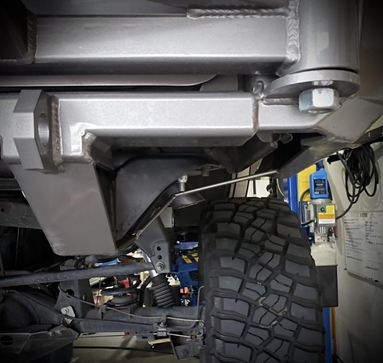

Yep. Heard the same thing from an exhaust shop. Recently I put on a dual swingout and removed the spare along with the lowering mechanism and braces. The Vibrant ultra quiet resonator gets outstanding reviews, is 13” long and will be stuffed up between the frame rails. Tail pipe to exit straight out the rear. Can get a rough idea of how much space is freed up in the following pic. As long as the muffler sits above the present tail pipe exit it’s a win in terms of clearance.

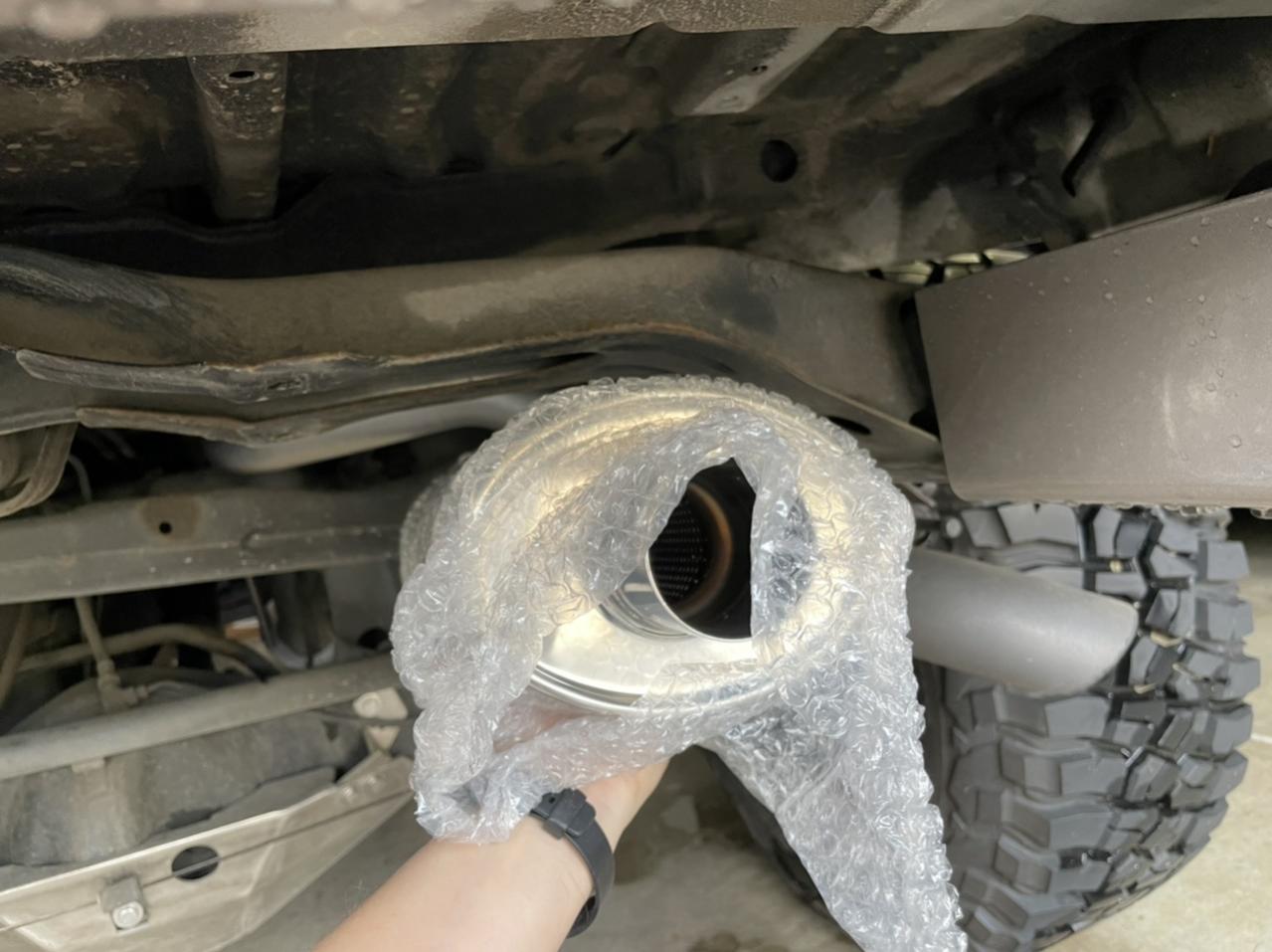

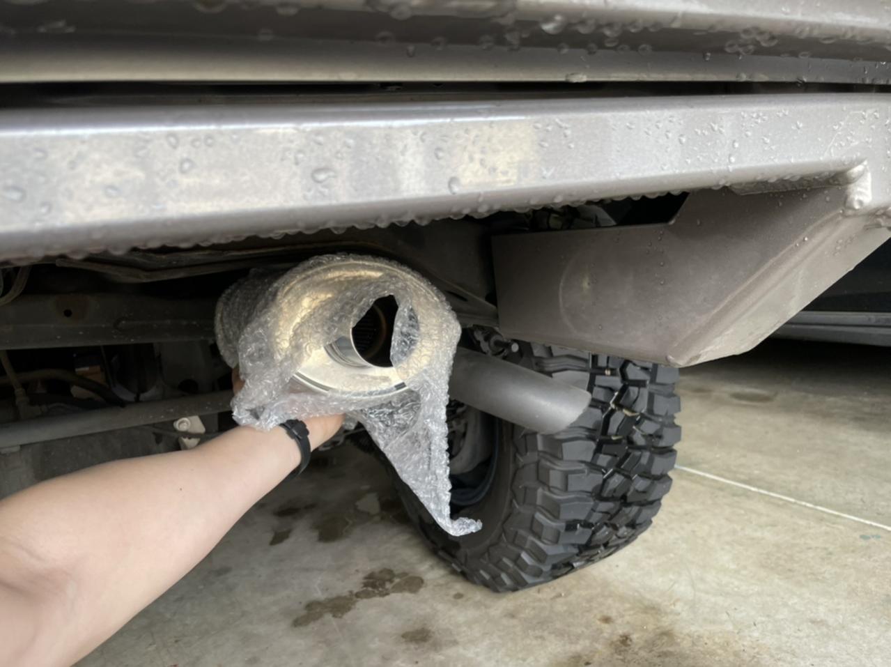

Pics of the idea below. Slant cut rolled 3” tail pipe will exit straight out the back consistent with rear frame rail angle.
dang straight out the back. I've been doing some research and will probably put it right after the second cat and before the muffler. it's a tight fit though

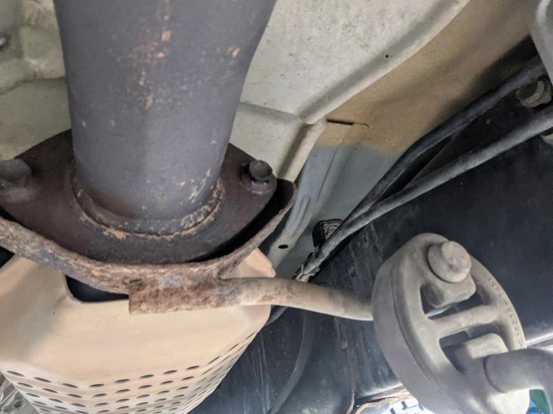

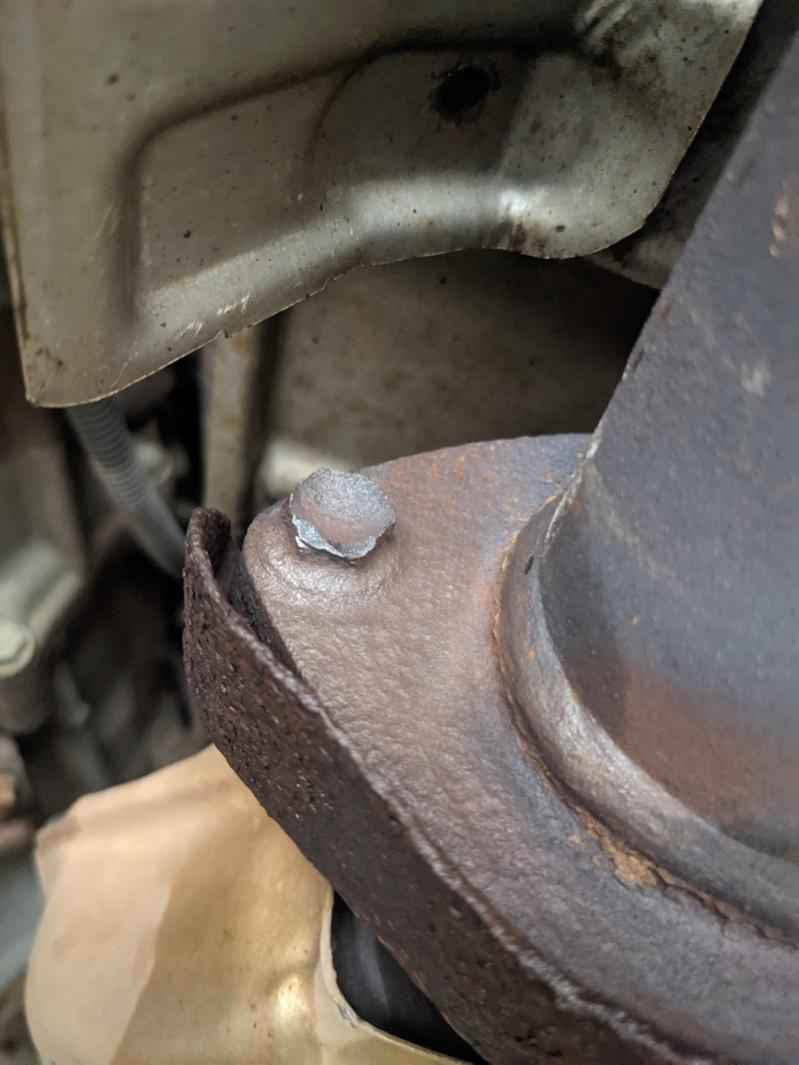

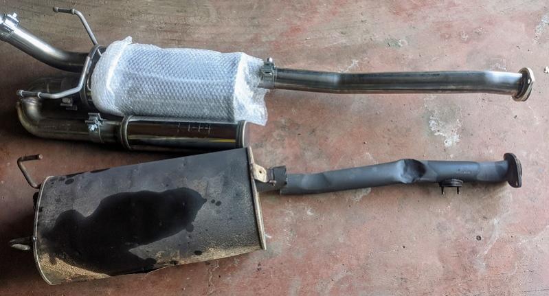

Mine finally showed up. Went to get it installed in a garage to find out my 99 Runner has done quite the job of rusting the bolts. No amount of PB-Blaster was going to help.
Have the single cat Federal model. The bolts attaching the hanger bracket were thoroughly rusted. They actually looked welded on. 6 sided socket immediately rounded the corners.
Got a nut extractor kit off amazon. Downsized to 13? mm extractor hammered it on and off it came!
The bracket was toast. The threads on the welded nuts on the bracket were so rusted they looked like a spring after the bolt was removed. Installed M10 1.25 stainless bolt and nuts until the new bracket shows up from McGeorge.
Part 17503-62050 Exhaust Bracket $55 shipped :ybrick:
Had to cut out some pieces via sawzall and use the nut extractors on the O2 sensor nuts as well. So to Home Despot for blades :ybrick:
Whoops, need a gasket for the O2 sensor. Go to O'Reilly. :ybrick:
Learned some PB-Blaster on the rubber mounts made it much easier to remove and install.
Used the OEM hitch nut and bolt on the tip hanger. Loosening the next bolt towards the rear of the vehicle, spray with PB-Blaster and give a good scrubbing the the bolt went in pretty easy. Glad I had an impact gun with a long extension to get those loose.
So... 1 wasted trip to use the garage, 1 trip to HD and 1 trip to O'Reilly and some elbow grease and cussing and it's on.
The sound is - different - than my leaky exhaust which was a bit loud and clunker sounding. With the resonator it is louder than expected on acceleration up to about 55 mph in 4th. Then the sound lessens. Feel its tuned to cruise in 5th between 65 and 75 for the least amount of drone.

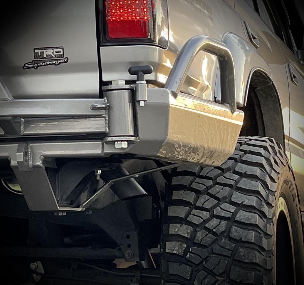

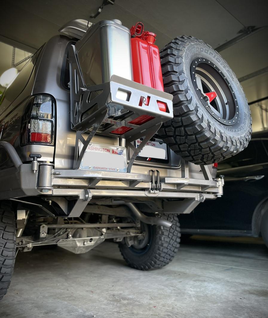

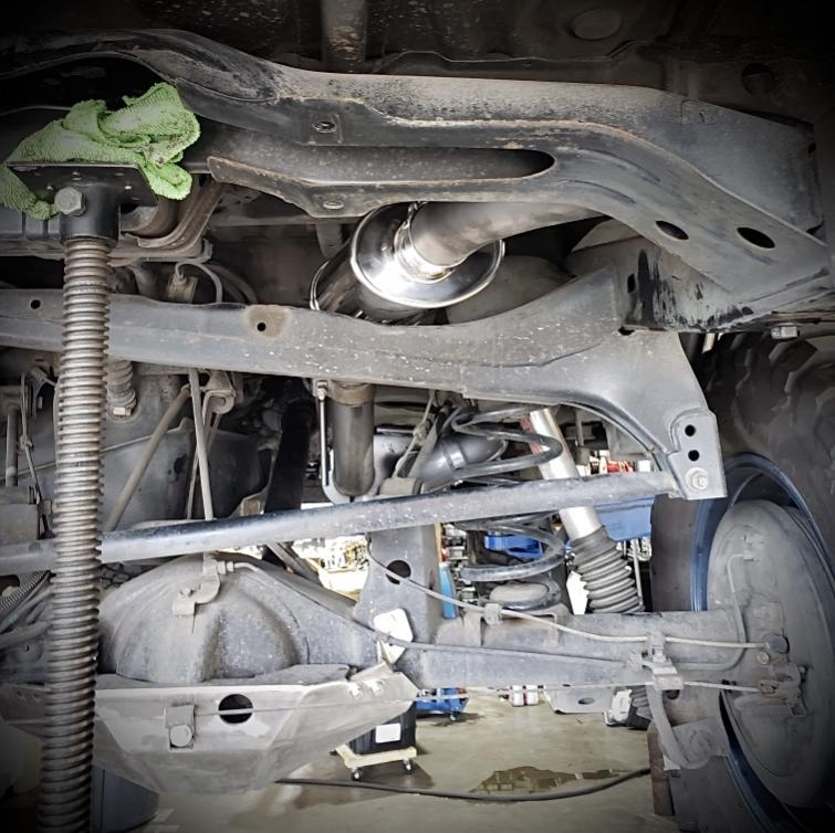

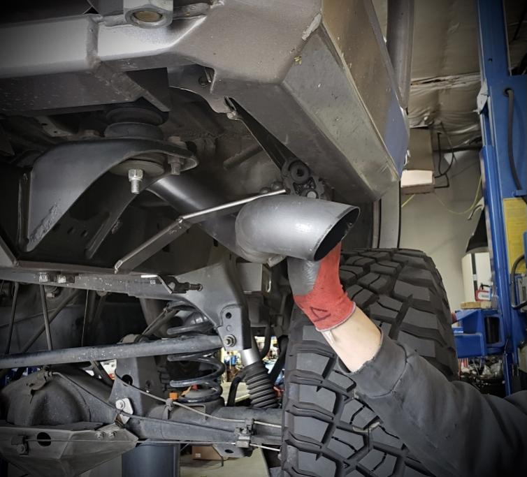

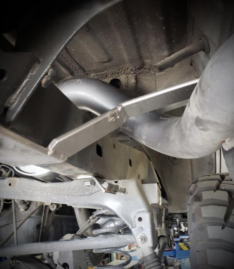

Vibrant ultra quiet resonator installed. Tames this exhaust to mellow levels just louder than stock. Similar to the TRD exhaust on my prior 02 sport. Sound clips on my Instagram stories: Formidable_4runner
Exit was also modified to turn down above frame rail just behind rear wheel. Cut at the NW swingout rear bumper bracket. Pics below.
Very happy with this setup.
