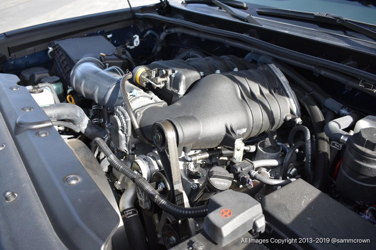

Sorry to hear about your issue. I have a Magnuson SC on my 2016 Trail since April of 2018 and haven't had one issue. The tensioner has always worked correctly and the belt has been tight. I hope you get your issue resolved soon so you can enjoy the SC.
Looks like one of the pulleys are out of round or not centered correctly.
