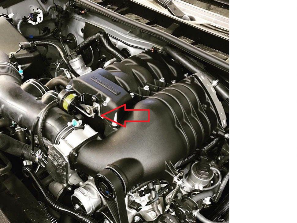

Can you shoot another video? We need to see what's happening here:
