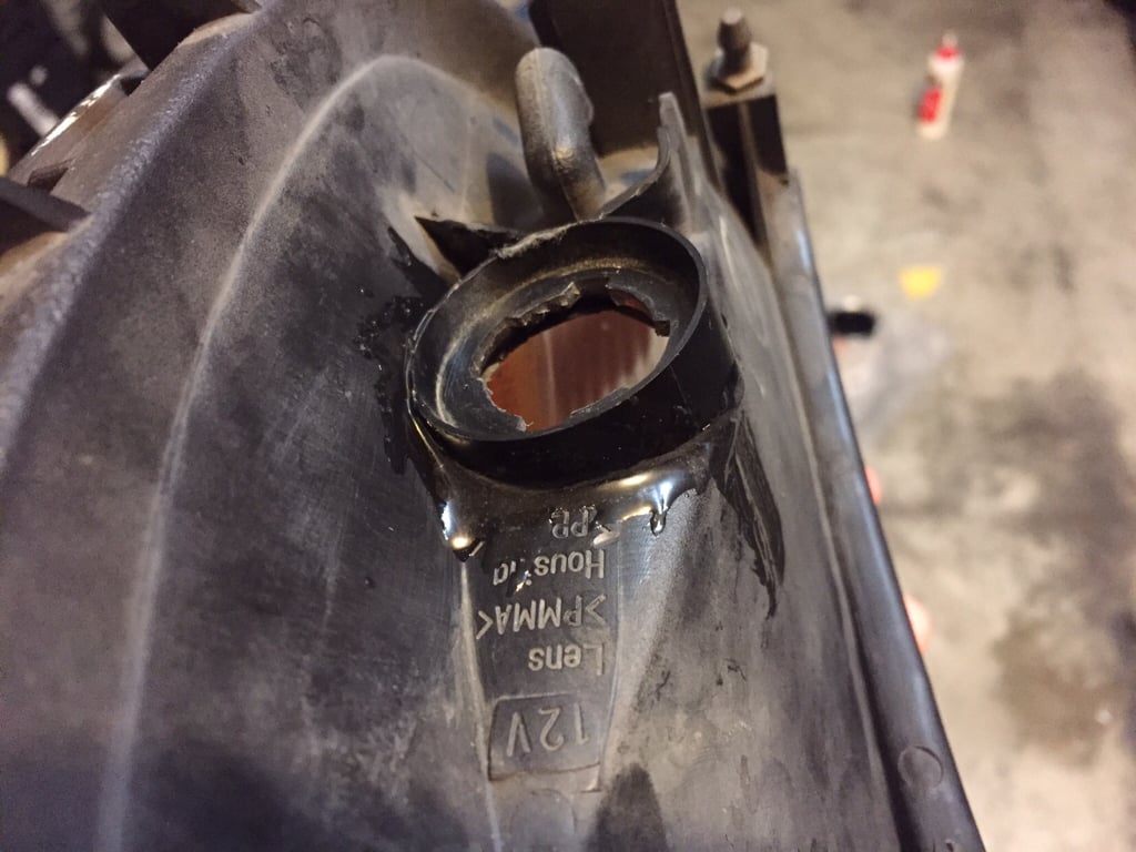

Originally I was going to add a second LED light to the marker housing itself, but logistics are tricky with where to fit it, and I after upgrading to clear corners I didn't want to drill into them.

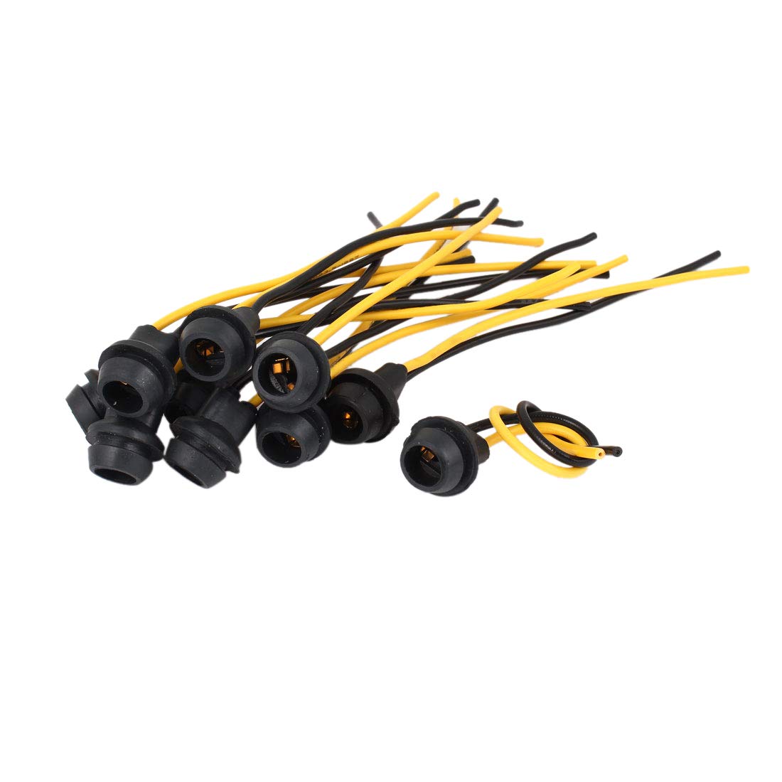

I retrofitted a 7443 bulb/socket from an OEM brake light housing on my '97.

I don't have any bumper blinkers anymore so I retrofitted am 1157 socket into the marker lights to run switchback LEDs to have white markers with Amber blinkers. I like it and even running a normal Amber light bulb with work great. I figured since tundras and Tacoma's run blinkers up there I shouldn't have a problem with it either. I'd say go for it cause it is a super simple mod to do.
