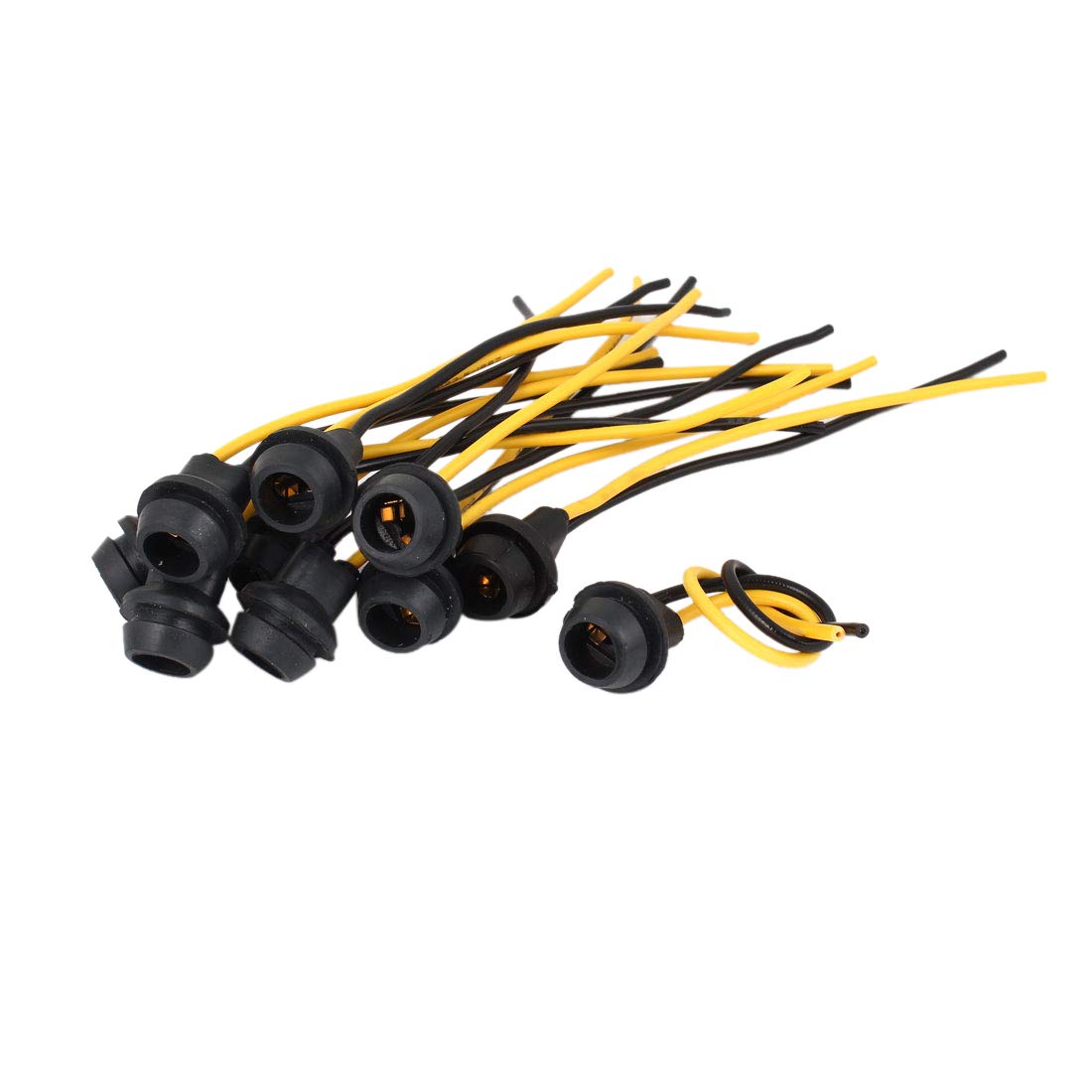

Those are fancy. I just used these and a drill to do mine and 2 other rigs. Still have 4 left.
https://www.amazon.com/gp/product/B00W8W5MR4/ref=ox_sc_act_title_1?smid=A1THAZDOWP300U&psc=1
still have any of those left?
