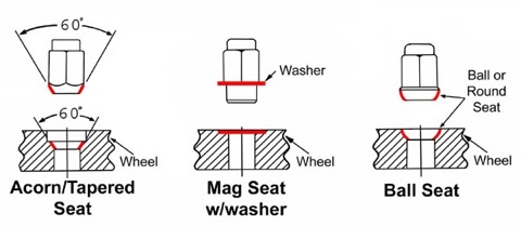

The previous owner also said these wheels came off of a 94 Land Cruiser so I bought some acorn/tapered seated lug nuts to fit. 93 and 94 LC's need these style lug nut where as the 95+ use the same style as our stock 3rd gen's do (mag seat with washer).
See picture for reference: (Picture courtesy of [MENTION=58830]JWaldz[/MENTION])
After further examination of the wheel however, the look to be 95+ because of how the lug holes sit. Can anyone verify this for me?

Like you said, there are two different version of the wheels. With these wheels being passed around so much it's hard to keep up with knowing for sure which style lug nuts they need until you just try it. If you have any mag seat lugs I'd see of they fit. If they don't then you'll need the acorn/tapered style. If you do end up needing acorn/tapered style I highly suggest getting the E/T threaded ones. They offer more thread engagement.
Like these (but maybe minus the fact they're spline driven)
They actually turned out not to be the acorn/tapered style, I guess they did just get mixed up when they were tossed around. Thanks for the help!
