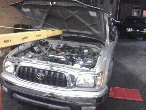

I purchased my tacoma for $500 from a customer at my work. I found a used & complete 69k mile 3.4L out of a wrecked 03 tacoma prerunner off of eBay of all places. Had it shipped to me here in Md. from Az. I also replaced all the maintance items and clutch before i installed it. Its been a great engine, i was nervous since it was a sight unseen used engine. I drove the truck to Texas to pick up my new 17ft camper just days after i got it up and running. I've been upgrading it ever since, Toytec lift, tundra brakes, SCS wheels, poly bushings ect... My buddies all have new trucks and call me "cheap" because my taco and my 2 4runners are 10+ years old. I tell them keep making those payments, lol.

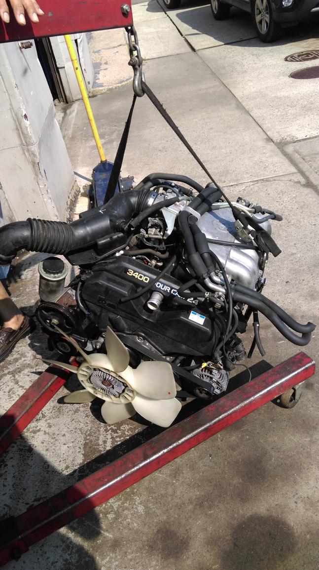

Just got running an hour ago. It sounds great. I bought the entire truck with a blown head gasket for the price of the brand new tires on it.
Here's a pic of the engine when it was delivered

When i was searching for a 3.4 for my project tacoma i read somewhere that the JDM engines were slightly different than the 3.4's that are built for the USA. For instance i remember seeing a pic of a JDM 3.4 and the oil filter set farther back, where the oil cooler should be. Any other differences? I also read that the emmission parts from the old engine could easily be transfered to the JDM, is this true?
Correct. We had to change the manifolds, relocate the oil filter, swap out the water pump(Hiace 5VZ is missing a coolant neck), and the injector harness. The fan pulley bracket is totally different too. There are a bunch of details here and there.

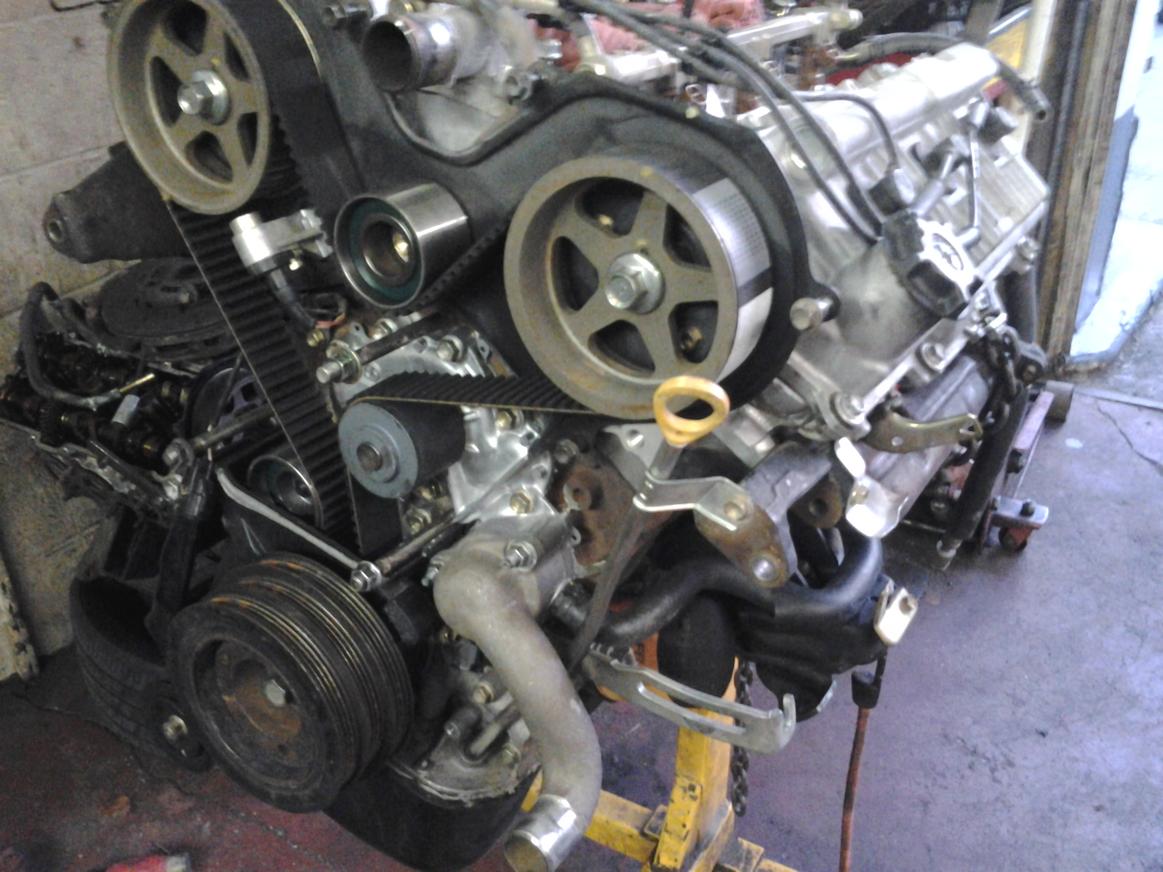

Kind of blurry, but this is what the majority of JDM 5VZs are coming out of.

What vehicle is that? Looks like a car vs an SUV. My oil pan was swapped as well, forgot to mention that until now.
That would be a Toyota Hiace van. There is also the Granvia van which is built on the Hiace chassis. It is pretty popular outside the United States.
That looks like a ***** to work on compared to our 4runners and tacomas!

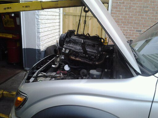

Today we went to The Narrows off of 64th street at the oceanfront and brought Kayaks. The new engine is running great and I can't wait to see how much my MPG's improve.
Sorry for all the crappy pictures as they're just cellphone pictures
