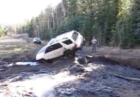

This is pretty close to flopping.

Well if you are just parked or on a smooth slope, your CG has to rotate past the edge of the tire for it to roll. But don't be mistaken that you're safe as long as you don't go past that angle. As your CG rotates around the edge of your tire and approaches tipping, the amount of energy needed to push the truck past the tipping point decreases at the cosine of the angle (with the horizontal plane). This means that if the truck is nearly at the tipping point, very little energy is needed to push it over such as a bump in the road. I rolled my runner onto its side a few months ago, and I didn't feel like I was anywhere near rolling but my right tire hit a tree stump and just that was enough force to push me over. Similarly that's why you see pictures of a few guys just hanging onto the bumper of a few thousand pound vehicle and stopping it from tipping.
