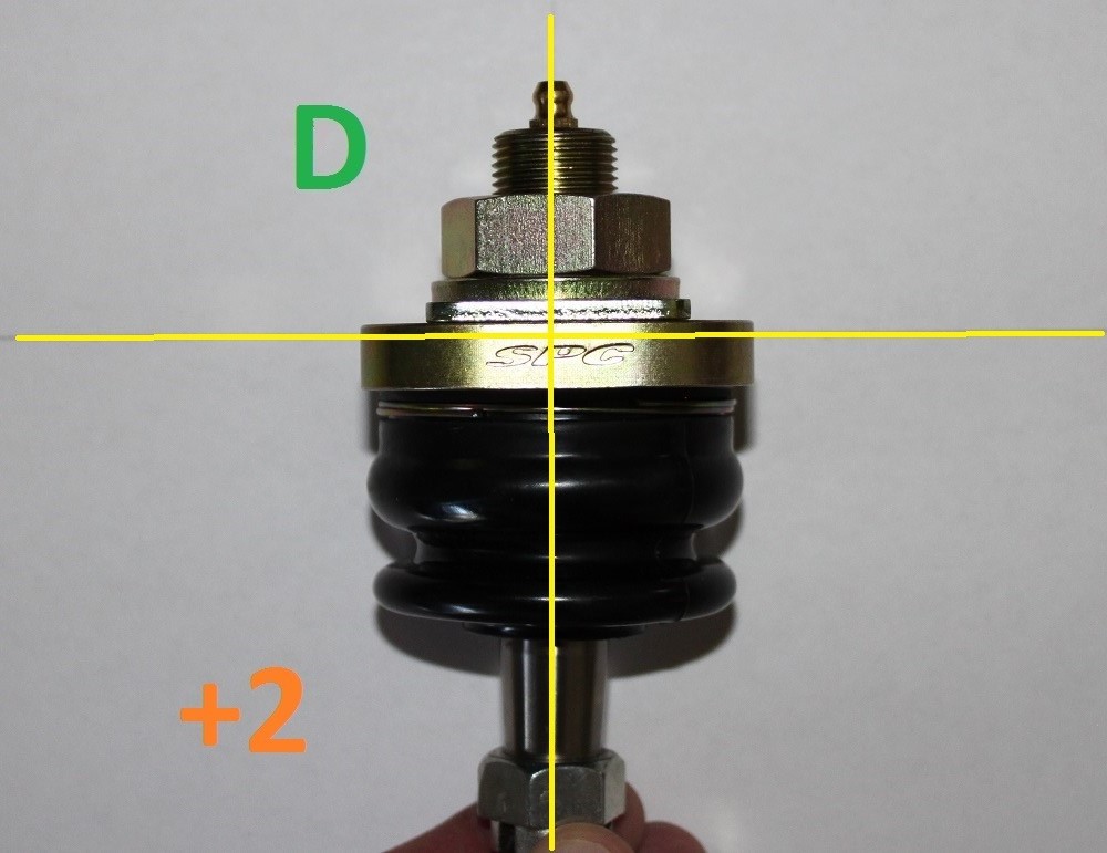

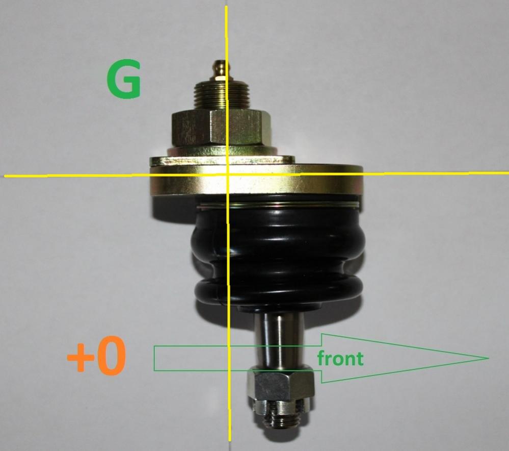

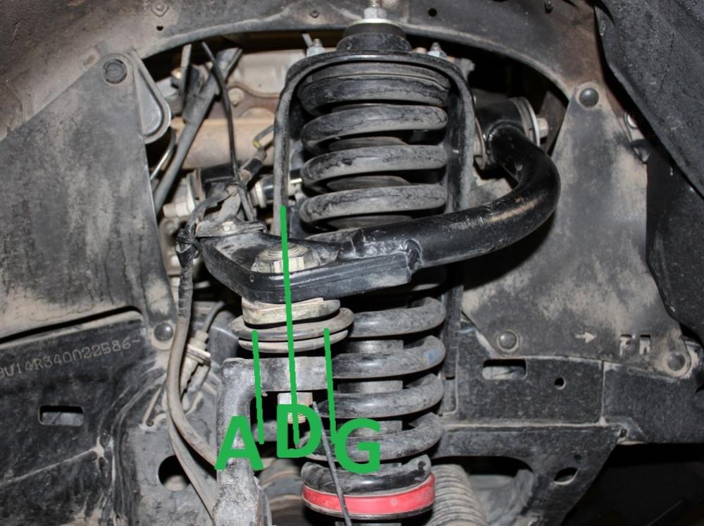

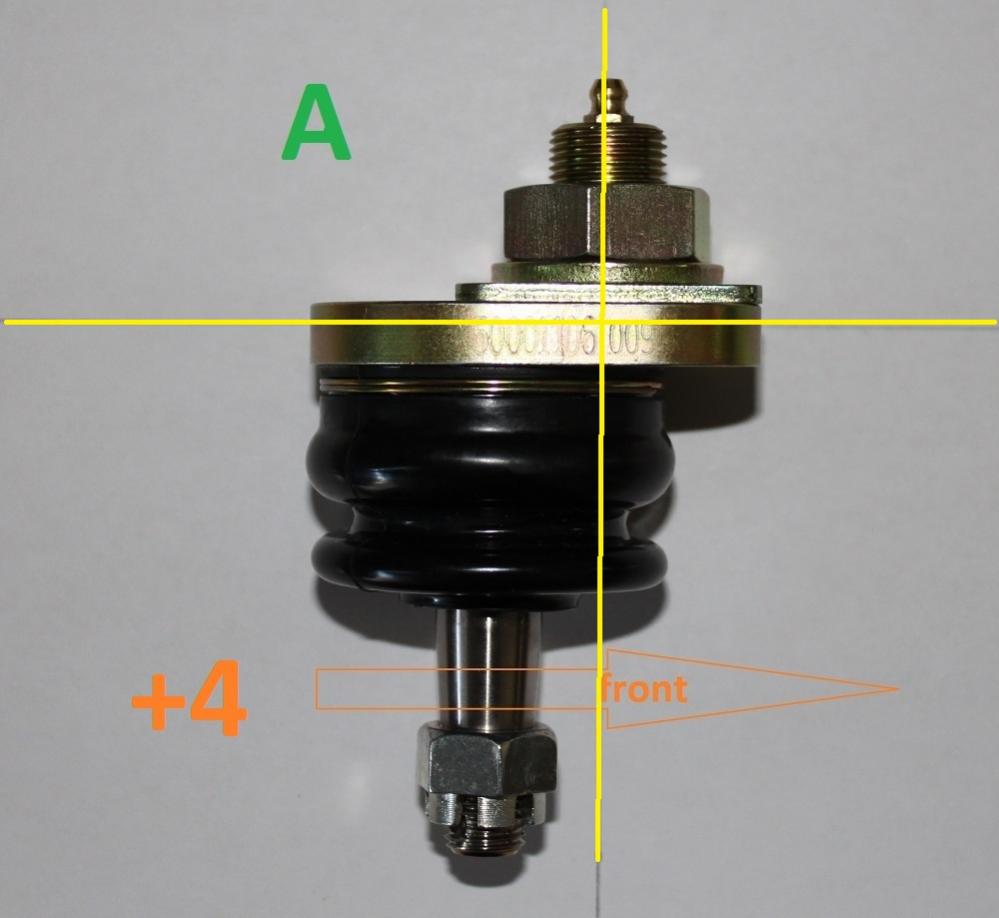

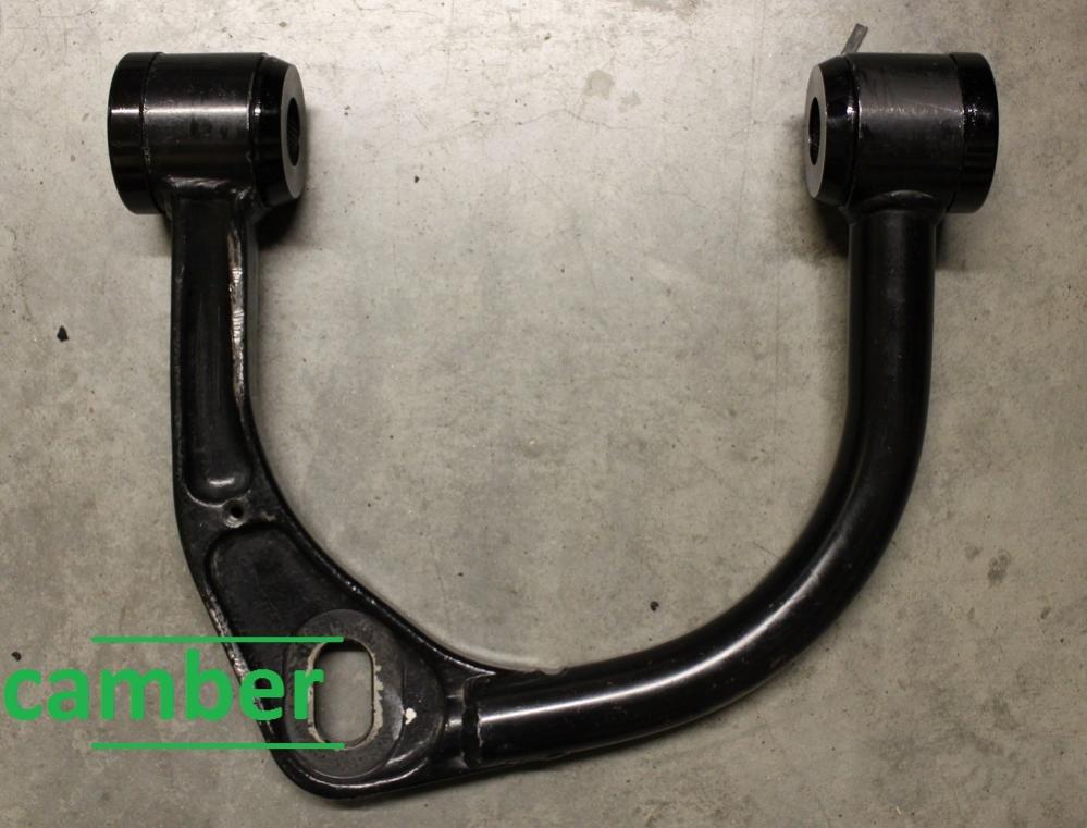

Jaming in more caster with the SPC UCAs will move your tire into the body mount more.
The 3rd gen guys figured it out.
Orange is caster# the SPC arms do.
