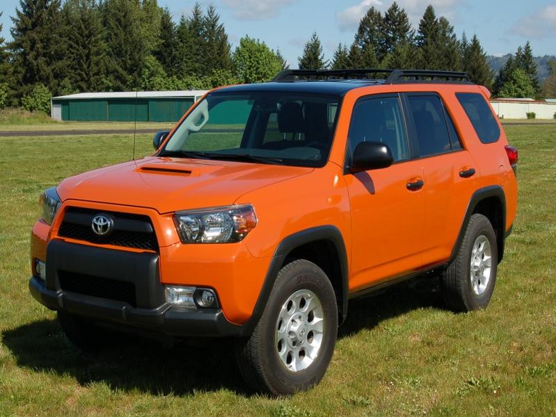

Just got the 4Runner back from paint today. The paint job turned out awesome, we used a factory Toyota FJ55 Land Cruiser color called T308 Persimmon Orange! Next we are putting it on the lift for a Total Chaos 2" long travel kit, secondary shock hoops, our long travel rear suspension set up, 4.56 gears and an ARB air locker.
The truck looks awesome in Orange! I'll be following this build closely. Excited to see what you guys have coming out for the 5th.

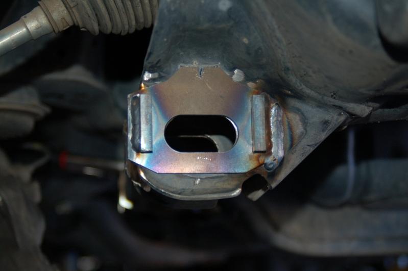

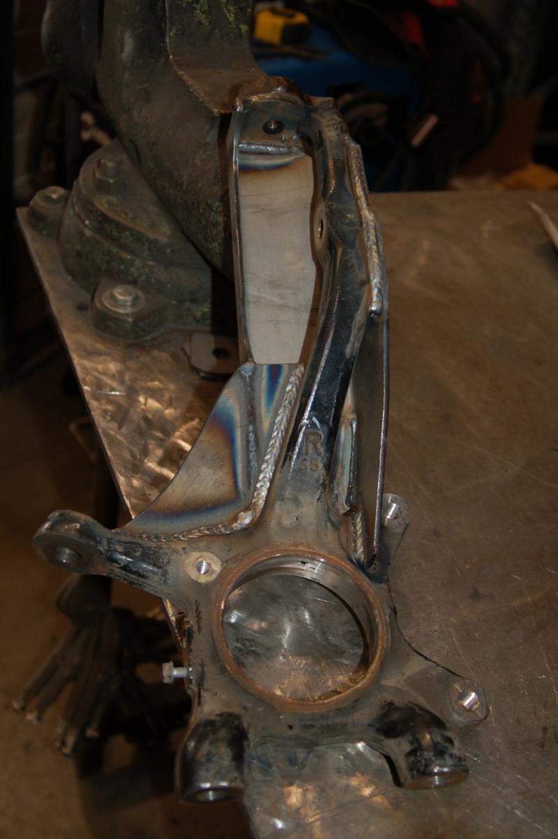

Below is the Total Chaos spindle gusset that is sway bar compatible and the next picture is the Total Chaos replacement cam tabs that are much beefier than the stock ones.

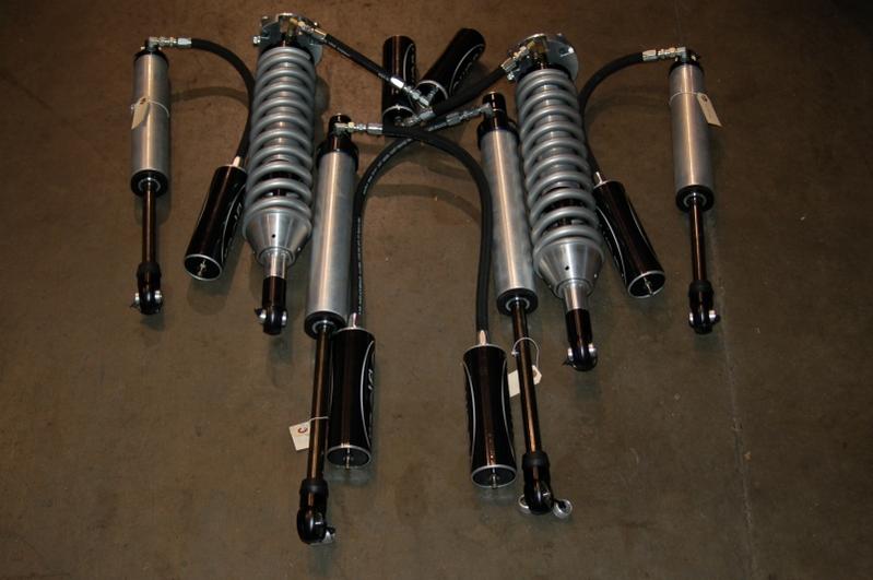

Just got in the coilovers and shocks from Radflo Suspension. Here we have the long travel coilovers, secondary remote reservoir shocks and our long travel rear shocks with remote reservoir.

We are using the long travel speced coilovers for the Total Chaos 2" Long Travel Kit, all the manufacturers make them King, Fox, Icon, Radflo and Sway Away. The extended travel coilovers that Icon offers is meant for a standard 3" lift that allows for an extra 7/8" of down travel when combined with an aftermarket UCA with a high misalignment joint.
For the rear as you pointed out we are using our progressive rate long travel springs and we had Radflo build the shocks to our specifications. We won't be using a sway bar since the shocks will more than handle the body roll even with the absence of the sway bar. Unfortunately you cannot use the factory sway bar if you want to utilize the full travel. However, there have been a few customers that have adapted Currie Anti Rock sway bars to the FJ Cruiser and have had positive feedback. We might tackle that project to provide a bolt on option since most people due carry more weight than what we typically do on our vehicles.
For the links we are in the process of having our own version of replacement links being machined at this moment. I have put the prototypes on our 4Runner and it is looking like we are going to be the full vertical travel of the axle before the links contact the axle housing ;)
Sweet sounding build! Looking forward to the updates and the results. Bold beautiful color as expected
why aren't you using your MetalTech/ICON long travel rear? Would love to hear more about that kit, what it is designed for and how it REALLY performs. Do you guys have anyone running that kit on a 5th gen runner?
Is the rear Radflo kit being added to this rig avail.? and built for the 5th gen?
We are still using the same components except with the use of Radflo shocks. Radflo had approached us about sponsoring our 4Runner so we decided to move forth with it hence why we are getting all this Radflo suspension. The rear long travel truly does work, we didn't come up with arbitrary numbers without testing them. We will offer the Radflo version of the long travel shock but we have plenty of the Icon 2.0 VS Series and 2.5" remote reservoir shocks as well for those that want a choice between the two different companies.

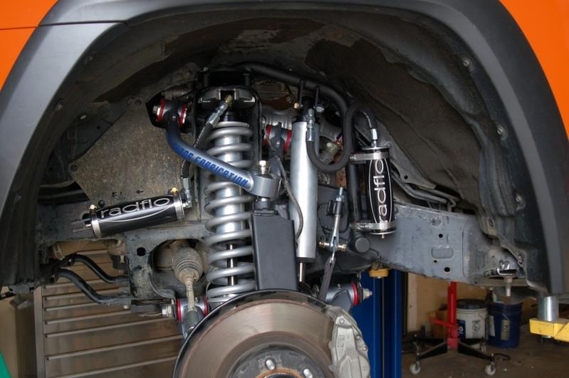

The 4Runner suspension is all buttoned up and ready to go. We will be taking it down off the lift and start breaking in the gears. In the next week or so the front bumper will be coming off to start developing a shell bumper :)
