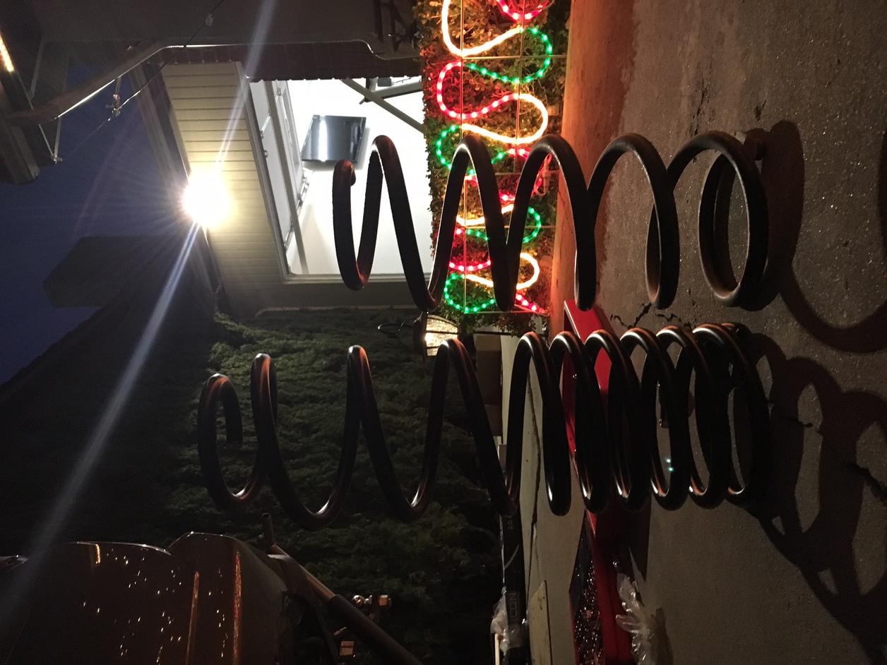

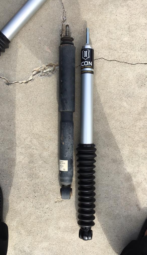

Install: PITA although it was a given since I don't have a shop lift and the length of the stock springs/shocks are significantly shorter than the MT4x4 kit. I did the uninstall by myself and a buddy came over to help me get it on the car.
TIPS: 4-ton jackstands, spring compressor, impact, and 3-4 ratcheting straps to get the diff lined up after you have to drop it to the floor to get the springs in there. I'm not running a rear sway bar and this is my DD and i have no issues.

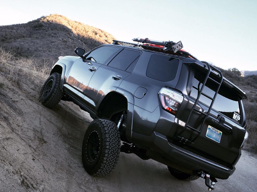

Off Road: Pictures speak for themselves i suppose - this isnt maxed out neither as it wasnt hitting the bump stop. Overall - it's a bargain for the insane amount of travel and droop you get out of this kit.
