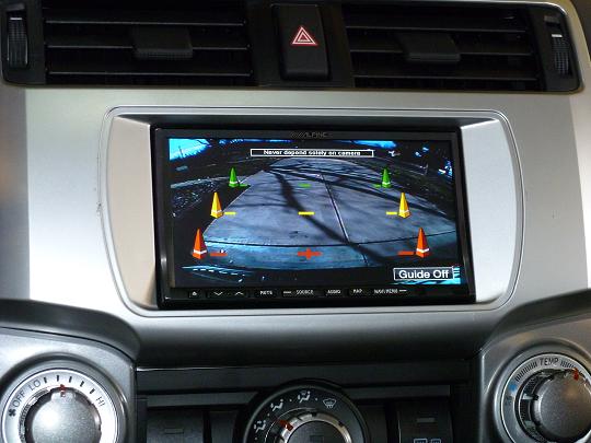

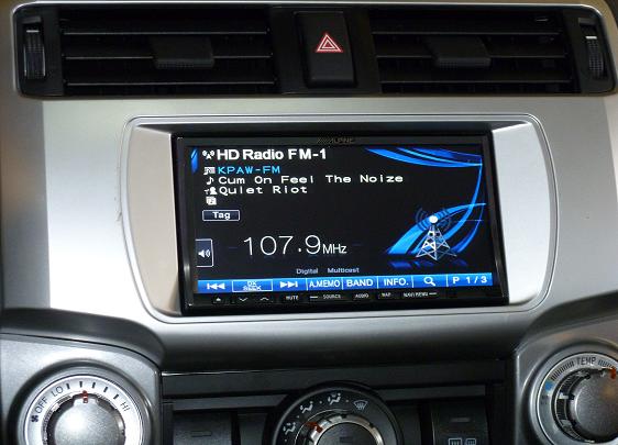

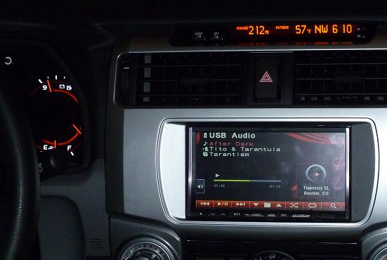

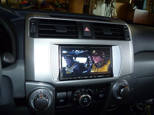

I've had both dash kits. I ended up using the Scosche kit because it has stronger supports for the radio and looks better with the indentations around the radio. Color matches good on my 2012.
Here are the requisite pics of it on my rig...
