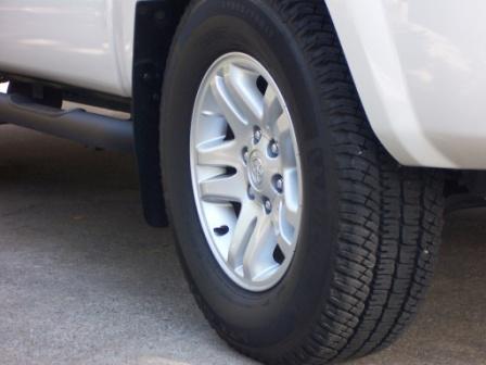

Here's a pic of the AT/2 tire. I have about 5 months use with some being during Oregon's 1st and 2nd elk hunts with no significant problems. I have encountered very slight rubbing on the fronts when the tire is turned completely in. This sounded worse than it was as there was only a slight scuff on the plastic fender liner.
Note: I have 3/4" Cornfed spacers on the front that provide a 1 1/2" lift.
These Michelins ride and handle great even though they are Load rating E.
The only cons so far is that they really fling small gravel on some roads and are VERY HEAVY which reduced my mileage about 1 MPG
