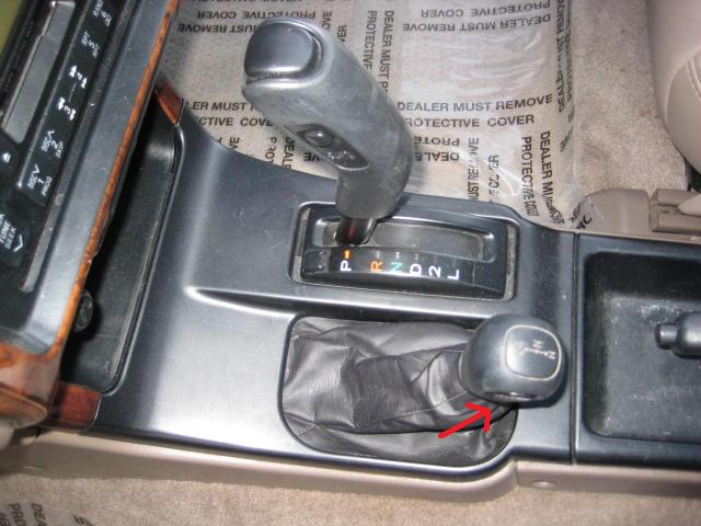

Could somone please post a shot of their console with the piece not missing?
It is like a Hood with a gap between the top of the cover and the flat spot in front of the P. This is so you can pop it out with your key.
OK, I tried squezzing it in. and this is what i have. Is this what it's suposed to look like?
If so this is some shoddy engineering for Toyota. Looks way outta place and the gap is pretty noticeable. But for $1.50 i supose i can live with it.
I still would like to see what one looks like that is factory.
Kinda a bad picture I found on the Internet but you can clearly see the cover in place and how it's suppose to look.
I'm sorry but I think I told you guys the part number for a 2wd cover.
I looked it up again and the 4wd part number is different.
This is the part number for a 4wd 33554-35050.
It's also about 6-7 bucks.
But again I'm sorry. I didn't see this myself when I looked the first time.
Hope you guys don't hate/ban me now!
