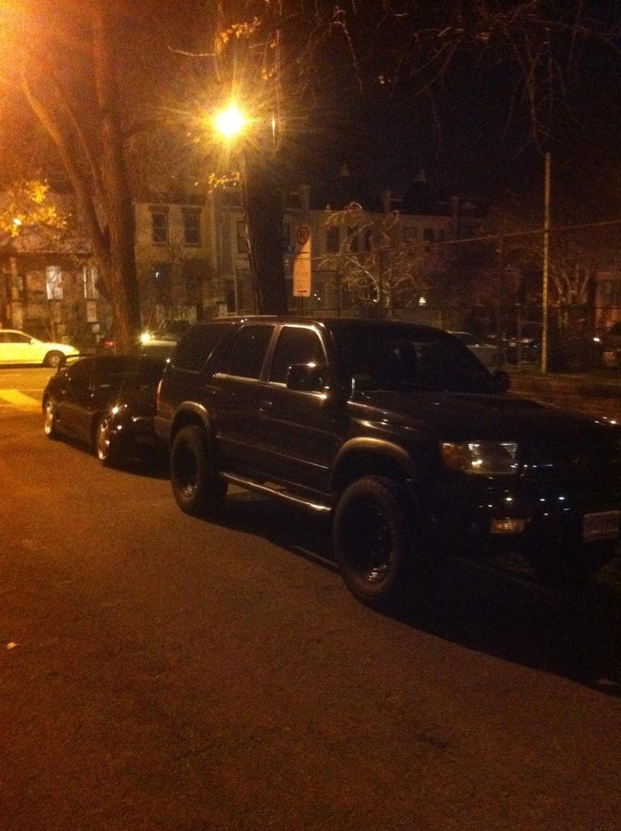

Pretty straightforward issue here - 1999 Highlander, suffered the infamous strawberry milkshake last fall at 144k miles. OEM radiator failed, fluids mixed, etc.
Replaced radiator, had tranny powerflushed, etc...lasted 9k miles until last night.
Symptoms:
- 1st gear, the truck barely moves regardless of how much you floor it...until you get out of first, then it's fine.
- Right as I'm going to park, A/T Oil Temp light comes on. Damnit...first time it's ever come on.
So now the truck's parked, and I'm having it towed to my house until I can find a shop to handle the replacement. Not going with a rebuild, as I'm not confident that they will get all of the coolant traces out of the gearset, etc.
I've found a couple used trannies locally (DC), but now my issue is getting the work done. Any local T4R guys want to take on the job, or recommend me a shop to work with in the DMV area?
Also, if I go with a shop how many HOURS of labor should I be paying for a tranny swap and fluid fill? Driveshaft, T-case, and all that will stay as-is.
Glad I have my Supra around to daily drive for now. :)

I like the Supra. That is a nice car.
