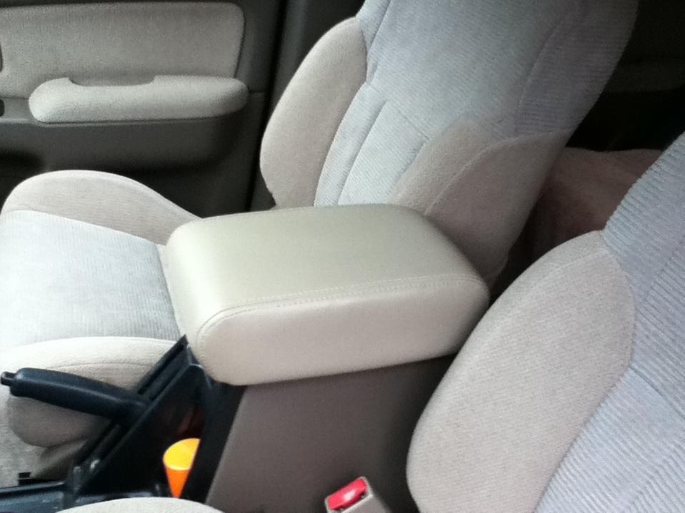

2. Modified Storage Compartment mini-mod
Link: http://www.toyota-4runner.org/3rd-g...compartment-mod-removed-box-added-carpet.html

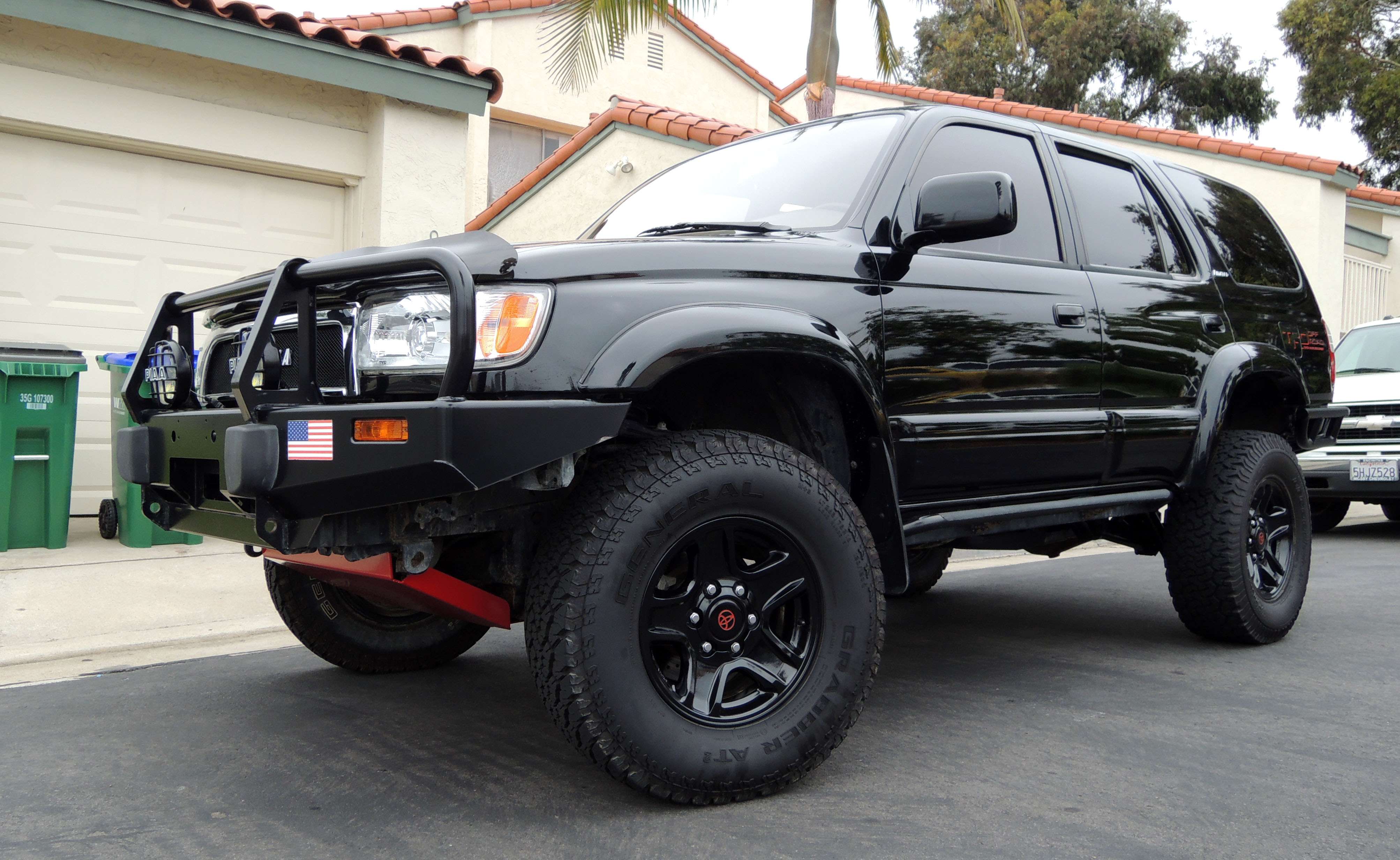

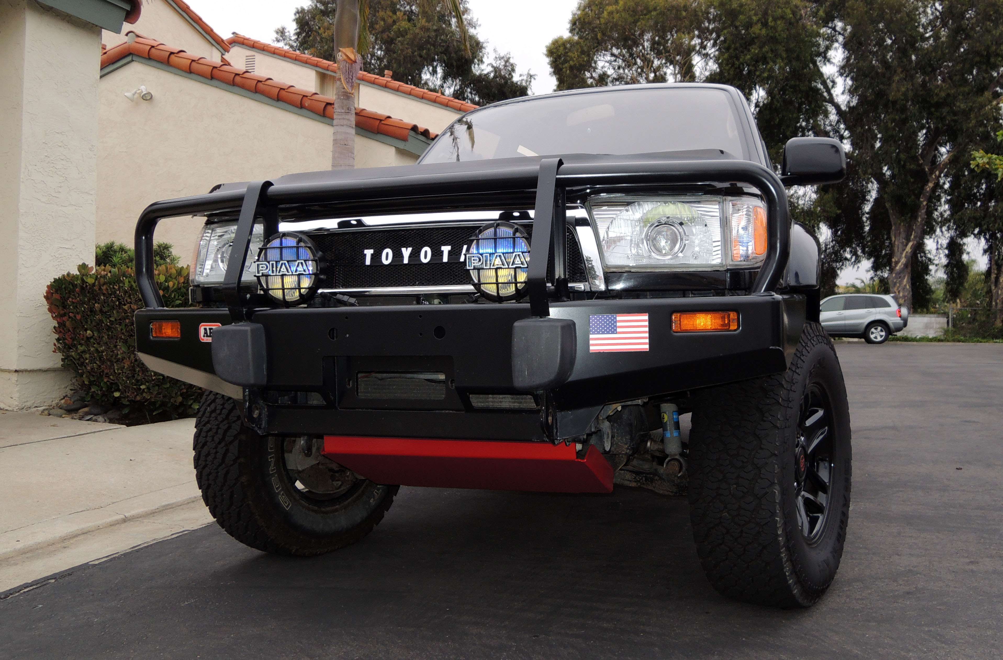

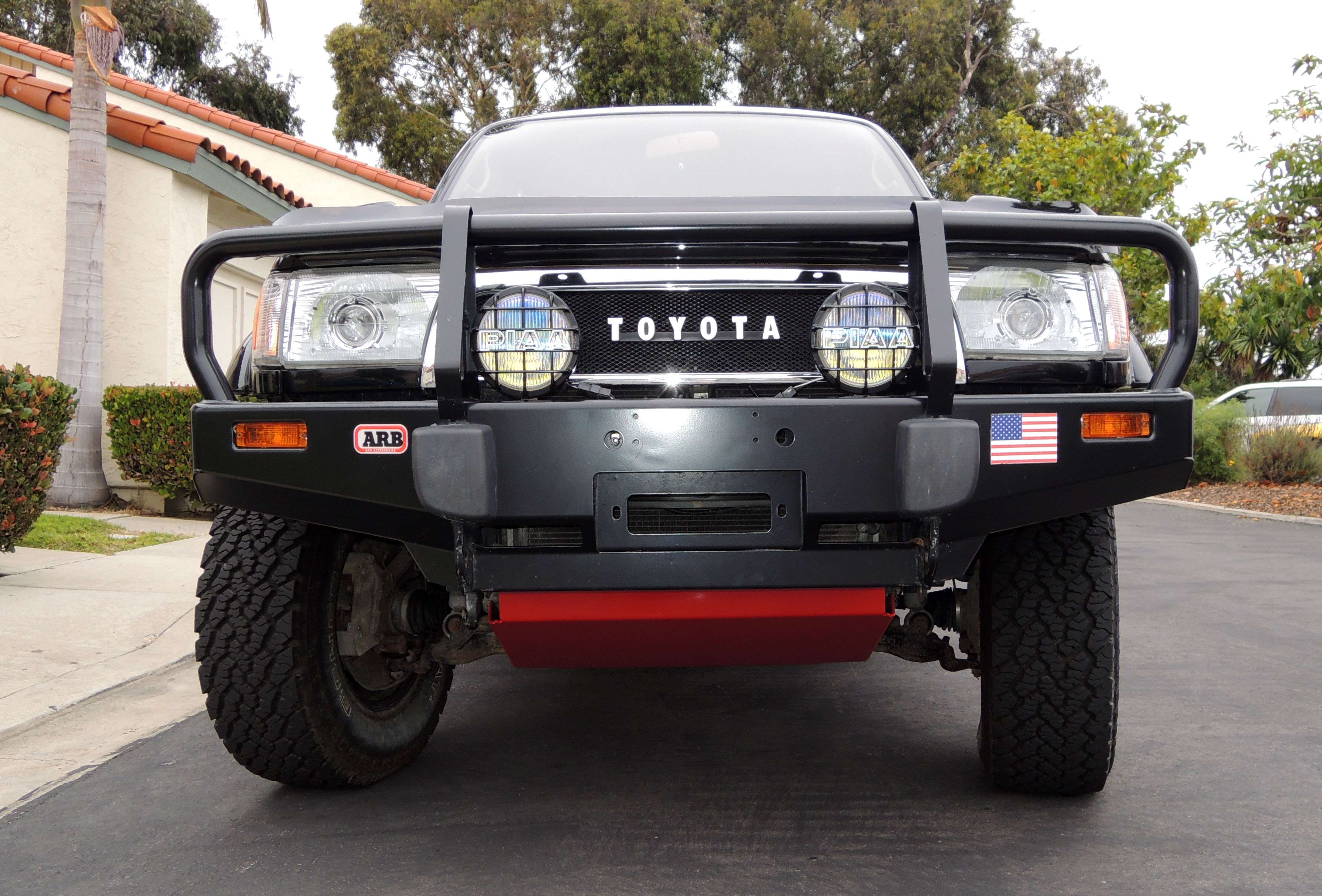

3. Trimmed Front ARB Bumper
Link: http://www.toyota-4runner.org/3rd-g...-build-maintenance-thread-17.html#post1131243
***** Trimmed the ARB Bumper (thanks Brian2Sun and JMoney$) *****
1.
2.
3.
4.
:party:

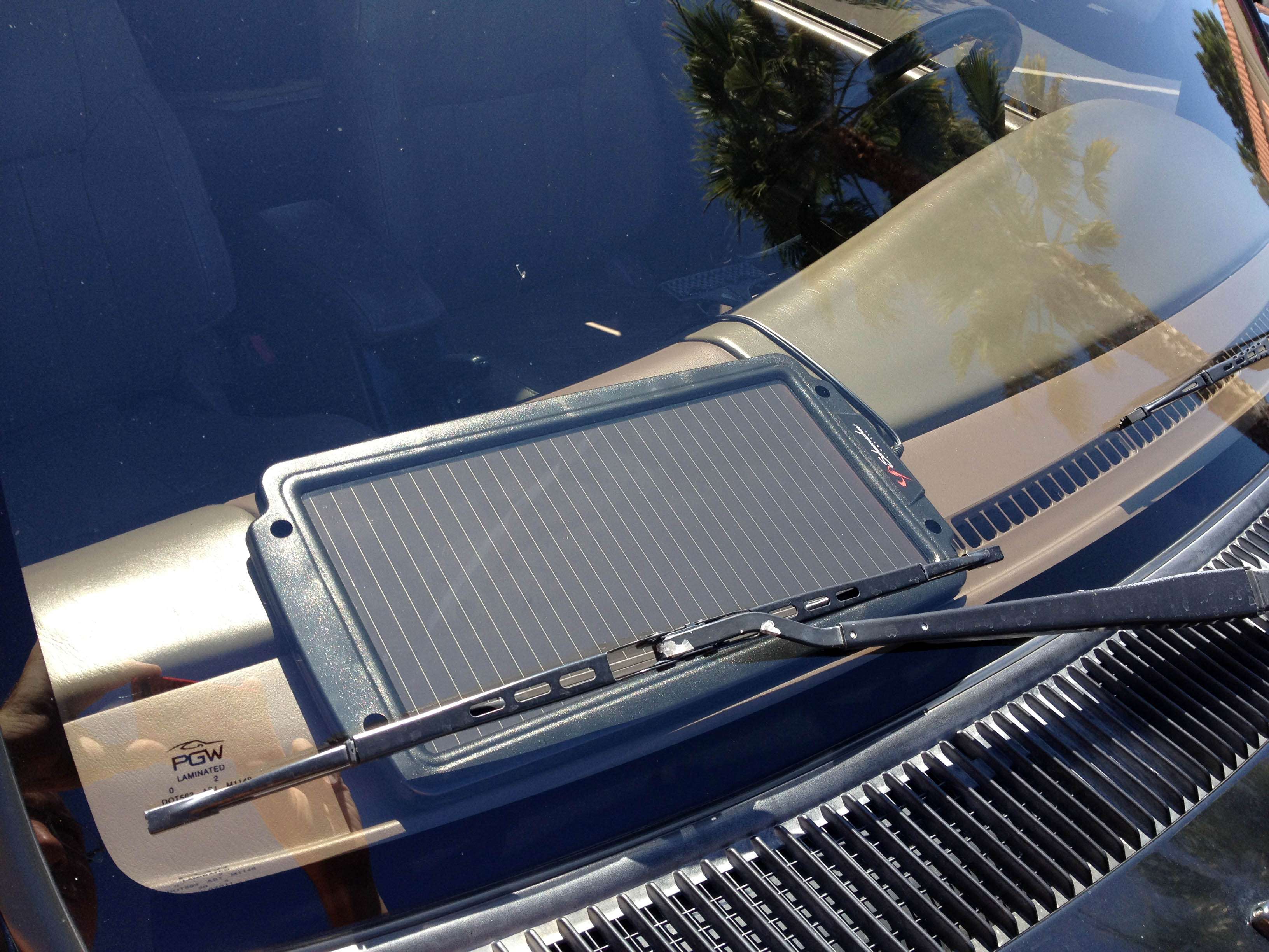

3. Solar Battery Charger $30
Link ---> http://www.toyota-4runner.org/3rd-g...-build-maintenance-thread-16.html#post1129824
Solar Panel - I recently purchased a 14.4V solar panel trickle charger off of Amazon for about $35. The goal is to keep the battery charged when I don't drive the car for several days or weeks. Since installing it about a month ago, I haven't had any battery issues. My yellow top optima is about a year old but it had been draining. I have a lot of electronics on the truck so it is difficult to really trace out the problem. This was the simplest solution.
Schumacher 2.4 Watt SP-200 Solar Battery Maintainer
Schumacher SP-200 2.4W Solar Battery Maintainer : Amazon.com : Patio, Lawn & Garden

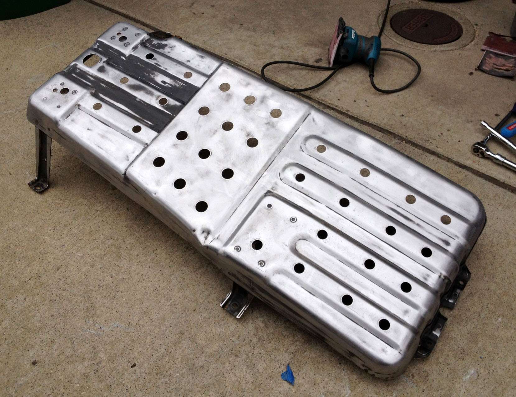

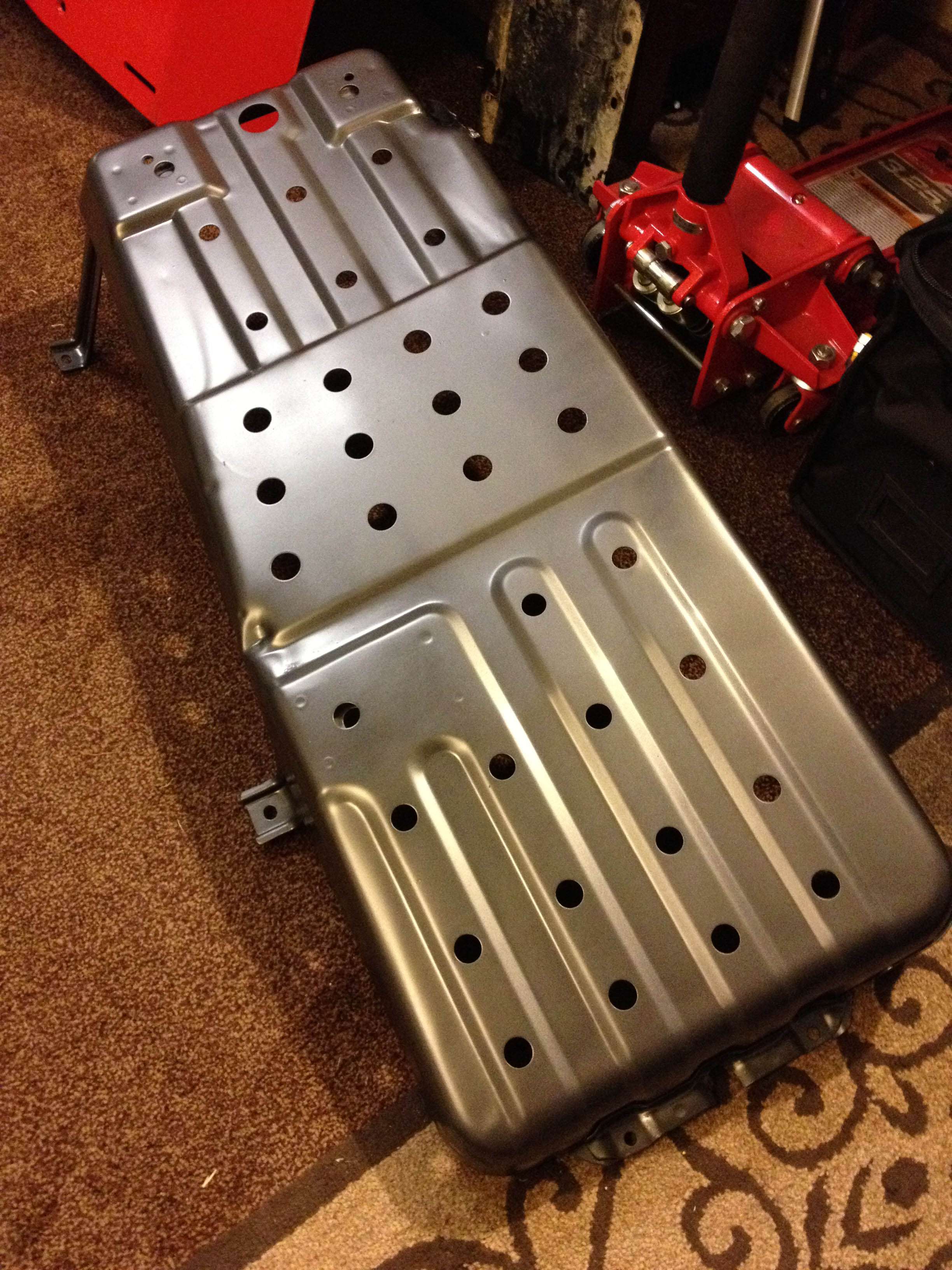

I also decided to sand down some parts of my undercarriage. 1st up was the gas tank skid plate which looked terrible an hadn't been touched in 15 years.
Solar Charger
5. Repainting rusted Gas Tank Skid
Gas Tank Skid Plate - Sanded
Gas Tank Skid Plate - Painted SEM Gunmetal Grey
:biggrin2:

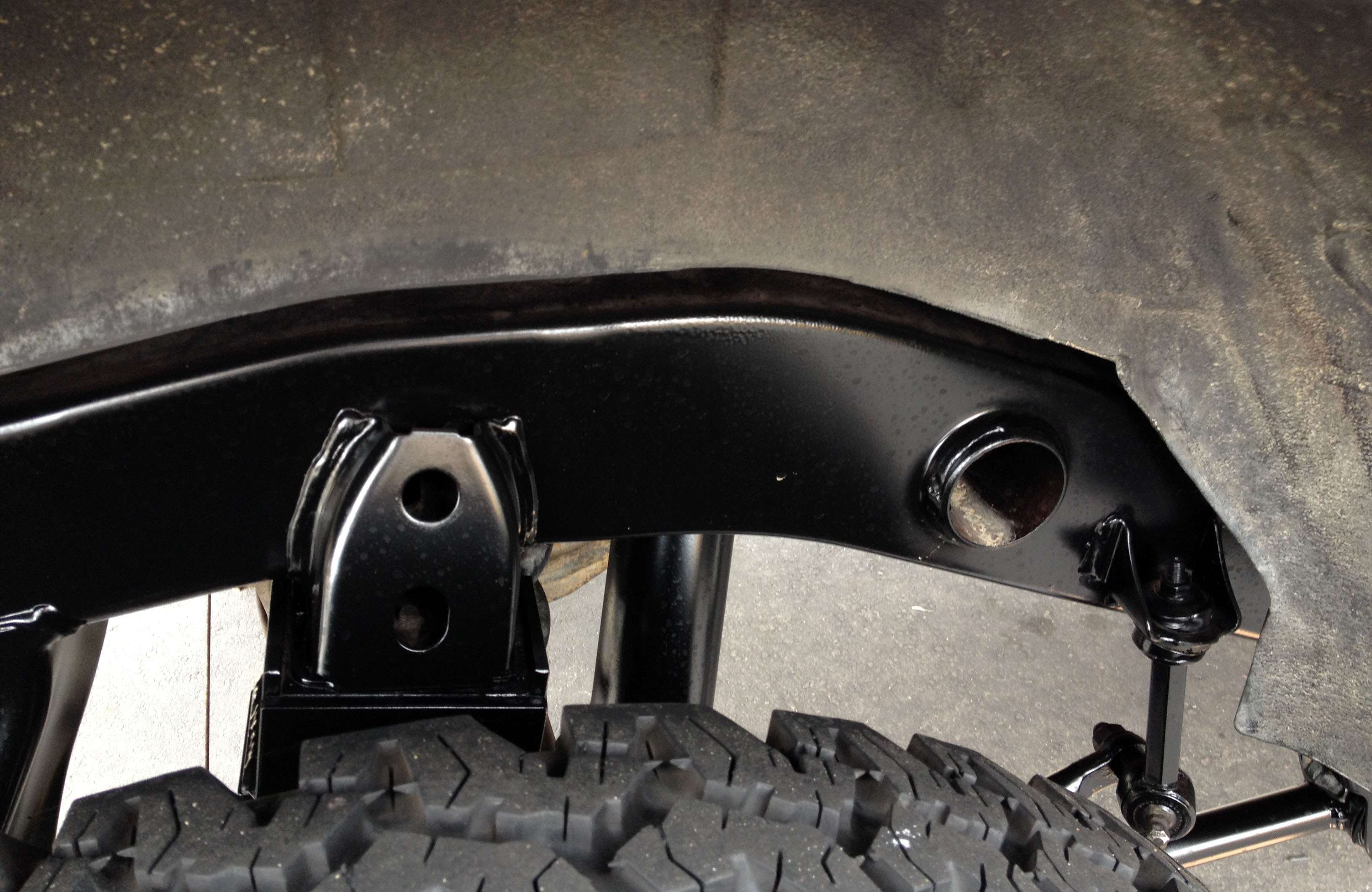

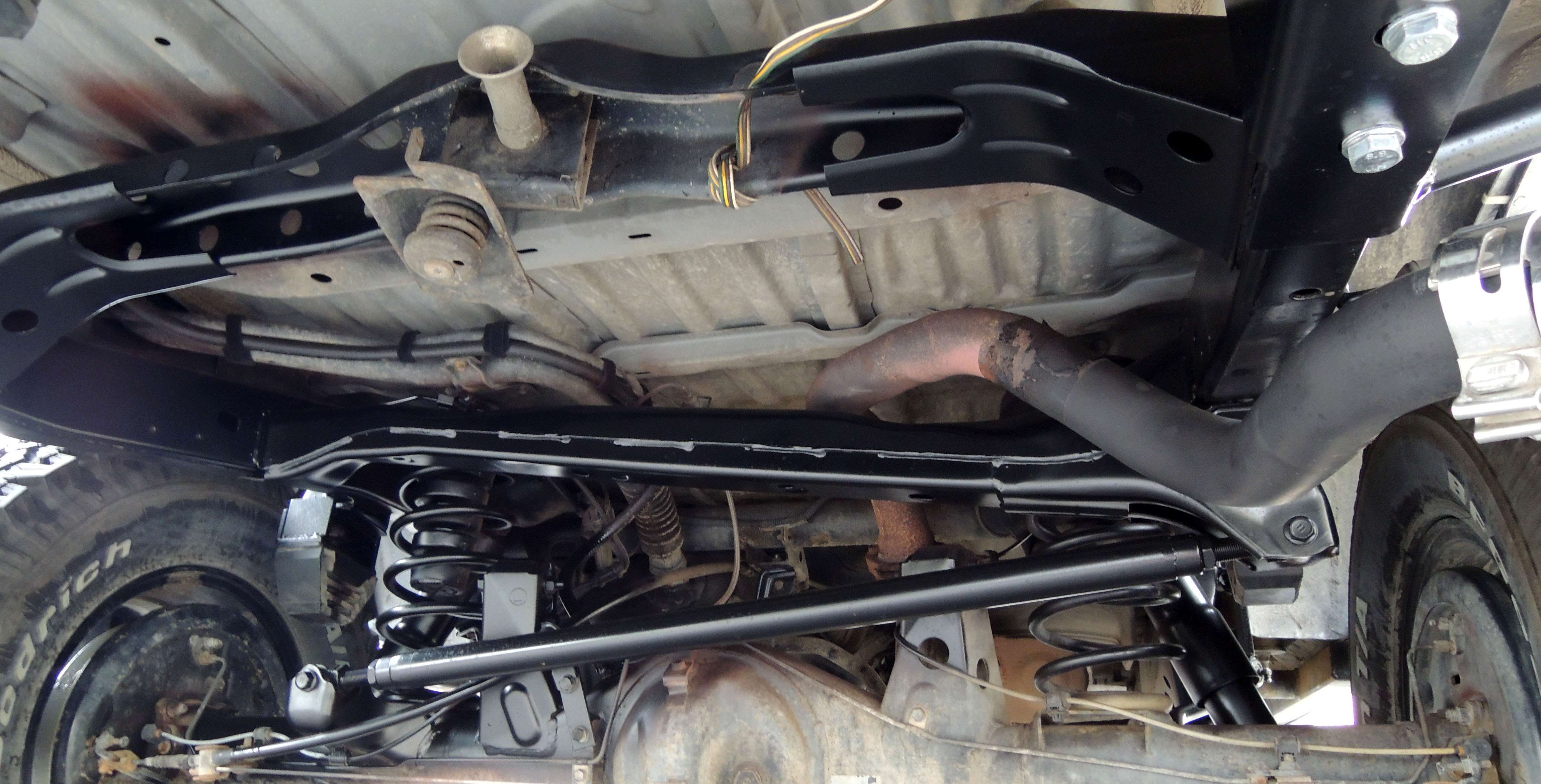

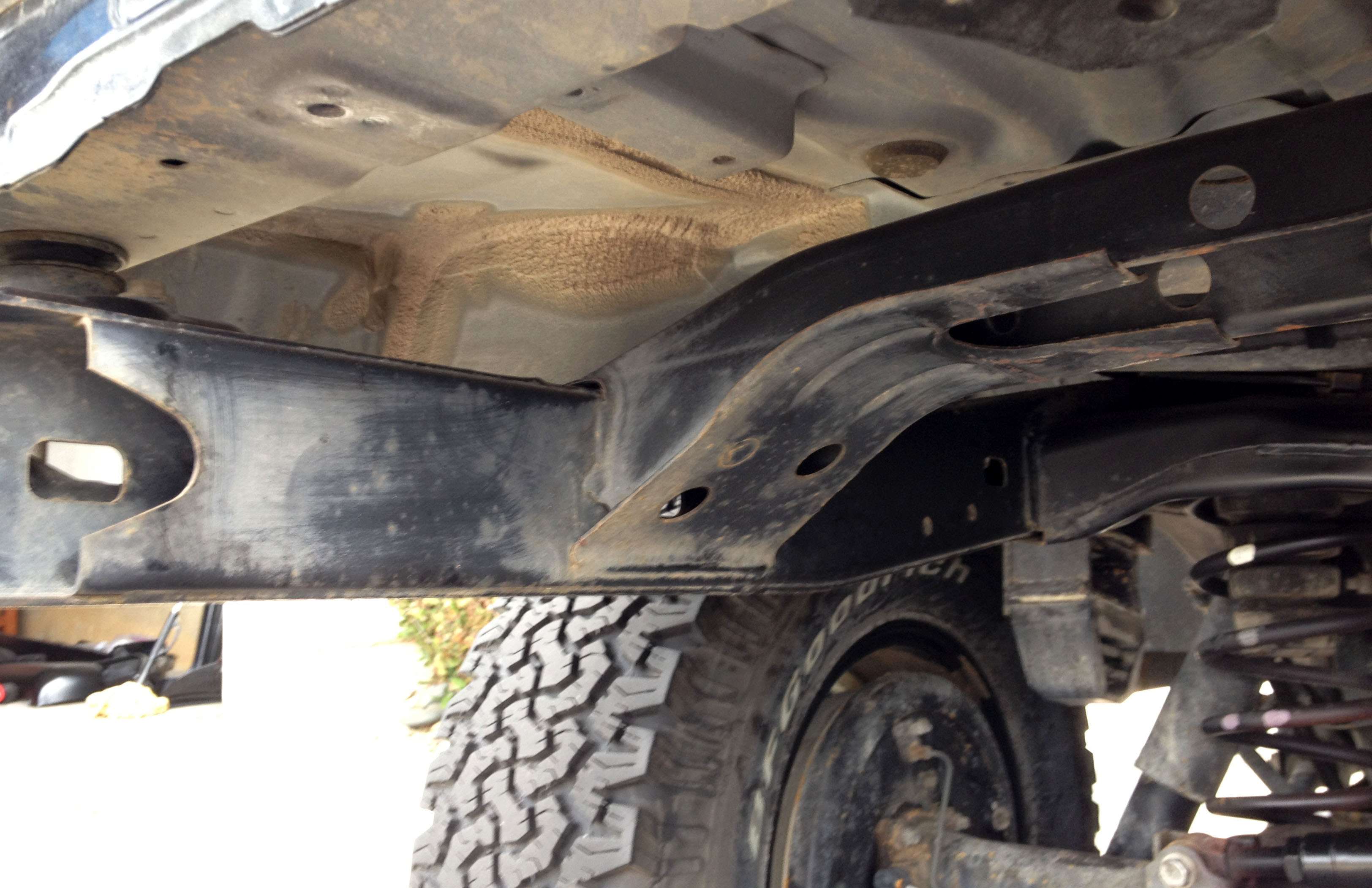

6. Sand rusted rear undercarriage and repaint | $15 Paint
Link: http://www.toyota-4runner.org/3rd-g...-build-maintenance-thread-16.html#post1129834

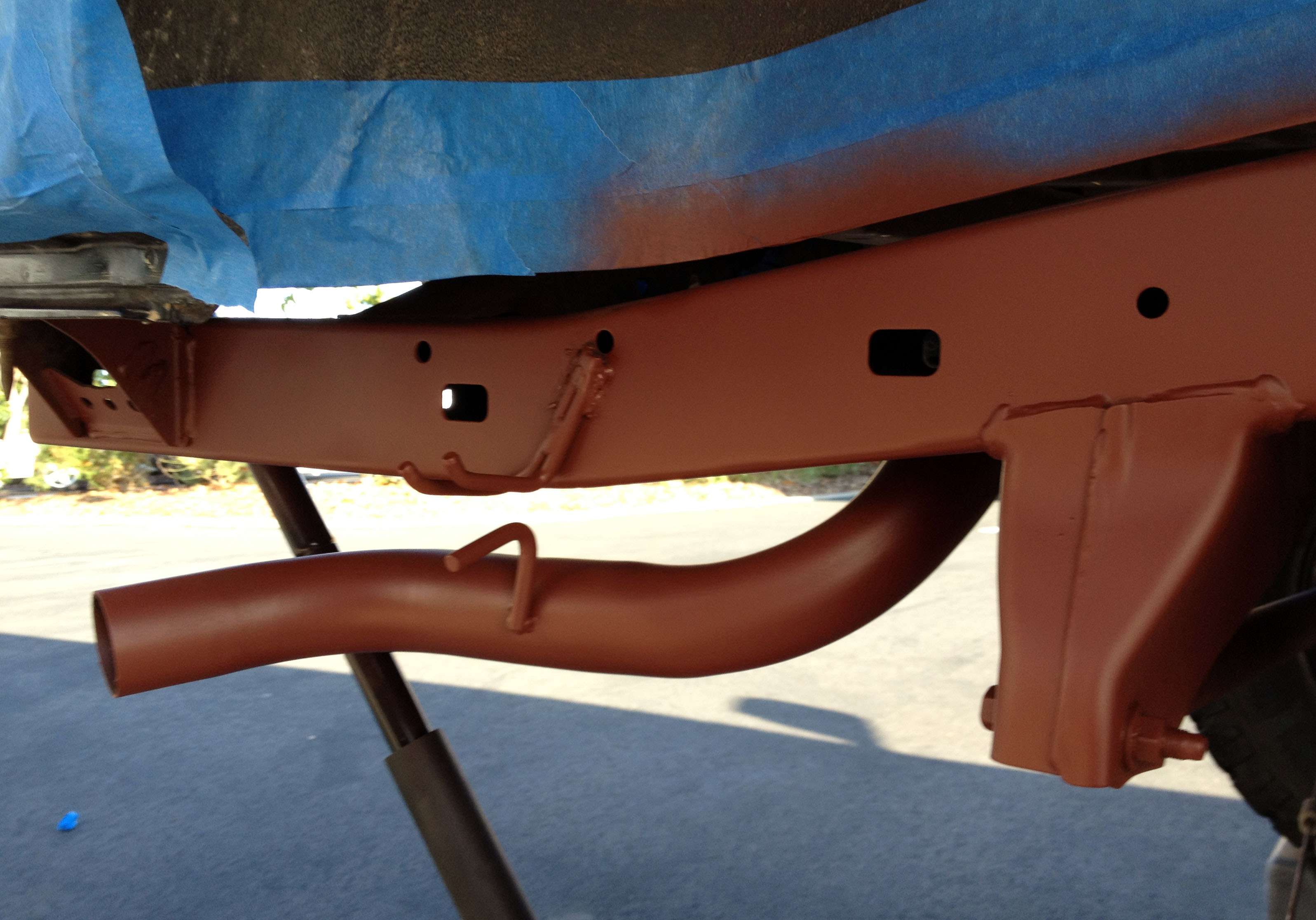

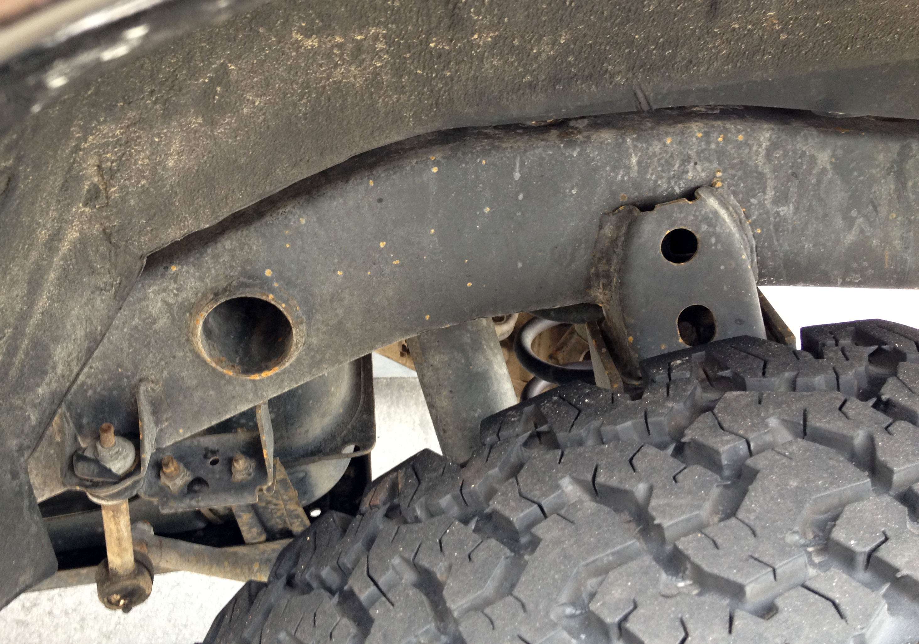

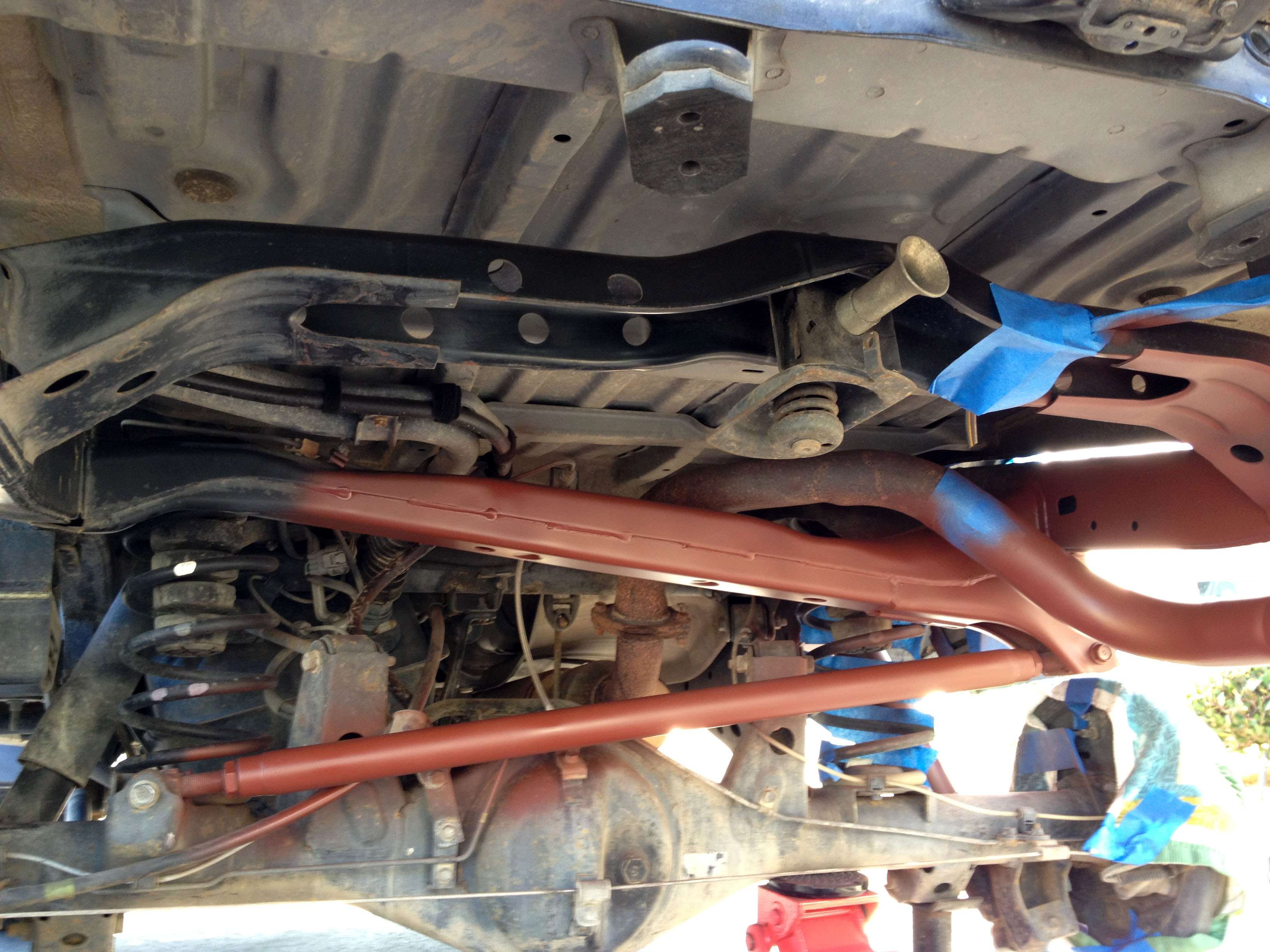

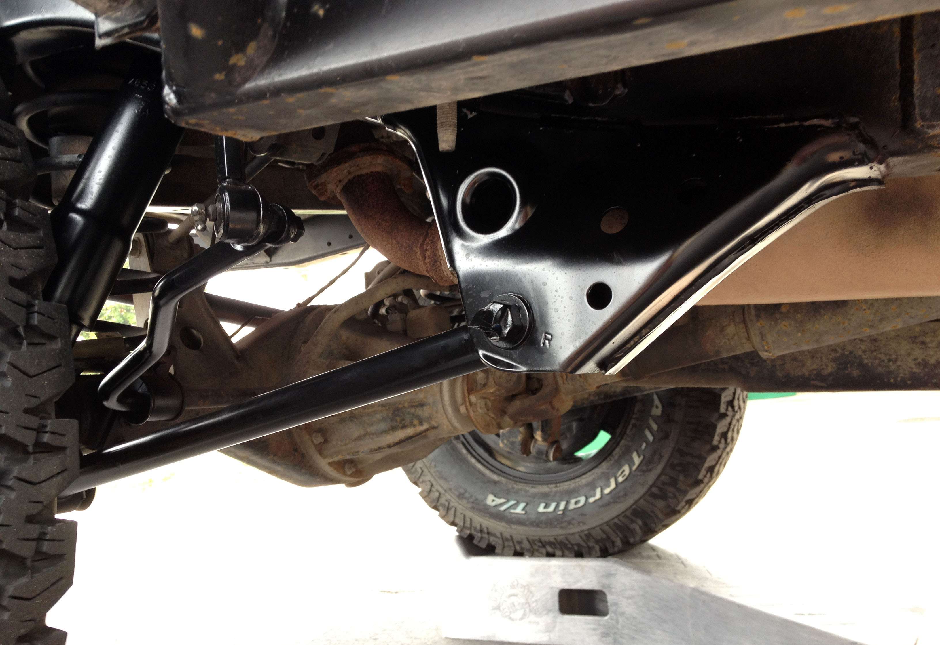

****** Repainted rear undercarriage in anticipation of new bumper *****
I also recently decided that after 15 years (10 of which I've had the truck), it was finally time to repaint the rear undercarriage of my truck.
I removed each rear tire and sanded down everything shown with a power sander and 80 grit sandpaper. This actually took much longer than I thought it would but I think it was worth the effort since the rust is now gone.
I really wanted to do this because with the low profile tube bumper on the rear, you can see a lot more of the rear end and it wasn't pretty.

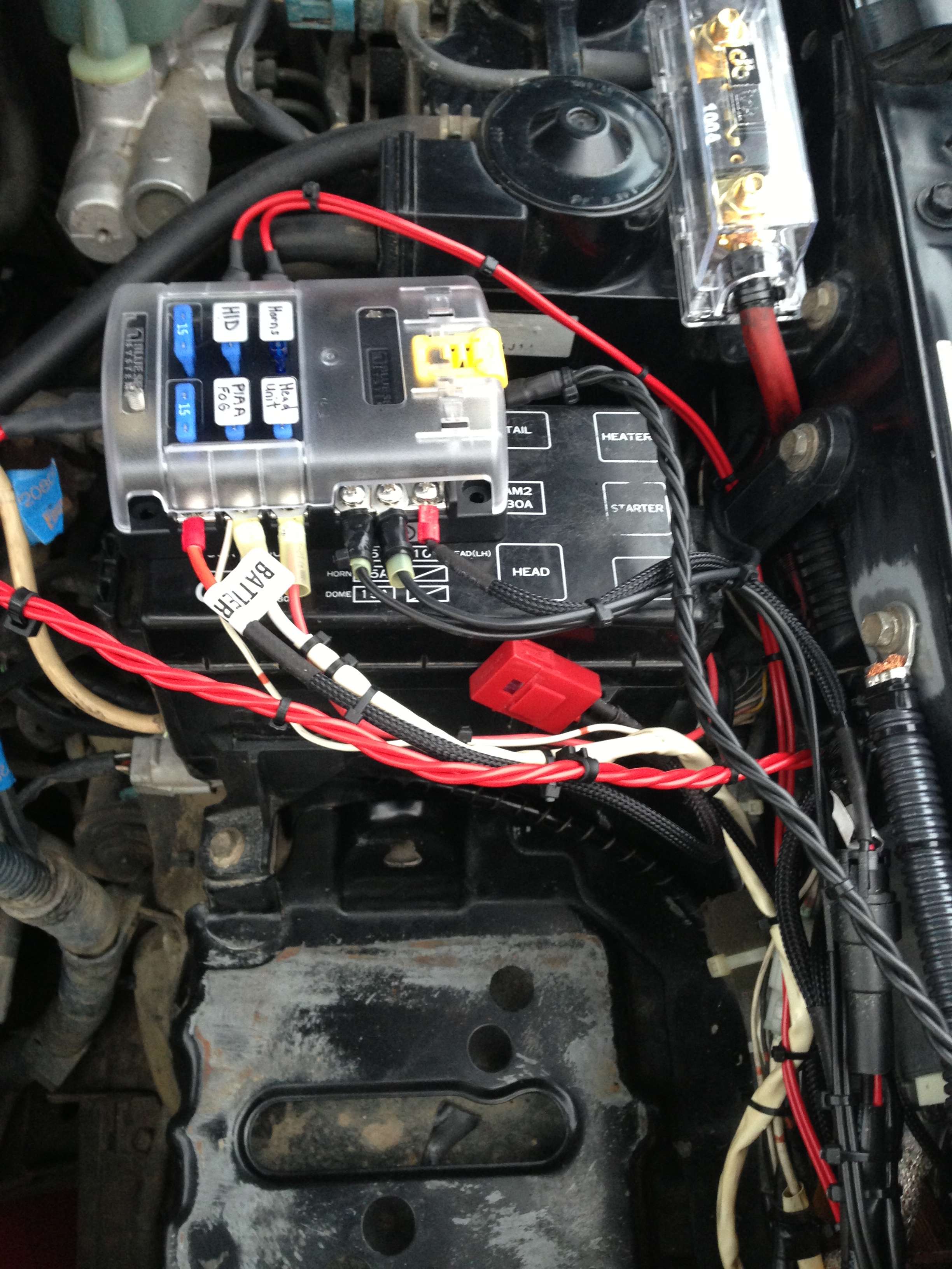

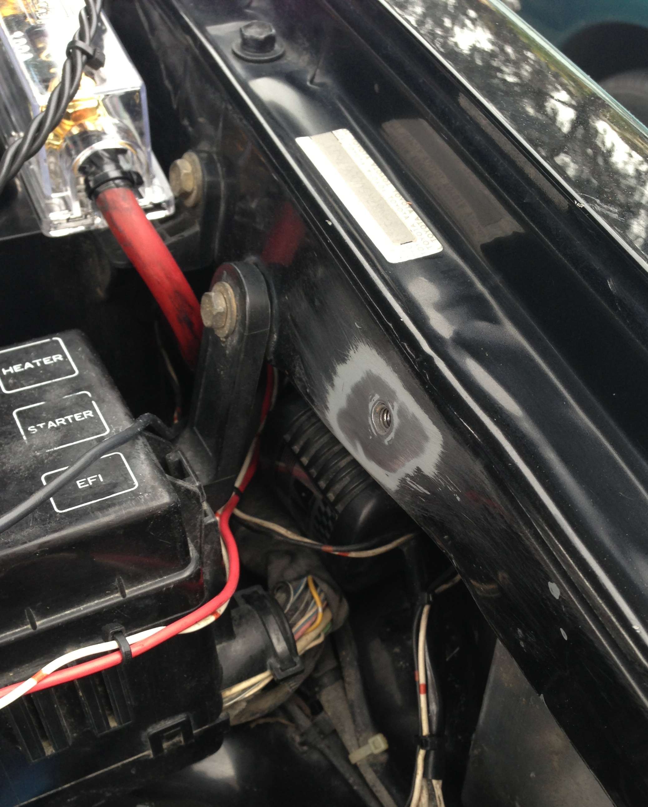

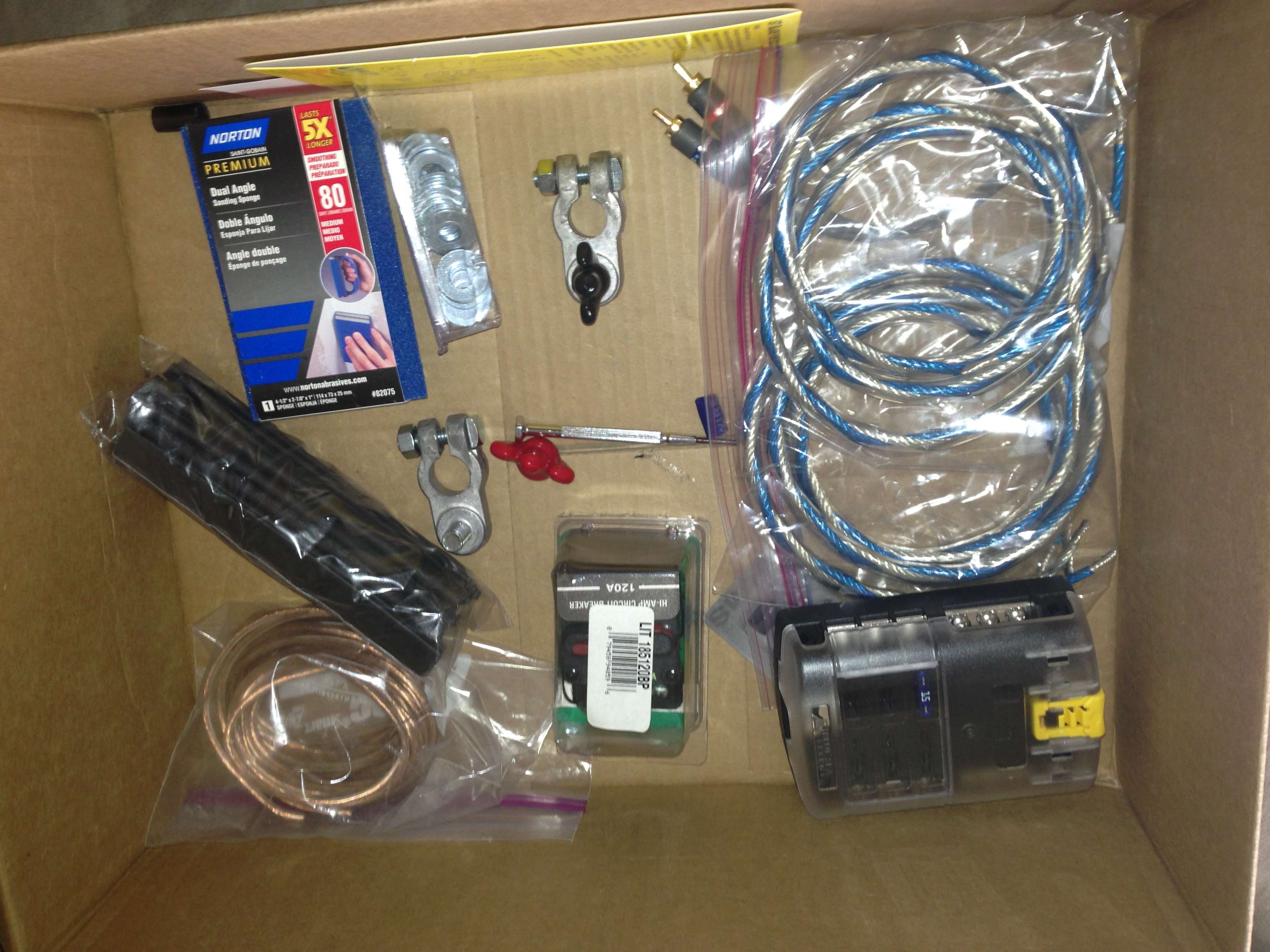

Update - Big Three Upgrade Part I (with pics)

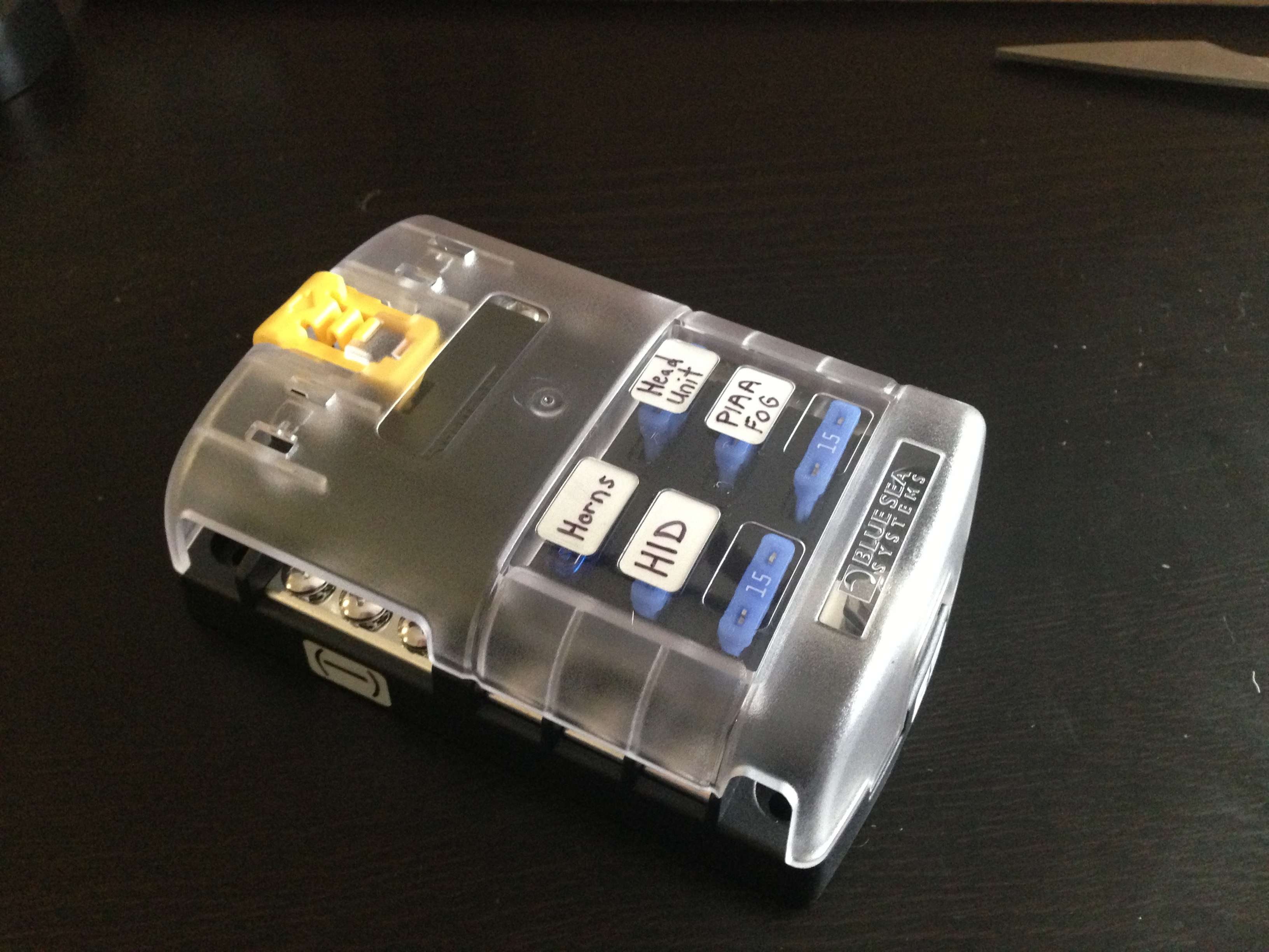

This past Saturday I started working on the Big Three upgrade as well installing a new fuse box for all the electronics I've accumulated over the years.
As you can see from the first picture, the area around my battery was a total mess of wires. I still cringe just looking at the pictures.
Installing the fuse box made a huge difference in cable management plus safety.

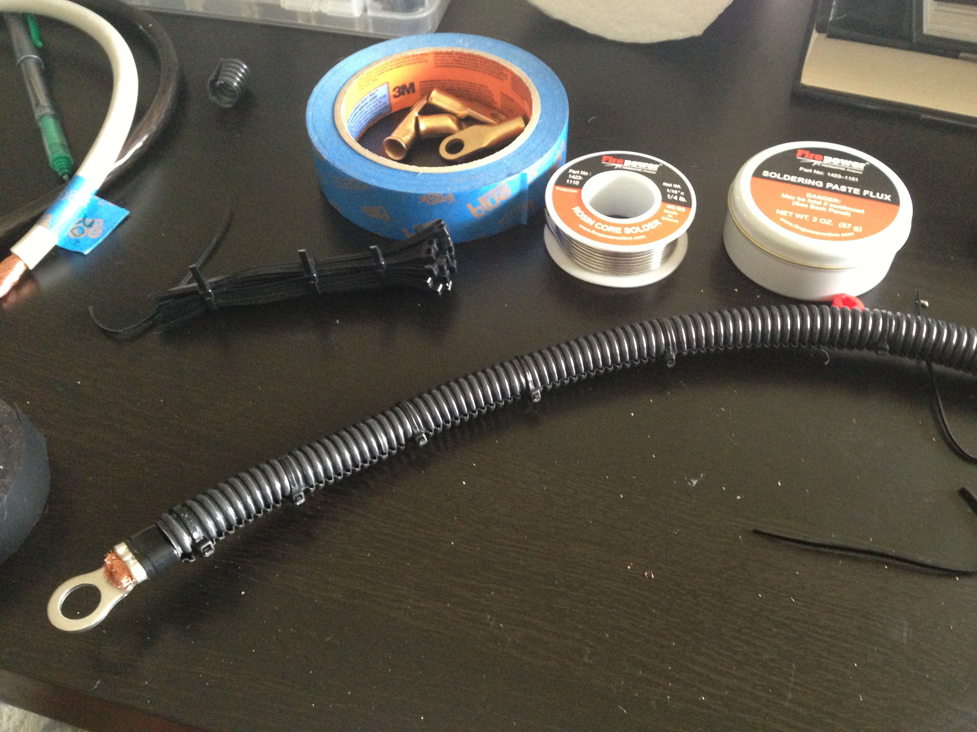

Next is the Big-Three upgrade. I first heard about the Big-3 from BigFishAllDay's thread back in 2012. Since then I have been stalking his rig and planning to do this mod.
Quick Source:
http://www.toyota-4runner.org/3rd-g...wiring-ugrade-3rd-gen-toyota-4runner-how.html
Pictures!
Before:
Setup & Tools (see link above):

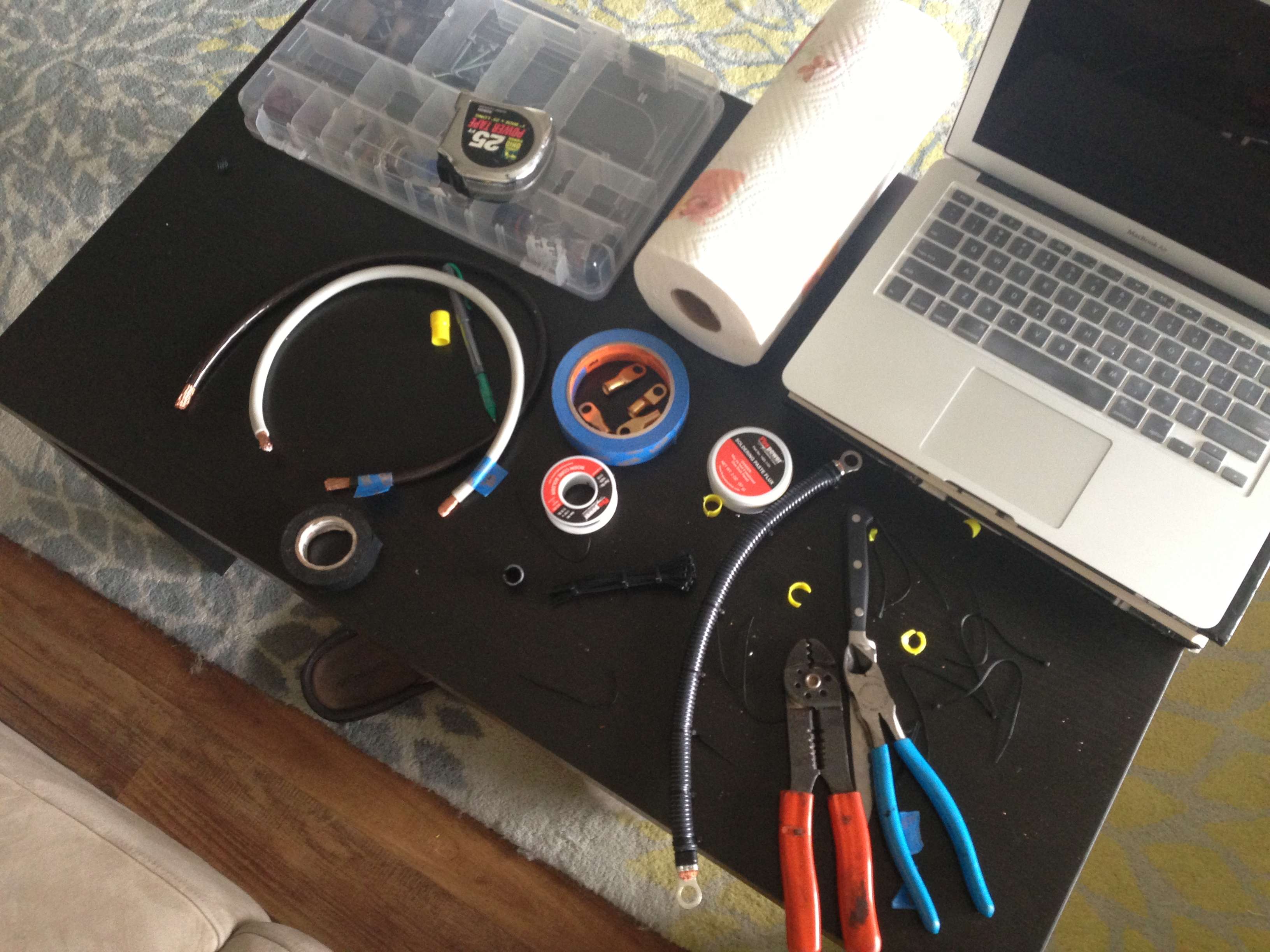

My workbench is my living room :( (side affect of living near downtown)
Prepping the first cable. Not shown: crimping the connector and holding tip over the gas stove for 45 to melt the lead.
First 4-gauge wire completed:
// So ends part 1. I will install the final 2 cables tomorrow and post pics. //

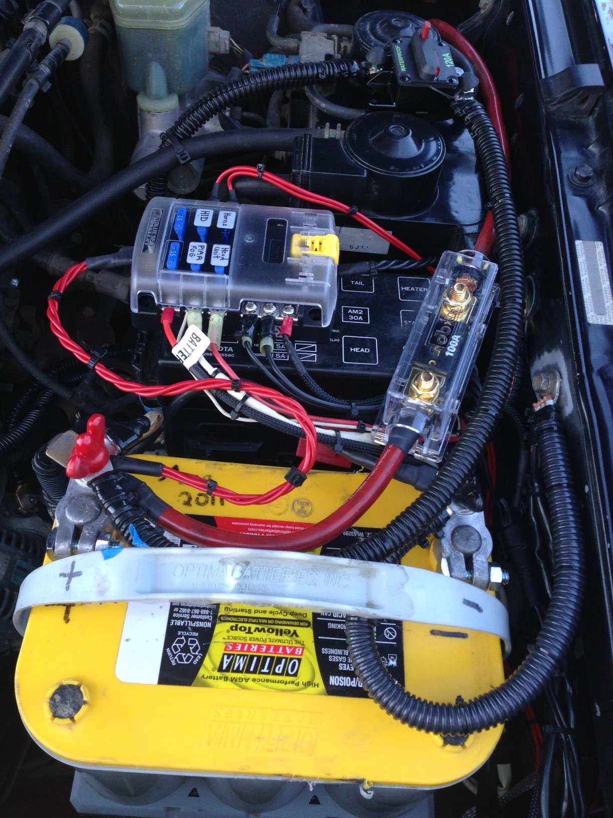

Finished up the Big Three Upgrade today.
All I had left was connecting the 4g wires however I needed to change out a few of my end terminals. I had originally bought 5/16 and needed 3/8. A quick trip to West Marine and I had everything I needed.
Picture: New connections on the alternator
Picture 2: overview of the engine bay featuring my new fuse block, new audio fuse, and new wires.

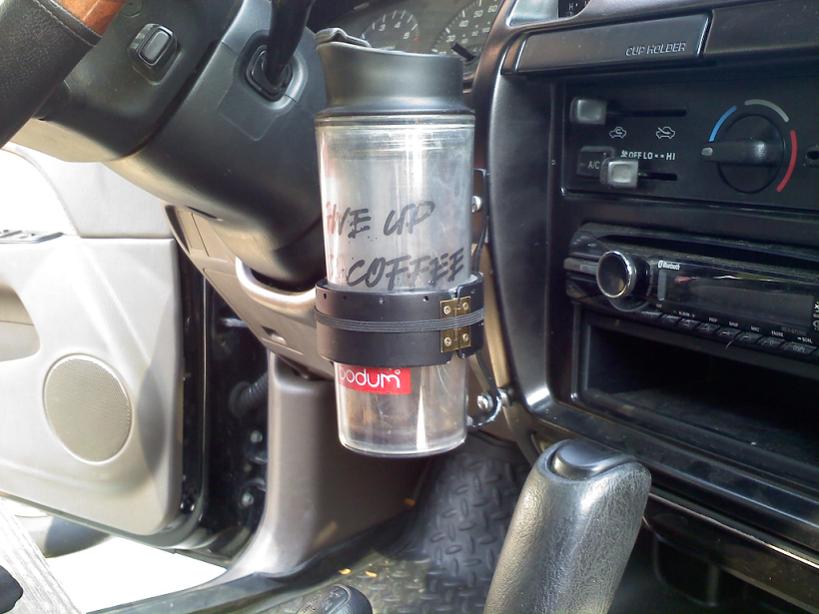

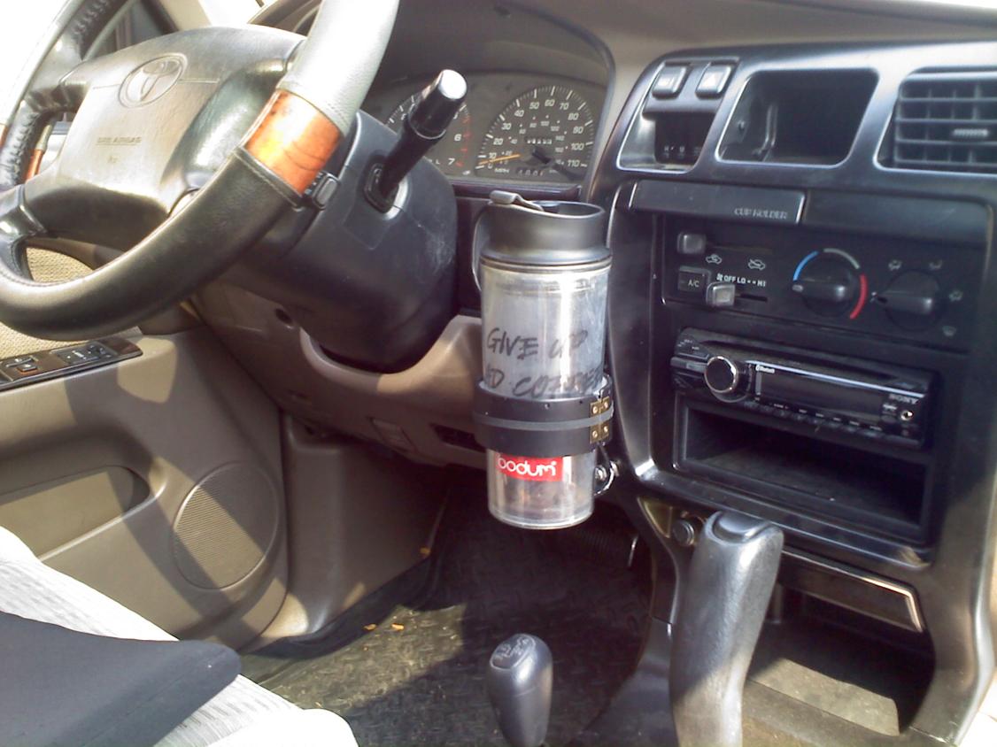

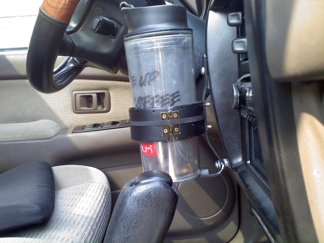

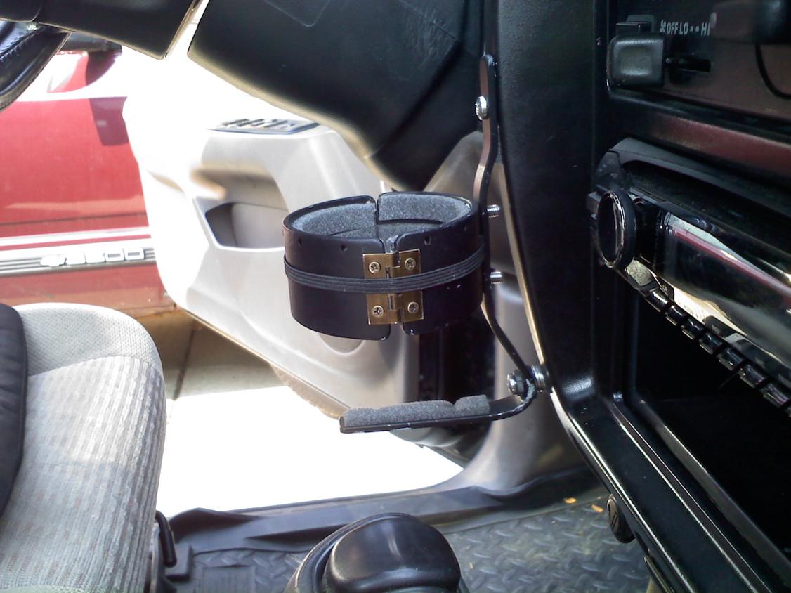

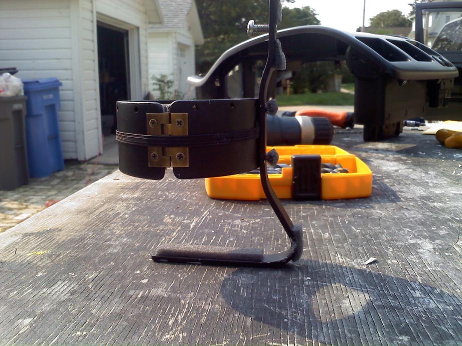

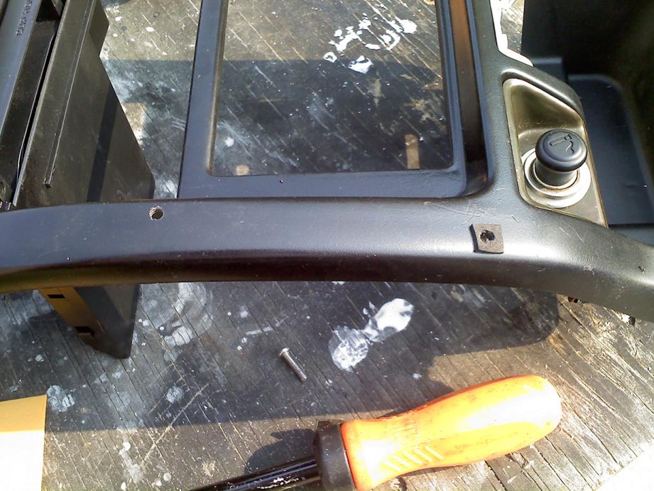

For anyone else with the lazyness gene here is the cup hold mod. Nice job BTW.
http://www.toyota-4runner.org/3rd-gen-t4rs/73462-few-pictures-my-runner-14.html
>>> continued from previous post >>>
Here's what it lookes like with eveything back into place.
And with a large cup in place.
MY CONCLUSIONS:
This little cup holder is sweet! It works perfectly and holds any size cup you throw in it. The mounting is rigid and strong, while the foam allows some cushion. I think it looks pretty cool empty. Its not too big or gaudy. The tension from the cord is perfect. It holds just tight enough, but not so tightly that its a pain pulling the cup out and putting it back into place. No more dealing with the cup sliding all over every time I hit a bump. And the location is perfect. No more blocking the ac/heater and clock. It does'nt interfere with the steering wheel or wiper lever at all, and is at a perfect distance for my short arm to reach. For all of you 96 to 98 guys out there, I think you would really enjoy this little mod. For 3 to 4 hours of work, and $15, it's well worth it!
