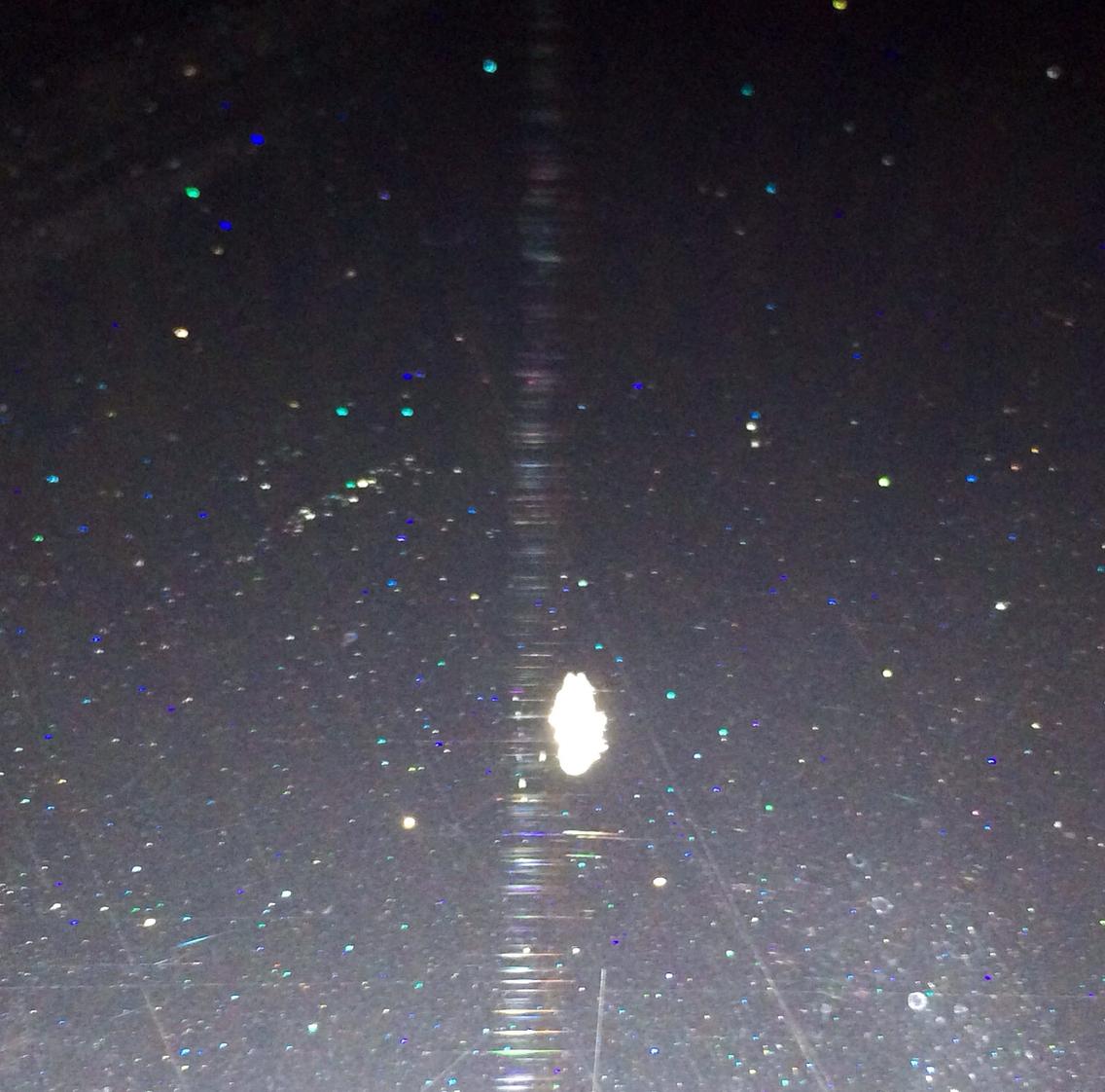

One week in with our '14 LE and a rock hit the hood chipping the paint. It's not bad enough to repaint the entire hood but the Attitude Black is chipped down to a silver/white. When I took a photo of the hood with the flash on, I was very surprised by the color flecks of white,blue, green and silver that you can't see most of the time.
Any references on places to buy touchup paint? Are the Attitude Black pens for the Landcruiser/Camry the same Attitude Black for the 4runner? I'm not seeing a pen for a '14 4Runner Attitude Black listed.

Jesus that has a shitload of scratches for being a brand new truck. I would order straight from Toyota, I have tried aftermarket and wasn't pleased with the match.

Not scratched, just a crappy phone camera with the flash on. The "scratches" are just a reflection from the flash hitting the paint. That was the only way to show the color flecks.
