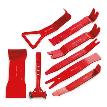

*Get yourself a nice set of trim removal tools like these from Griot's Garage.
