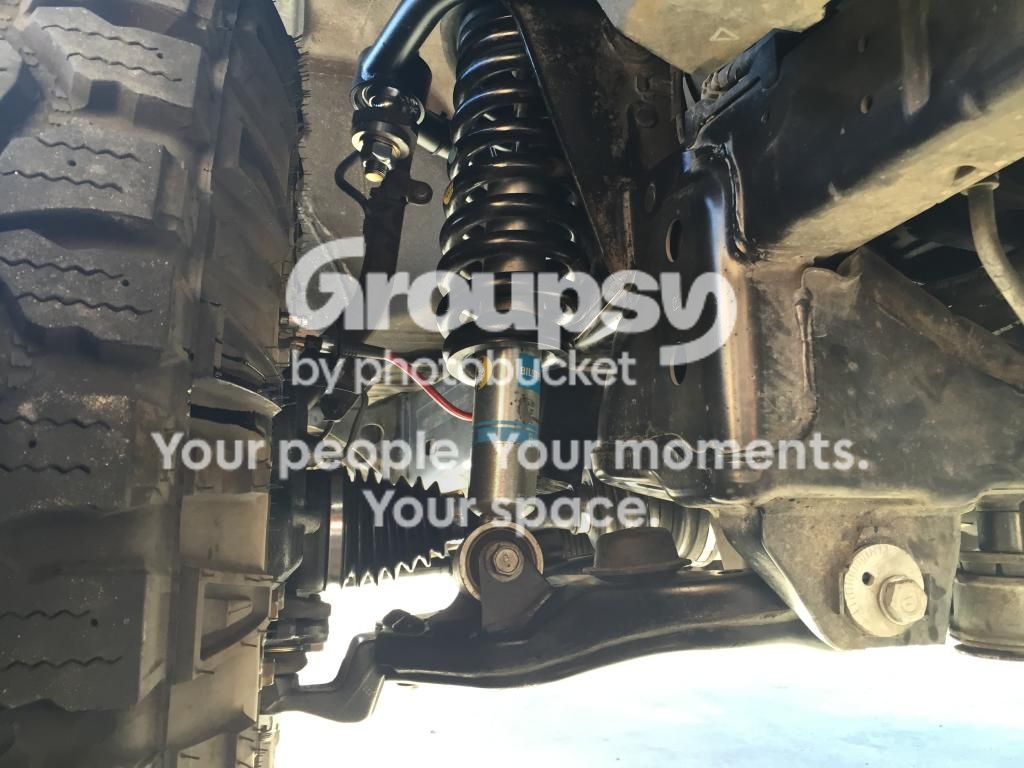

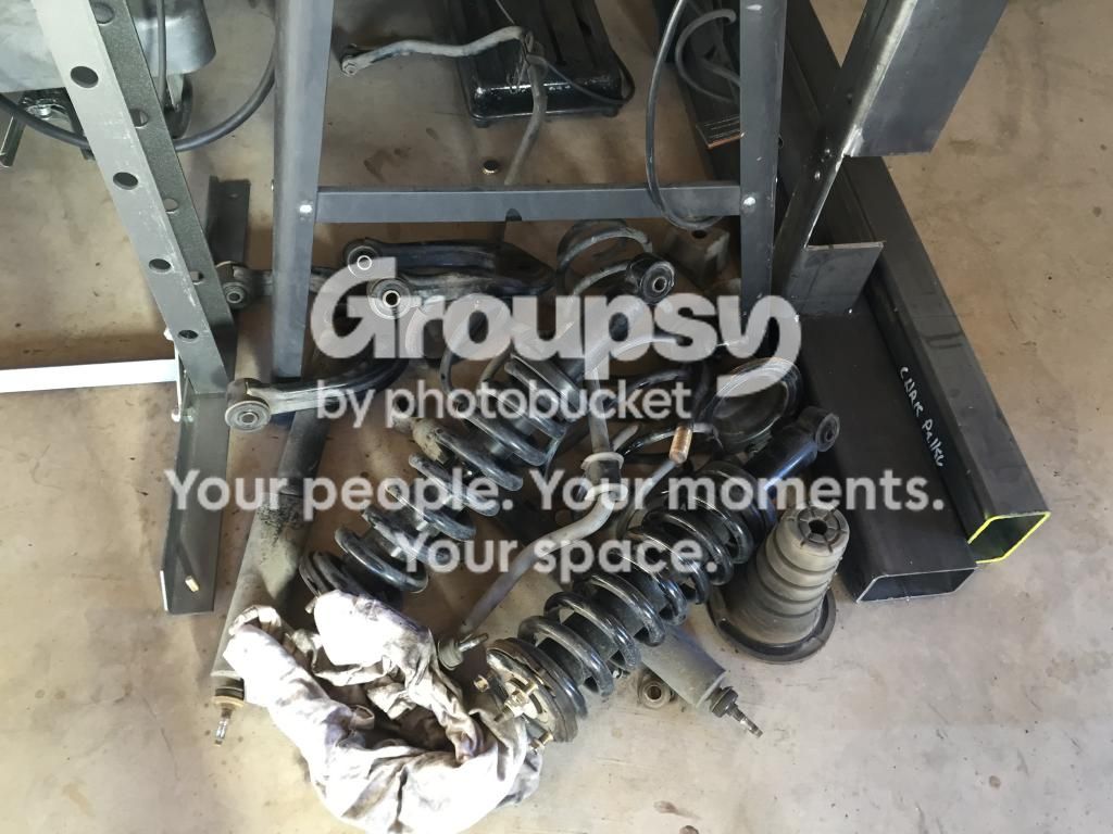

Now for my rig. Big install weekend!!!
- All-Pro UCA's
- Sonoran Steel 1.2
- Outter Tie Rods
- Poly LCA bushings
- Poly Rack Bushings
- Wheelers Brake Lines
- CV's Rebuilt

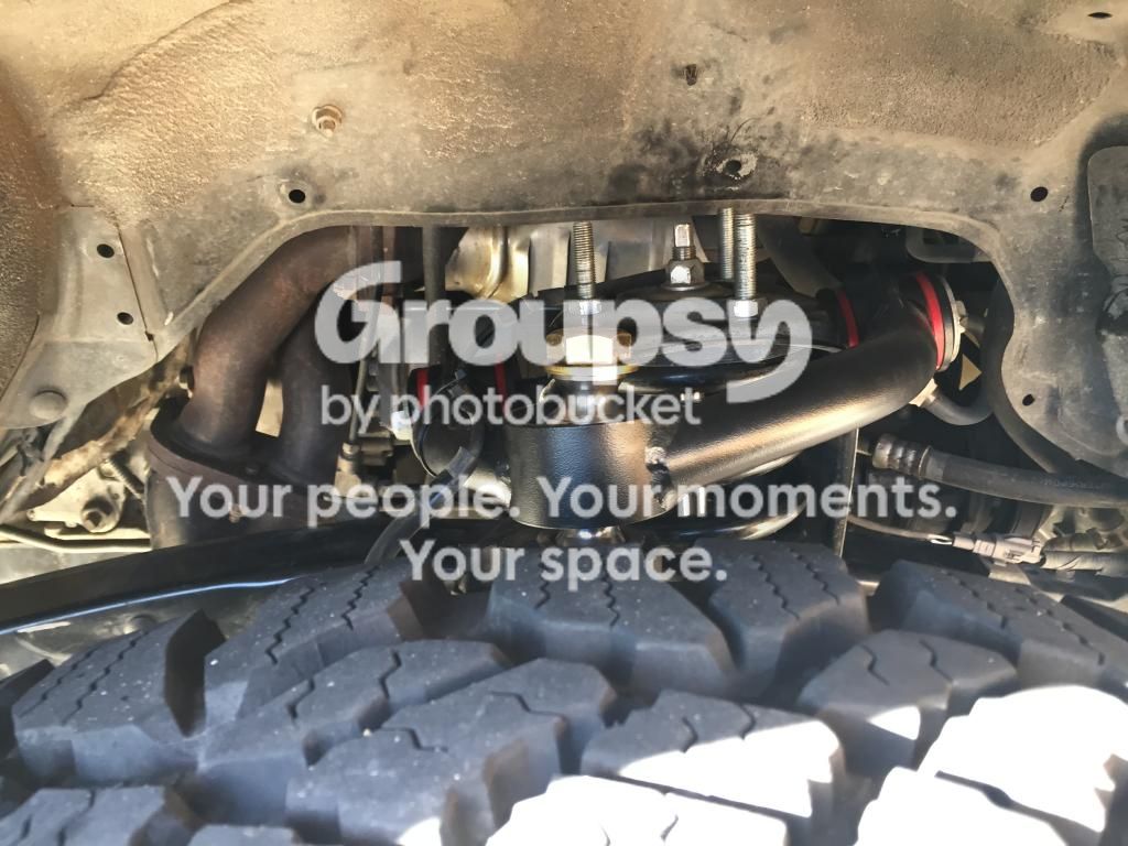

Thoughts:

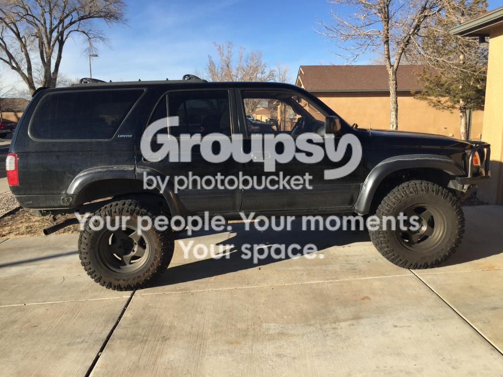

So I will be taking this pig out tomorrow to test it out. But as of right now I have some initial impressions. The front end, it's perfect. It drives straight, firm but not covered wagon stiff, and seems to have nice road manors. The rear on the other hand is a little disappointing so far... It is the LC 7.5 wraps that Sonoran Steel includes with their lift. They are lifting it like 5", and the back feels very bumpy and stiff on the road. I even weighed it down with a spare tire and three sheets of steel in the back and the rear is still really high and bouncy. I will be ordering ToyTec's long trail coils up for this thing as I really wanna see the rear end come way down. I will make my final decision tomorrow after my trip but so far it's not what I want...
So I would say yesterdays trip was a success! 4runner did well and the only issue I had was the weight on the drive shaft contacted my factory gas tank skid. Easy fix, a little beating to move it over and no further problems.
Thoughts on SS 1.2 kit: So I have mixed feelings, the jury is still out on this one. The rear is still sky high. I was hoping that after a day of trail use it would settle a little more. At times on the trial it looked as if it settled, but when I got home from my trip it still measured 41" from ground to fender, which is where I was before... And also, surprisingly the front seemed to settle about 3/4". I have the shocks set on the first setting. I am going to clean my rig and move the springs to the 2nd or maybe 3rd setting and see where I sit. I don't wanna go too high. It's at 37.5" right now and I wanna be closer to 39".
Also, I ordered up a set of ToyTec superflex coils for the rear. I want to try those as well and see where it sits. My goal is to have a level truck, or at most 1" up in the rear. I still need to finish my rear bumper and get all the back stuff finalized to see exactly which set of springs I will run for the long term. I do have 3 4'x2' sheets of steel and a spare tire in the back to simulate that right now (at 41") but I am hoping it will go lower once I hang that weight off the back more. I like that I will have 2 sets of springs to play with here.
Also, I will have a more detailed update coming in the next week or two. I have done a bunch of little things and will be doing more work.
A truck like yours should be running the middle notch. No one runs the bottom notch. Stockers run 1 up.
It will work a lot better if it is installed the way we designed it. Kind of a problem with a used kit. Once you build a rear bumper, the rear will drop quite a bit. The 80 coils will. You will have to ask Toytec what their springs will do, I don't know.
So adjust the parts as they should be and re-call the jury.
Thanks for chiming in. Used is never as good, but sometimes you have to make sacrifices...
I popped the front coilovers up to the 2nd notch, I think there are 4 or 5? That seemed to really help with the stance. The front rides nice and I don't have any solid complaints yet, just not picky stuff as anyone does. I may pop up to the 3rd, we will see...
The rear I took off the 7.5 wrap LC coils for now. In it's current situation they are just too tall. But they are on the shelf and once I get the full load on the rear I plan on testing both since they are relatively easy to change. For a stock weight rear end they are just too high... But we will see where I finally do land. The rear shocks work very well though.
Still open to see how everything does and so far I think you have a great kit without going full 2.5" shocks. It is hard for you to make a one size fits all kit when we all have different stuff haha.
I still say you should run the 3rd Middle Notch. I would also swap out that goofy top plate with the really long spacer studs for the one that came with the truck. While your at it. Make sure you use the factory toyota top cup and lower cup with a new upper bushings, this will avoid the limiting straps. The factory cups, suck the shocks up just that tad they need to not be too long.
Move the poly seat over to the other stock top plate and I can give you the part number for the top busing we use, it is not from a 4Runner. Email me if you need that.
I don't know who bought that one, but they put the front together too low. It is also a newer one from after I went to the Chilli Challenge it has those changes in it.

Funny you mention the top cup. I changed it out with a factory one I had when I adjusted the springs to the 2nd notch. Just been too busy to post a quality update on here. If you wanna PM the part number I will check out what you are saying, for some reason I am not able to invision what you are talking about... If you have them, shoot me a quote too please if you don't mind. I probably need it because as I was putting my shocks back on I noticed that the All-Pro UCA's are topped out and the shock barely fits in there.
Who I bought the kit from... some guy, and a few things were missing that I had to make myself (e-brake extender, brake line fittings, etc). Risk you run when you buy these things used though, what can you do haha.

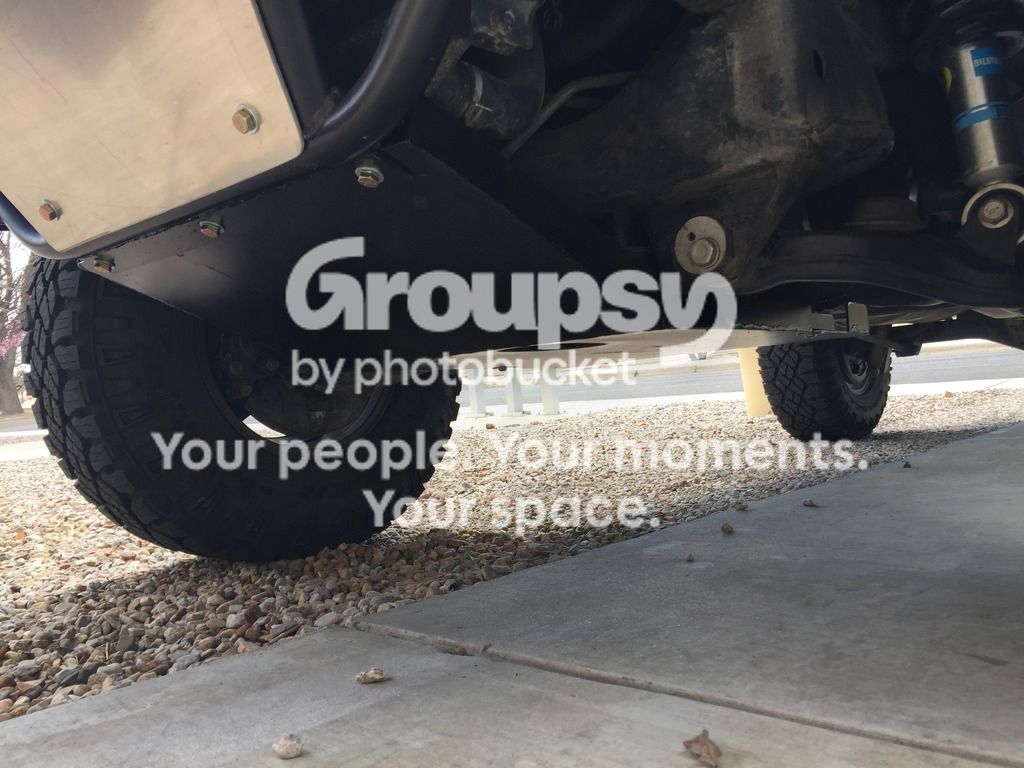

Front bumper got a major overhaul. I posted in my bumper build, but was waiting to add to this one. Added an 1/8" aluminum skid with dimples. Also I took the LED strip blinkers out and added the standard optical eye looking ones. Did some various clean up on the thing and re-painted it satin black. If I like this I may end up getting it powder coated some form of this color down the road.
Other small stuff, got the GT seat covers installed. These are very nice leather and look stock. I am a little too dirty for these haha... I may end up switching to Poly ones later. But not because they suck, I am just ruff on cars.
Lastly, finished my front skid. This is all 1/8" steel plate. IT has about 8 ribs in various spots to keep it rigid. I know it won't stay straight from the big hits, but I am not a big rock crawler and this things will offer plenty of protection. I won't be sad if it gets tweaked, haha.
