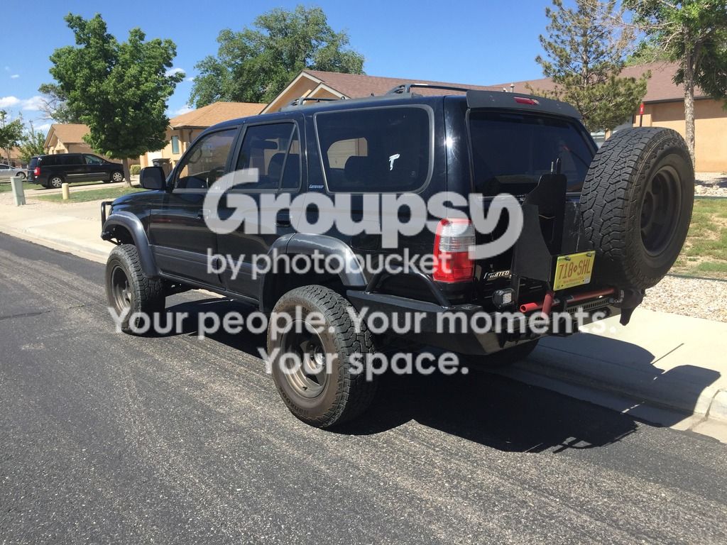

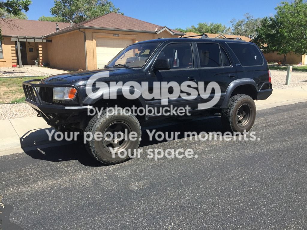

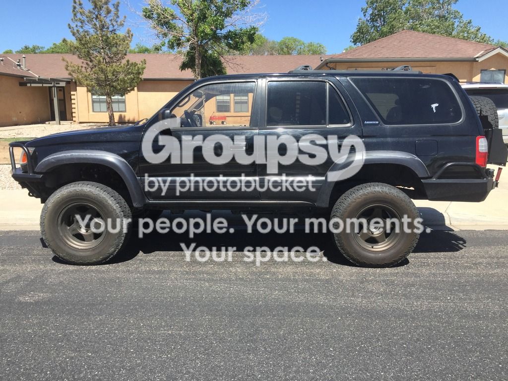

I'll snap a picture of my 4Runner today.
