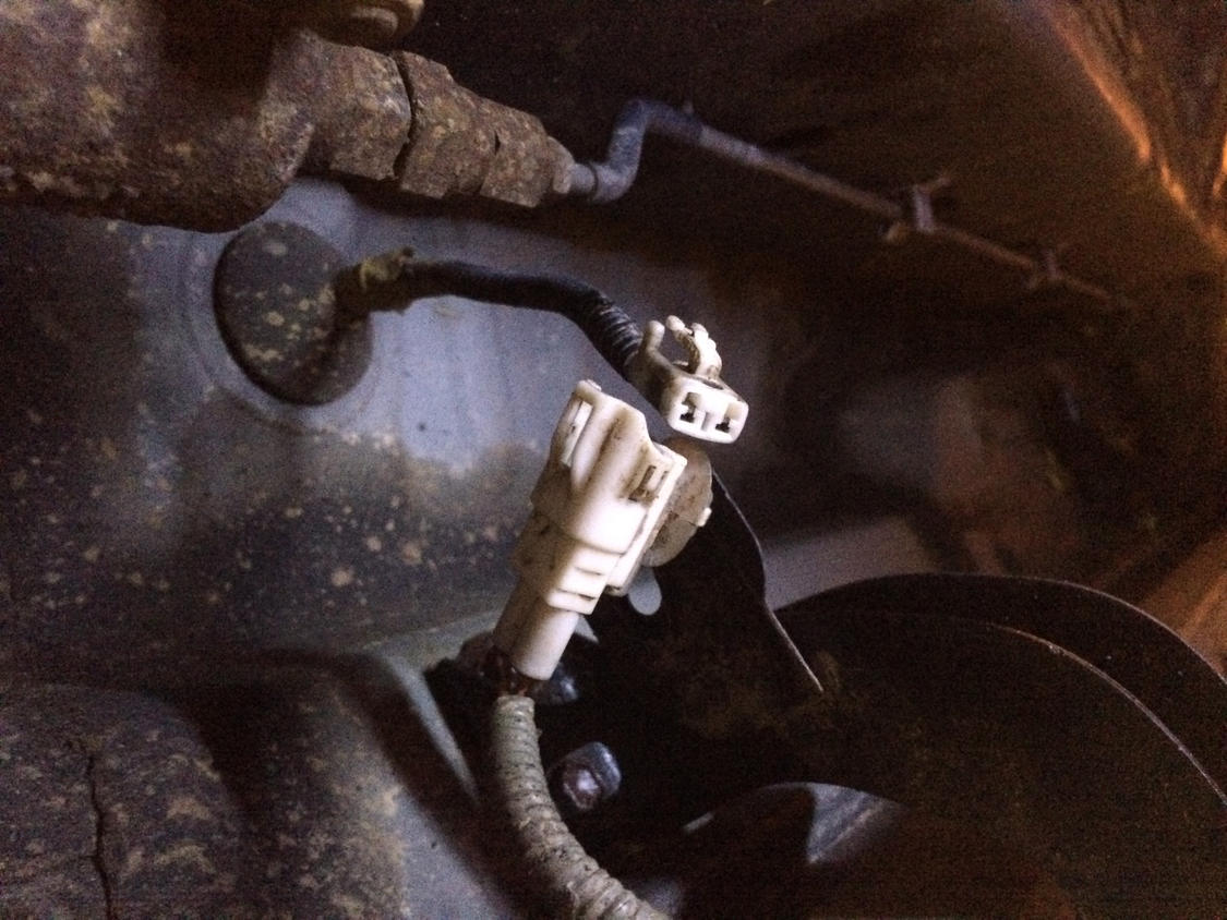

Hey Momo! Quick question for ya. I just pulled my lighted running boards off of my 03 Limited and I am looking to add back those courtesy lights cause they are really useful. I am thinking I am going to do something very similar with those low profile Eagle Eye LEDs. How did you wire them? I know they simply have a positive and negative, but is this (see photo below) what you cut and then tapped in to for the lights to come on with the doors and stuff? This was a cable coming from my 4Runner connected to the lighted running boards. Thanks!
thats what you use
thats what you use
Ok. It has a red/white and solid red wire. I am assuming red is positive and red/white is negative as with most wires on the car. Do I just snip that old connector off and wire the Eagle Eyes together to the existing wires?
hope you have done something like this before. sounds like you have never done electrical work before
I've done electrical work before a lot. I have just never used these little LEDs and never knew about this little connector coming out by the running boards. I'll just wire it like I think I should and see how it goes.
Do you have any problems with them overheating/loosening the tape? I was looking at those before the little LED bolts and a lot of people complain about them getting so hot that the tape on the back melts and becomes useless.
I haven't had any issues. The main think is to prep the area really good with some denatured alcohol. They have worked perfect for me
