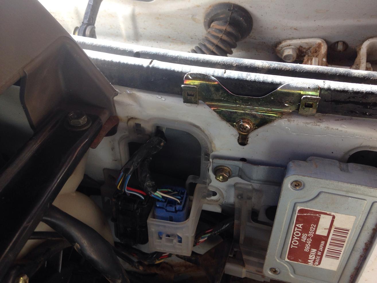

So I searched the forum an did the normal unclog drain holes for moonroof. Ran weed wacker line through it, blew air through the holes. They are not clogged water runs through. On my passenger side I see the tube go down the top (a) ? frame to the glovebox area. The line that goes down that way seems to end just about the glove box level ... I can see end of drain tube there just letting the water flow out... Is it disconnected inside that metal body panel?
Is that normal. Where is the water so pose to flow down an out to? The water is dripping out by the heater thing at passengers feet an edge of door jam.
In the picture it's leaking in the opening above the toyota abs, where the wires go into the side panels next to glovebox. An drips down on all those components an the ground of my truck.
You can see a bit of water dripping off the glove box.
Major frustration. Any advice or help would be great. Thanks.

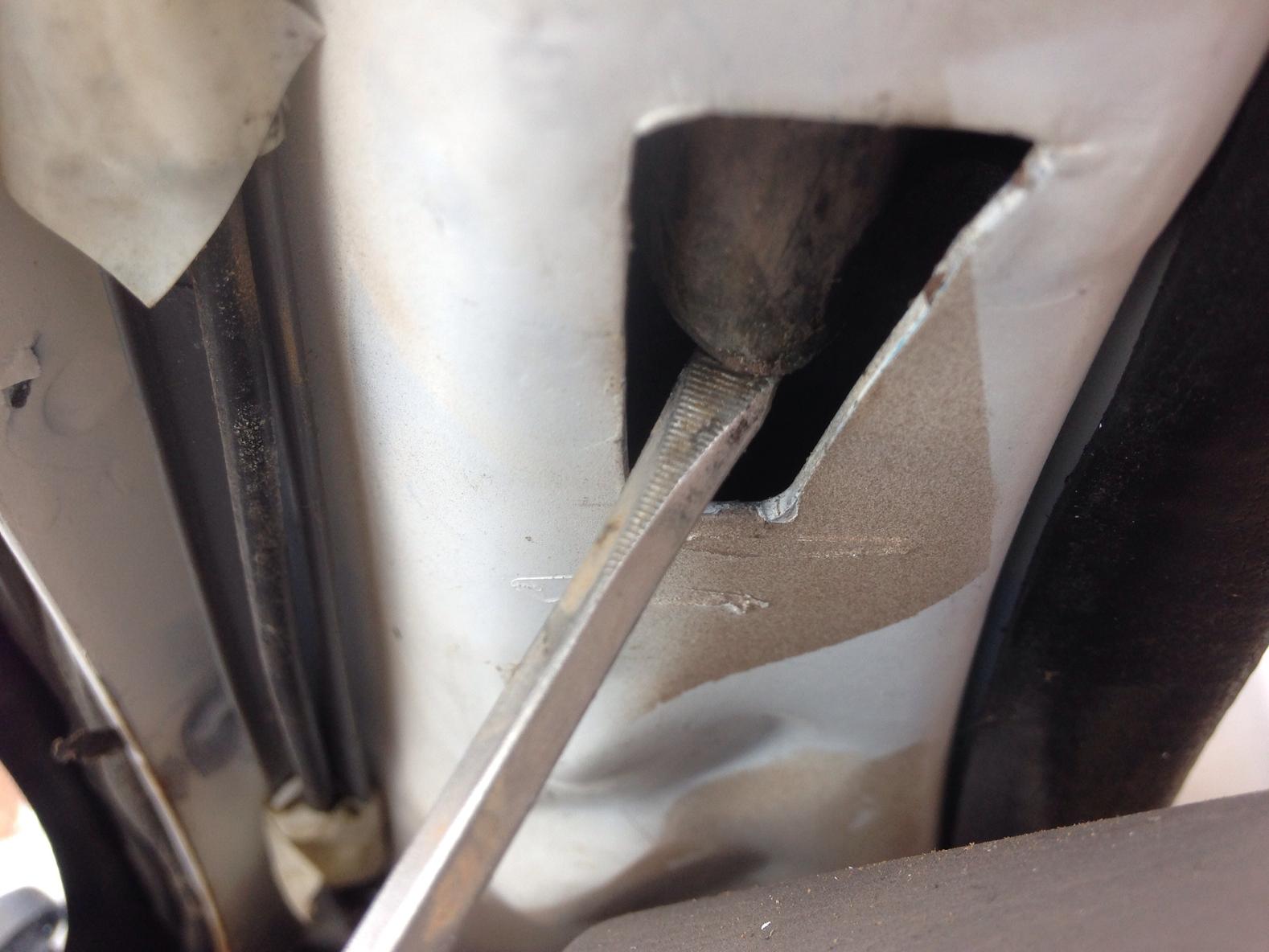

Here is where the hose ends right at the dash level. Is it missing tubing, break. Talked to a friend who thought it's suppose to go all the way down.....
Well I looked at drives side too. It seems both sides the drain tube only goes down to the dashboard level... That can't be normal. ?!!
Then drips to drives side foot board an on all the electrical wiring.

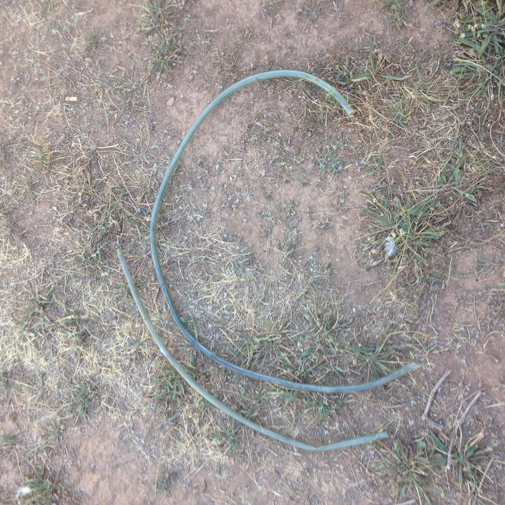

Fixed leaking moonroof
Since it's summer an I don't want my moonroof leaking anymore I went ahead an grabbed new drain tubes from pick an pull. My old drain tunes where clearly not long enough.... Wtf. But problem solved pulled he old one out an slide the new tube in. For others having a leak issue check that your tubes go into proper hole in kick foot panel. Where it will drain out of the vehicle, an not into th carpet. Success!
