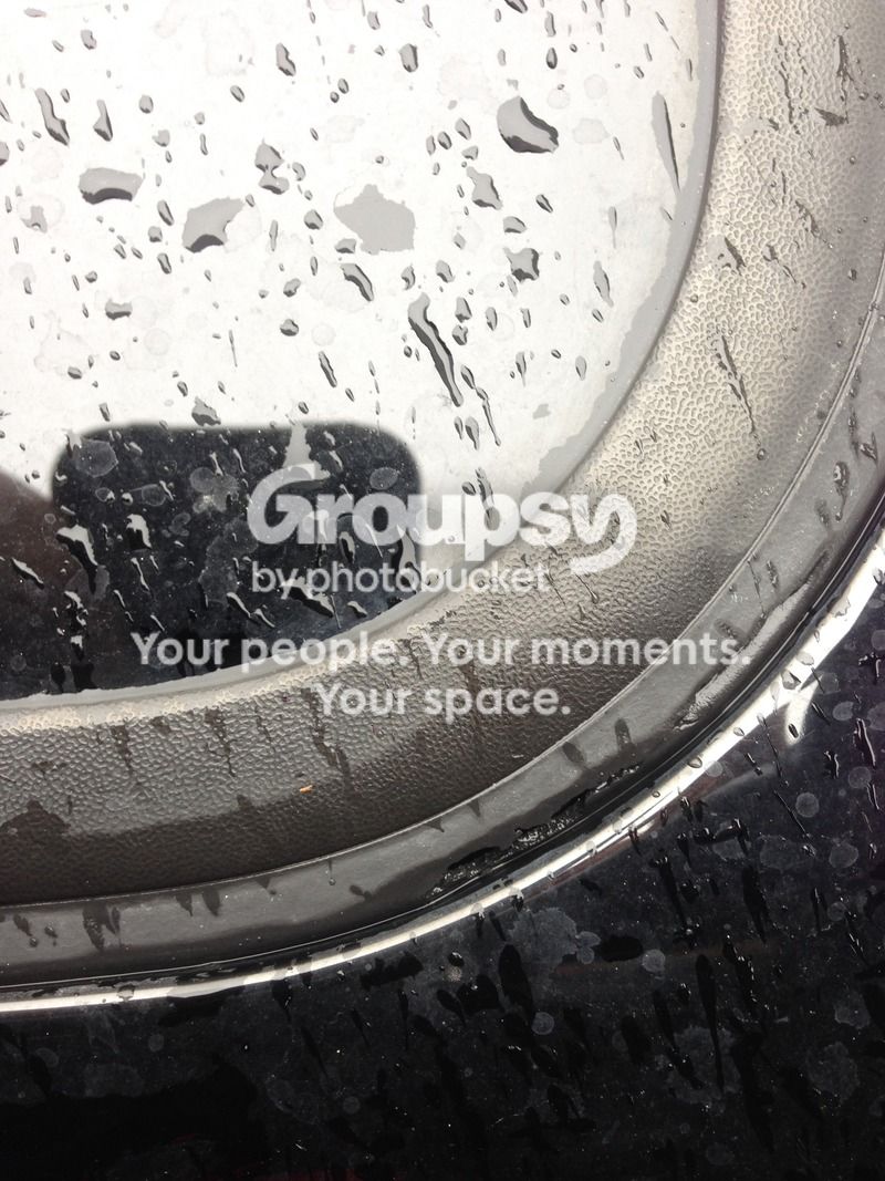

i have definitely determined that mine is leaking between the glass and the plastic bezel that all the brackets mount to. the drains are clear - at least the front ones - and you can see from the pic where the leak originates. it is then dripping down onto the headliner. if I park at just the right incline in a hard rain it'll actually fill up the compartment below the e-brake. haha
017.jpg~original
my plan is to remove the sunroof from its bezel and silicone seal it back in place. it's not going to be an easy job, but I'll try to take pics as i go.

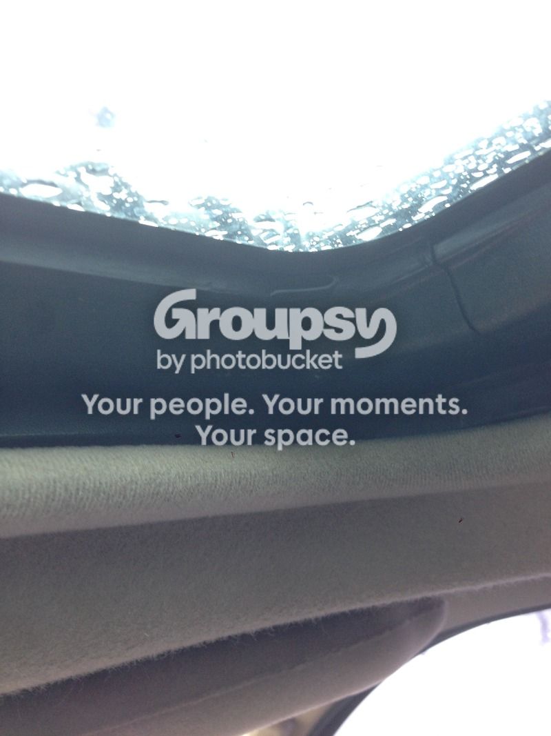

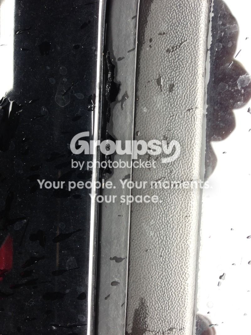

Mine's leaking too. Mine's leaking from the gasket around the glass and is leaking inside along the glass edge.
image_3.jpeg~original
Checking the gasket I found these holes
image_1.jpeg~original
image_2.jpeg~original
Any suggestions besides the $587 for new glass from Camelback?
