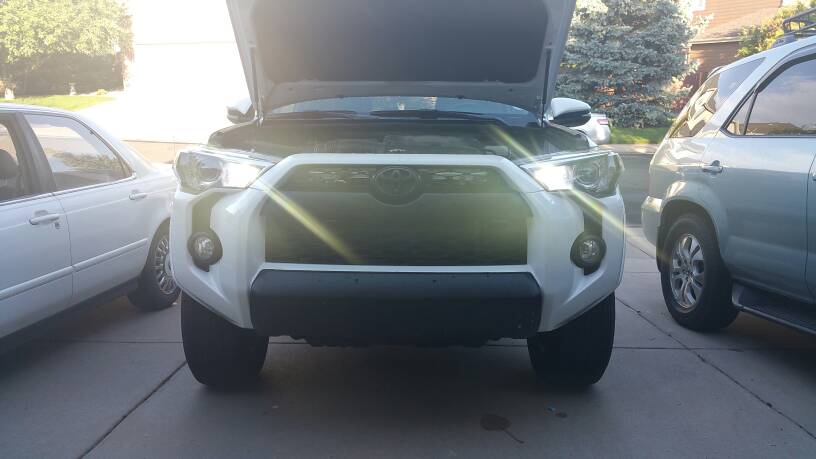

I have them. They are a tad brighter than the halogen. But I don't mind it as it's doing it's job as a drl. 20160715_183744.jpg

One thing though these you notice the light pulsing of led. Because of the pwm trying to tone the brightness down for the drl. Not sure if that is same for saber. But stupid bright as high beam. I love it
