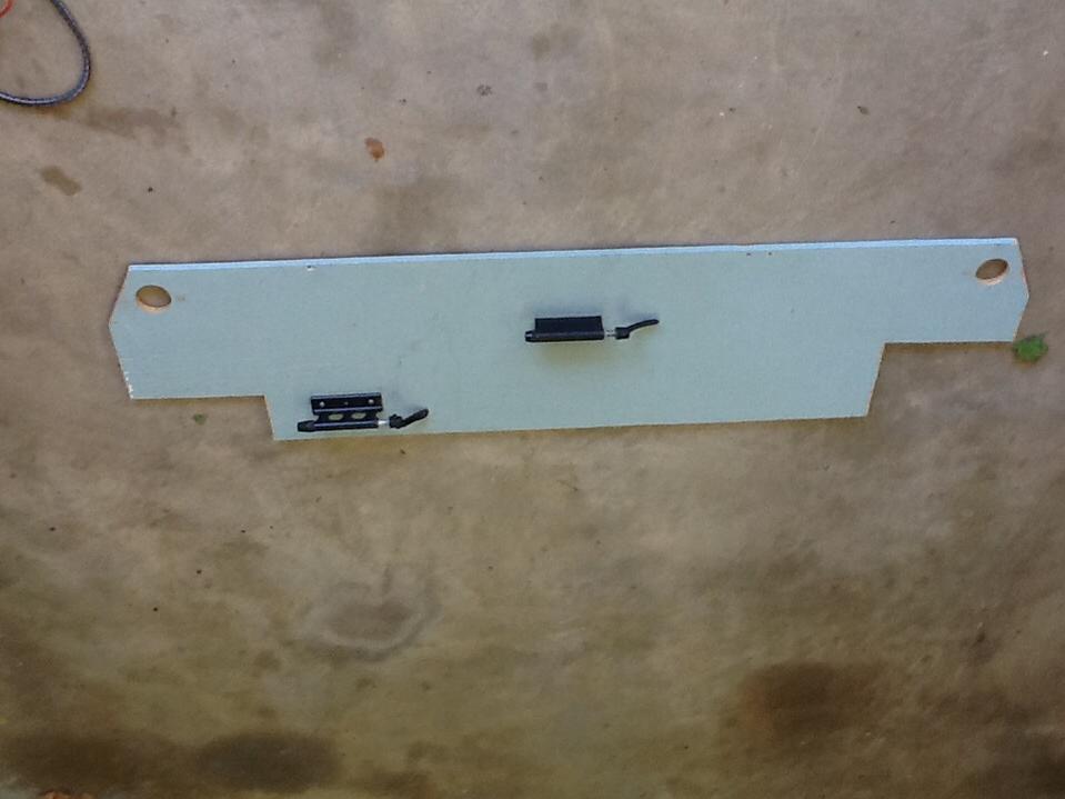

I cut a board to fit the width of the bed in the back. Cut holes where the rear tie downs are and stretch a bungee between the tie downs to hold the board in place. Fork mounts are installed on the board to hold the bikes upright. Be sure to use all three holes in the fork mount and largest wood screws that will fit. Works great. Have used this for many years.

cut board based off floor mat. two layers of plywood, bike mount, used a carriage bolt so it would be smooth on the bottom and not rotate when bolting the mount down. wrapped in fabric and addad mounting spots. i dont even bolt it to the d rings anymore. the fit is perfect and it does not slide

Here's a pic of mine. Simple and easy to store. I run a bungee between the tie downs. I do like the carriage bolt suggestion above.
