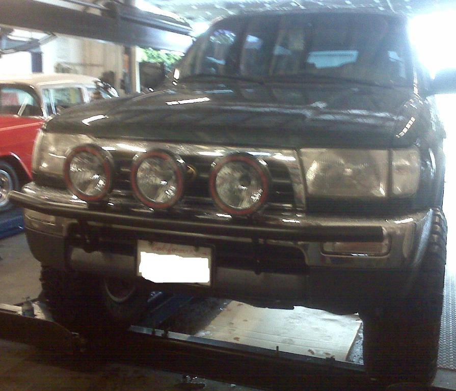

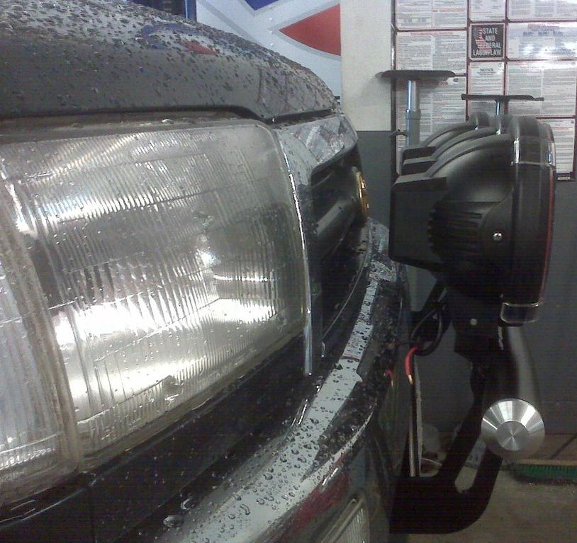

His bar is very sturdy. You can't move it even if you tried to shake it with yours hands. The bar is actually attached to the frame, which is why it's so solid.
Correct on the lights. His 2 centers are the long distance focused beams, and the outer lights are driving lights.

i have found holes in my frame that I planned on using for blaires setup. Good to know it's pretty solid. Where can I find one of those light bars?
Also, why the pinspots in the center?
He got his from Defiant. I was about to get one myself, but now I am fairly sure that I will be getting a Shrockworks full front bumper in the next week or two instead.

Everything Josh said is 100% correct. I have the spots in the center b/c they really throw light straight down the road well, and the other ones light up where the high beams leave off, basically. I figured I don't need a really long distance beam in the direction I am not traveling.
The bar is very solid and the lights there don't shake, the ones on the roof on the other hand do move a decent amount. I will try to get some night shots soon, I just put in 100w bulbs into the Hella 500's yesterday.

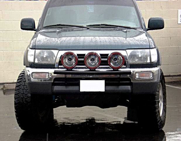

but I have a 3rd gen, and Paul at Defiant recently finished my light bar...I opted for the longer version. These are my cell phone pics, but he has better pics up on his site.
