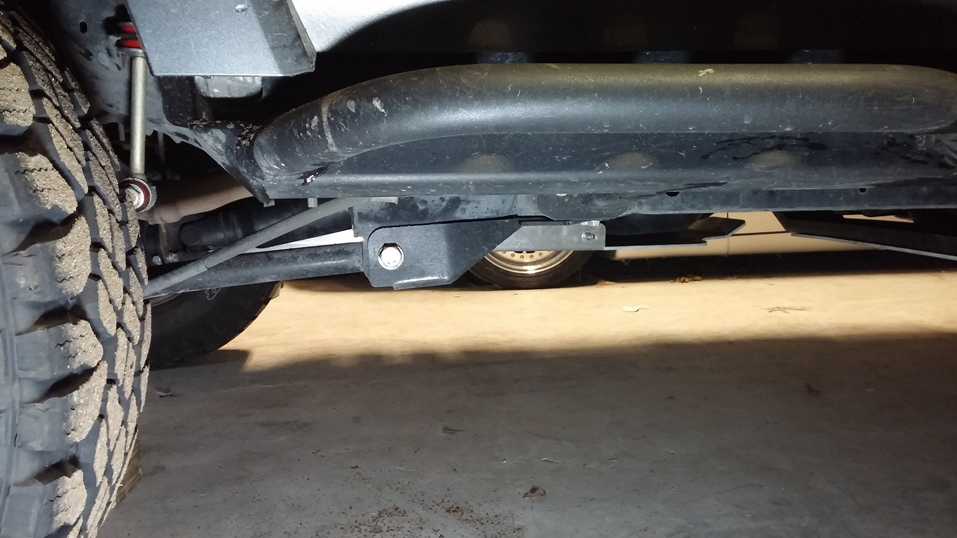

Here is a pic on the passenger side to explain. The slider is higher than the bracket. When I'm going up a ledge the brackets often hit and then everything clears once a back tire (usually the on the other side) starts to climb. I get no contact when I can get a solid angle of attack, but sometime s the trail is too narrow to allow my big best to do that. I'm going out tomorrow, so maybe I can snap an actual video or pic of the situation.

Don't know if you can tell really well as I've not climbed under at full flex... But you can kinda see what I've got going on.

I can see where your fuel tank skid is helpful on the driver's side also. But what about the passenger side? There's nothing hanging down that low over there but the forward LCA mount as far as I can recall. I'm off to read your build thread and see what it says....

I can where your fuel tank skid is helpful on the driver's side also. But what about the passenger side? There's nothing hanging down that low over there but the forward LCA mount as far as I can recall. I'm off to read your build thread and see what it says....
Lol. Passenger is more exposed but the muffler takes the brunt of it. I don't have a pic that shows it but I'll get one.
I would not call those rock sliders, I would call them rock skis. :lol:
For those of us with sliders, the passenger side is vulnerable at the mount. Would like to see what yours looks like on that side bim. Take a close look and see if it has been hit... Your skis may protect it.

Looking at it on my passenger side it does look like I could hit it hard. I just haven't yet. I think I favor that side since I can't see as well so tend to take the hits more on the driver side to protect my muffler and driveline and therefore have not crushed the mount. Maybe I should armor that bad boy! Thanks for pointing it out! I didn't take a night shot of it because it is pretty useless to do that. :)
