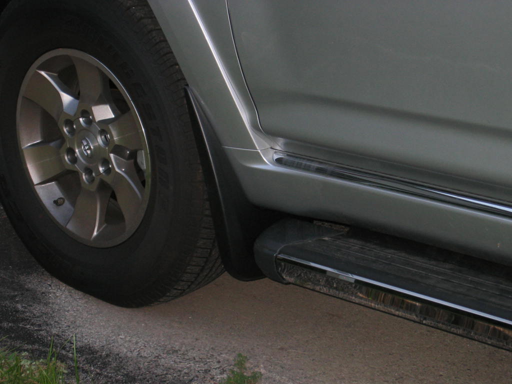

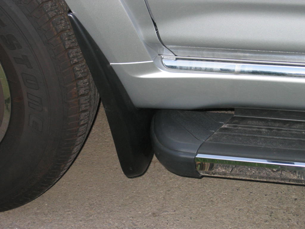

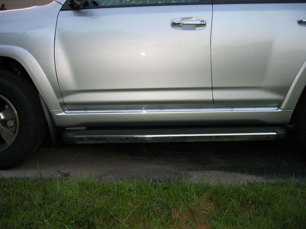

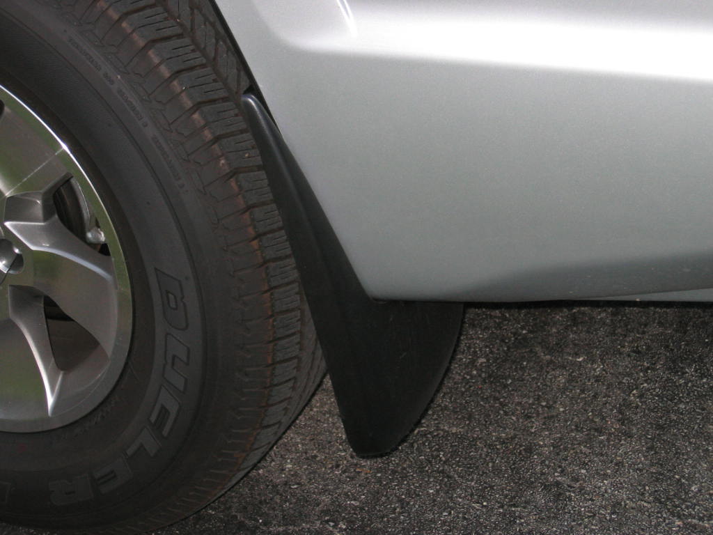

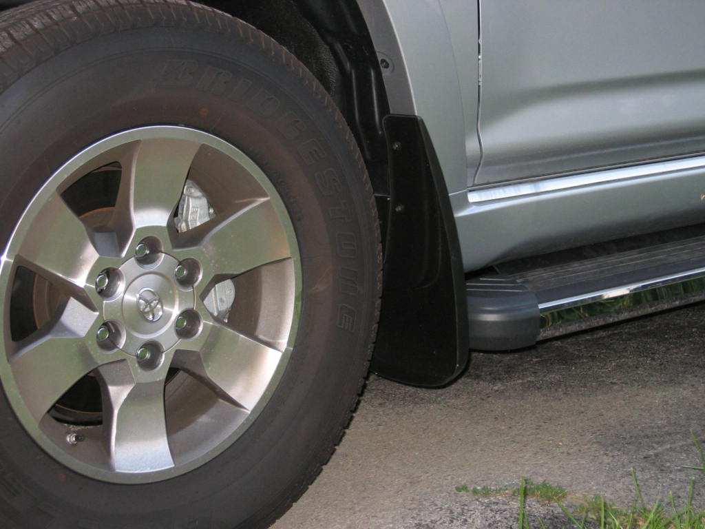

After being the first person to order the Husky mud guards and have them sit in my house for weeks, I finally got a chance to install them over the weekend. The big issue holding me up was the SE Toyota running boards. Since the mud guards interfere with the front of the running boards I new it was going to be a lengthy install. The rear mud guards went on very easily and I didn’t even need to remove the rear wheels (just needed to use a small ratchet with a screwdriver tip for one of the screws. The biggest issue for me was installing the clear protective tape (I just personally don’t like installing stickers and stuff like that). Without the running boards, the fronts would have been a breeze to install. Unfortunately, I had to deal with the running boards. Here’s what I did.
1. Remove the running board from the brackets
2. Remove the two screws holding the plastic end caps on (one screw on each)
3. Slide the end cap off of each end (may need a tap with a mallet)
4. Slide off the rubber seal that seals the running board against the 4Runner
5. Slide the rubber grip top several inches off
6. Set miter box to about 27.5 degrees
7. Cut off 1.75” of the aluminum extrusion and deburr
8. Cut 1.75” off rubber seal and grip top
9. Slide rubber seal and grip top back into position (water and soap will help them slide)
10. Replace end caps
11. Drill new hole in the end that the cut was take from and reinstall the two screws
12. Reinstall the running boards on the brackets.
