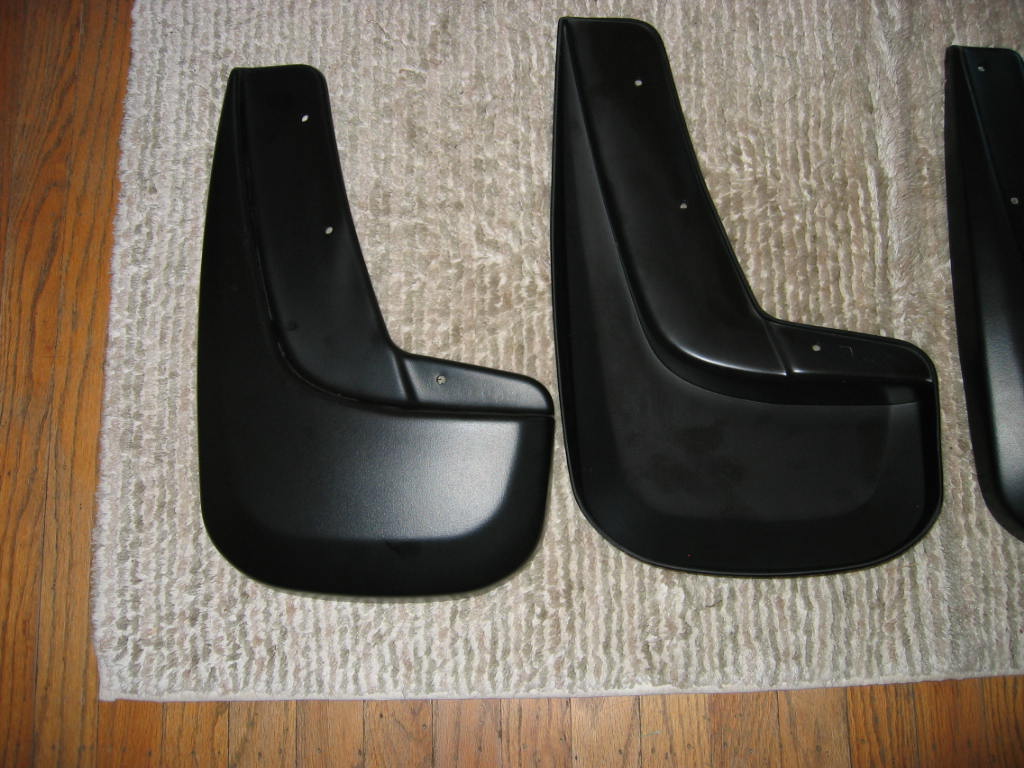

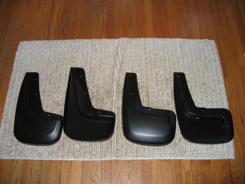

Received my Husky Mud Guards today. I think they look really good. I haven't installed them yet, but like sporty87 I just held them up the the 4Runner and can confirm that the fronts do interfere with my SE Toyota Running boards by about an inch. I am going to first try sliding the Running boards back a bit to see how they look. If I don't like that, I'll probably cut the running boards down. That should be pretty simple since they are just extruded Al with a rubber top and plastic end caps. Once I get them on, I'll post pictures. For now attached are pictures of the guards just sitting on the floor and copies of the instructions (no drilling required)

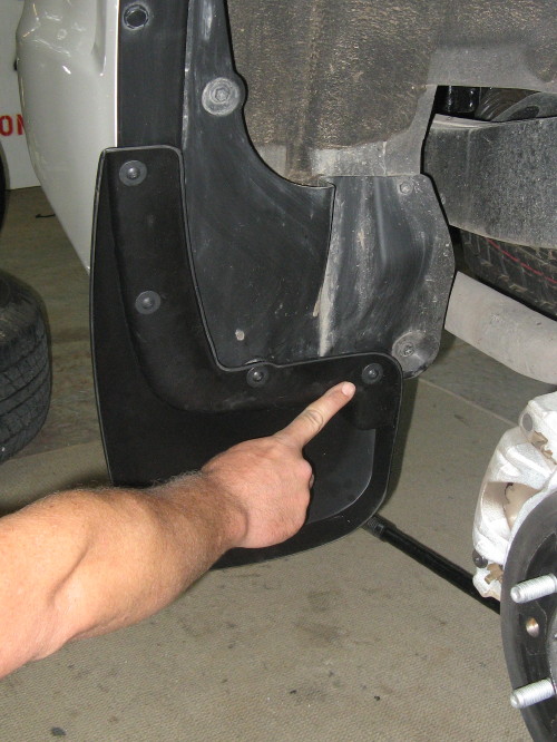

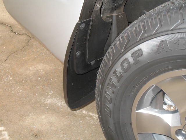

I installed the new Husky mudflaps onto SR5 this afternoon. Pretty easy install, one of the holes on the front flap was misaligned so I had to drill another hole. The flaps are a semi hard plastic. My '94 4Runner had more of a rubber mud flap so this one is different from what I was expecting. I like them on the vehicle but not crazy about them. They should do a great job at protecting the side paint. The back side of them looks great, the inner part is concave and actually has a bottom lip that may hold mud instead of letting it fall. Since there isn't a lot of choices right now I will keep them on and see if something better becomes available. I got them at TSE Truck Stuff costing roughly $70 forall four.

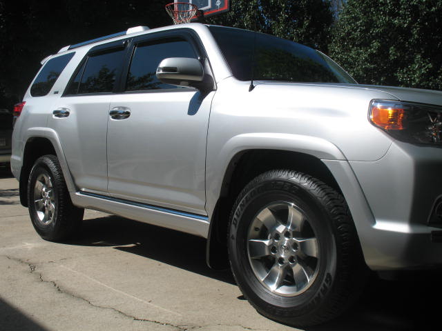

Here are some additional pics of SR5 with AVS ventshades and Husky mud flaps.
Much appreciated for the photos! They look like they fit pretty good. I think I'll definitely be ordering these for my scheduled camping trip/logging road excursion in August.

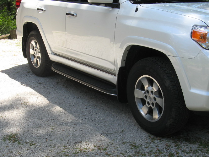

Not much different than buddyluke's install, except running boards.
We found this much easier with the rear tires off. And we also added a 4th screw on the rears, where the Husky instructions called for using 3 oems.
The front flaps were snug against the RB's, but they curve anyway, so were easy to install.
Quality product. Due to their shape, I expect they'll fill with slush in the winter, so we'll see how that goes.
Running boards are these: http://www.owens-pro.com/
Running boards are these: Owens Products, Inc
