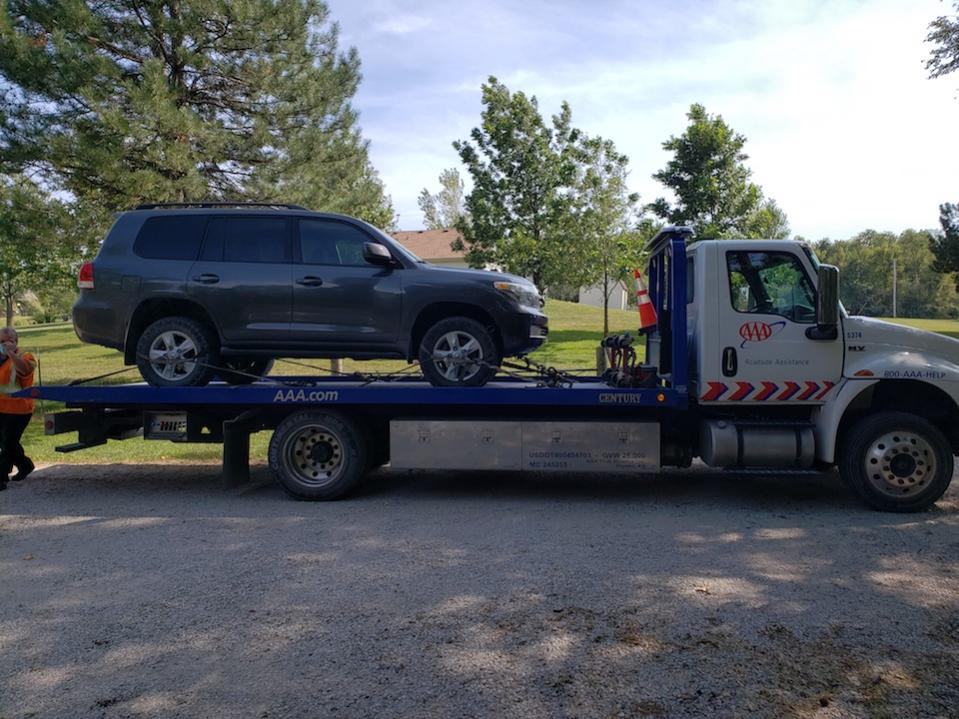

My wife's 200 series was attacked by a squirrel less than an hour after parking it in our driveway. The little bastard did $10,000 in damage to the wiring of the truck. Fortunately we have comprehensive on our insurance policy and all but our deductible was covered. I thought for sure that that insurance would total it out but this goes to show how well these vehicles hold their value. FYI its a 2008 Land Cruiser with 140K on it, I had bought almost a year prior to the day for $25K.
Like I said, I would not wish it upon anyone. Just awful! I'm very sorry for your own situation too, and am glad that insurance took care of it.
