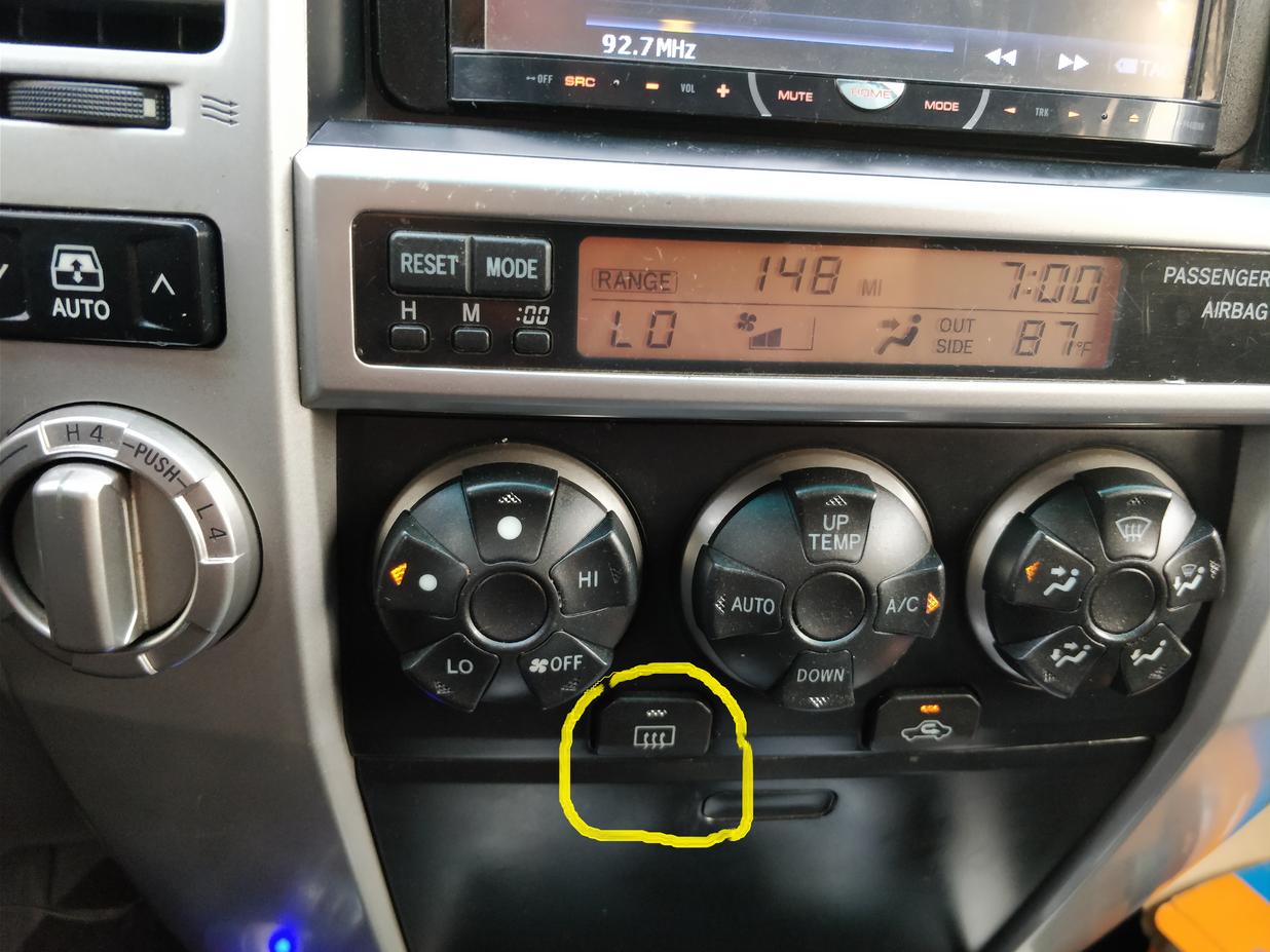

b. the defog button on the hvac module does not light up anymore, and i dont have the windscreen defog option anymore - the button is highlighted in the pic below, i feel this may be a case of unplugging stuff and forgetting to plug it back during the dash tear down, would appreciate any suggestions
c. the air direction function doesnt work anymore, the option to blow from the vent on the floor lights up when depressed, but no change in air speed, ie the button to blow air on ones feet
d. the fan airspeed seemed to have reduced 30% to 50% as before i usualy leave the fan setting on the lowest setting, but now i gotta put it on the 2nd or 3rd higest fan setting

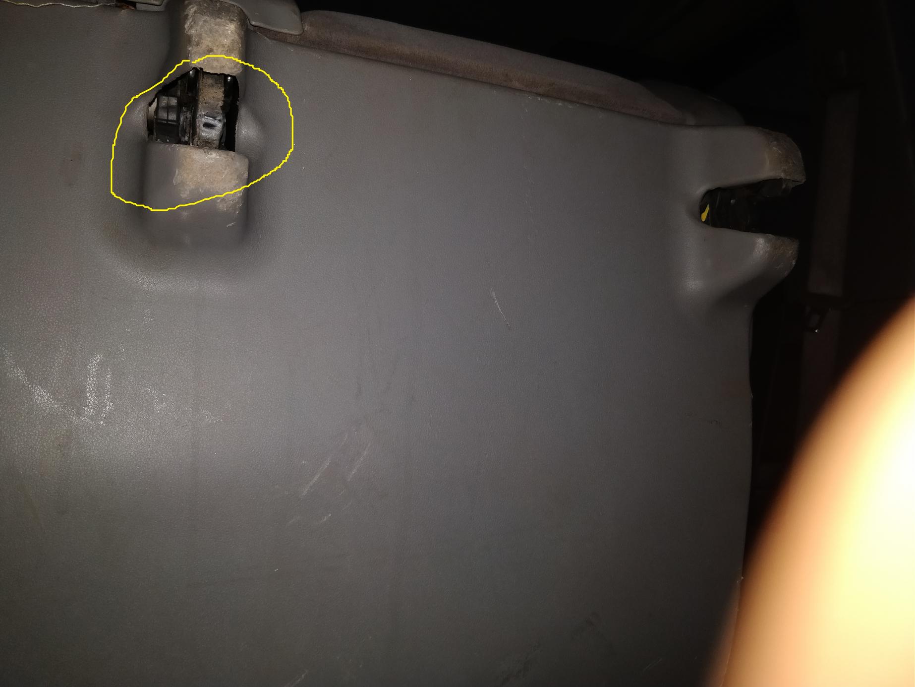

i removed the rear seats to give the rug a thorough cleaning. now one of the claw stands on the rear seat is closed in the locked position - thus the seat isnt seating firmly in its track, as 1 claw is open, and the other closed, need tips on how to correct this issue

thanks, got the rear defroster working, with the battery reset, but the major issue still remains, the front defroster isnt working, and the airvents dont respond when the air direction button is engaged to change the airflow direction
update: harsh squeal on start up is almost gone. fiddled with the chair and found the claw opened., mine is a 3rd row model, so does not have anything to pull, just a red knob to depress,
so only the ac vent airflow problem is still pending, may have to go back to the repair place next wk..if am unable to figure it out, just wish to avoid thenm tearing into my dash again!!
update 17/04/1 everything resolved now, belt squeal on start up is gone, .just 2 old issues i have been battling with
