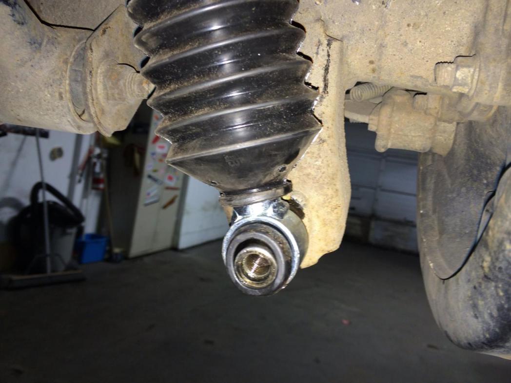

Thats for all of the replies, it's not the rubber thats stuck to the post it's the metal sleeve inside of the bushing that's seized to the post.
I forgot to mention that I did use one of my impact sockets & hammer to try to shock it free. Nothing. It sat for a week in PB Blaster & another week in WD40 now it will be sitting until Sat morning with more WD40.
I'll see if I can borrow a puller from someone. Thanks again!
It looks like this. And yes! I will be sanding & painting the post with Eastwood rust converter & using Anti seize on re-install!

Support the impact socket with a piece of wood and give it a real whack with a sledge or really BFH with two hands. All you need to do is break it loose and it will come right off. I did this last week with a pulley i needed to get off a tile saw motor. No amount of heat, puller or hammer would budge it. As a last resort I put an oversize nut on the pulley and gave it a real whack with a sledge and it popped loose and then came off easily with the puller
Buy a decent 2 or 3 jaw puller, 5 ton or more, mix some acetone and ATF, pour into sleeve, put the shock bolt back in to the housing, then tighten up on the puller very tight and walk away. If the 50/50 mix works it will come free with time.
This works as long as you can get a bite on the back of the shock mount.
