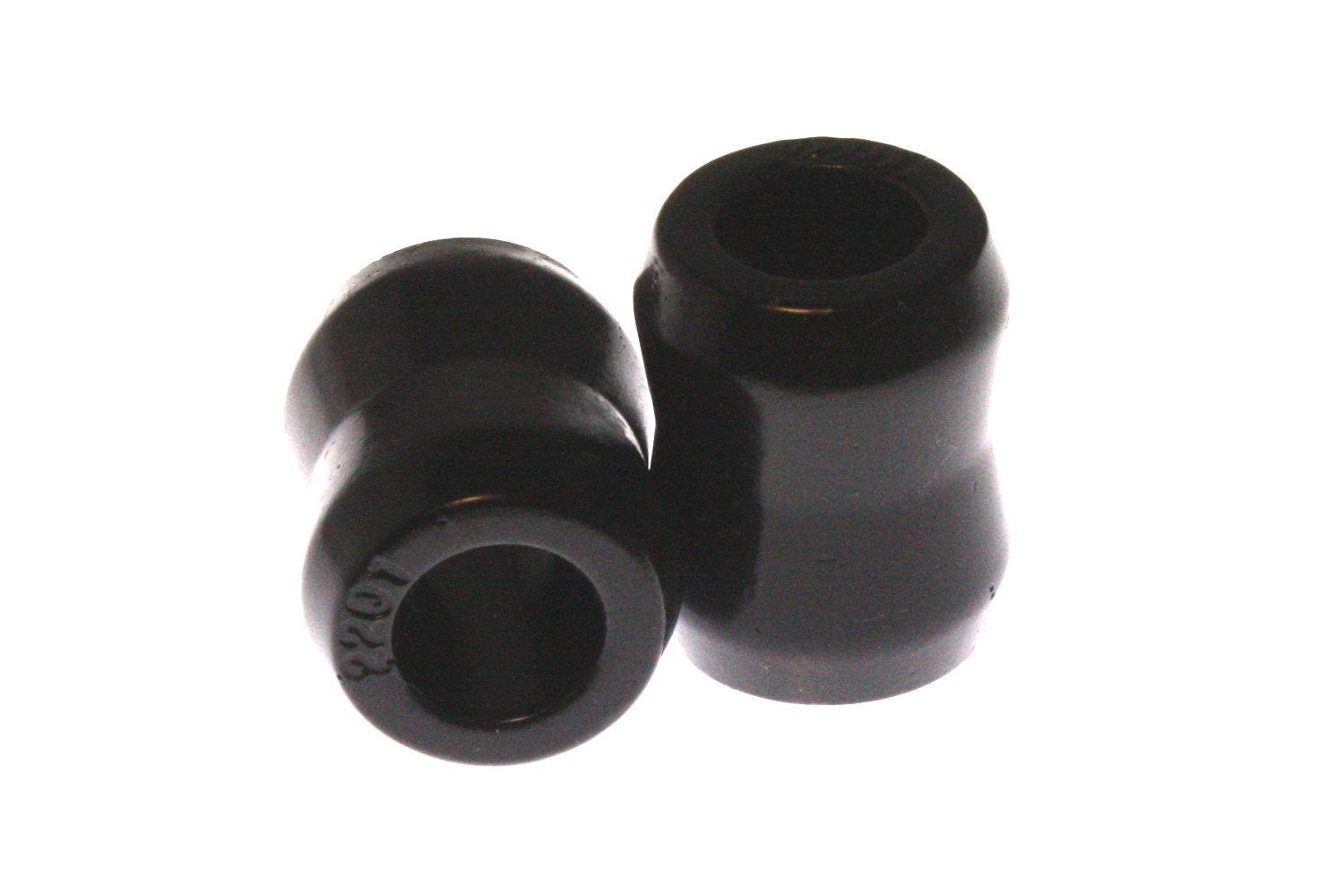

I'm looking at replacement bushings & I dont see any with the metal sleeve in the center? The ones from Daystar & Energy are Poly only with no sleeve? I guess I should replace both so they are the same on both sides?
I bought a 3 jaw gear puller set. 3", 4" & 6". The 4" fit perfect & pulled the shock right off the bushing! LOL The metal sleeve is still seized to the mount. No biggie really since I'm not using that axle housing again unless I get another T4R that needs it or decide to sell it.
I remember looking all over for an OEM style bushing(with the sleeve) when I installed my 5100 Tundra shocks and couldn't find ones anywhere. I use the daystar poly bushing and so far so good. Definitely want to replace both sides.

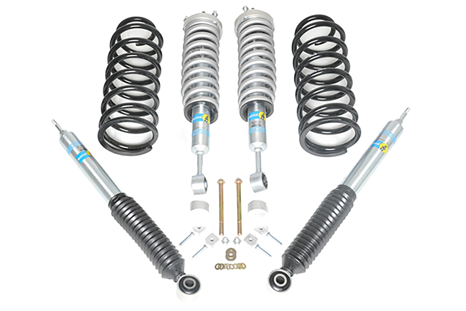

hmm when i installed my new 5100's on the rear neither had the metal sleeve.
nor did my old shocks. old ones came off with just the bushing no sleeve attached. installed the new 5100 with out a sleeve too. in the pic you posted that looks like the factory part thats threaded for the bolt lol
In the pic the sleeve is on the outside of the threaded mount. See how the mount is recessed in the sleeve a little?
Mine had the metal sleeve in the center like these in the pic.
I wonder if my ride will be smoother by going to an all poly bushing?
Poly is stiffer and you will need to worry about squeaks. There's better things to worry about so avoid.
