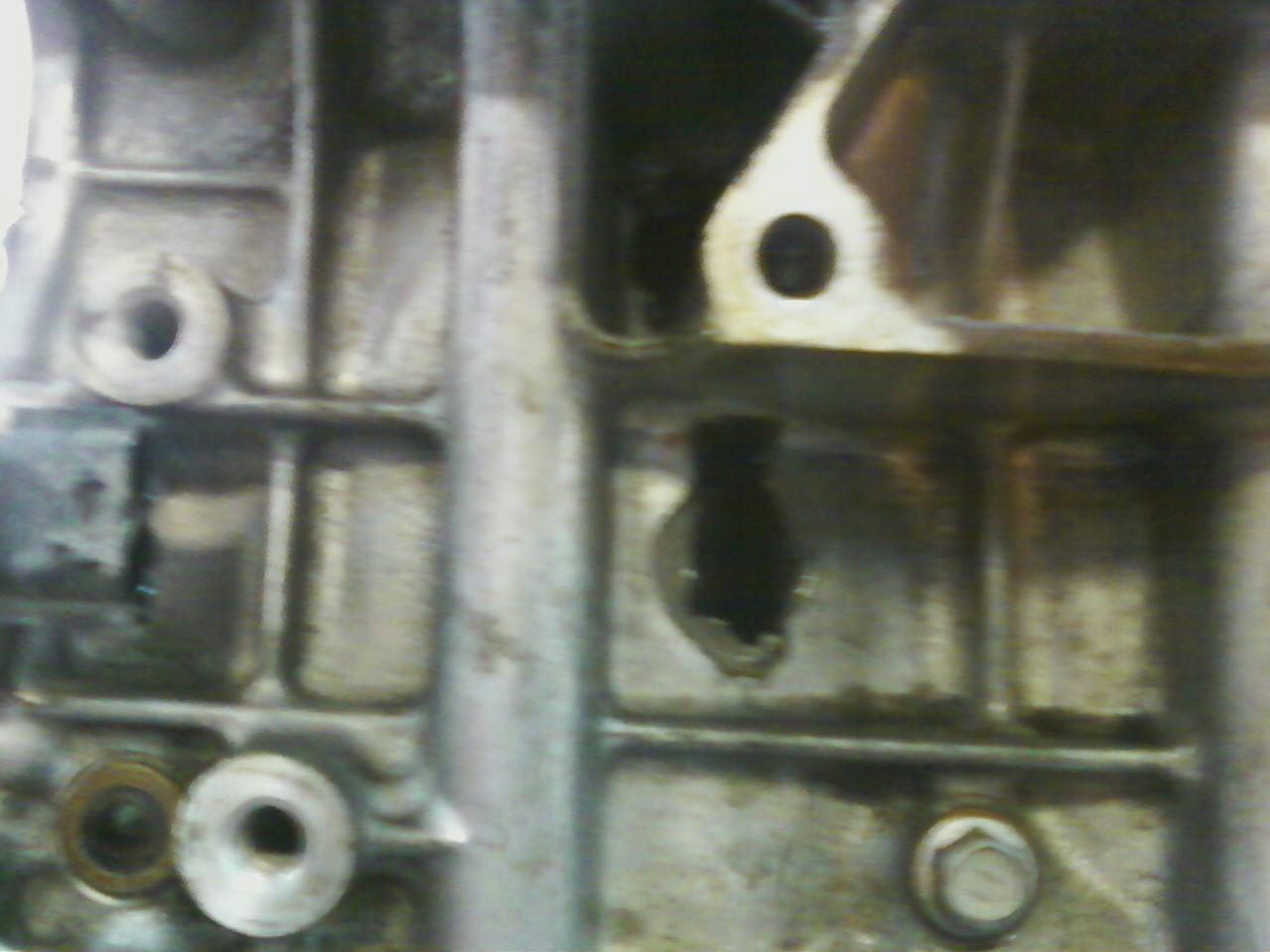

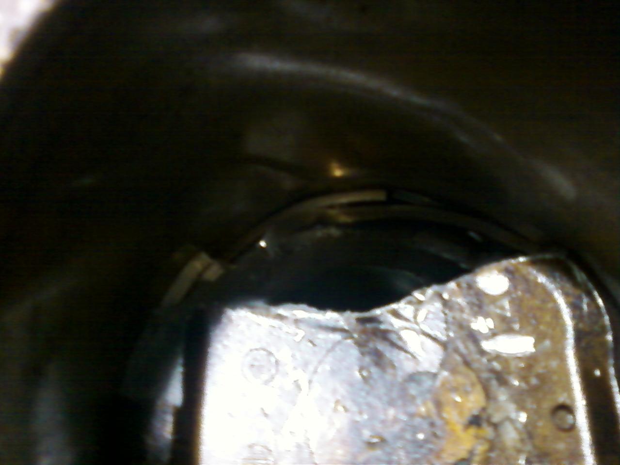

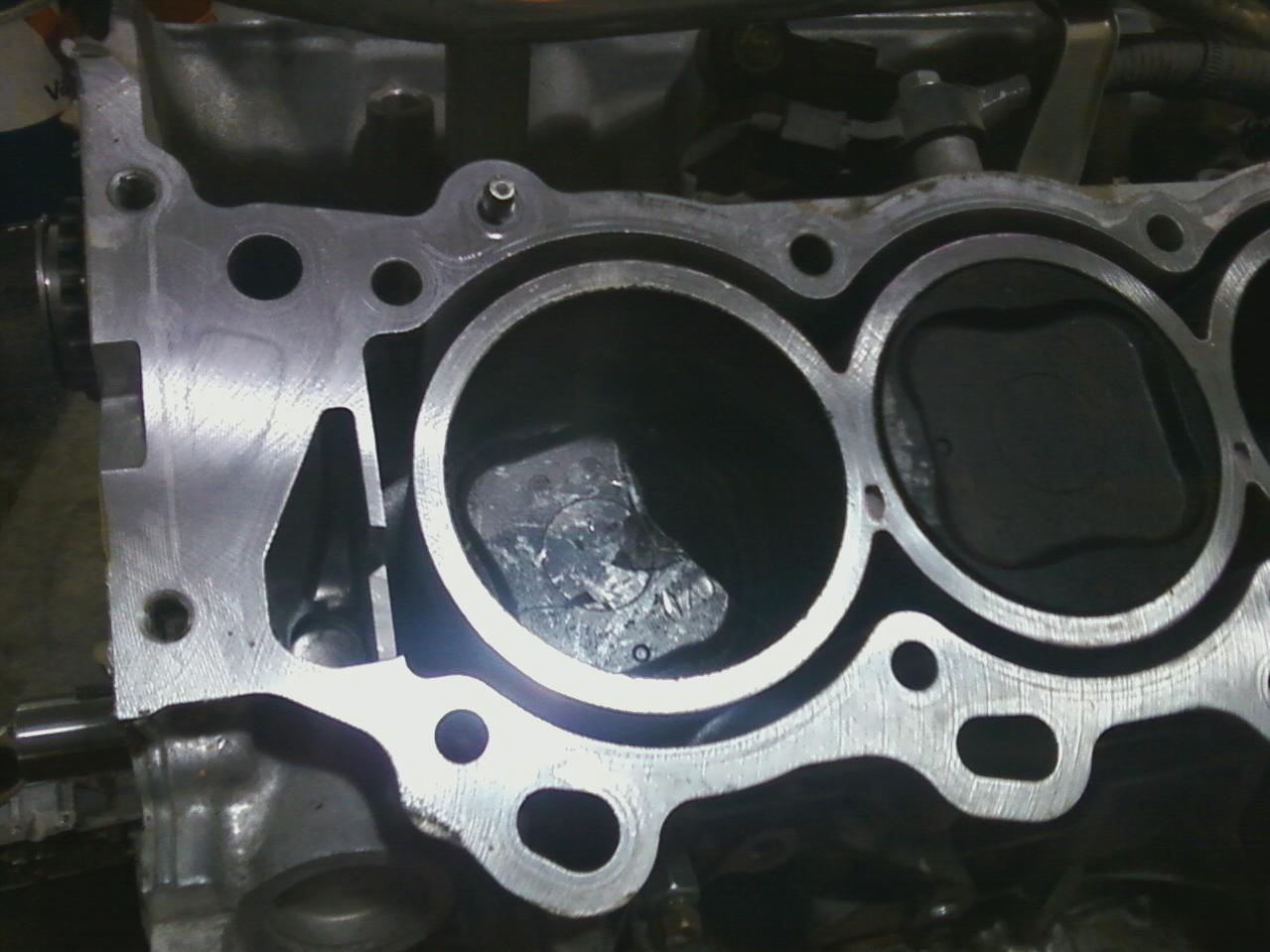

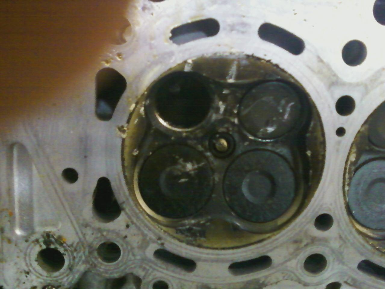

Okay so i went to the dealership today. what i was told on the phone was wrong.....oh well
i talked to the mechanic and he showed me what happened and why. here are some pictures
what happened was one of the exhaust valves broke loose (was told manufacturing defect) and bounced around in the piston, shattering it. then blowing a hole through the left side of the engine. then another one at the bottom of the oil pan. so with one shattered piston, the fragments of it were thrown around in my engine block causing 2 other pistons to crack.
so i will get brand new
-engine block
-pistons
-crank shaft
-oil pan
-headers
-timing chain
-he said he would replace all of the belts
-gearing in the transmission
pictures aren't the best quality, i took them with my cell phone.
