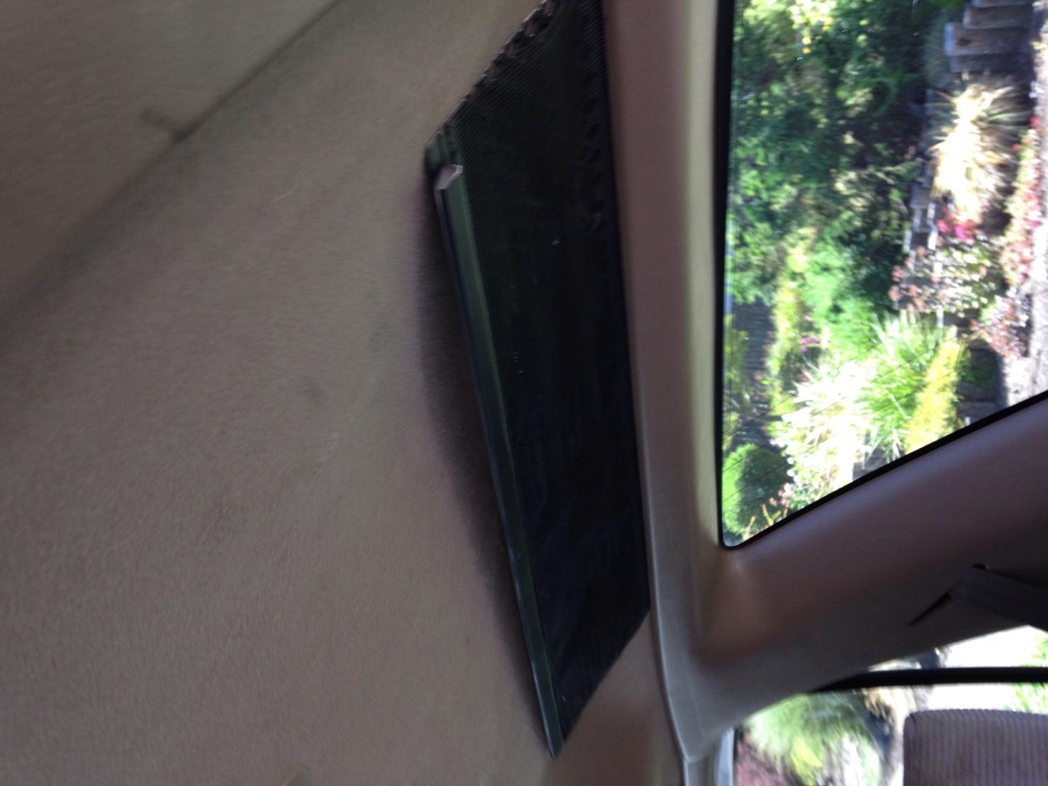

My 4 dollar window screen!
By popular demand
Also found a nice easy way to store it as well!

Ha, that's pretty cool.
I bought mine yesterday and painted them. Got them all cut up this evening and they're pretty slick! I'll report back how well they work after I test them out this weekend.
Nice! [MENTION=63487]A.Wilson013[/MENTION] here's to hoping the C.O. mozzies stay at bay...last weekend they
were pretty tolerable near Wickiup/Craine Prairie Res.
This is much better than my wrapped/taped screen around the rear windows...

It actually fits really good, and has enough bite into the window channel to offer some security. Meaning for one, you can't just slice through it like a screen, and two if you were to try and push it in, it takes a bit of effort to do so. So the security would be the time it takes to get past it, just enough to wake up and be conscious of what's happening.

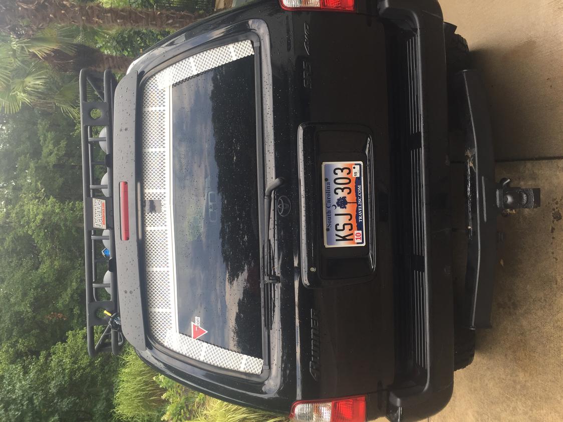

Well since no one responded with a picture of their back I went ahead and did it trial and error style. I got 2 guards and cut them to the exact shape of the window and then added 2 smaller pieces of screen that I just stuck in the window channel. I taped the screens together on the inside so they won't go anywhere. I took them for a drive and got up to 70 mph and nothing was shaking or anything. Thanks for the idea!

[MENTION=115455]JeepKiller[/MENTION] thanks for being the one to show how to do the back window, I think with a few minor detailing on it you will be done. If you don't mind maybe you can take a picture of the pieces for others to copy. You know, just so they can see how you trimmed the screen to fit, just so they can have an idea how to start. As far as hitting 70 mph, that's awesome to know it will stay put!
