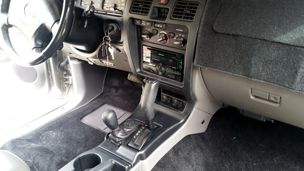

- Replaced OE radio with a nice affordable kenwood double din

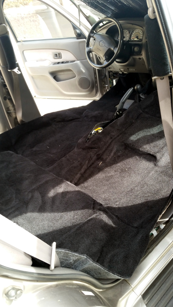

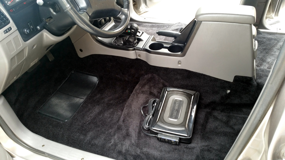

- Remove carpet and replaced with new, form molded - black (big project as it was molded for the 4runner but have to trim, cut and place holes and such

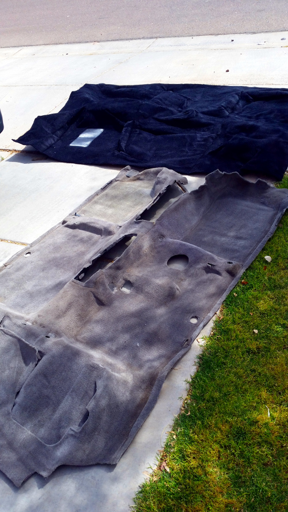

Old carpet and new carpet...

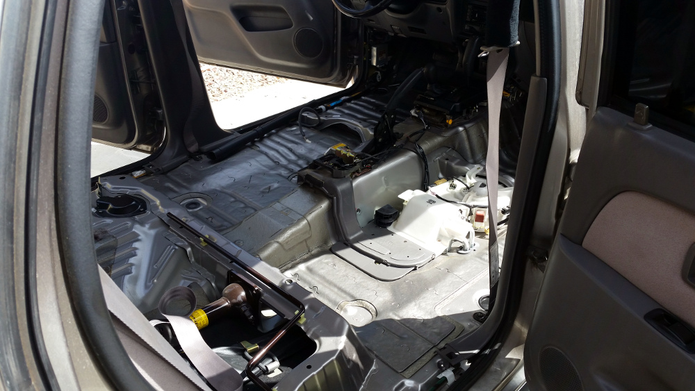

Comes pre-formed but not cut in detail. Tons of trimming and work involved to make it perfect
Interior stripped

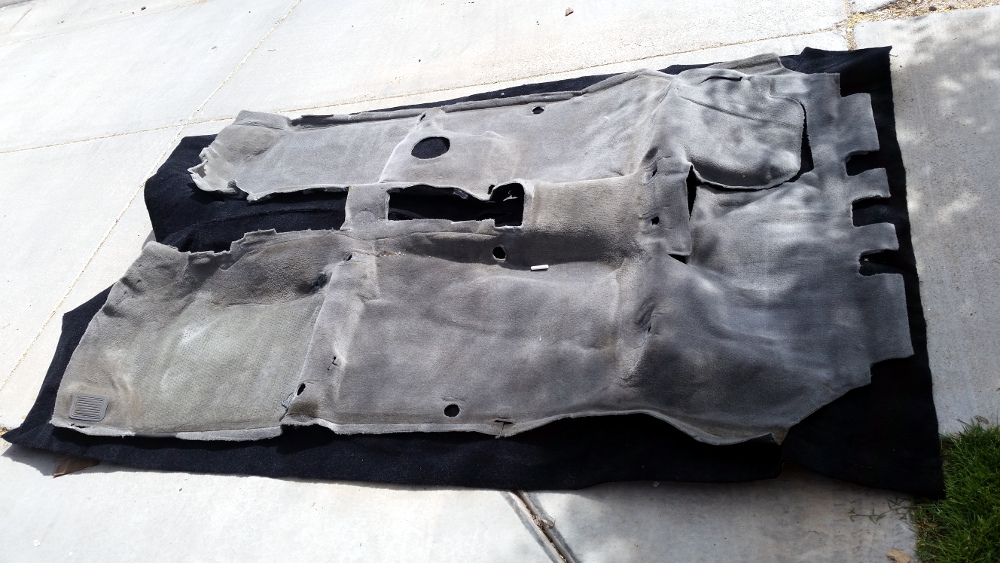

Just a loose fit of the new carpet prior to trimming
Carpet trimmed and installed. Pic of the under seat sub. Little guy adds warmth to general music and with the deck upgrade, sounds decent. I used to be a show car builder a lifetime ago so this little sub is sort of a laugh... but... Does what I want it to do and serves its purpose. Surprising output for something so small and does not sound bad at all. Works great with the large cabin / transfer function of the vehicle. Does not reach deep - but just makes music fun and sound as it should. Also, sort of acts like a bass shaker since it is firing right up your bunghole HA!
Cheap $110 kenwood double din. Serves its purpose :) I laugh as the whole system cost less than what I would generally pay for power wire.. but I am totally happy with it as I am going for general OEM quality, fitment and nothing crazy. Just tunes when driving (amazing how priorities changes with age) :becky:

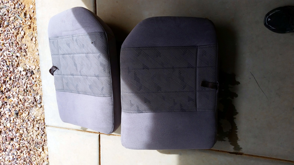

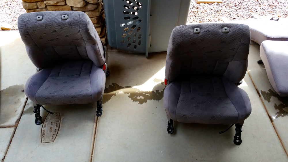

Seats drying after being pressure washed and cleaned. Zero stains or rips - look as good as new now.
Black dot was a fly that landed on the seat.
By tomorrow evening, seats should be dry and ready to put back in. Then more pics of the progress.

To clean seats or carpet (non powered seats) Simply take them to your local DIY spray car wash. Set the machine to wash so soap comes out and lightly mist the seats or carpet so they are wet and soapy. Scrub anything you need (often not needed - the pressure washing does this for you). Let them sit for 10 minutes or so.
Then go back, set the pressure washer to rinse. Make sure no soap is coming through the lines and blast the hell out of them starting from the top and working your way down the seats until all the junk comes out of them. They can take up to 48 hours to dry depending on your climate. Carpets take about 24 hours so keep this in mind. Helps to put a large box fan on them just to keep air moving.
Most carpets over the years are full of nastyness. When you pressure wash them, it may shock you with what comes out!
You can also use spot clean laundry stuff as well and spray it all over each seat prior to pressure washing if you have some nasty stains.
This sort of thing is easy if you have a pressure washer at home. Even a cheapy electric one will work great.
If you have power seats, just make up a bucket of hot water with a small amount of laundry detergent. Scrub the heck out of the seats and soak them well. Then suck up the water with a shop vac. Rinse a few times to get the soap out.

Good communication - great product for the price. As stated, it takes a bit to install it properly. Plan for about 3 hours or 4 hours for someone new. I have done tons of custom automotive carpet and interior stuff before so this was not bad since it was pre-formed. Just a load of trimming , cutouts and such to make it perfect. Will take good photos tomorrow after I vac it out. Above pics were during the install and it looked a mess.
A little tip, when the carpet is in place, use a phillips screwdriver to punch seat bolt holes. Then use a 1" hole saw in reverse on a drill to make the holes
Another tip is to use chalk to make your marks on cutouts like under the back seat for the jack flap
Next weekend or maybe a weeknight this week I will put in all the rear carpet. It covers the entire floor, backs of seats and wheel wells. Replacing all of the carpet with black.

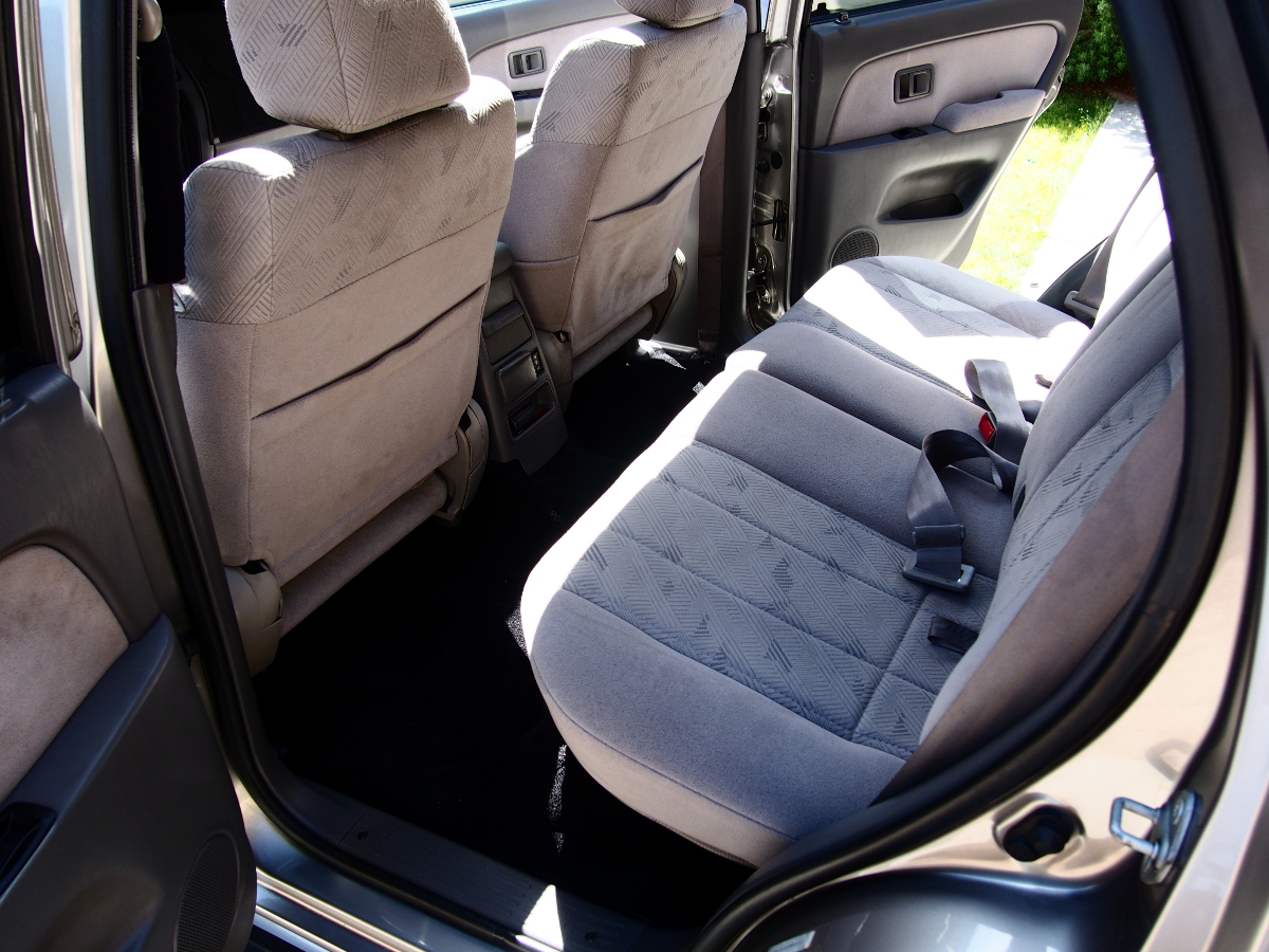

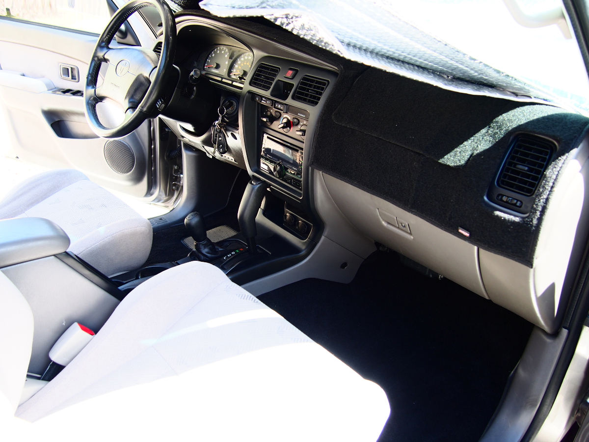

Finished up the interior assembly and detailed the beast. Turned out better than I had hoped!
All seats are as new now... Still need to soak and scrub seatbelts.

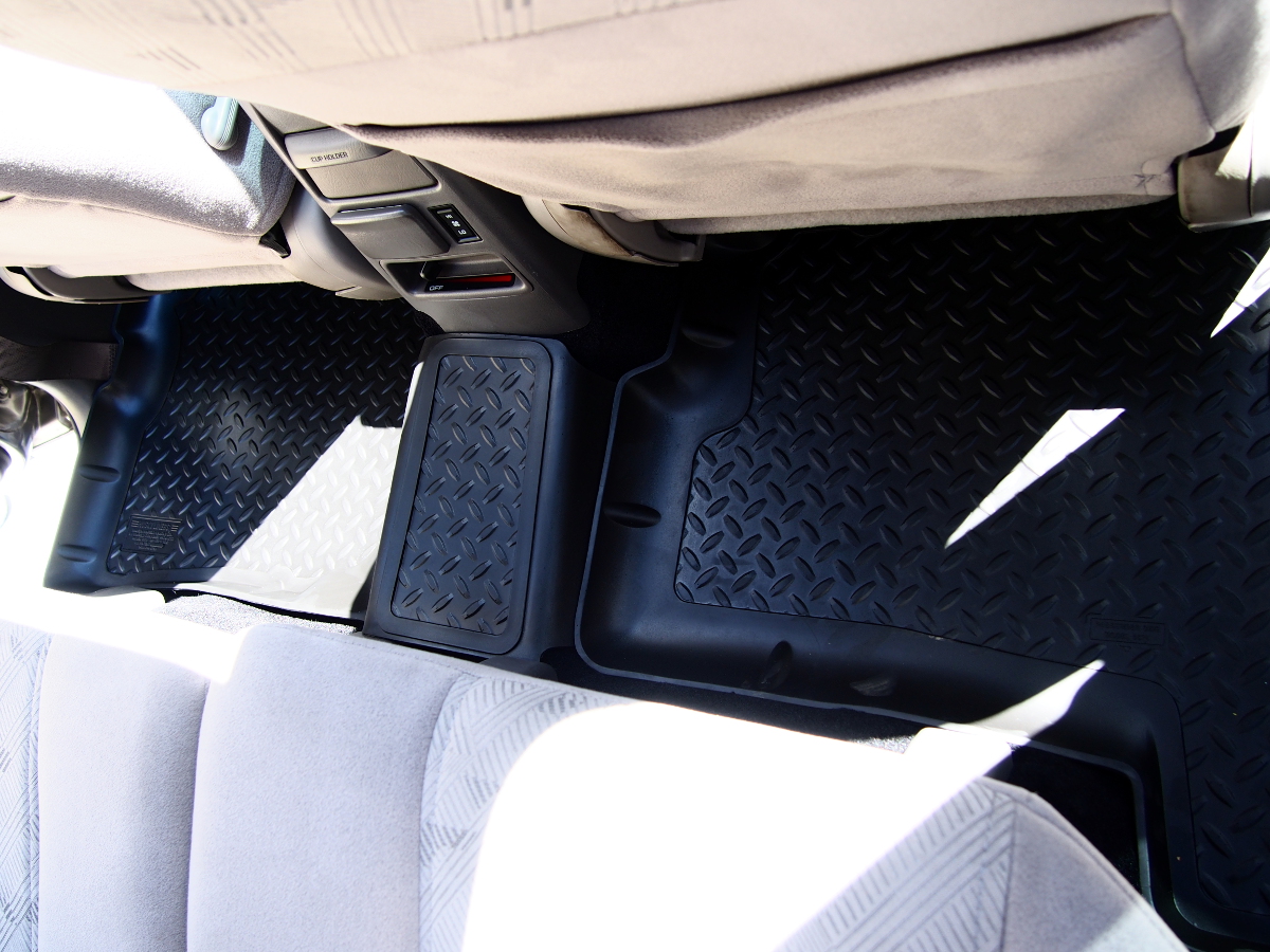

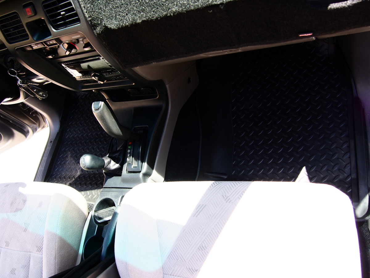

Front Husky Liners
Rear liners
Clean interior shot with the black carpet / no liners. Just looks pitch black - love it!
