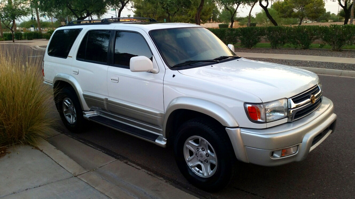

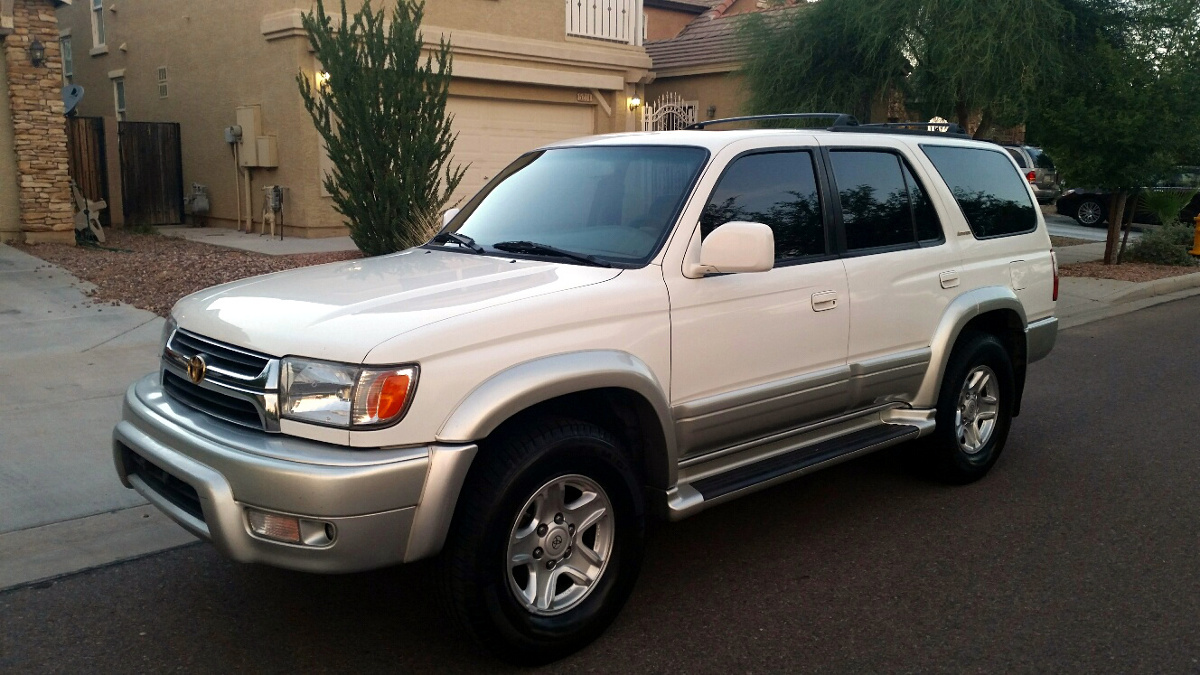

Bought a 2001 4wd limited on Sunday. She is white, silver with tan / brown interior. 220K. Will be doing the same work to it as well.
The new one is actually cleaner than my SR5! She was garage kept / all verified highway miles and even the original floor mats are perfect as they were covered since new. Az car since day 1 so no corrosion or rust issues. Engine bay looks like it was assembled a year ago it is so clean. Guy did a LOT of maintenance to it with all records. Hell of a purchase for a laughably low price.
I do like my SR5 better. I do not like the painted bumpers (chrome is easier to clean and stays looking better). I do not like the digital climate controls and super heavy power / heated seats.

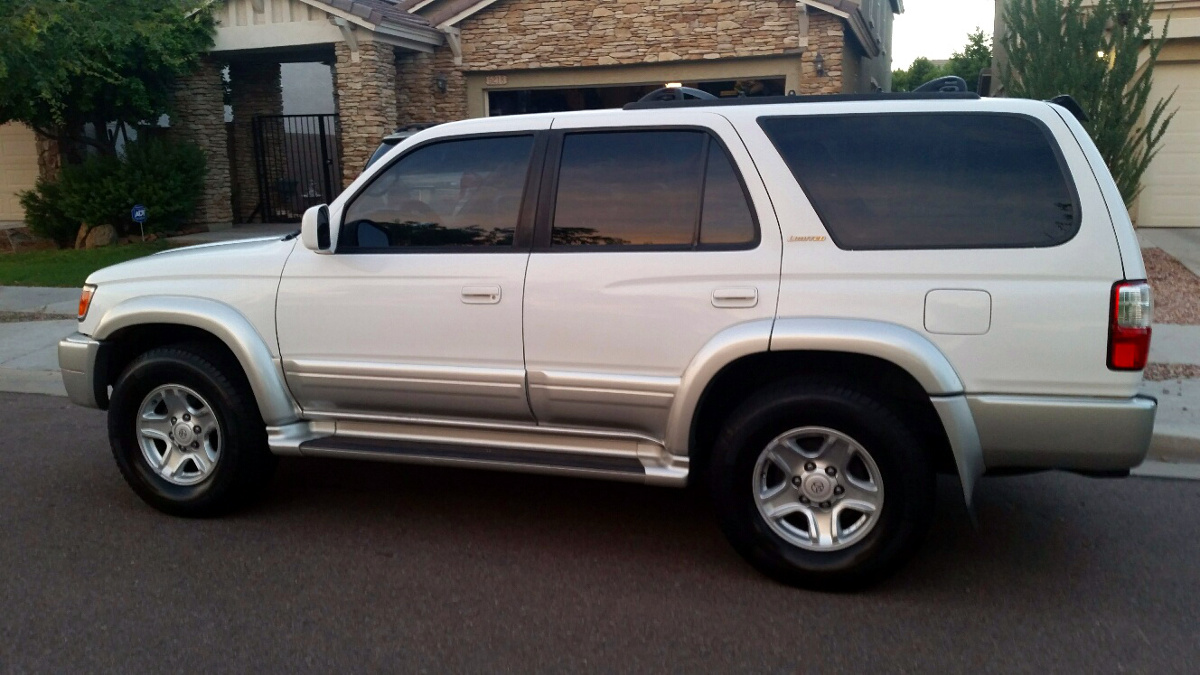

Already ordered in most of the gear I installed in my 02 in the previous pages. Taking her in for super dark / heat reflective tint in 30 minutes, and tomorrow installing 265/75/16 toyo MT mud terrains as the stock Michelin car tires are shot on it. The 265/75/16 is basically a 32... tiny bit smaller and should not rub. Will look pretty damn good though :)
Is that the original leather on the seats? If so that's the cleanest leather seats I've seen in a 3rd gen apart from one new off the dealer floor. Great find!
Thanks guys. Yes - craigslist find.
The lower drivers seat (in the photo) was re-done by a local shop and it matches the passenger side 100%. The leather overall on the fronts is about 7-8 out of 10. The back is maybe 9 out of 10.
I am going to call the same shop he took it to and have them just re-do the whole fronts to perfection. Their work is impressive!

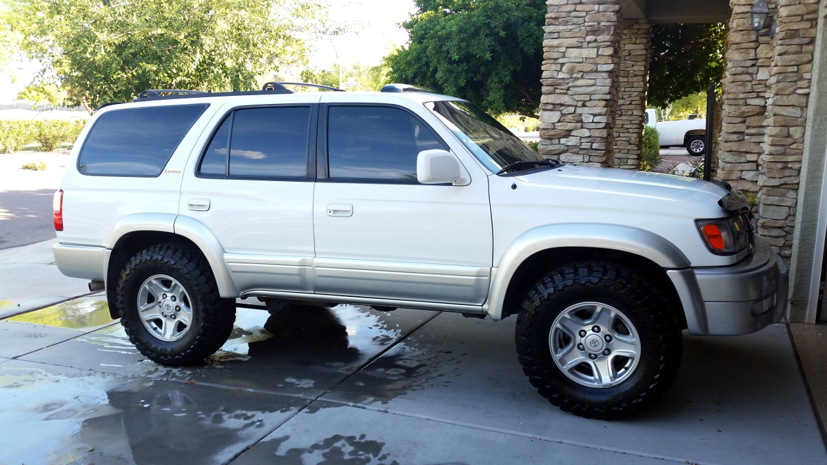

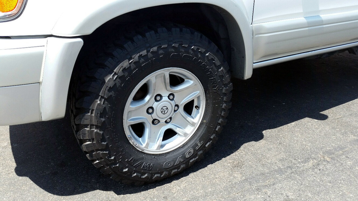

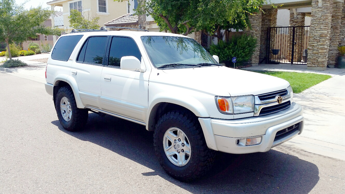

New tires for whitey today :) 265/75/16. Basically a 32". Toyo MT's with matching spare. Also took off the running boards. Looks great for no lift!

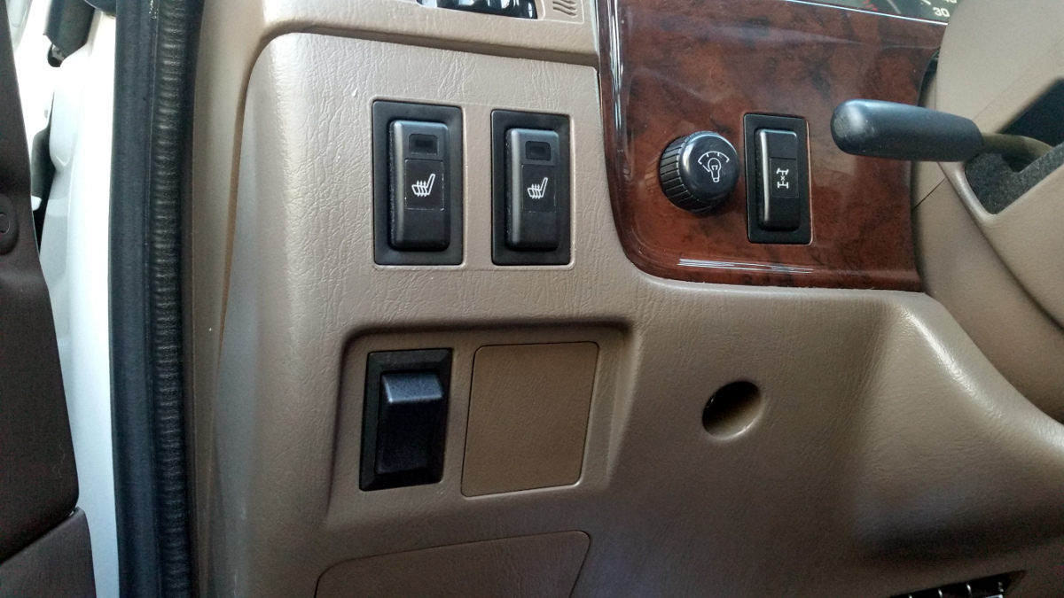

- Installed a stereo with BT. Did a kenwood DPX501BT and an SW11 under seat sub. Turned out great! Discovered the PO already put in Boston Acoustics FS60 door speakers (old school but sound decent). After a re-wire and cleanup of the hack job - happy with the sound
- Installed a switch for the power antenna so it will only raise if I want it to. Doing the same with my other gunner.

What I learned: Toyo MT tires are HEAVY MOFOS! Good lordy!

Here is the switch to manually control the power antenna. I do not like the taco whip so I did this mod so that I only raise the antenna when absolutely needed.
If replacing the oem radio or if you have an aftermarket radio
Buy the antenna adapters to combine the glass and power antenna cables
- METRA 40-UV43 $6.99 shipped
- Scosche MDAB adapter $4.50 shipped
- Simply buy a new antenna mast assembly as most of the time, your motor is fine. These install in seconds if you know how (just youtube) $19.99 shipped Toyota 4 Runner Power Antenna Mast 1996 2002 Brand New Stainless Steel | eBay
Last, buy a switch for the antenna. This way you can keep your mast down most all the time as the window antenna works great. If you REALLY need it, just flip the switch and raise the pirate flag for better reception
Splice the switch into the antenna wire which I believe is black/red on the 96-99 and black/white on the 00-02 (need to double check that). If an aftermarket radio, the wire will be blue or blue white depending on the radio and kit. (some radios combine amp turn on with power antenna)
This switch is a flawless fit for a knockout to the left of the steering wheel
Scion OEM Style Rocker Switch I do feel it is overpriced but I never searched for a cheaper direct fit. They also have a lighted one as well.
If you have a stock stereo, just buy the switch and new mast and splice the switch into the antenna wire. DONE.
