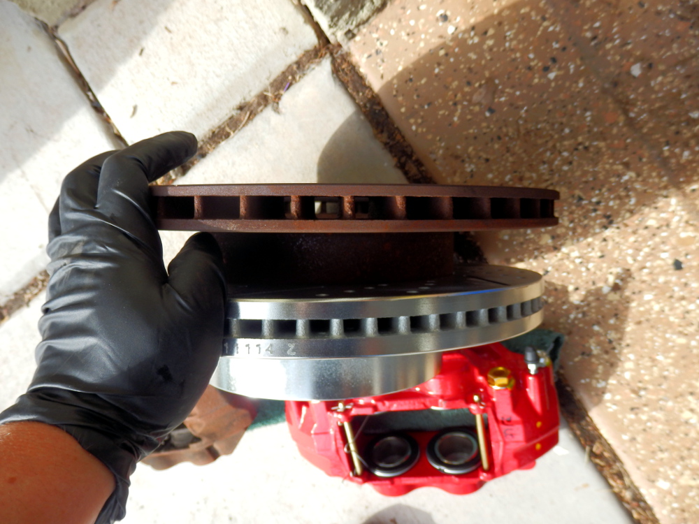

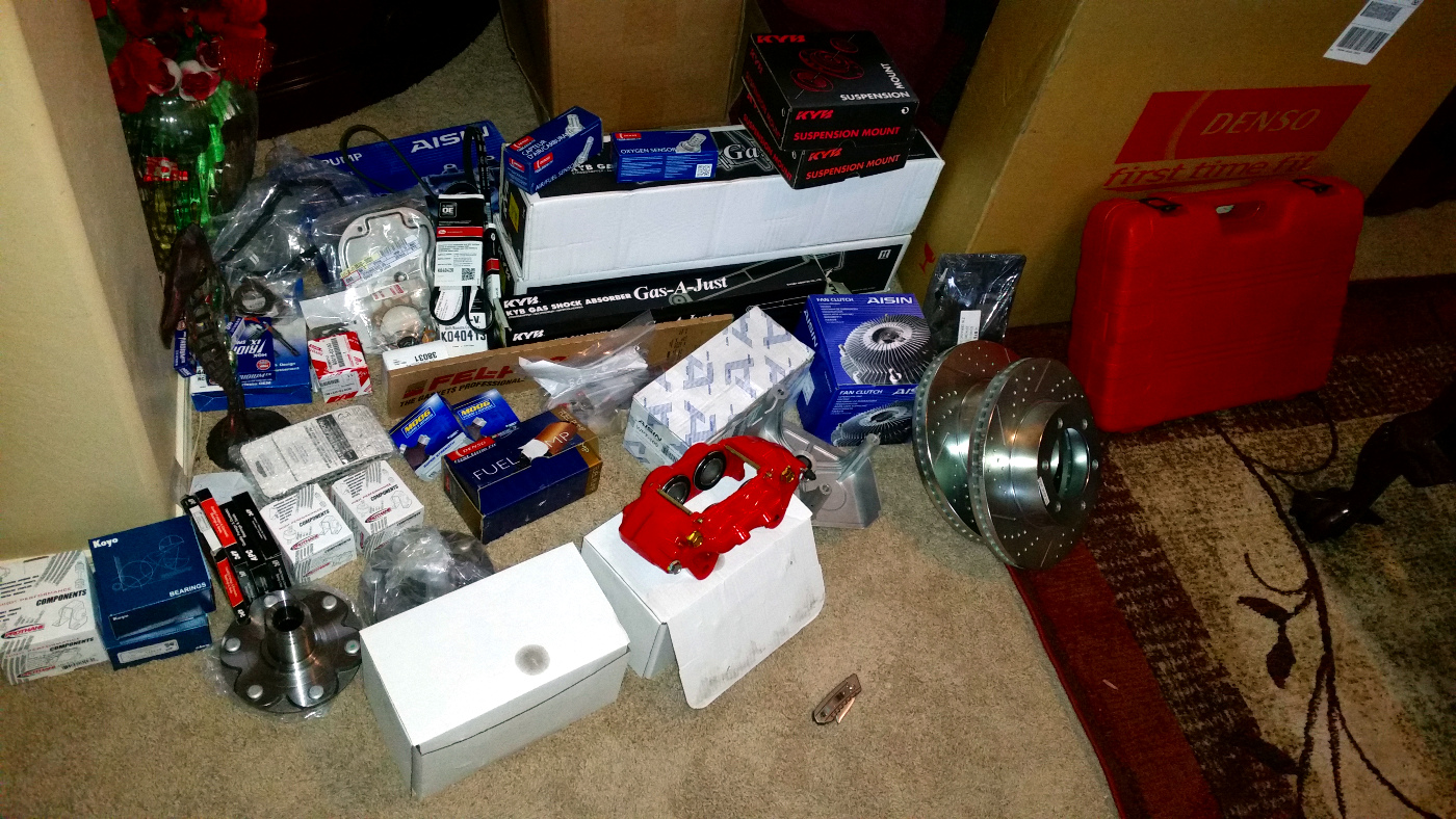

Loads more parts on the list in. Almost there :) Lordy the 13WL calipers are big! First I look at the pile and say WOOHOO! Just like always when car parts come in... Then reality hits on how much work I have ahead of me and... ohhhhhh crap is my next thought.

Some other goodies that will be here which I forgot to list (will edit the front page)
- Roca rear sway bar bushings and end links
- Whiteline / new style LCA bushings. LBJ's were already replaced by toyota not that many miles ago under the recall

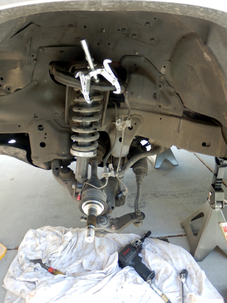

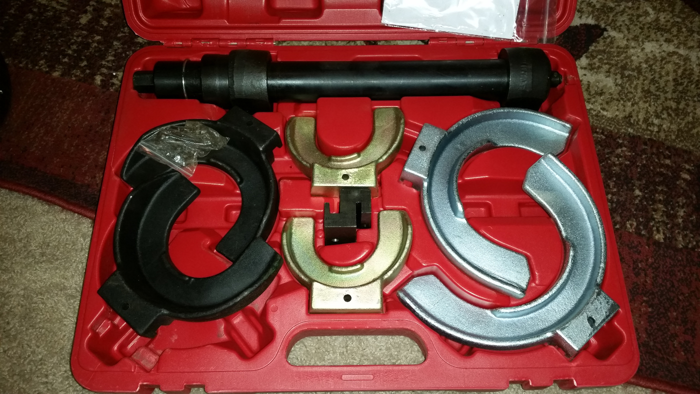

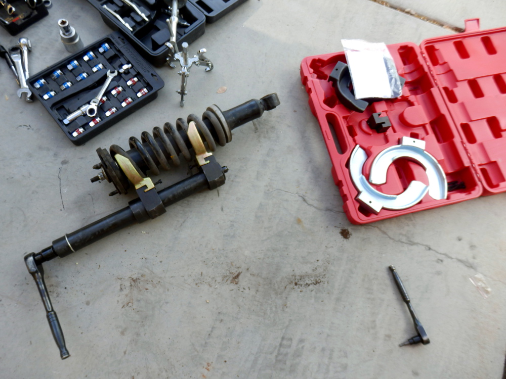

Well, since I have broken every cheap spring compressor known to man on past suspension jobs... I received a new toy today. Supposed to work VERY well and can be mounted in a vise according to a bud that picked one up. If this guy fails on me, I am going to by a hydraulic unit. Looking forward to trying it out soon!
That's a nice pile of parts there haha. Make sure if you do the rear drum brakes to get Toyota shoes, apparently the aftermarket ones don't fit well and can cause issues. I've got a set of new Toyota ones sitting here waiting for when I decide to to my brakes. How is the finish on those powerstop calipers? Does it seem durable, or cheap and likely to flake off quickly?
Will do - was reading about issues with other shoes and that the OEM are the way to go as they come with pins pressed in and new clips / no fitment issues.

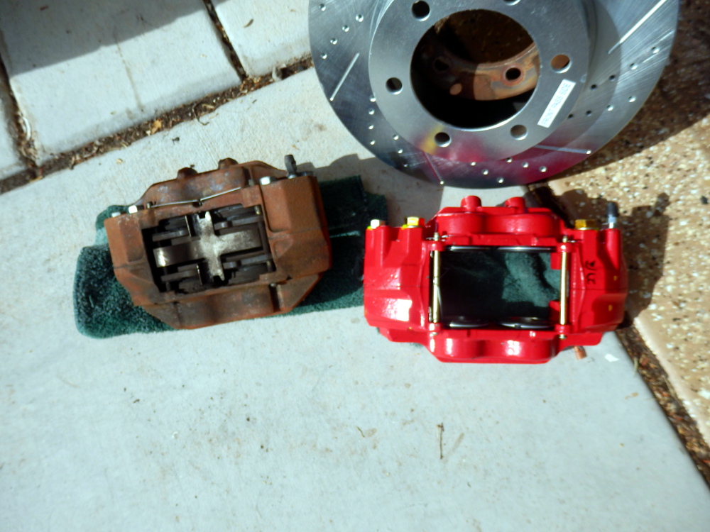

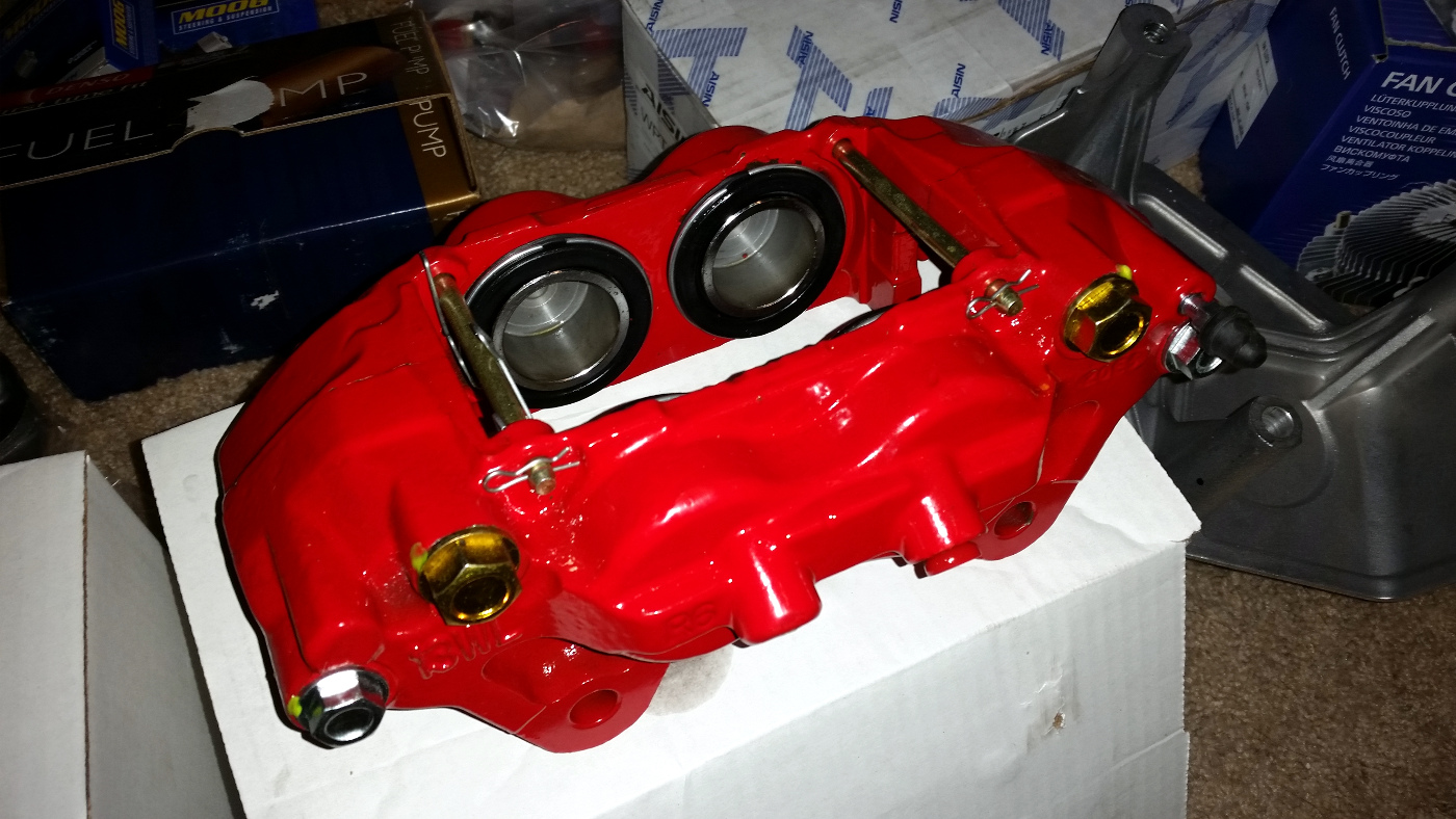

The coating seems very well done on the calipers. These were done by callihan which is technically owned by powerstop.

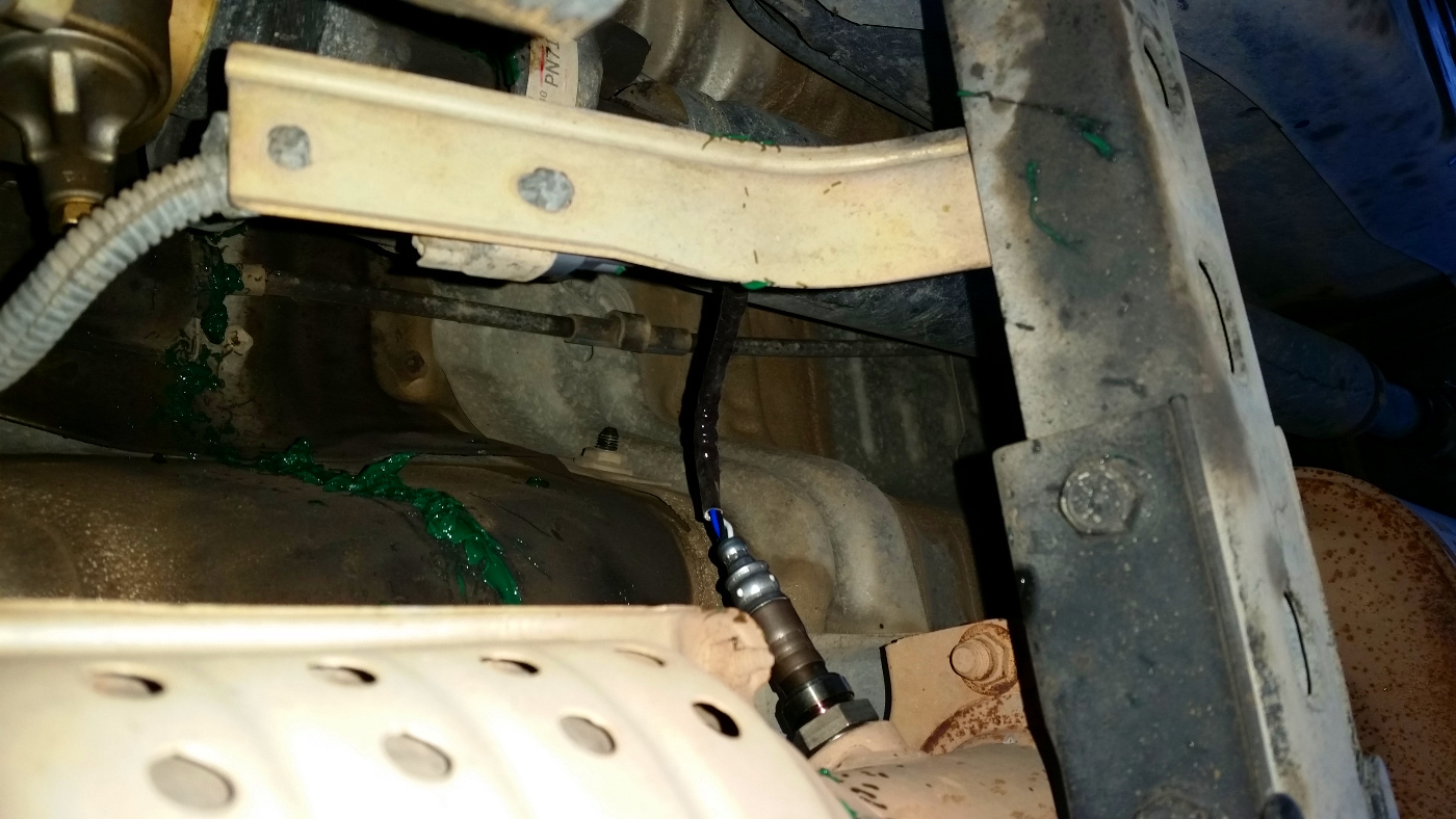

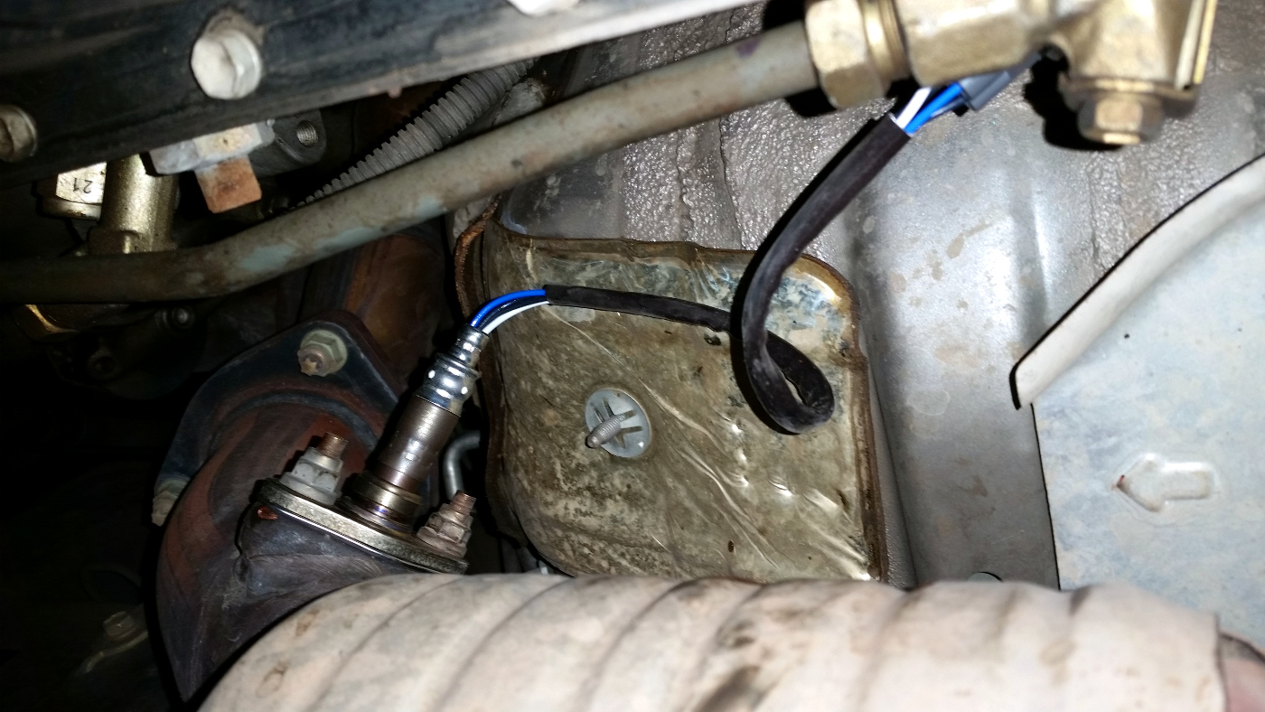

- Replaced both O2 sensors. Fuel mileage was not terrible at 17 average in city and I did not check them electrically but went ahead anyways. Sensors looked to be Bosch as they had orange tape on them... Not really a fan (hate their spark plugs... just sayin) so put denso back in. At least I know there should not be any surprises for a long time.

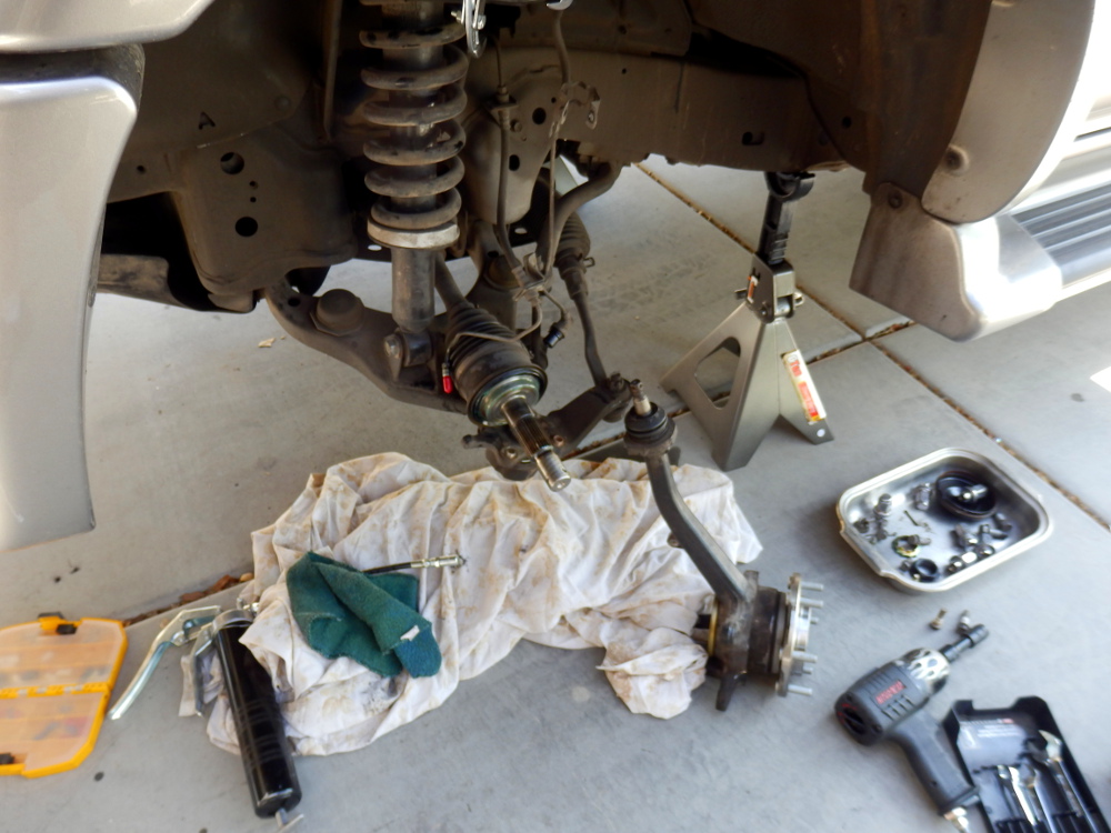

- Greased every fitting I could find on the drive shafts. Went way overboard flushing the stock grease out with Lucas x-tra heavy duty / green grease. Never tried it so giving it a go. Lots of clean up to do tomorrow night after it is slung all over hell and back :)

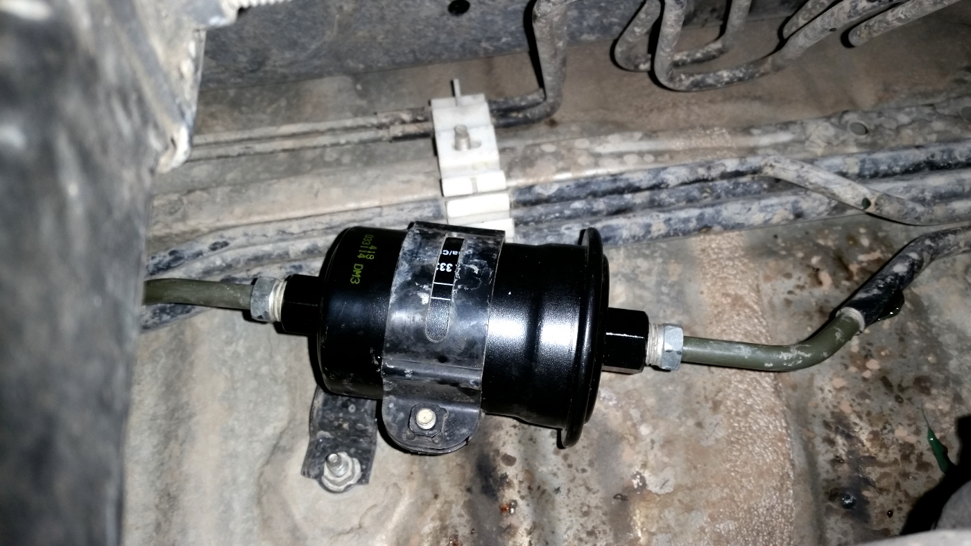

- Changed out the fuel filter. Good news is that it had been changed previously as it already had a wix 33319 installed.
Random boring pics of common new parts installed :moon:
You can see the lovely lucas grease slung all over in this shot of the rear O2 :toilet:
New fuel filter

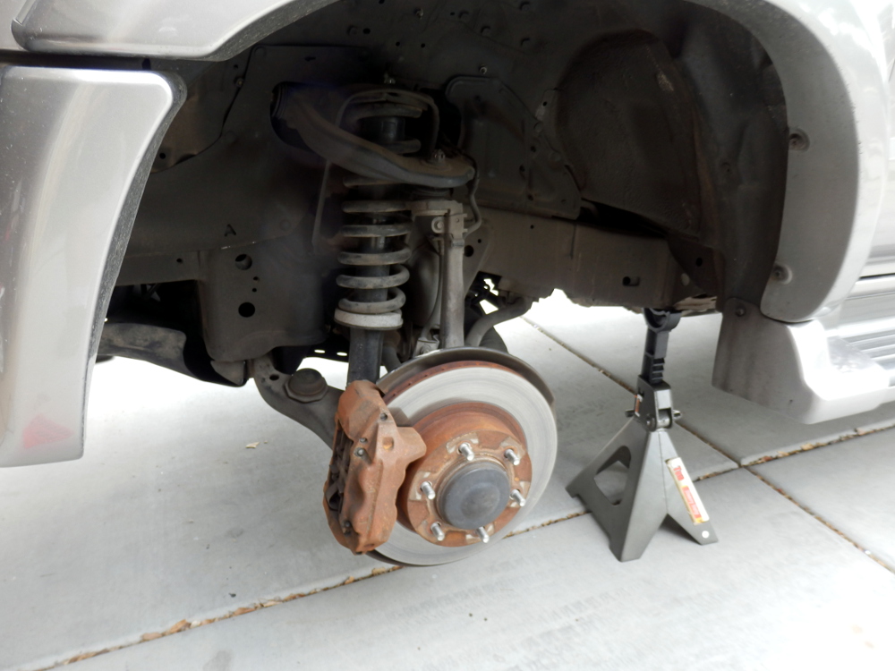

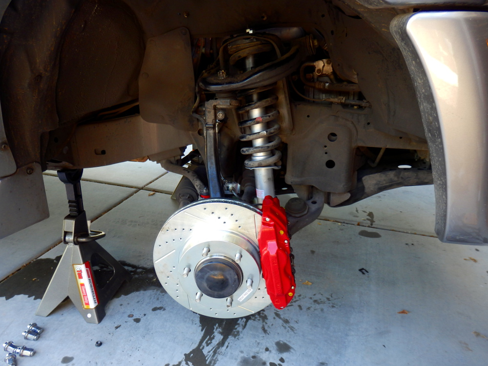

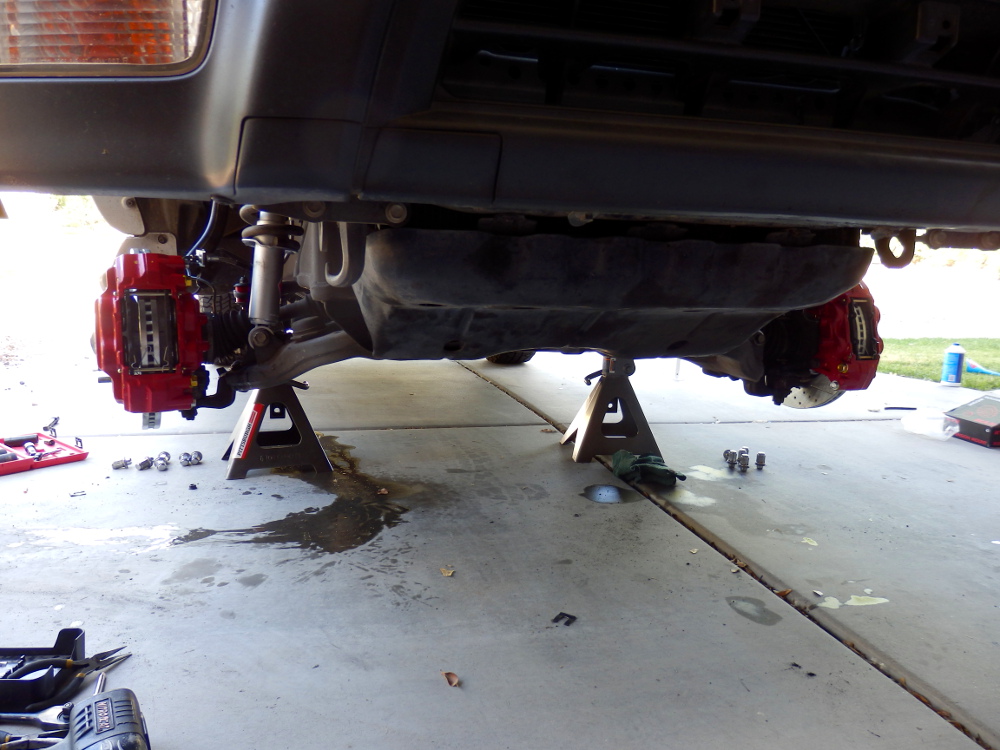

Completed today on the front:
- Replaced the wheel BAB's (big ass bearings)
- Stainless lines
- Tundra brake upgrade / Callahan
- KYB Gas Adjust with new hats
- Swaybar bushings
- Wanted to do LCA bushings but this kicked my ass royally as it was... so that will be a battle for another day (have the new P/N whitelines ready to roll at some point)

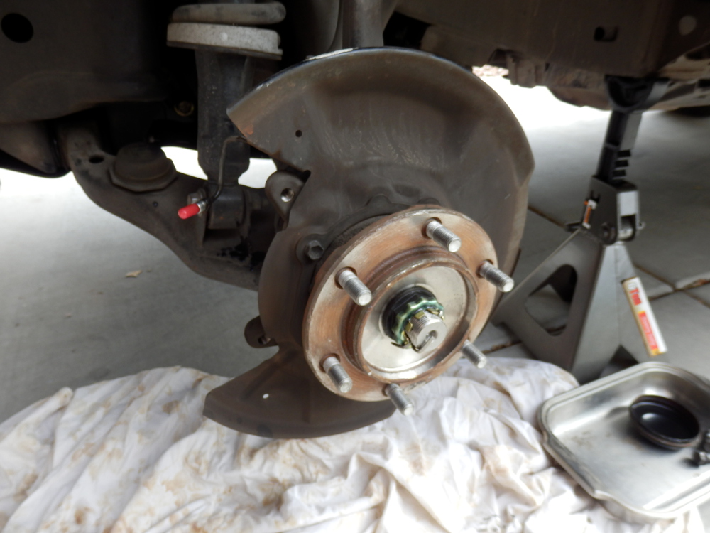

Bearings were quite a bit more of a chore than I had imagined as I am setup more for car bearings or smaller bearings. Things I learned:
- Slide hammer will NOT work on these hubs HA! They laughed at me
- God bless my 20T press
- Re-affirmed my hate for dust shields
- Need to buy another set of arbor press plates for the press for larger jobs like this (need 4 total arbors)
- Always keep stock rotors around for your press. This can be dangerous if all of your crap is rusted solid and massive force is needed to press things apart... but for lighter duty, they work AWESOME
- You cannot do this job with very basic pressing tools. You need a lot of different press plates and such to make it all work properly.

Tomorrow will take a look at the rear drums, replace shoes, cylinders and such if axles seals are good and also replace rear brake lines / adjust and re-bleed the whole setup.

Photos of the battle:
Bone stock except quite new LBJ's
Stock vs tundra caliper
Pathetic rotors at the end of their life (No idea how they were not glazed horribly or did not shake when stopping as thin as they are)

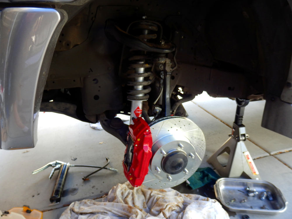

Caliper and rotor off with brake line capped

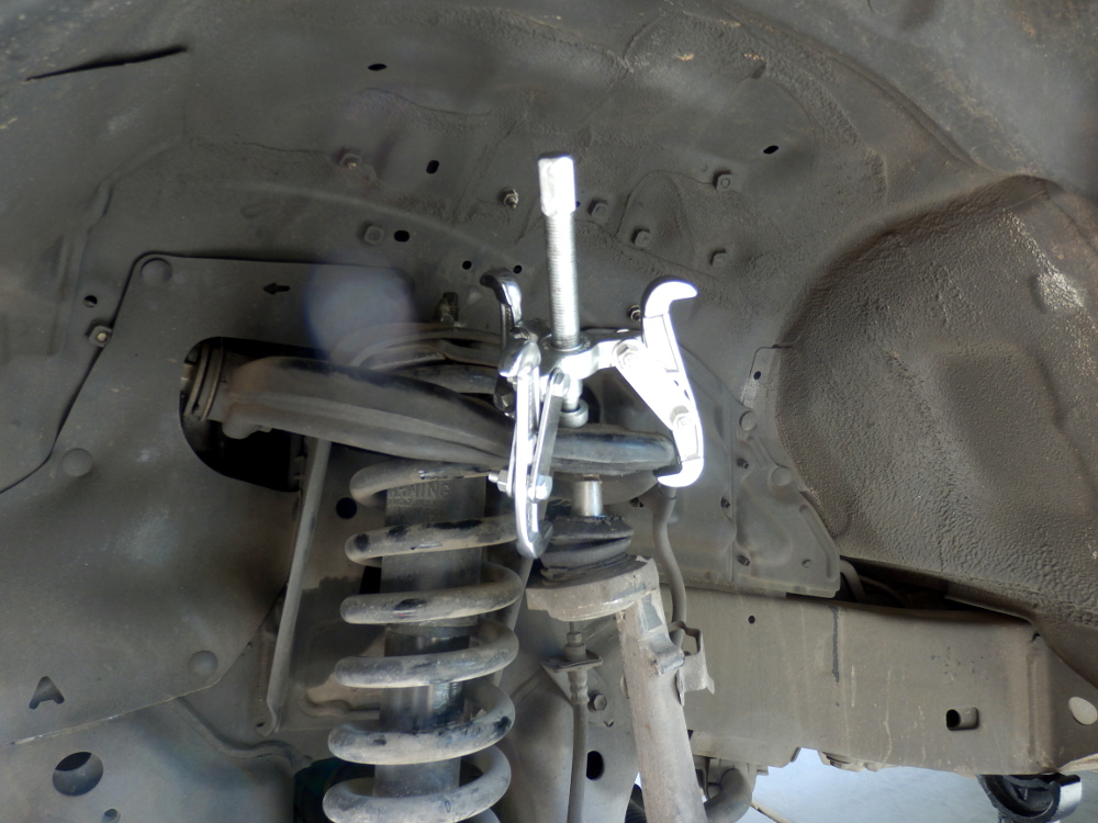

3 jaw made quick work of the UBJ
Juts a photo of dis-assembly at this stage

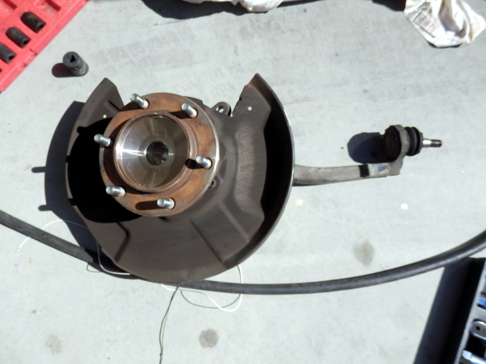

Spindle and hub assembly

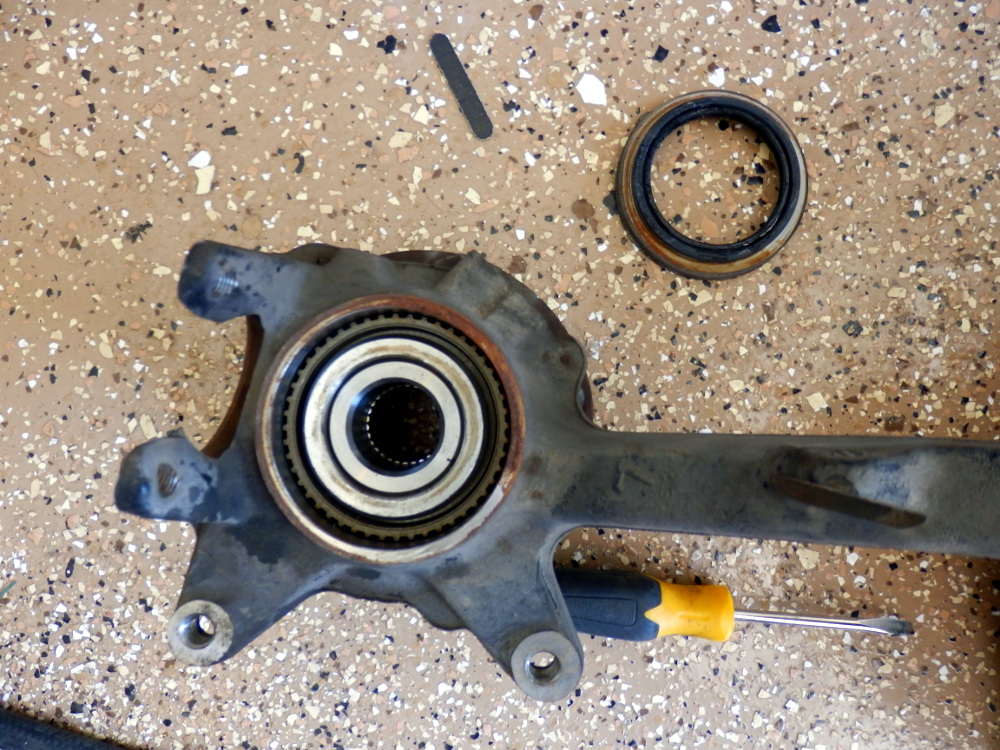

Inner seal removed to expose ABS ring and spacer

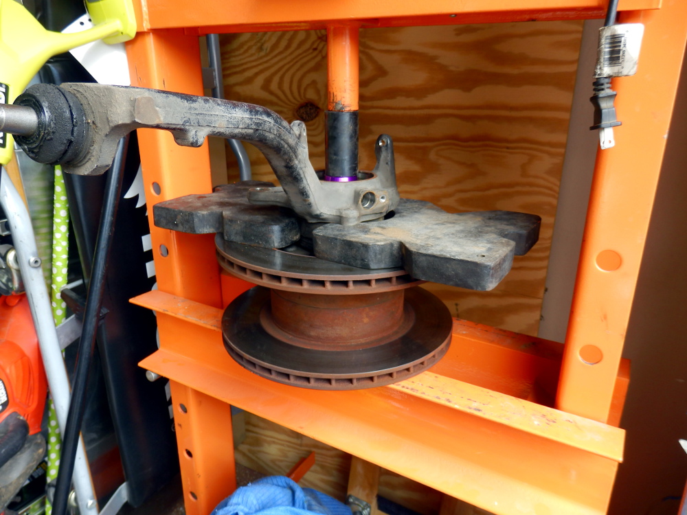

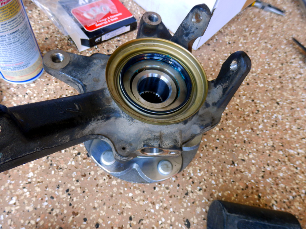

Rocket science / using stock rotors and 20t press. This is where I really needed two more arbors. When doing it this way, you line the stock hub up so that while pressing, the stock wheel studs literally drop down through the holes in the rotors. With two arbors, this gives plenty of room to drop the hub free of the spindle
New bearing, hub and seals installed. Make sure to grease the heck out of ALL seals and the CV shaft where the seal rides
Random pic of the new spindle assembly ready to bolt back on
Next up, Used my kick ass spring compressor to make quick and easy work of replacing the struts.
Re-assembled

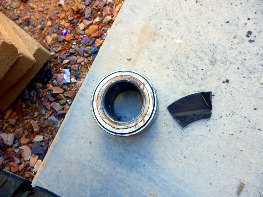

One of the stock bearings. You can visibly see the heat discoloration as it was starting to go. Grease was a little black and cooked too.

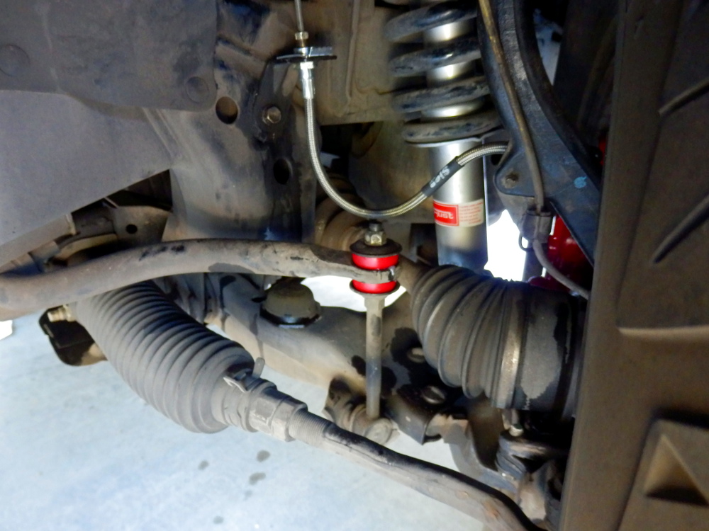

Installed poly endlink bushings and in this pic you can see the slee stainless lines.

After adjusting the rear, properly bleeding the fronts twice... I am VERY happy with the tundra upgrade. Night and day difference overall. Feel and modulation is excellent. No issues locking up the tires / tripping abs if I want to. Upgrade for me was worth every penny as the brake setup as it was.. was terrible.
- One caliper had very slow, sticking piston(s) which would cause an initial pull to the left when braking / then would settle
- Seals were shot on some of the pistons
- Rotors were dangerously thin and pads had about 30% left
- rears were WAY WAY WAY out of adjustment
- Did not look like the fluid had ever been flushed / looked nearly like used motor oil. Took a lot of fluid but it is mostly clear now
