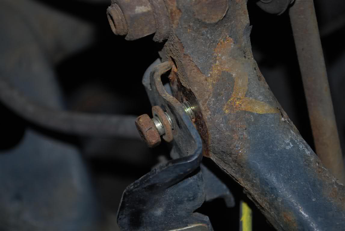

bolt snapped on me
I broke this rusty bolt holding the small metal plate (brake line retaining plate?) while snapping the hardline on the downstroke.
Half the bolt is still in. Whats some advice on what i should do next. I was able to zip tie the plate so it holds everything out of the way but this is only temporary.
I'm not sure where to start... get the bolt tapped out or get the piece
replaced that the bolt is stuck in? (not sure what those pieces are called either)
thx
Wow, sorry to hear that! I always spray some PB Blaster before working on these exposed parts as the salt here makes things utter hell. Your best approach would be to use PB Blaster or something similar, and let it soak the remaining bolt for no less than 45 minutes before having it tapped out. Sorry to hear about the brake line as well, must have been quite a swing!
thx
I broke this same 12mm bolt, where can I find a new one? What is the complete spec of it?
