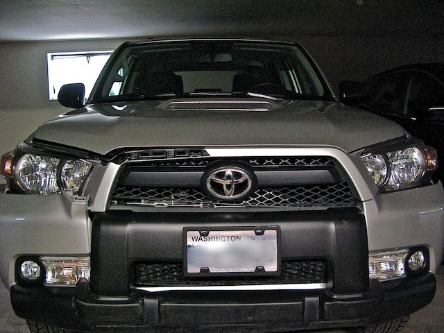

After three weeks at the dealer's body shop I finally get to pick-up my 2011 TE. She only had 8k under the tires to begin with, so my insurance paid for all OEM parts. Teeeked the radiator frame, the radiator, new hood, grills, passenger side lamps, etc. Anyone have tips for pickup and making sure the job got done right?
Also, the good was barely tweaked on the bottom and I'm keeping the old one for a project... What would you do with it?
Check for overspray on the windows are rubbers. Also check all the gaps around the hood and lights make sure they are similar. Open the hood and look at the rad support make sure that the repair was done correctly and that the supports were refinished and rust proofed.

Good advice Metallica thanks. Turns out it'll be tomorrow after all but they will detag the front toyota emblem for me by sanding it down and painting a flat black mat. Guess it's my consolation prize for having it out of commission for so long. The damage really didn't look that bad at first though. The initial estimate was just over $2,0000 before the teardown.
Do you think it'll show up on lemon reports down the road? Do you think it'll affect how she handles from here on out?
Pick it up during daylight hours, get it into sunlight and go over everything with a fine-tooth comb. If you see something that doesn't look right, get someone from the shop to document it right then and there so they can fix it on their dime. Once you drive it off the lot, anything you find wrong will be your problem, not theirs.
