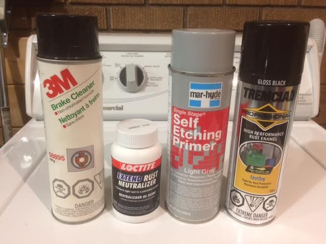

A few DYI, body work TIPS - used on my John Deere 318 snow blower, drift cutter build:
- best paint remover is CIRCA 1850 furniture stripper (buy at Home Hardware) / liquid mixed 4-1 with jell work very well
- wire brush on electric drill &/or sandblast rusted metal clean
- degrease bare metal, 3M break cleaner will work
- minute rust pits are hard to totally eliminate & will haunt a repaint later
- EXTEND is a phosphate coating to neutralize rust particles / buy at AutoZone...awesome stuff, I've used for decades
- the self etching primer as pictured, is good & durable stuff (purchased at NAPA/UAP)
- sorry, but the can of black Tremclad paint (on right), lacks toughness
LOCTITE® EXTEND RUST NEUTRALIZER Paint Over Rust with Extend Rust Neutralizer from Loctite Adhesives
Loctite® Extend Rust Neutralizer is a fast drying, milky white latex coating that is applied to rusted metal to stop rust, protect the surface and act as a primer for the finish coat. It converts rust to a neutral surface ready for painting, creating the ability to paint over rust.
