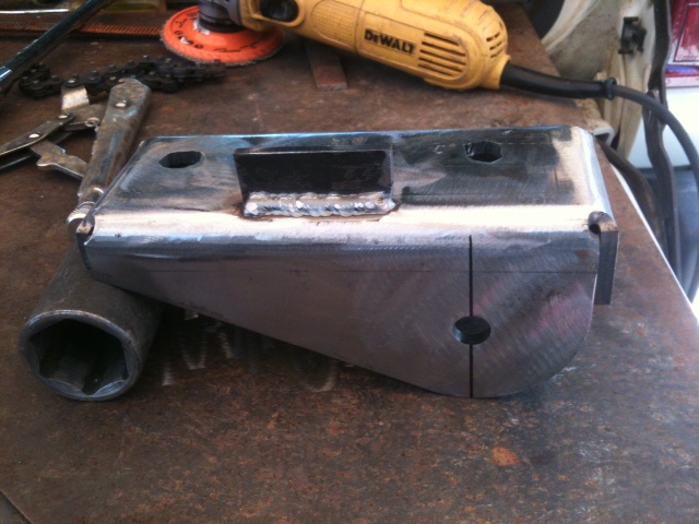

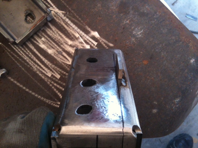

I got some progress done on the rear Chevy leaf swap today. Here's some pics of the RuffStuff frenched leaf spring hangers. I blasted some holes in the tops of them with the Plasma so I can Rosette weld them for a more solid mount. Also I marked a line 3/4" from the side so I can weld some reference tabs to the tops of them. The tabs act as an indexing guide so I can clamp them to the frame with C-clamps prior to welding.

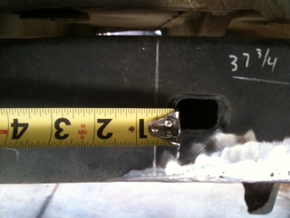

As most of you know, the rear suspension of the 2nd Gen's come from the factory with a 4-link. So that being said,it's a little bit more difficult to set up for the ever so popular Chevy 63 leaf swap. I probably spent 3 hours or more cutting and sanding off all the link mounts and bracketry that was on the frame just to get to the point I'm at now.
On other Toyota trucks that I have owned and done the swap to,it was a breeze to convert over to Chevies because you were able to use the stock leaf spring hanger as a reference point to measure off of prior to welding the new hanger on.
This pic show's the square hole that's on the rear portion of the frame in the middle of the rear wheel well. I used this whole as a reference to measure where I wanted the center of my axle to be. I measured back 1/2" and then from there I clamped a 2' level plumb on the line and measured 37 3/4" forward from that point and scribed a line on the frame.
The 37 3/4" is the measurement from the center of the Chevy leaf spring pin to the Eyelet mounting hole, plus the length of the frenched spring hanger from the very most front facing edge (where it tapers down)to the center of the mounting hole on the hanger itself. 31.5"+6.25"= 37.75" Mounting the hanger where I did, looks like its going to kick back my axle and move my tire back about 3" in the wheel well. Which I think is going to end up being a good thing. Having that extra space will give me options for larger tires in the future! Plus it's a lot easier to cut away the rear of the body for tire clearance than the front part by the door.

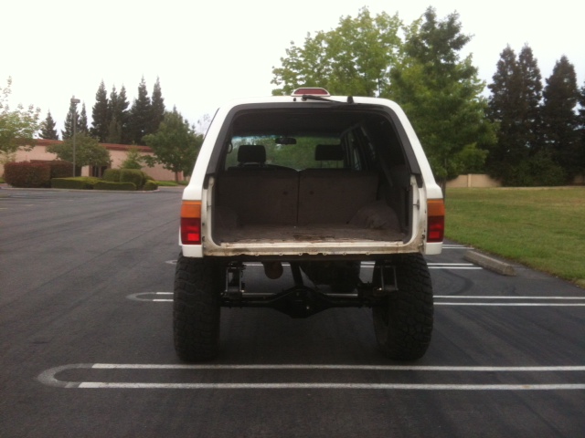

Do you think you could take a pic of the cut area looking up at it? Im getting ready to do the same thing and wanted to get an idea of the filler pieces im gonna need. Also what are your plans for the tailgate, since it hangs lower than your cut?
Looks great by the way!
Yeah I'll post a pic this afternoon. I'm planning on building a tire carrier bumper that wraps around the sides out of square tube. Not exactly sure what the dimensions will be yet, I know the sides will be larger than the rear but I just haven't hashed that out yet. The reason I chose to cut that area out was the stock bumpers hang too low and whatever bumper I make I'll be sure to have it at least 6 inches higher than stock hugging the body. Also where I have my tire placed in the wheel well when the tire up-travels it would have hit the bumper.

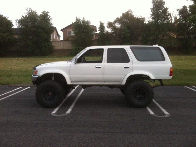

Well It's not done but I had to drive it today. I finished the rear Chevy swap but now it leans to the left and I don't know why!!!! I still need to cap the underside of the quarter panels build the bumper and mount the rear shocks. I figured I'm just gonna wheel the crap out of it and hope it settles!
The more I look at it though the more it drives me crazy!!!!! I guess that's what you get when you run RUF and some old Chevy springs.
