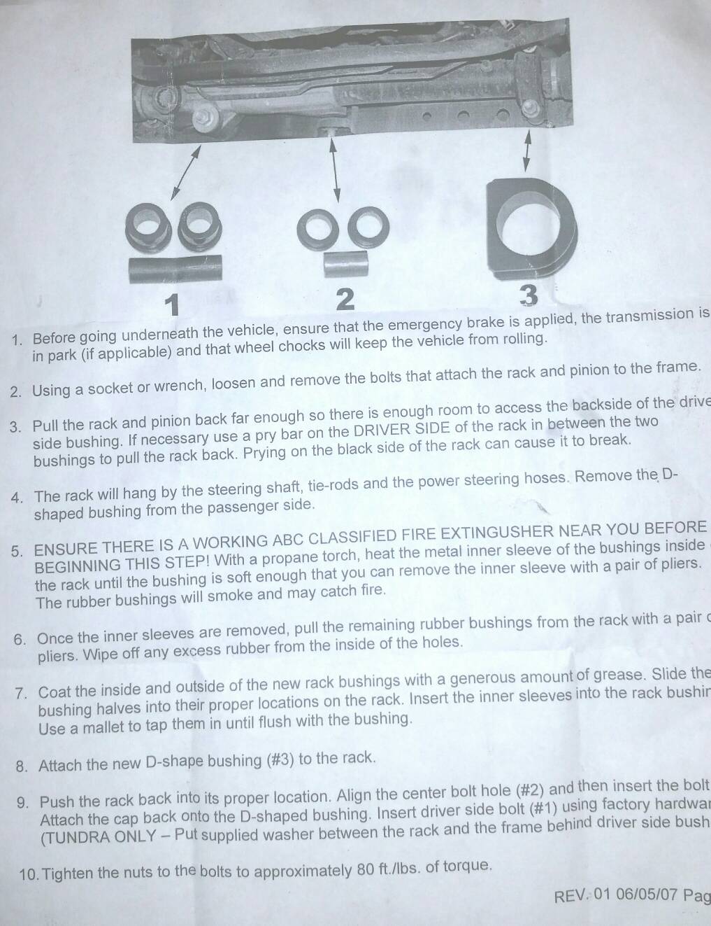

Damn this video would of been a life Saver for me. I searched for a long time before installing and your video is the best I've seen. Just a few days late.
The only thing I did different from Total Chaos directions was I took off the passenger side arm. Looks like you took off the drivers side. I didn't want binding, so that was the reason. I also had to clean the long bolt side because there was gunk build up inside. I mean thick gunk. The dremel cleaned it up nicely.
Your Energy Suspension System bushings went in nice. My bushings were a tight fit, even with the grease. Didn't go in with just my hands.
Here are the directions they gave me. The Torque are 80 ft lbs on the paper and you said 123 ft lbs for the middle/passenger nut/bolts 141 ft lbs. Looks like I have to tighten some bolts 1 more time. [emoji35]
Dude I love ( but really h8) how instructions make it seem so simple and you get to step 2 and start whispering swear words that shouldn't even exist! Hahahah.
It's probably a good thing your bushings were tight. Just means more stability.
Glad you got it done but at the end of the video we have the torque specs from the Toyota service manual with the torque specs again just to clarify if you missed it throughout the video
Yes it's done and all though I was doing it by myself with hand tools, I'm glad for people like you that make videos to make other people's lives easier. Much Mahaloz and Aloha for the 411.

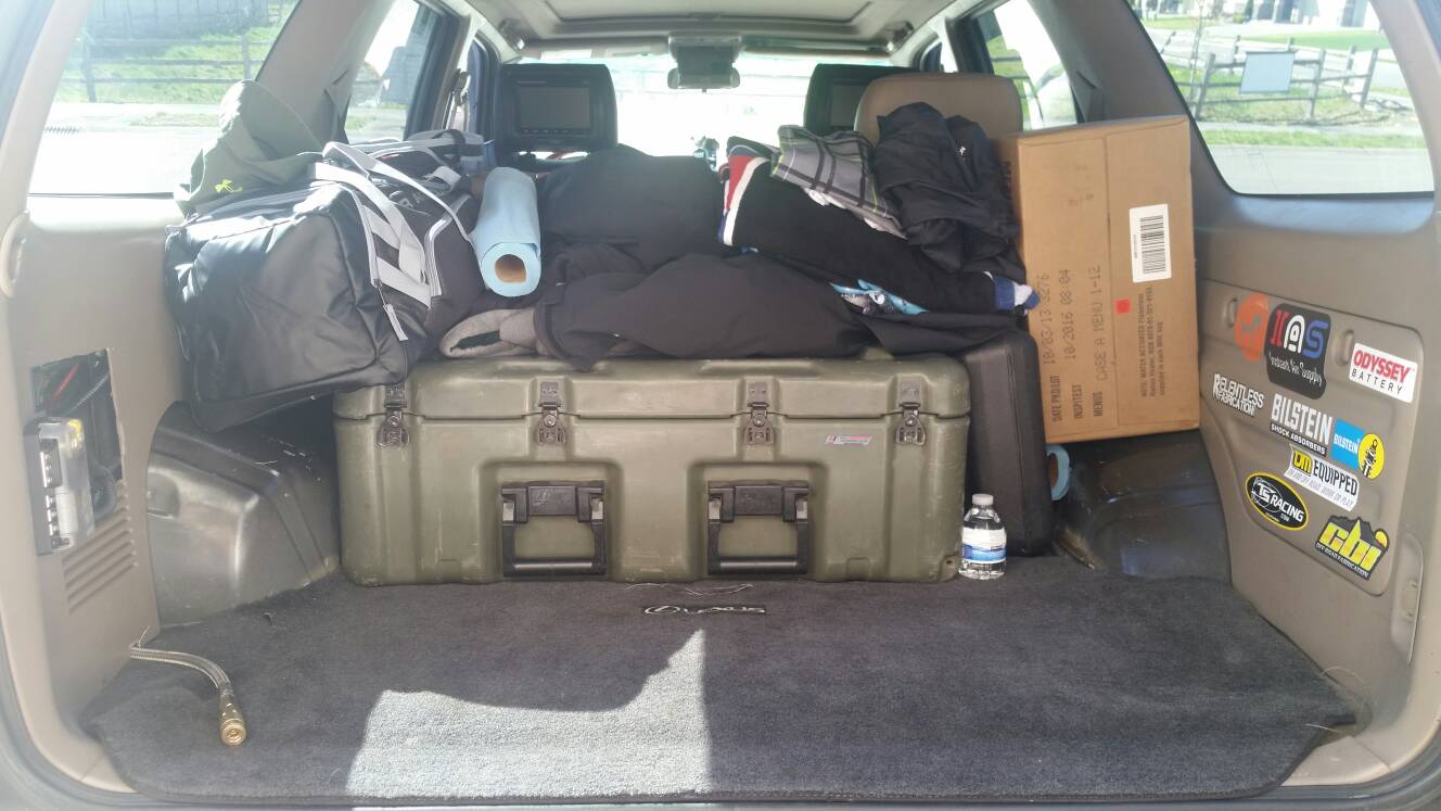

Put all my recovery gear and tools in my Medical Chest Case 472-MEDCHEST3. Also took out my 3rd row to get ready for my rear drawer system.

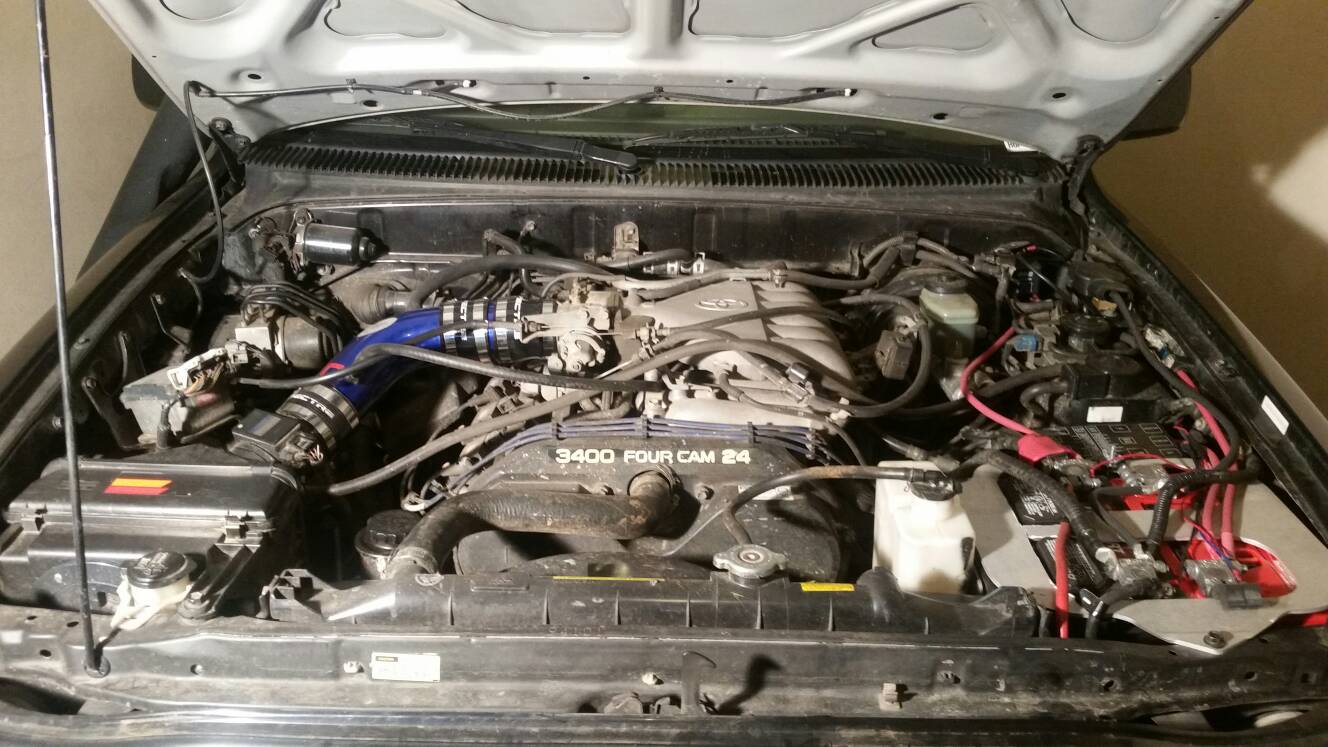

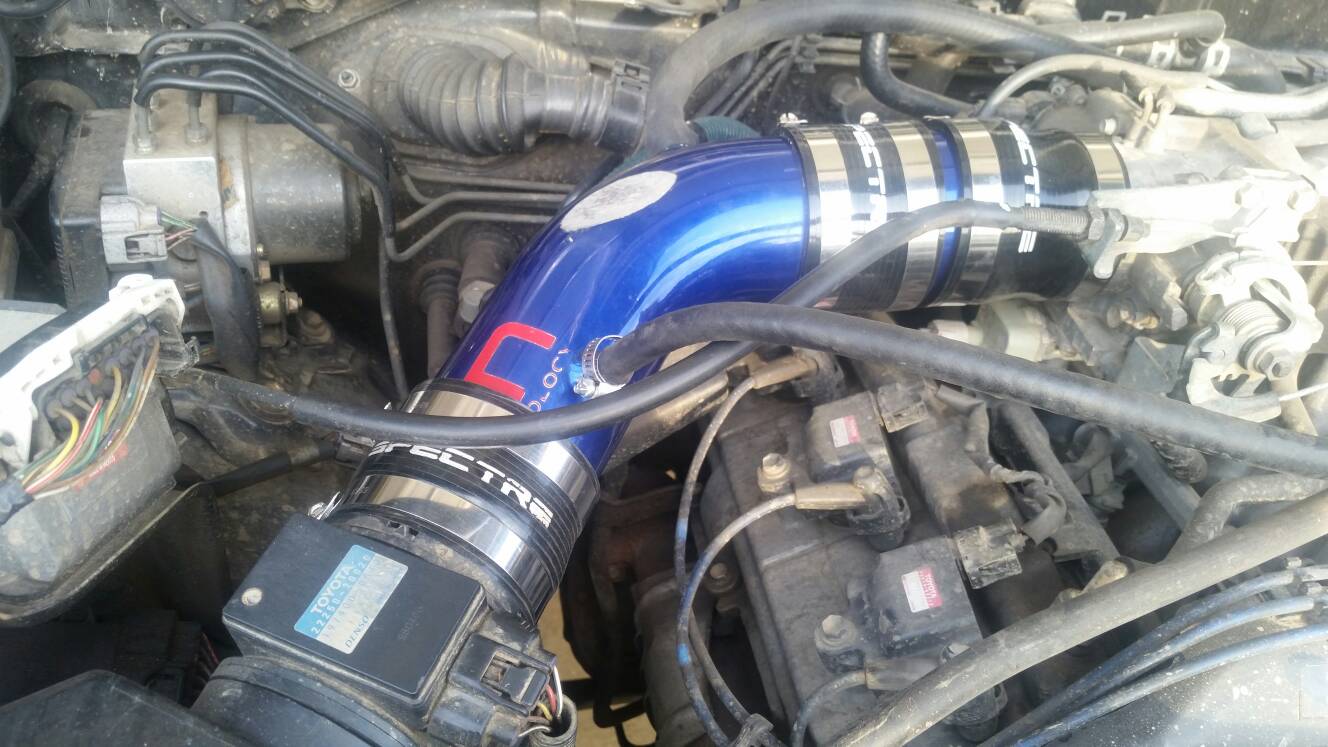

Just modified this INJEN intake from a IS300 I got from a junkyard. A little scratched up, but it started right up. Not bad for $20. I spent $41 total for the SPECTRE, INJEN, & hoses.
sent from my Hawn fingers
DAMN!!! your finds are spectacular....
i just bought an AIRRAID for $90 and its not as shiny as this!!
these tubes make the engine loud!!!!
I didn't drive it around yet. I just installed it and turned it on just to see if it would start up. I'll see tomorrow
