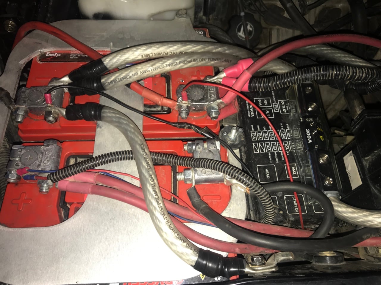

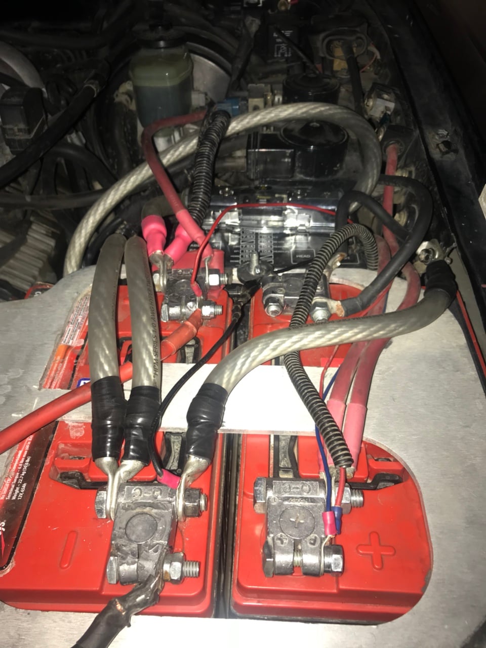

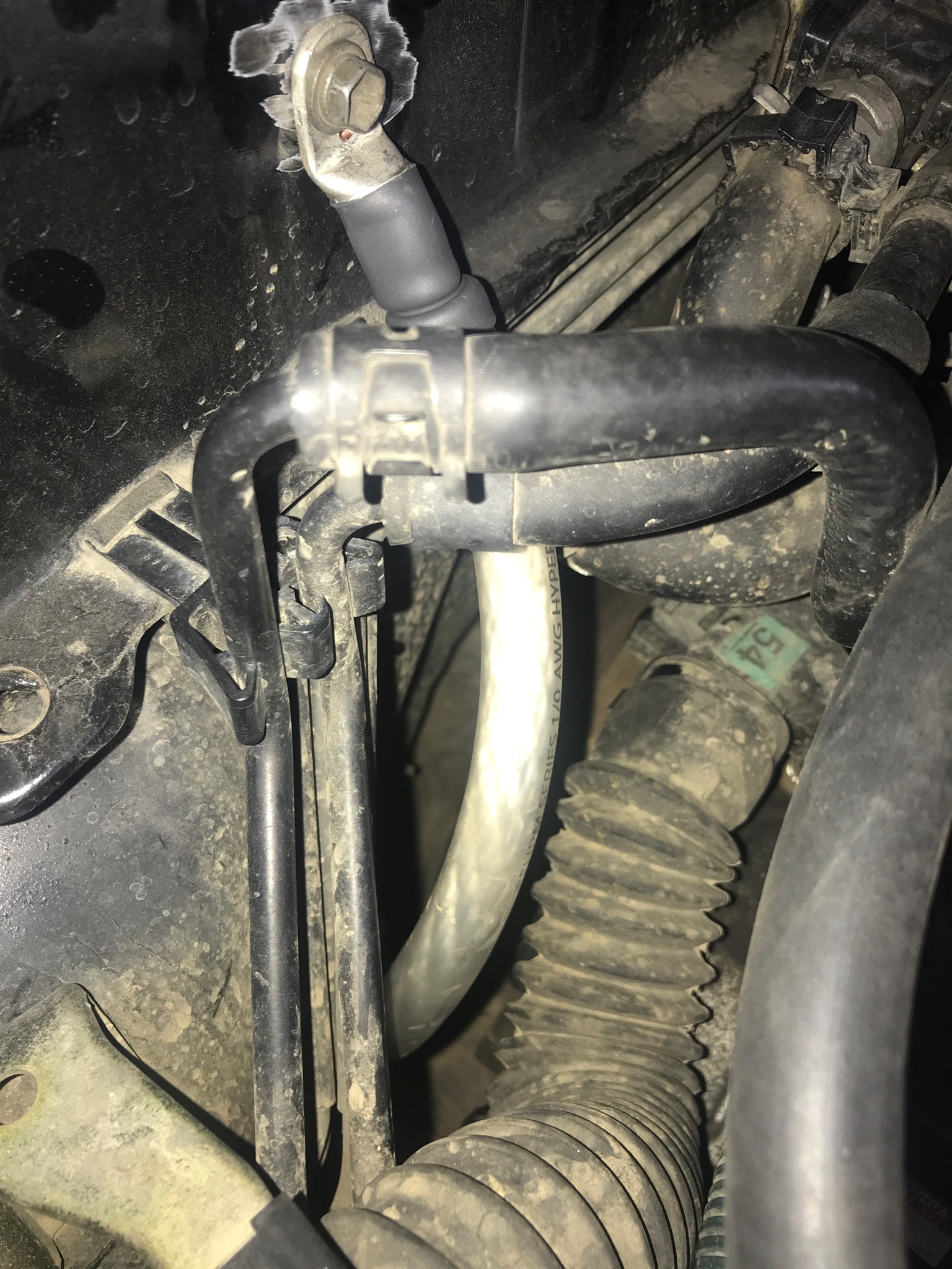

So I redid my BIG 3 4ga wires to the BIG 4 1/0 wires from CARPROS down the street of me.

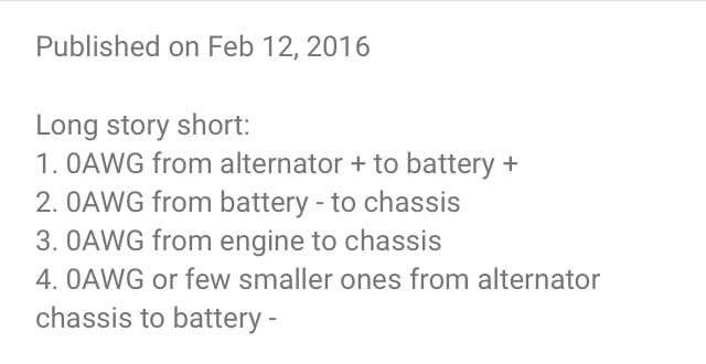

I also upgraded my engine to chassis rear ground to 1/0 wire. I never seen anyone do this, but i figure I might as well complete the ground if I’m going all in.

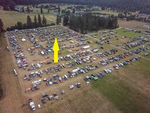

Went to the NWOR 2018 at Plain,WA on Thursday and Friday
Dang. I wish I would have run into you there. There were a lot of Washington people spread out all over that thing. We rolled through the gate with nine rigs, but I kept running into tons of people from 4Runners of Washington there. It would have been nice to check out your rig in person and talk a bit. Did you have fun?

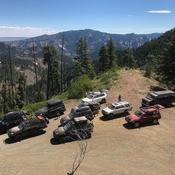

When did u het there? I only went from Thursday- Friday. I left at 2pm Friday afternoon because I had to chaperone my 13 yr old niece to the airport Saturday morning at 7am. My truck was displayed in the Badland Bumper Booth.
Ahh. I was there from Thurs-Sun. Somehow I missed your rig. I am pretty sure I would have recognized it if I saw it. I probably walked right by it. Next time.
On Thursday I was the only guy in the booth. Friday was when I was in the back of 2 red Toyota’s. When looking at the booth the Red 2nd gen had a 3.4 motor, SASed, with a tow in the rear. In the rear of the Blue 10x10 tent was a 04 Double Cab Taco set for Overland and my Truck behind the 2.

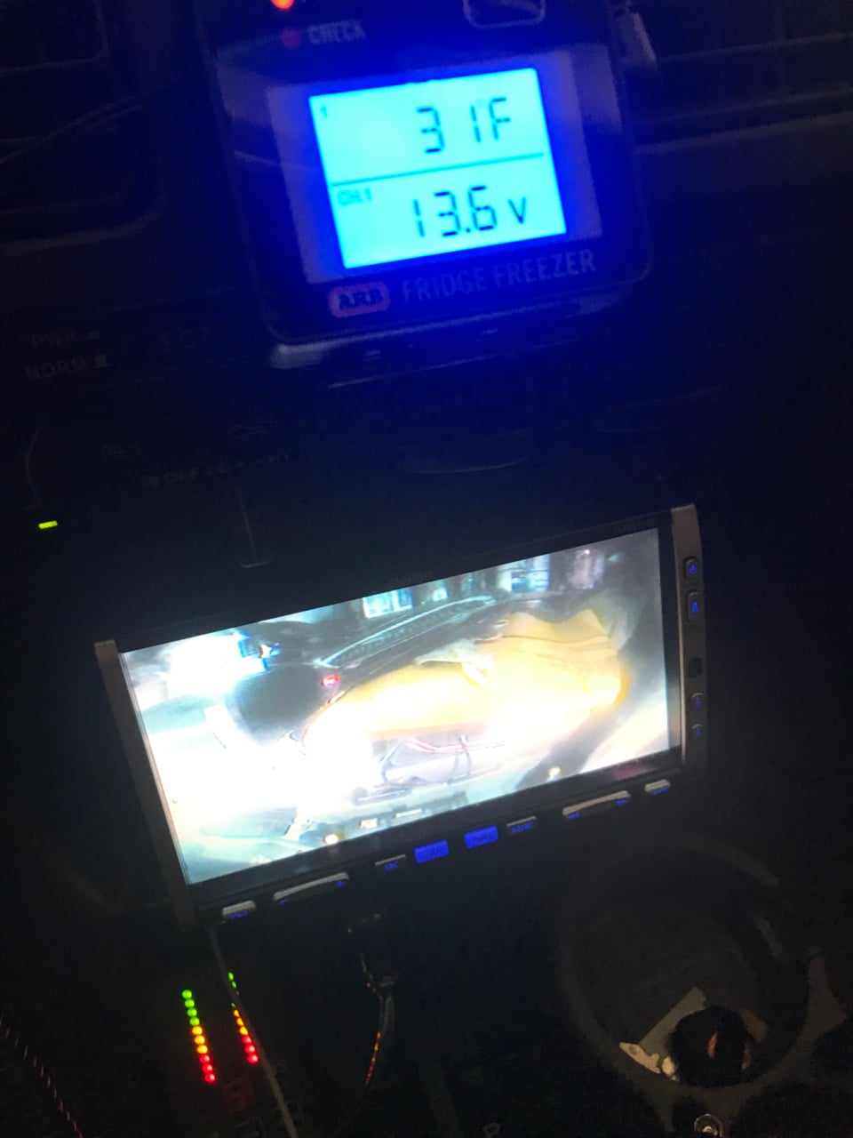

So I got a ARB 50qt Fridge/Freezer and boi it’s gude when outside iz 84 degrees
