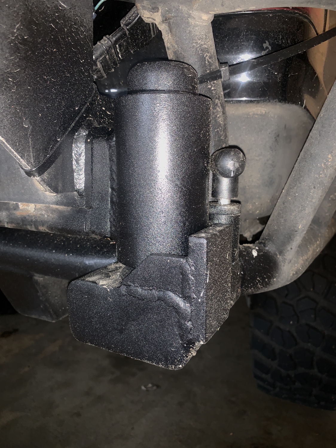

Completed and spayed. I also had my friend weld in a small plate to stop the arm from swinging fully out and crack my tail lamp again
Makes it easy to change the bulb !
Haha that’s the first thing that came out of my 9yr old son, but I glued and sealed the cracked parts up the day after we got home from camping. Besides the bulb cant come out threw the lens side. U would still have to unscrew the 2 10mm bolts and remove the tail lamps from the body to change the bulbs

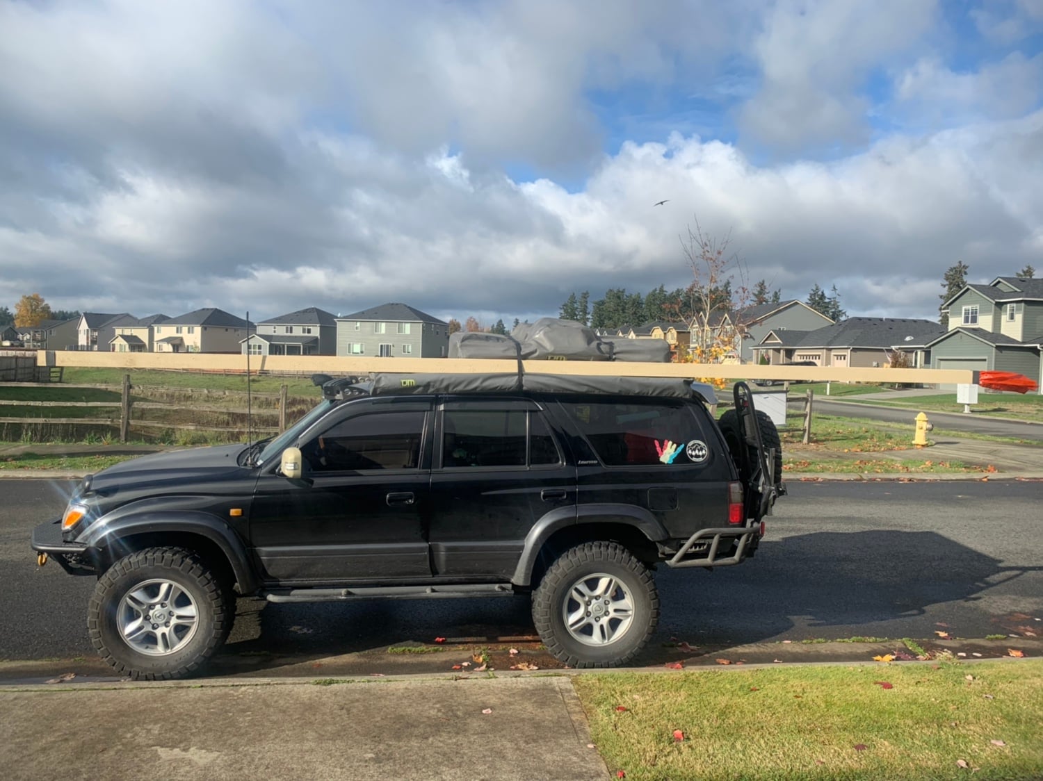

Nothing to do with the truck, but transport 20’ window trim that had to be replaced because of water rot

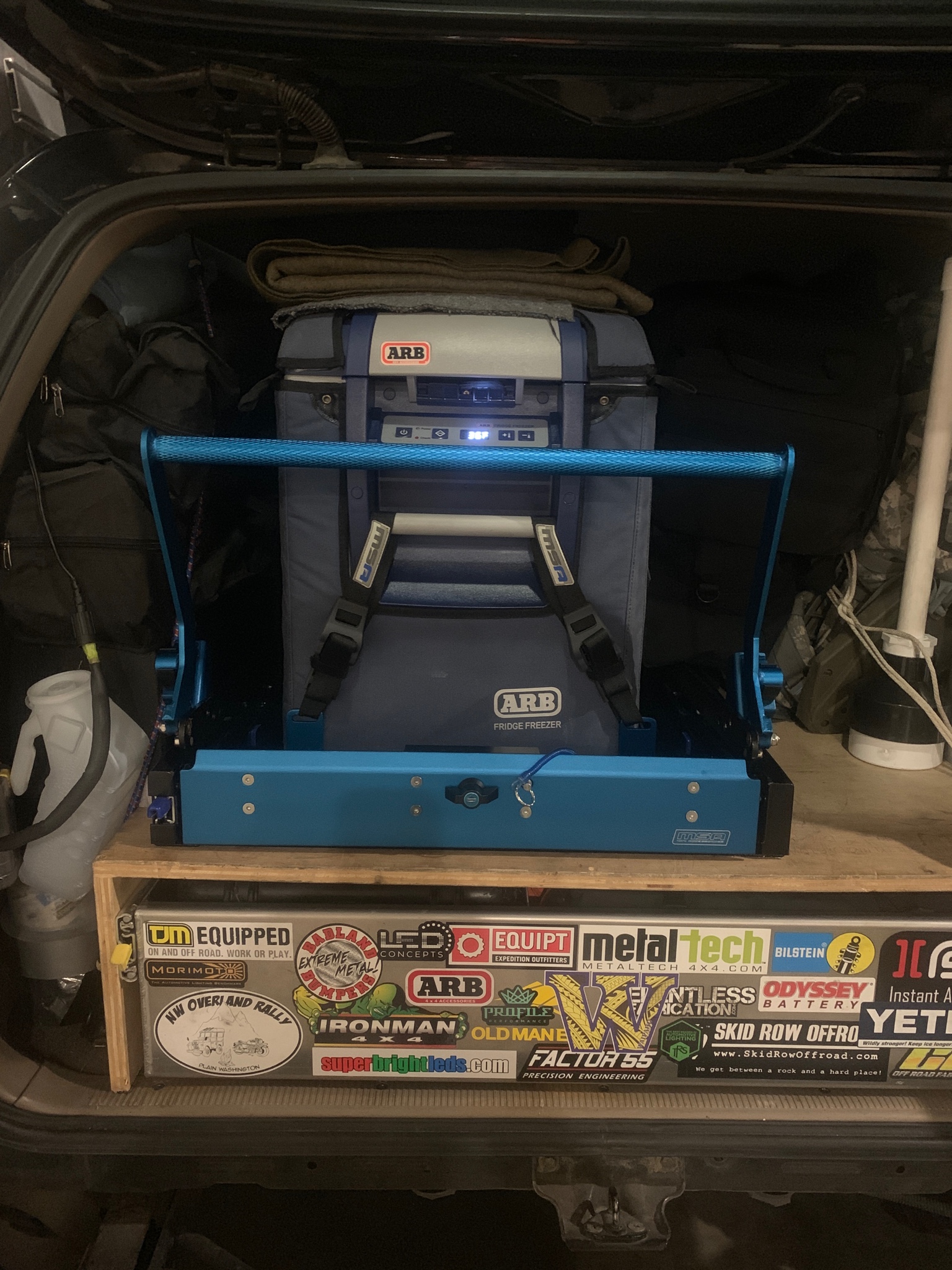

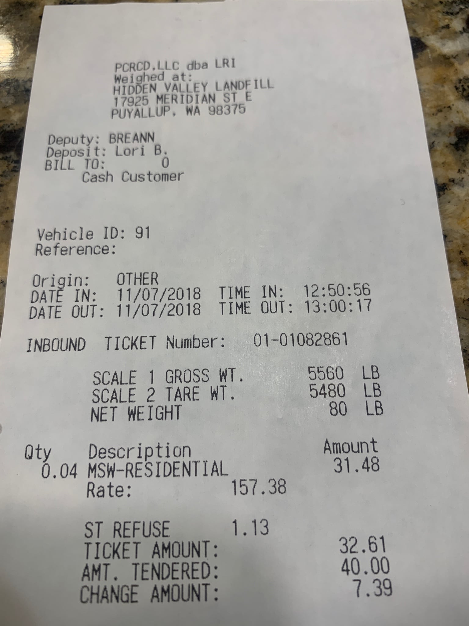

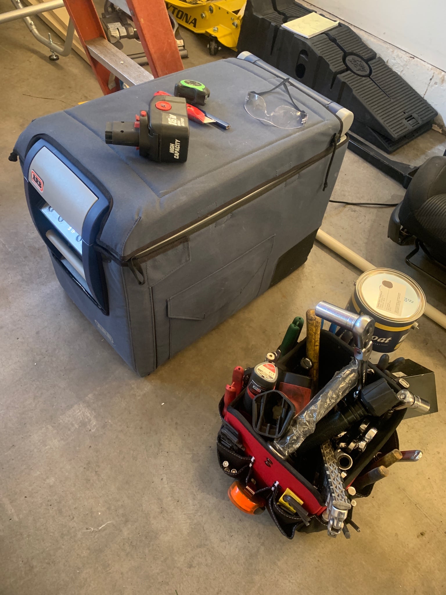

Well I’ve been working on my house and I had to throw sum rubbish away at the dump. Keep in mind all I took out wuz my ARB fridge/freezer and my bag of tools
I weighed in at 5480lbs
So that means when I go camping, I’m easily over 6000lbs.
These things get heavy fast! LOL. I think the last I checked, without tools or any recovery gear, it was just under 5000 lbs. I wonder how much the RTT weighs? Armor adds weight pretty fast too. So my full skids, sliders, front and rear bumpers are a healthy chuck of my overall over stock weight.
This is one of the things that really makes me think about how I might want to approach rear storage / platform / drawers options. Right now I just have two, and if camping three Sterilite totes, but I don't have any wood made structures as of yet. Those can add some weight.
But you have a cool aluminum drawer storage system don't you? How is that working out?
Howzit Road Bull. Happy Thursday. I also had full belly skids 3pcs. I took it off in January when I decided to SAS my truck. Yes I do have a Aluminum 1 drawer, but split 60/40 inside. My slides are rated 500lbs, so im gude in weight. I always carry my tools, recovery gear, ARB fridge, bug out bag, etc, etc

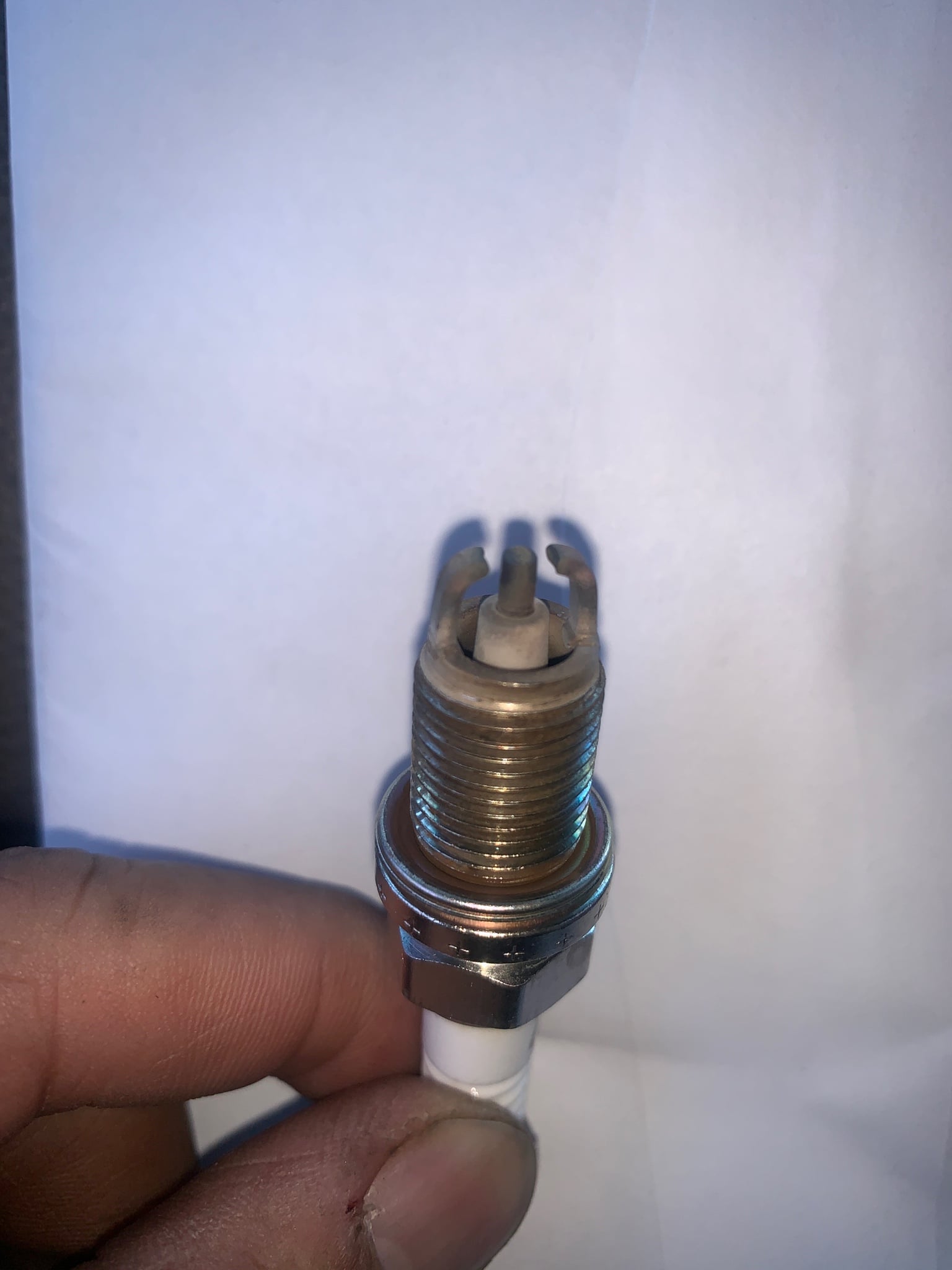

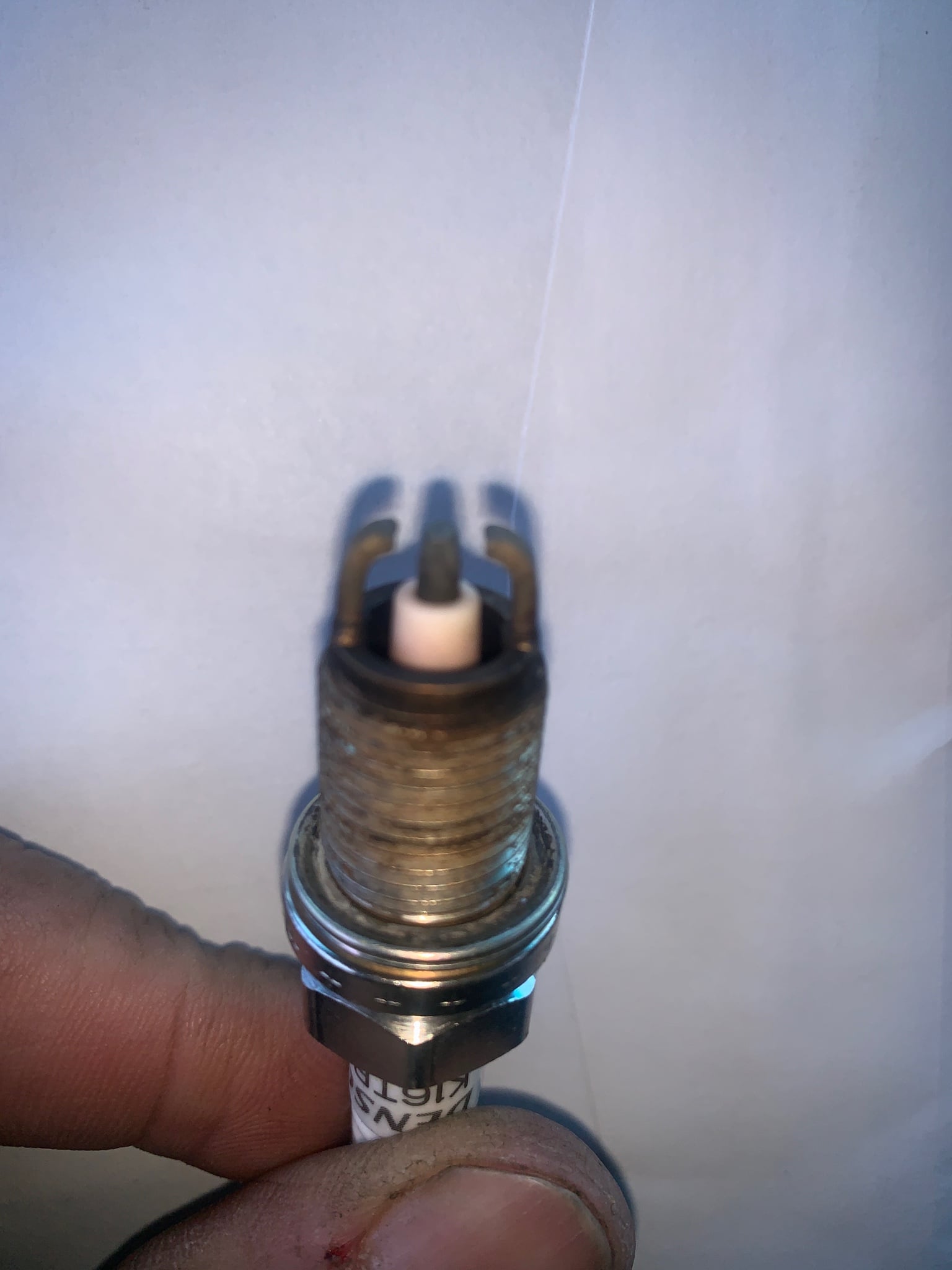

So my truck been missing every once in a while for the past 6 months. I did maintenance (Plugs,Wires, and Air filter) in 2016. I usually write the mileage, but I forgot. Well it’s December 3,2018. So I changed all 6 spark plugs with OEM DENSO K16TR11. 5 out of 6 plugs looked like this.
This plug wasn’t the same color

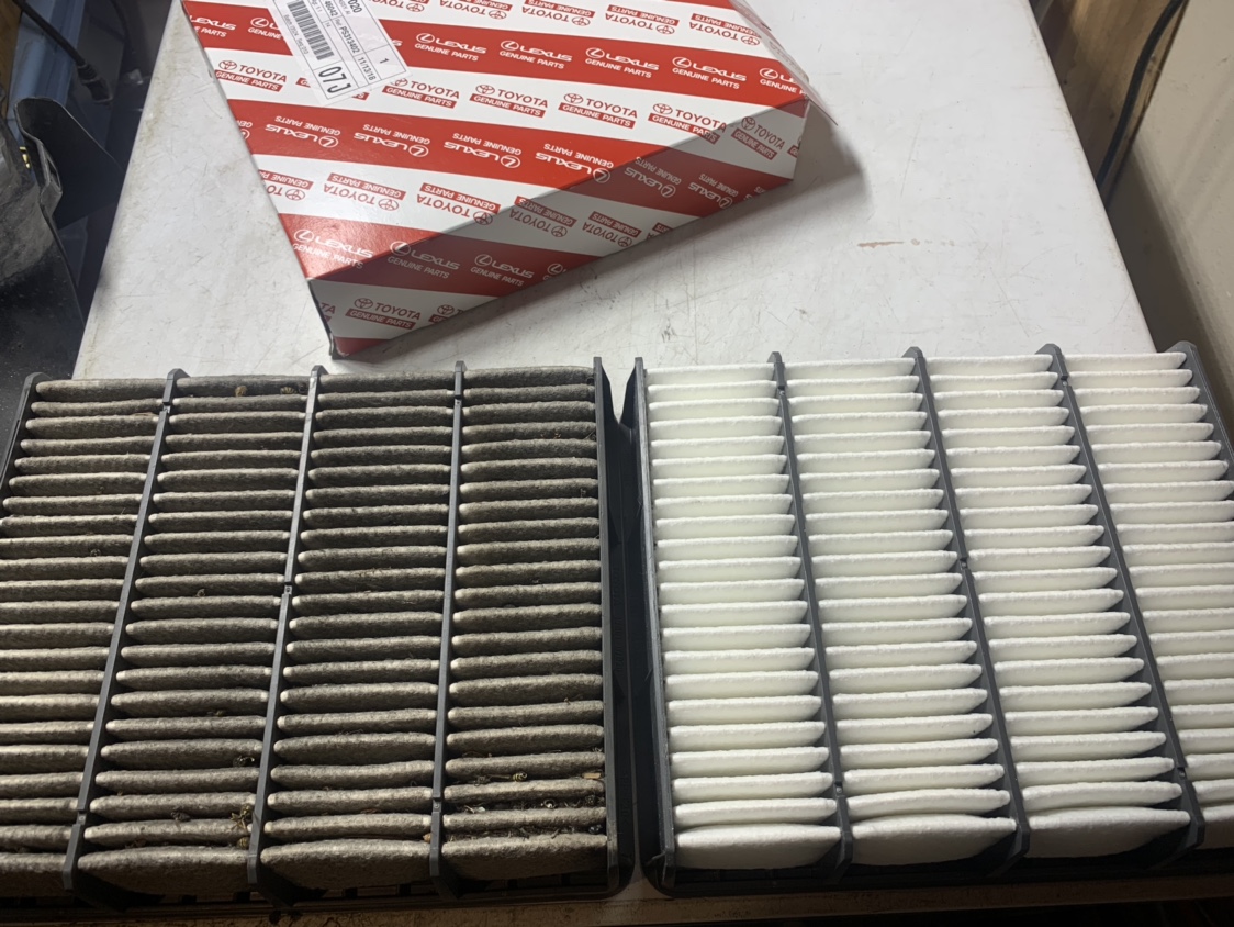

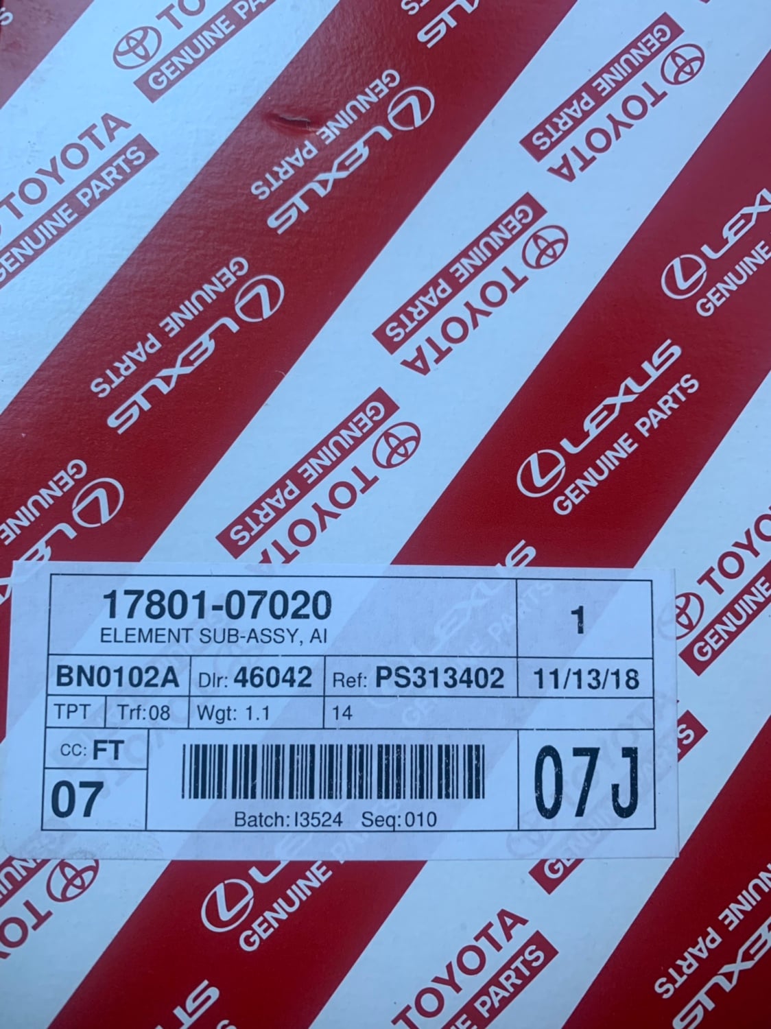

Then I changed my air filter
My coil packs are the OG from 98, so if the problem still exists I will start changing them soon.
Picture of what 2 years looks like on a filter. The dirty filter is also Genuine Toyota. Because of my snorkel, I have a lot of [emoji219] on the filter. I counted 10.

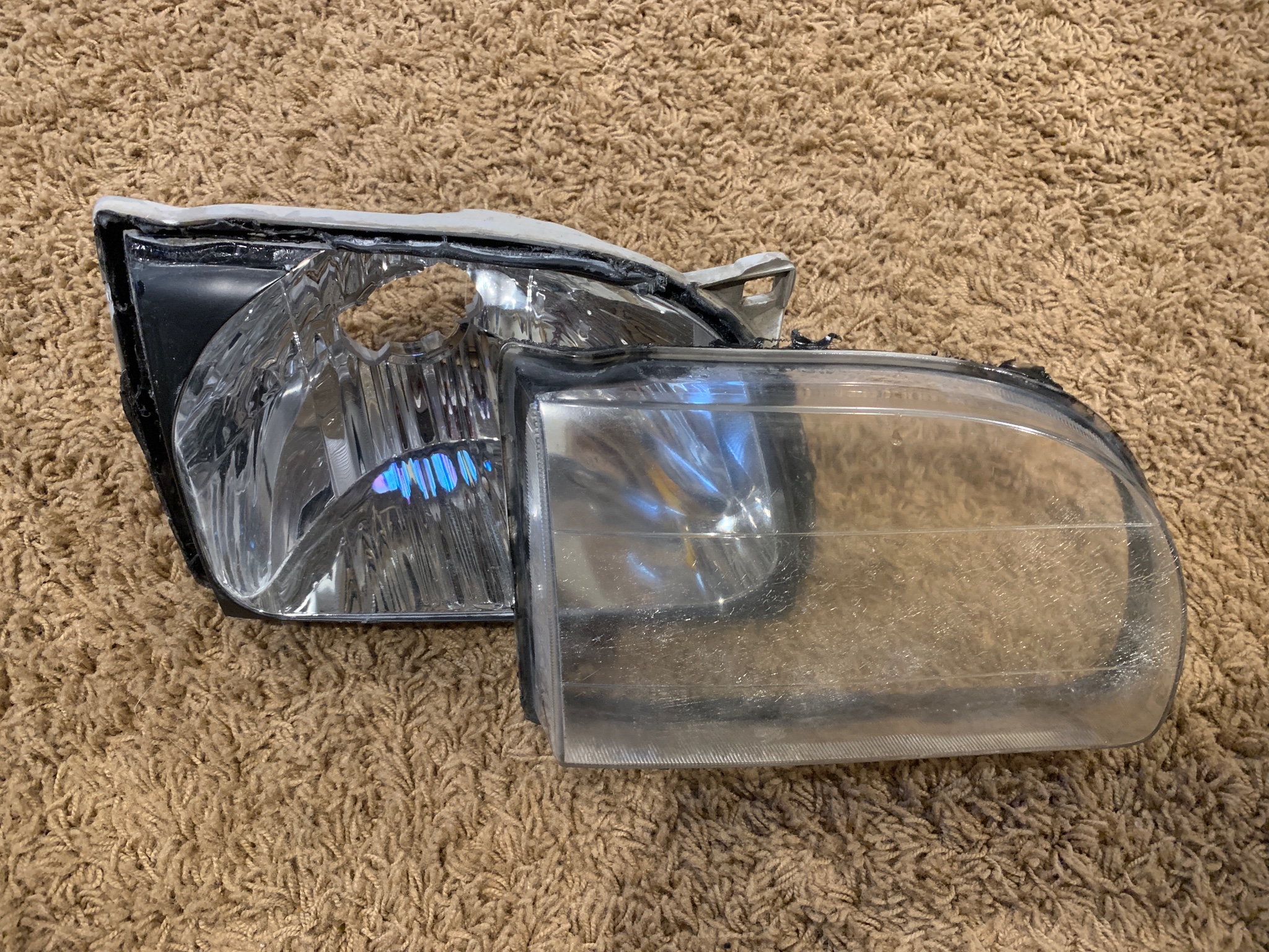

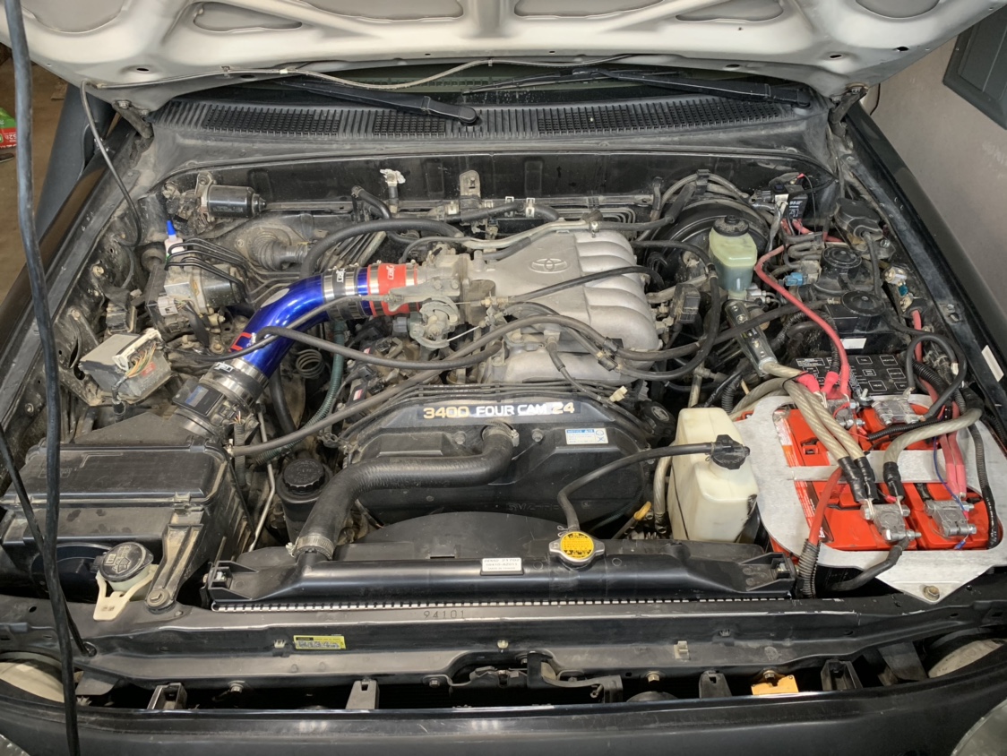

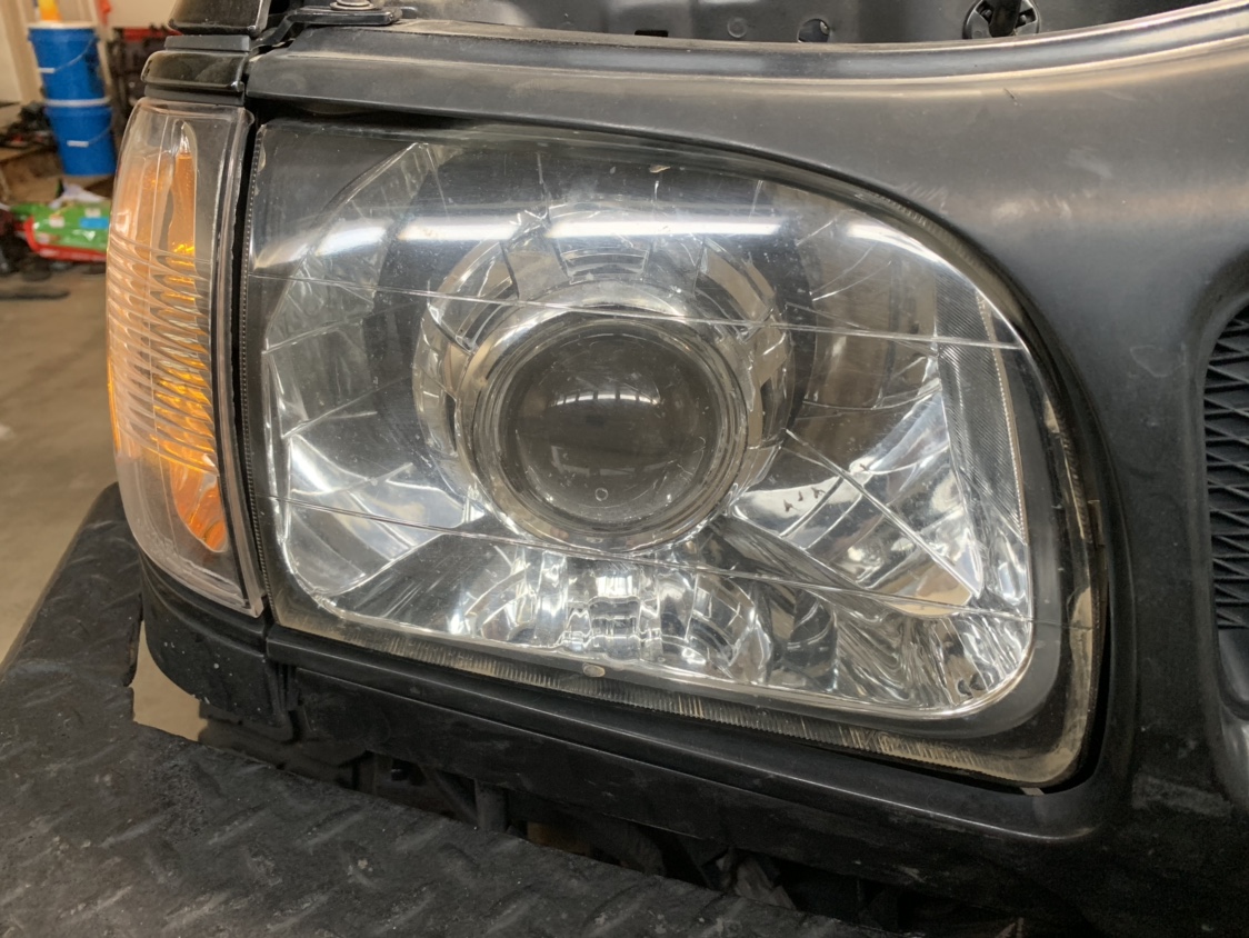

Cleaned the engine bay a little and fixed my R headlamp. The highlight wire came out and I had to separate the lens from the bucket just to plug it back in. What a nightmare.
Im goin to be installing another set of BI-XENON: MORIMOTO MINI D2S 5.0, HALOS: PROFILE PRISM (RGB), and other cool gadgets from Morimoto

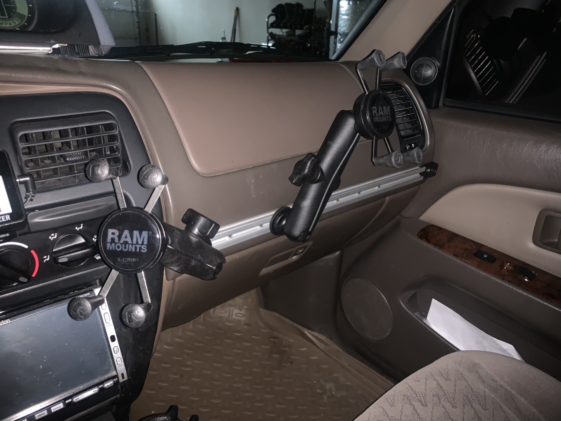

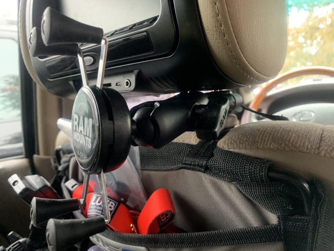

I already had a Ram Mount X Grip sucked up to my windshield, but it was getting in my way of seeing things in the night. So I searched Ram for other solutions and here is what I came up with.
This is the back of the driver seat where my little me sits
I’m currently working on the top of the center console area with the same aluminum rail system by Ram. I still have to make a bracket for the rail.

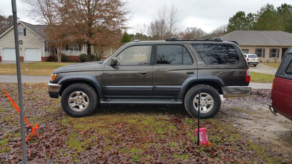

My New-to-Me '98 Limited
I bought mine off a used lot a couple of months ago with 238K on it. Unfortunately some nitwit before me worked on the rear end, apparently screwed it all up, and it started whining at me about five weeks ago. Replaced the differential, and then the alternator last week. Except for that I couldn't be much happier with it. The leather is all good, all the doodads work (except the clock, big surprise there) and the moonroof doesn't leak. It's bone stock and I'm inclined to keep it that way except for functionality changes.
I bought mine off a used lot a couple of months ago with 238K on it. Unfortunately some nitwit worked on the rear end, apparently screwed it all up, and it started whining at me about five weeks ago. Replaced the differential, and then the alternator last week. Except for that I couldn't be much happier with it. The leather is all good, all the doodads work (except the clock, big surprise there) and the moonroof doesn't leak. It's bone stock and I'm inclined to keep it that way except for functionality changes.
These r beast built. So long u do preventative maintenance, your truck will go a long way. My truck now has 320K. I drive it daily, but only 5 miles M-F. All my miles r from taking trips in Washington, Oregon, California, Idaho, & Canada [emoji1063]

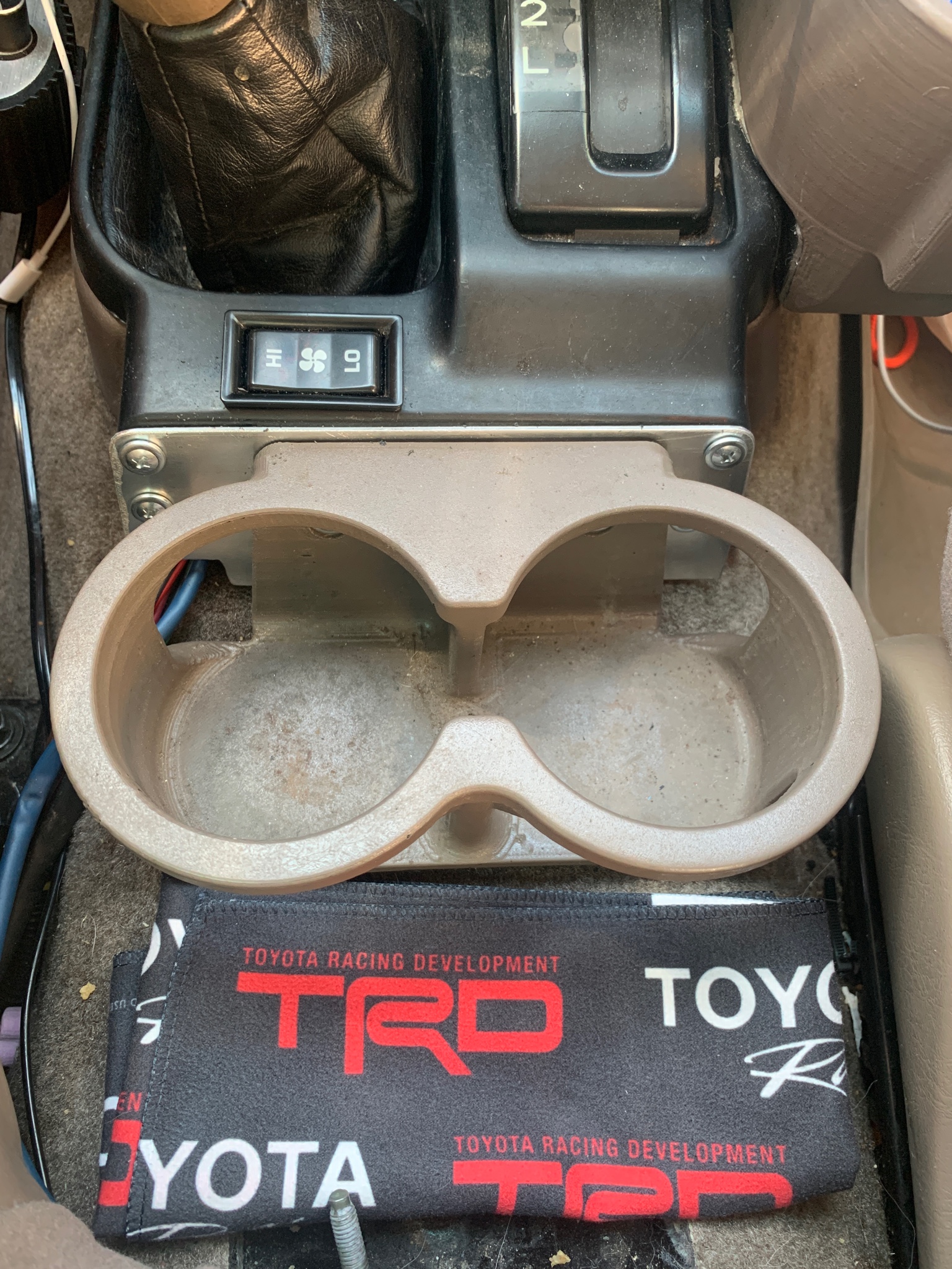

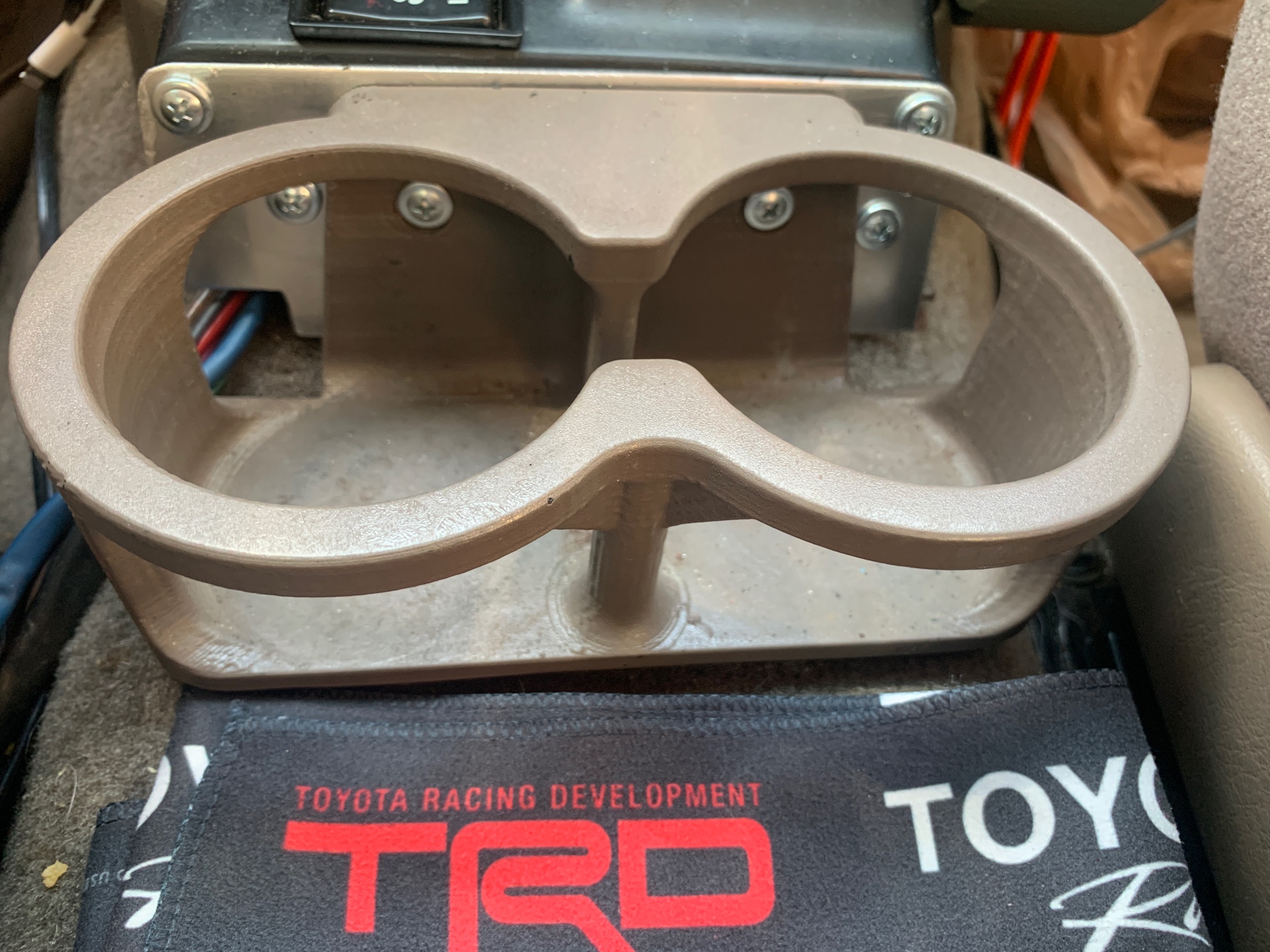

Reused my rear cup holder from my center armrest console. Put it up front attached to a aluminum bracket I made for the shifter console in the rear.
