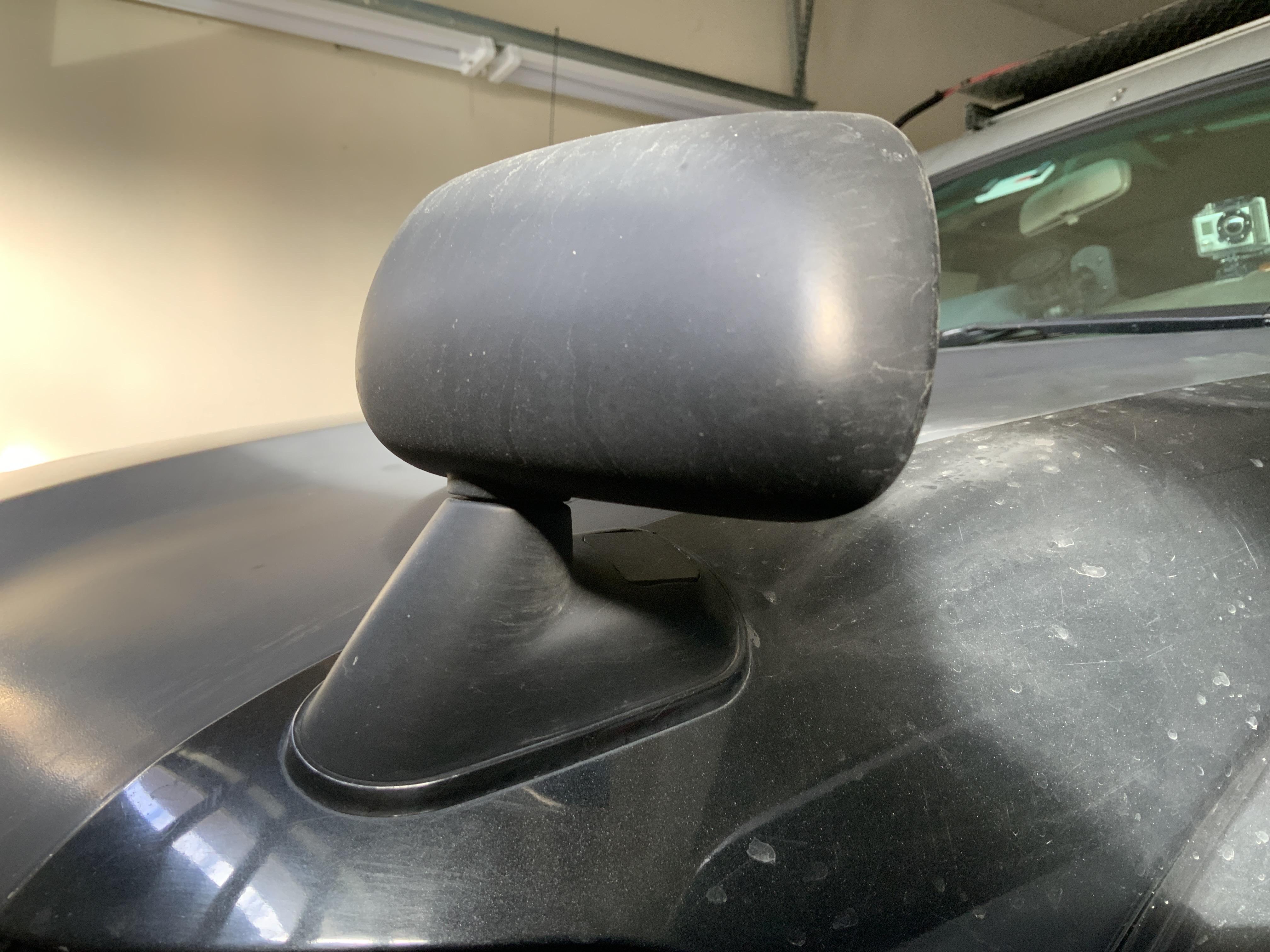

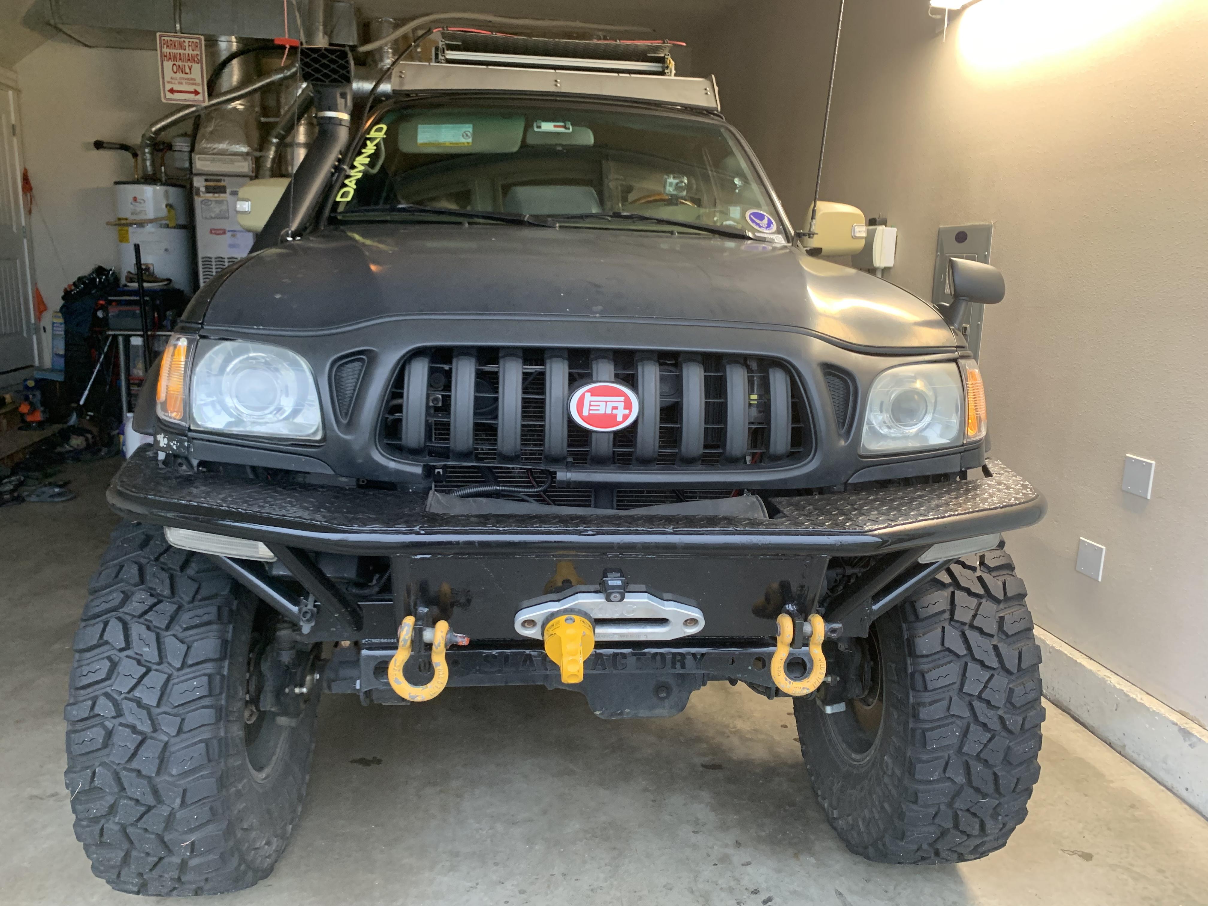

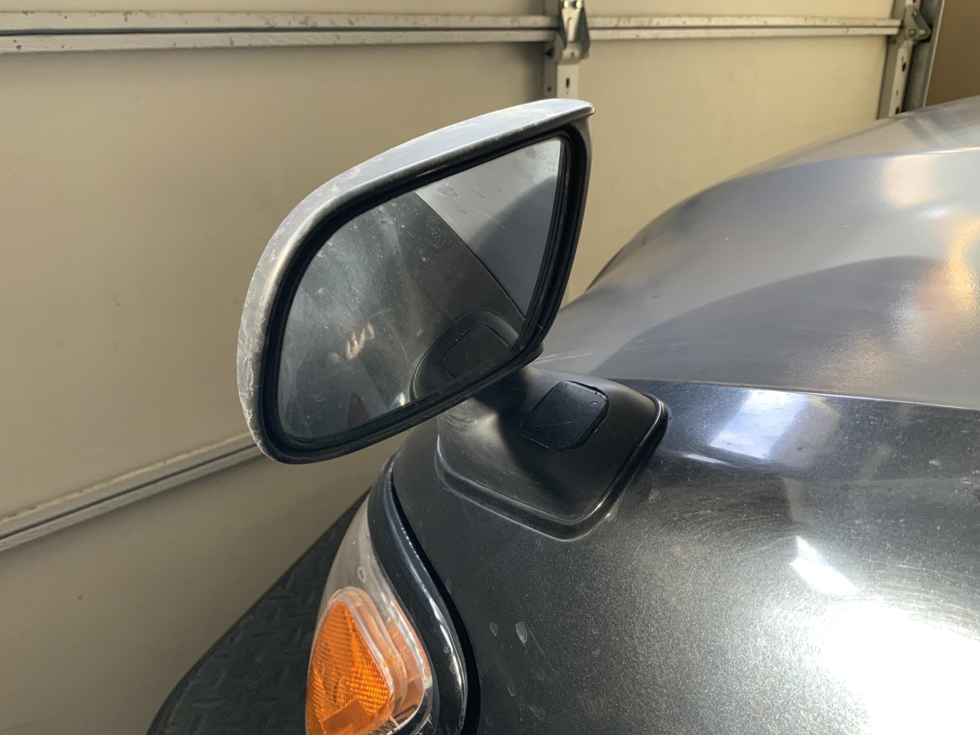

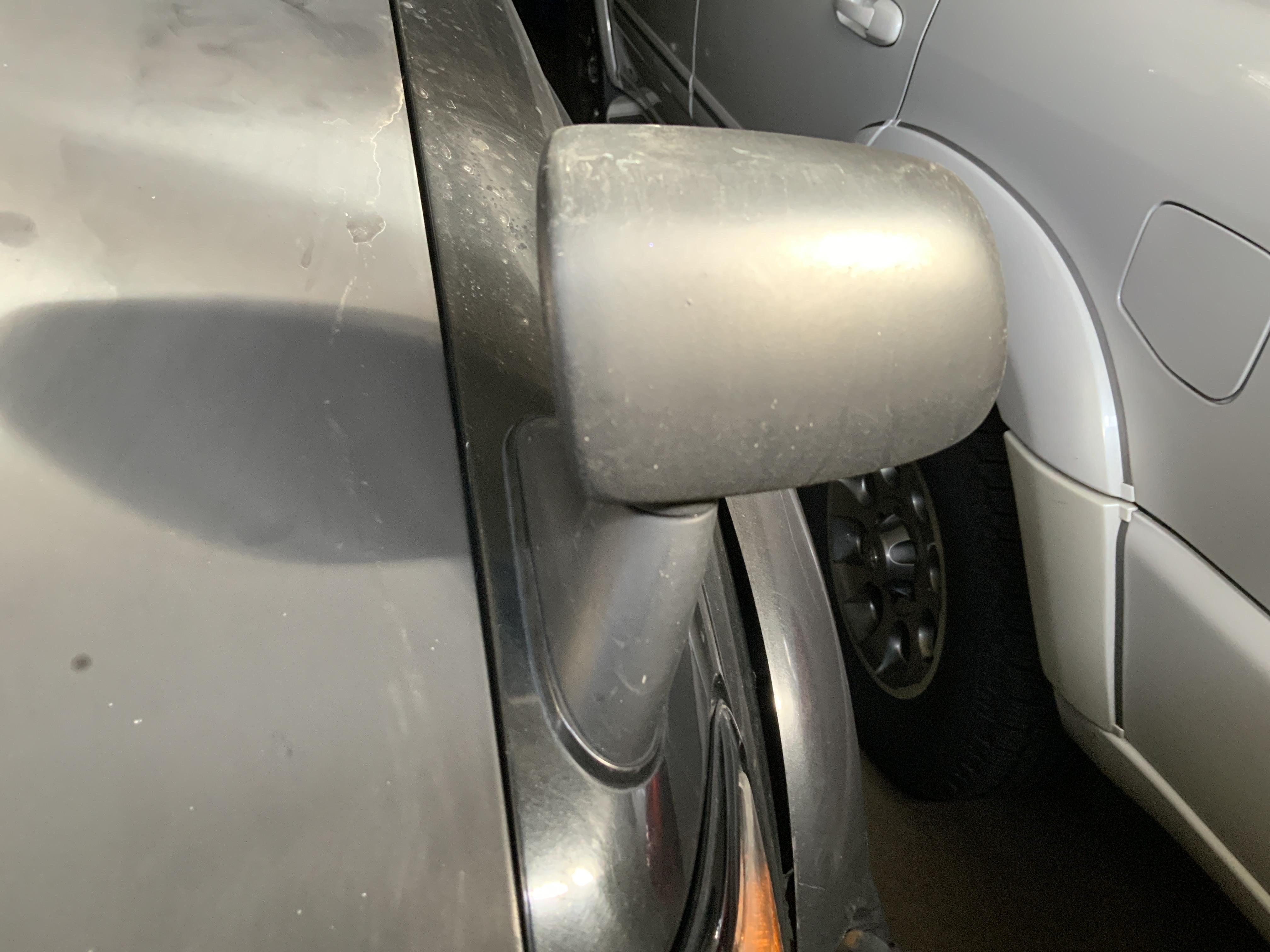

I love stopping in on your build thread and seeing all your progress// - could you post some close up pics of your JDM Hilux surf fender mirror?
I really forgot how I did it, but I know I looked on line and cross reference where the mirror was to the hood and the marker light. I used a nut and bolt to connect to the fender. The revit nut would of worked good in this application. Did you get one from Japan? [MENTION=139174]TW44LR[/MENTION]
No just wondering haha, it looks right man. Along with the whole Rig of course

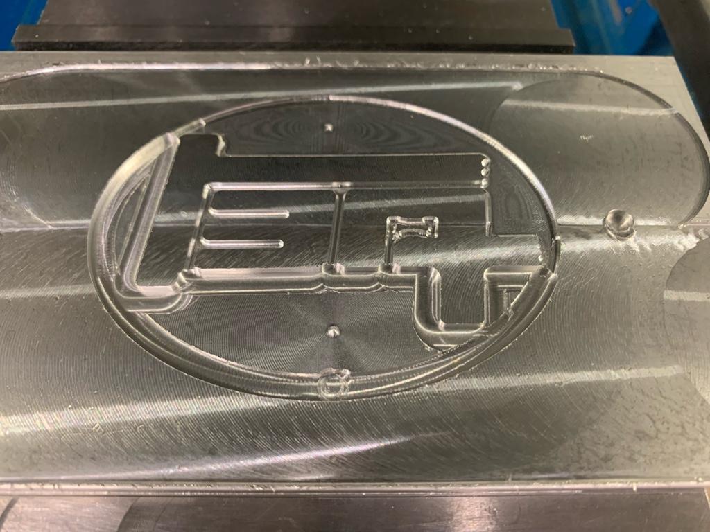

First attempt to cut my teq badge. Off that the far right the bit broke off with a plunge. I’m rewrote my g code to do a ramp on the last operation. I also adjusted my feeds so it doesn’t happen again. The bit broke on the 4th operation. I’m going to go at it again tomorrow morning 1st thing.

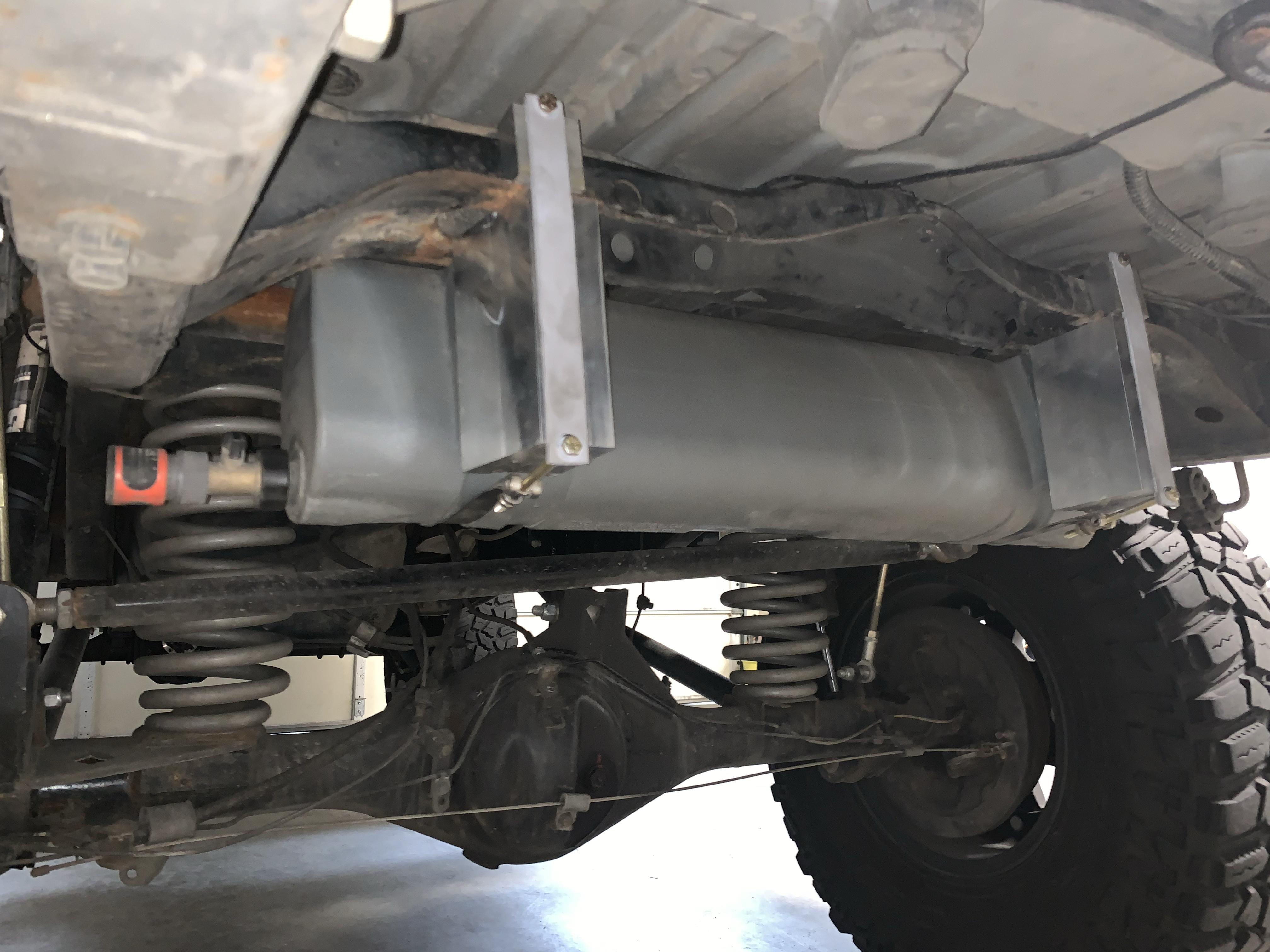

Made another bracket for the topside of the stock crossmember. The top of the crossmember to the bottom is 11 degrees, so I programmed the 5 axis CNC machine to cut 11 degrees. I also notched the bracket to except the one inch band to hold it in place. All 4 brackets are T6061 aluminum and were cut on a HAAS CNC machine

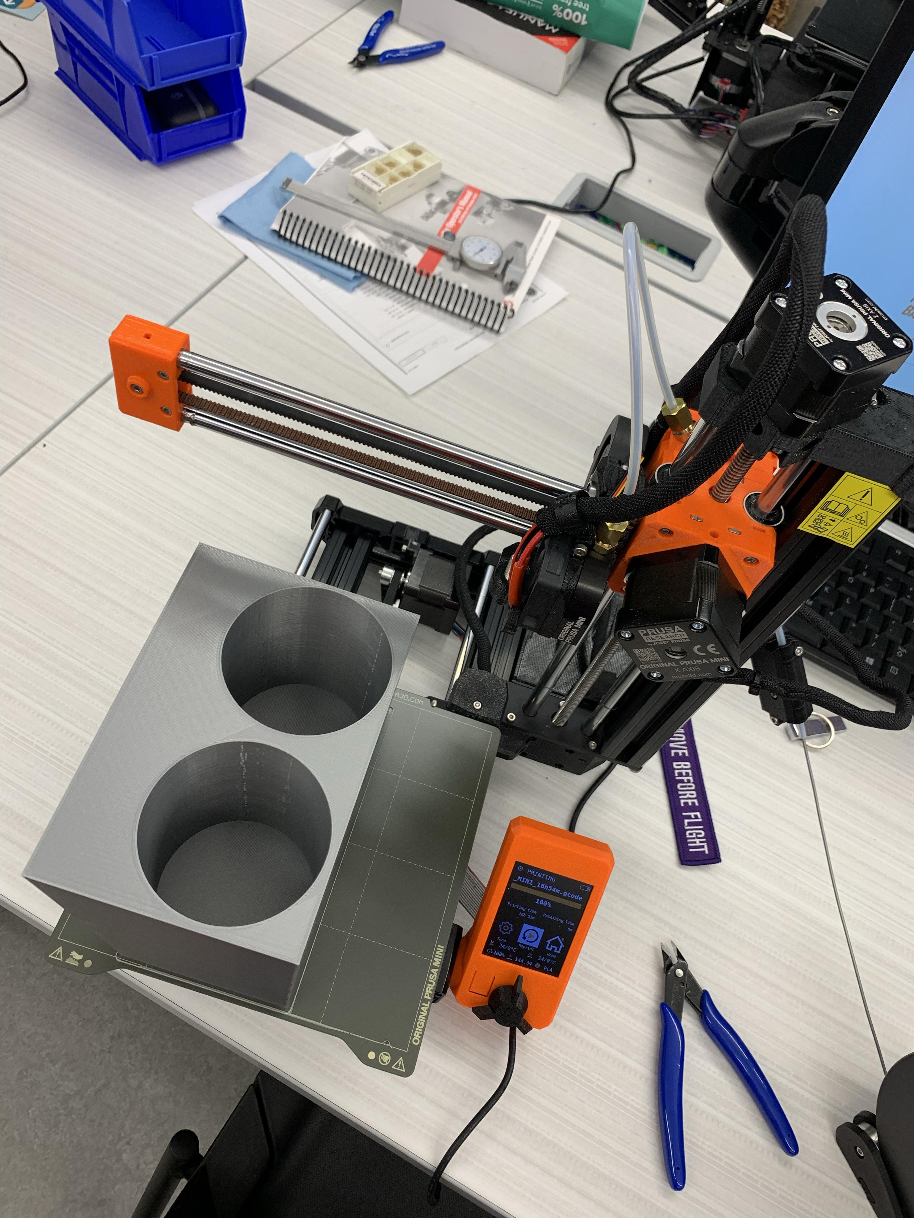

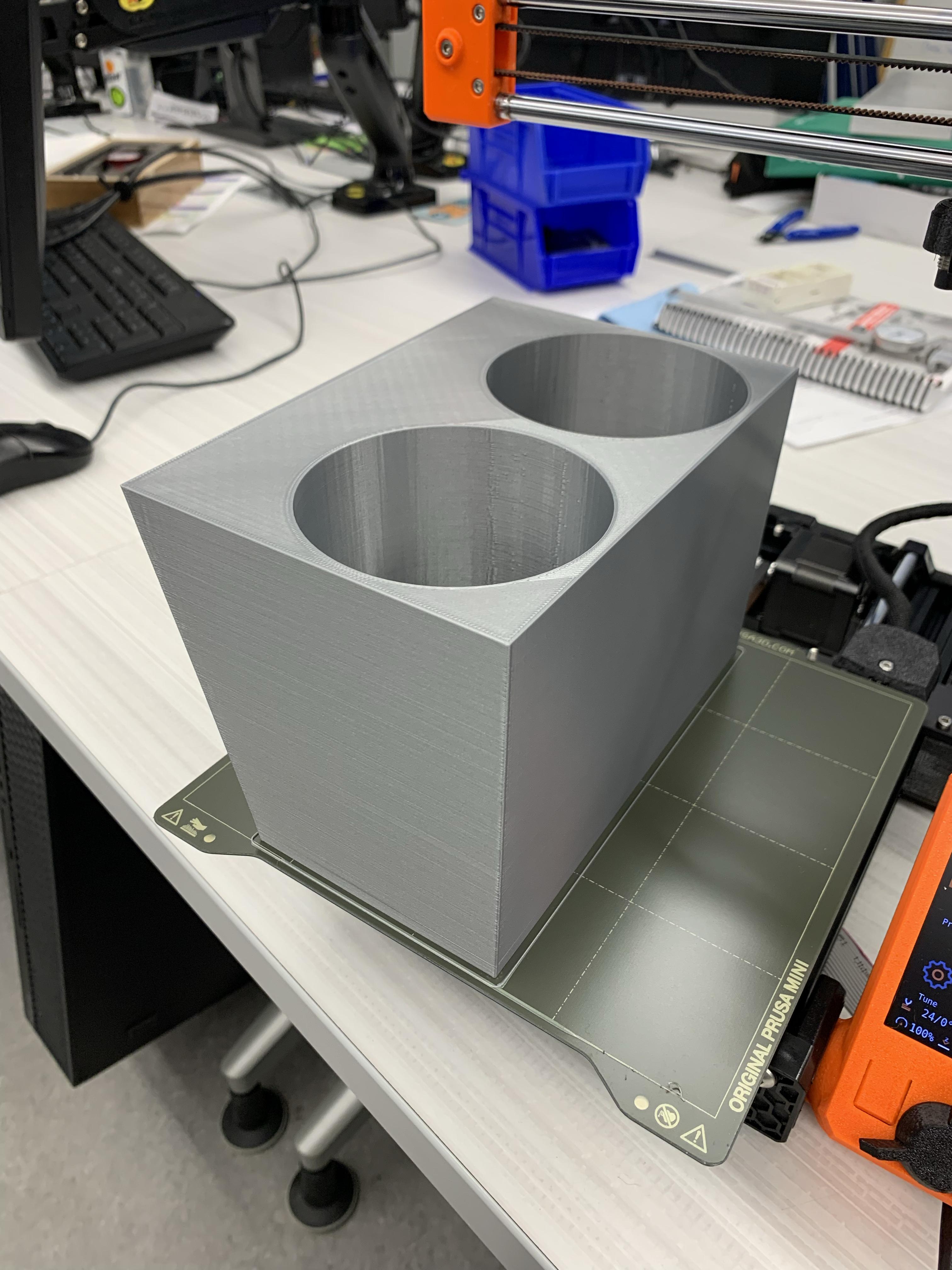

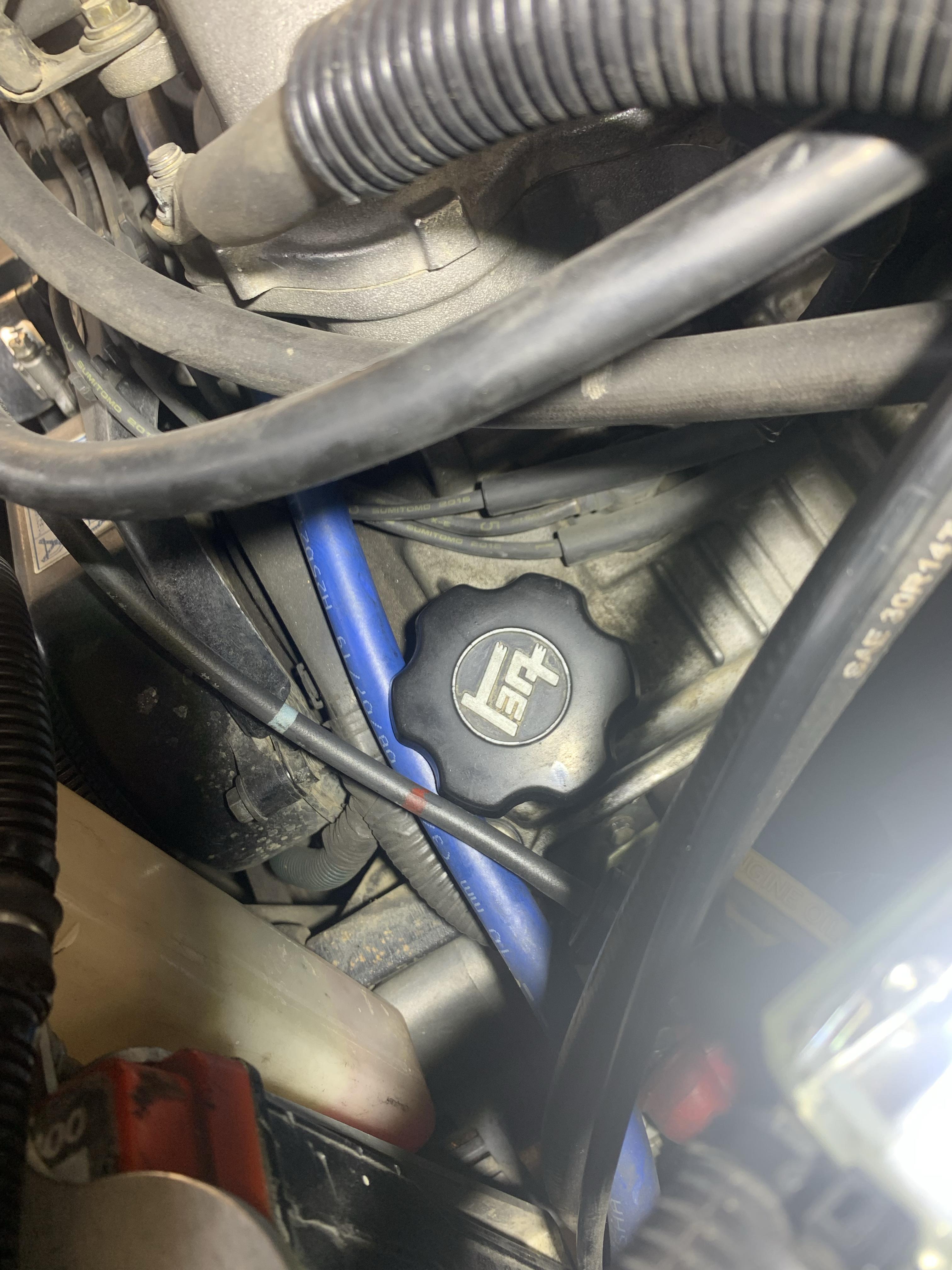

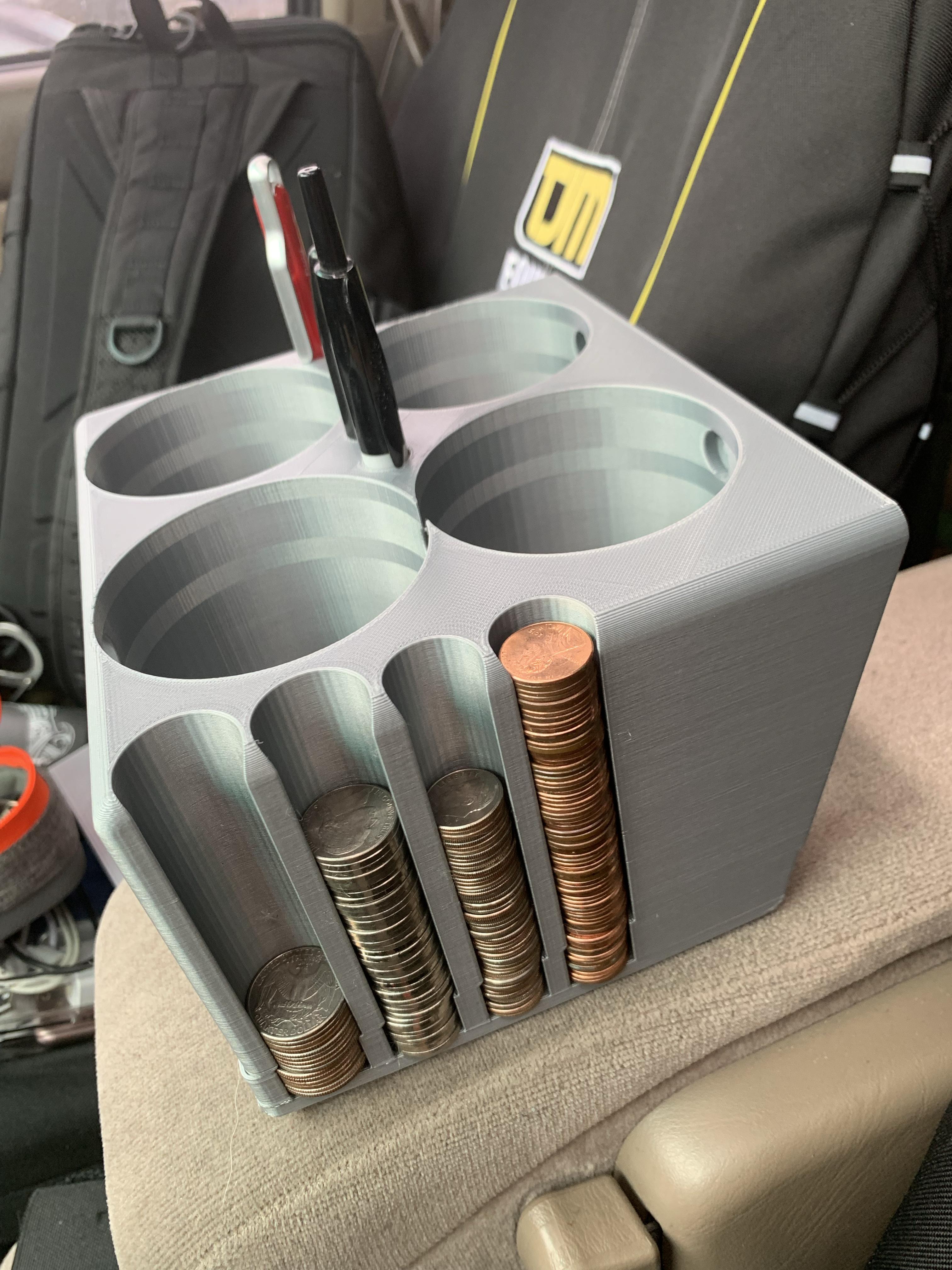

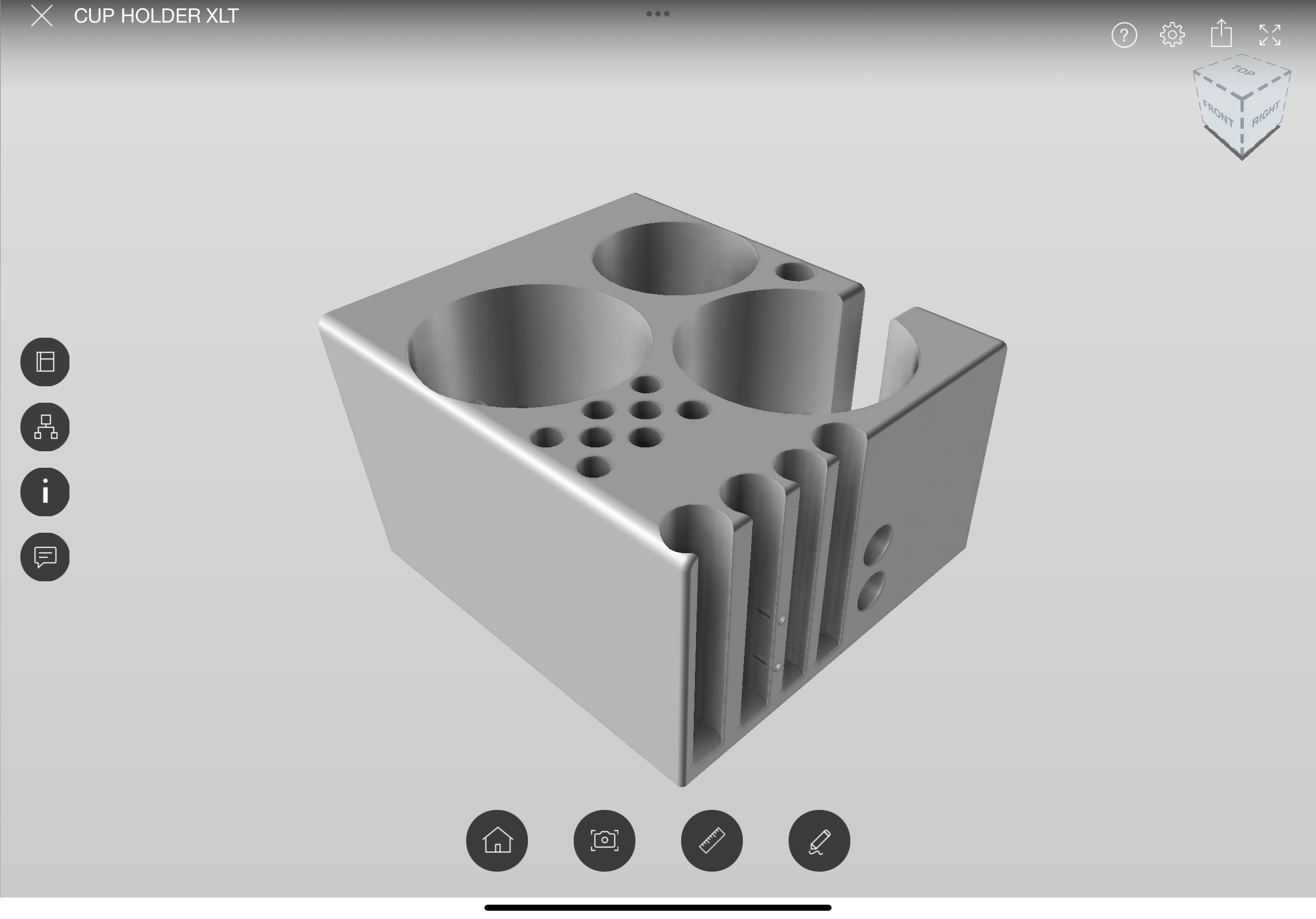

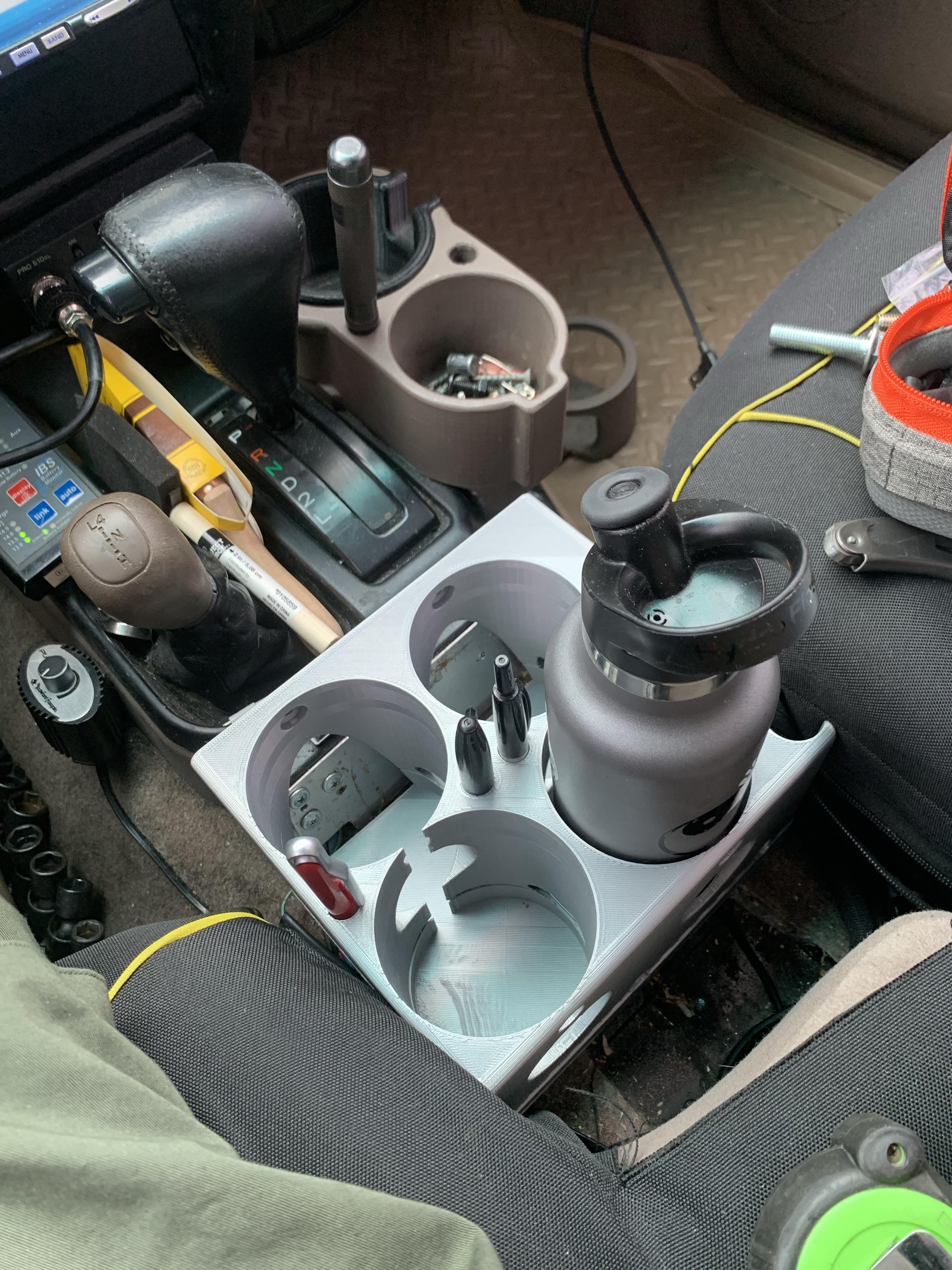

Installed my teq badge. This badge I bought from BH3D. The one I made will be installed on my brothers 4runner back home in Oahu,HI. I also made a 2 cup holder on the PRUSA MINI 3D printer in skool yesterday. I also made a 4 cup holder with coin holders. Both were 3D printed and I will make the final revisions tomorrow. All drawings were done on Fusion 360

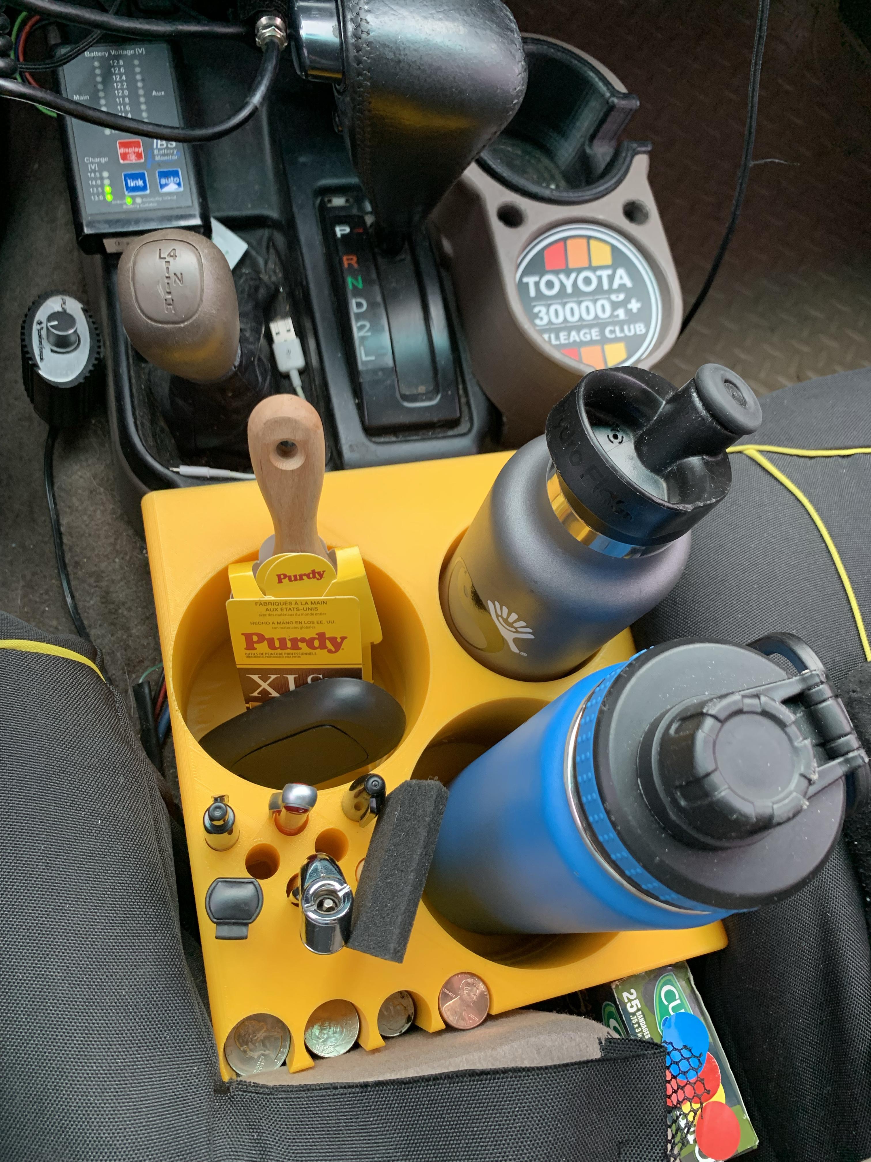

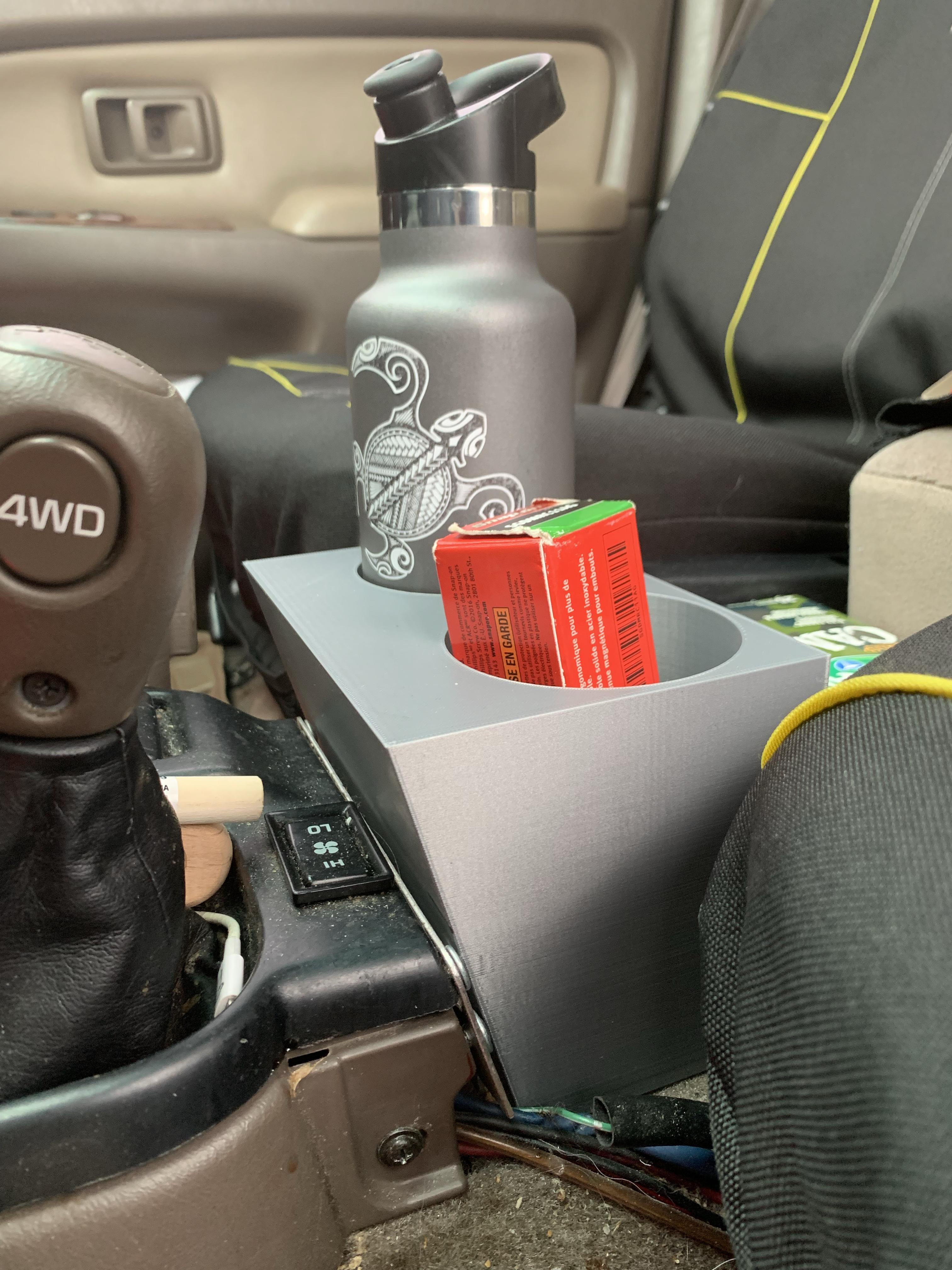

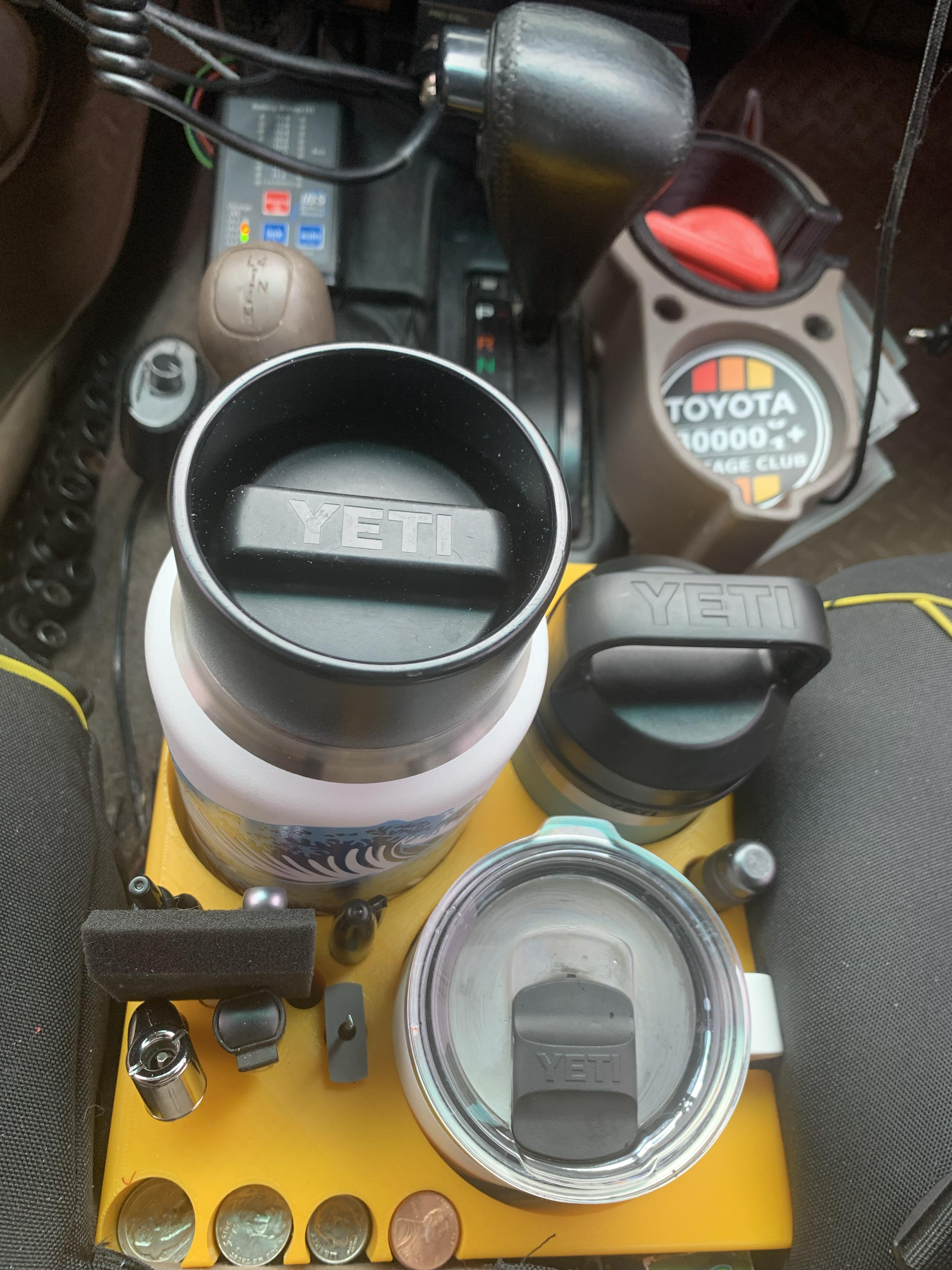

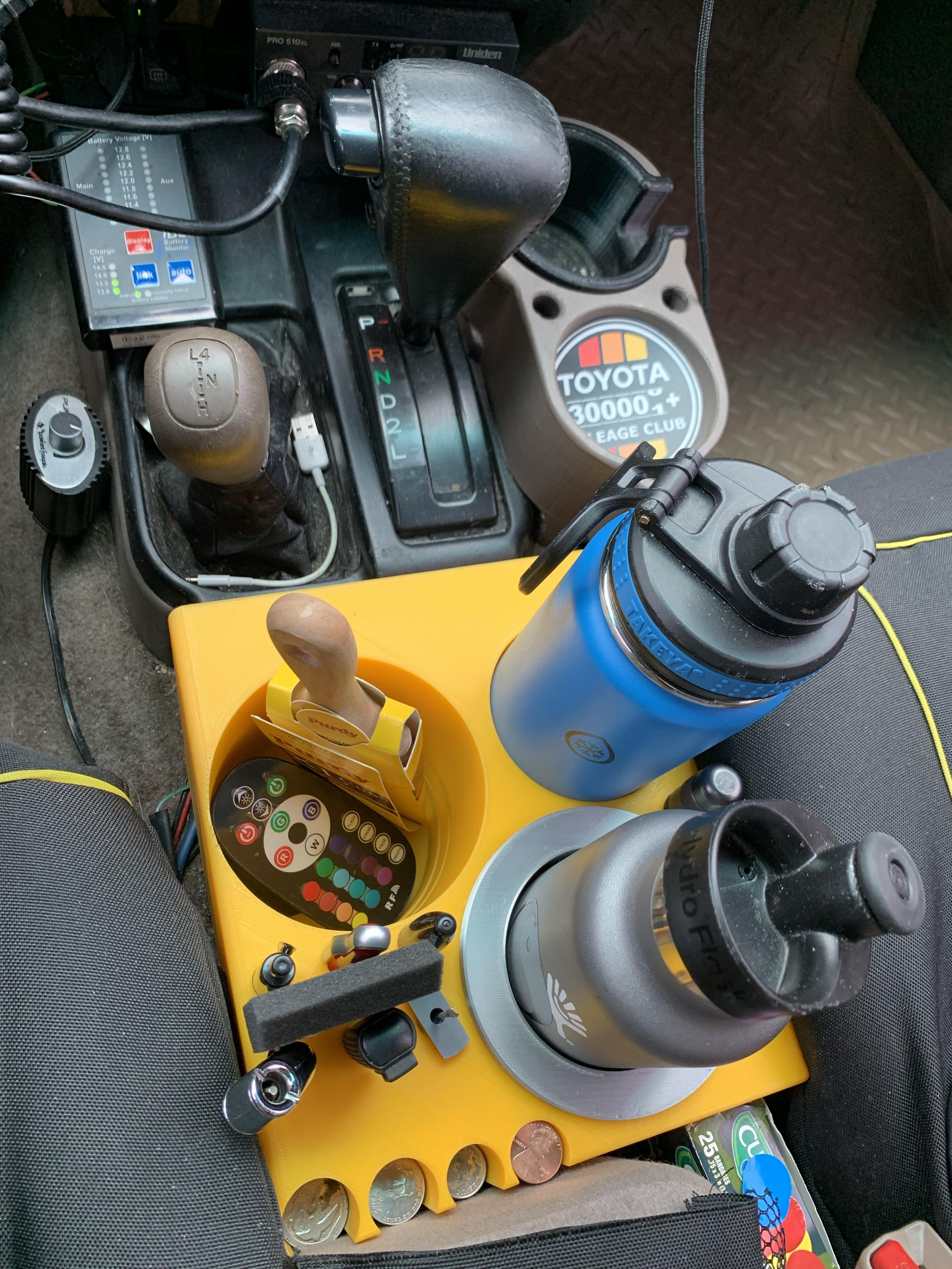

Made my last revision of my cup holder. I went with a 3 cup holder instead. Reason is my wife and I carry the big YETI flask and the diameter of those are 4”. My sons YETI is the smaller 2.9” cup. I also made slots for the coins, but I put it towards me instead of the passengers side. Made eight .5” slots for pens, tire pressure gauge, etc. Last hole on the far R was cut .75” for my window punch in case of an emergency. I put it on my wife’s side for her.

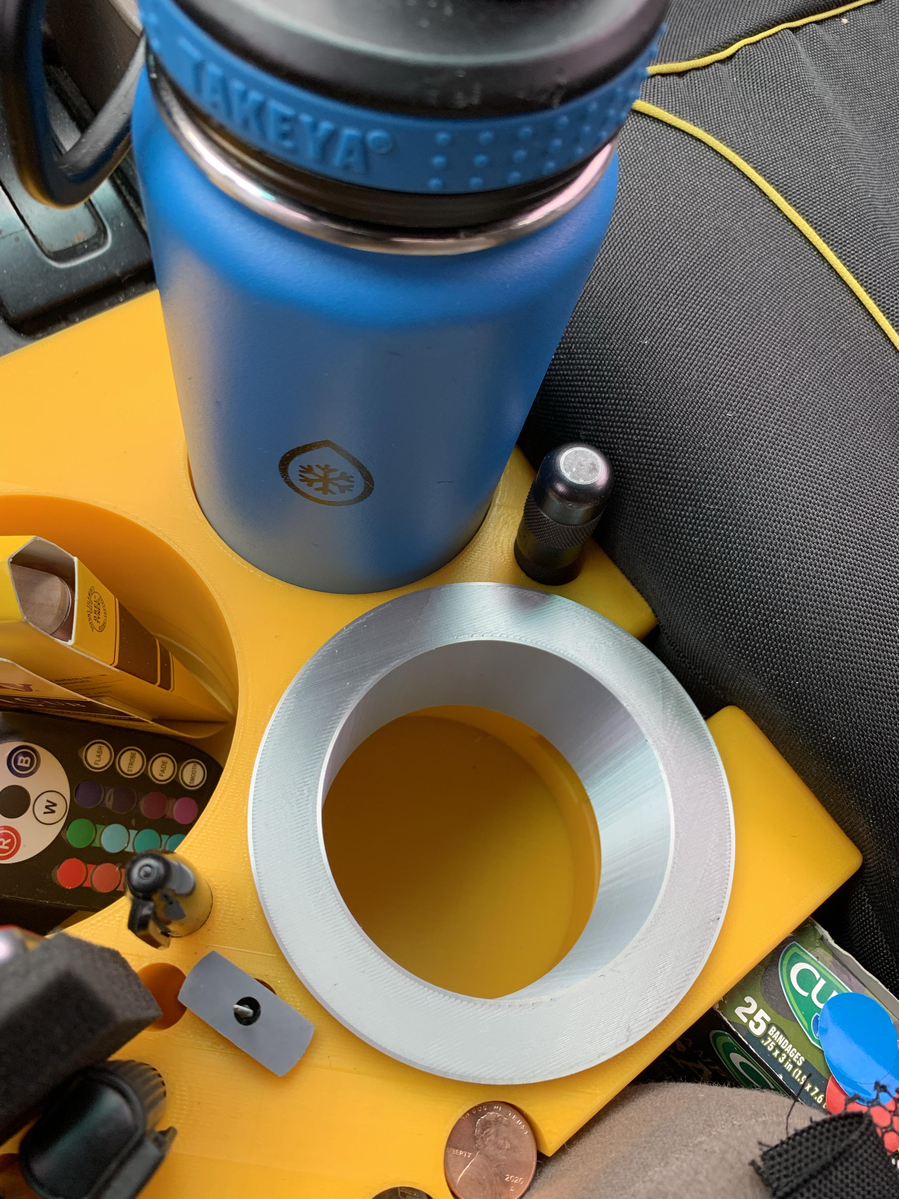

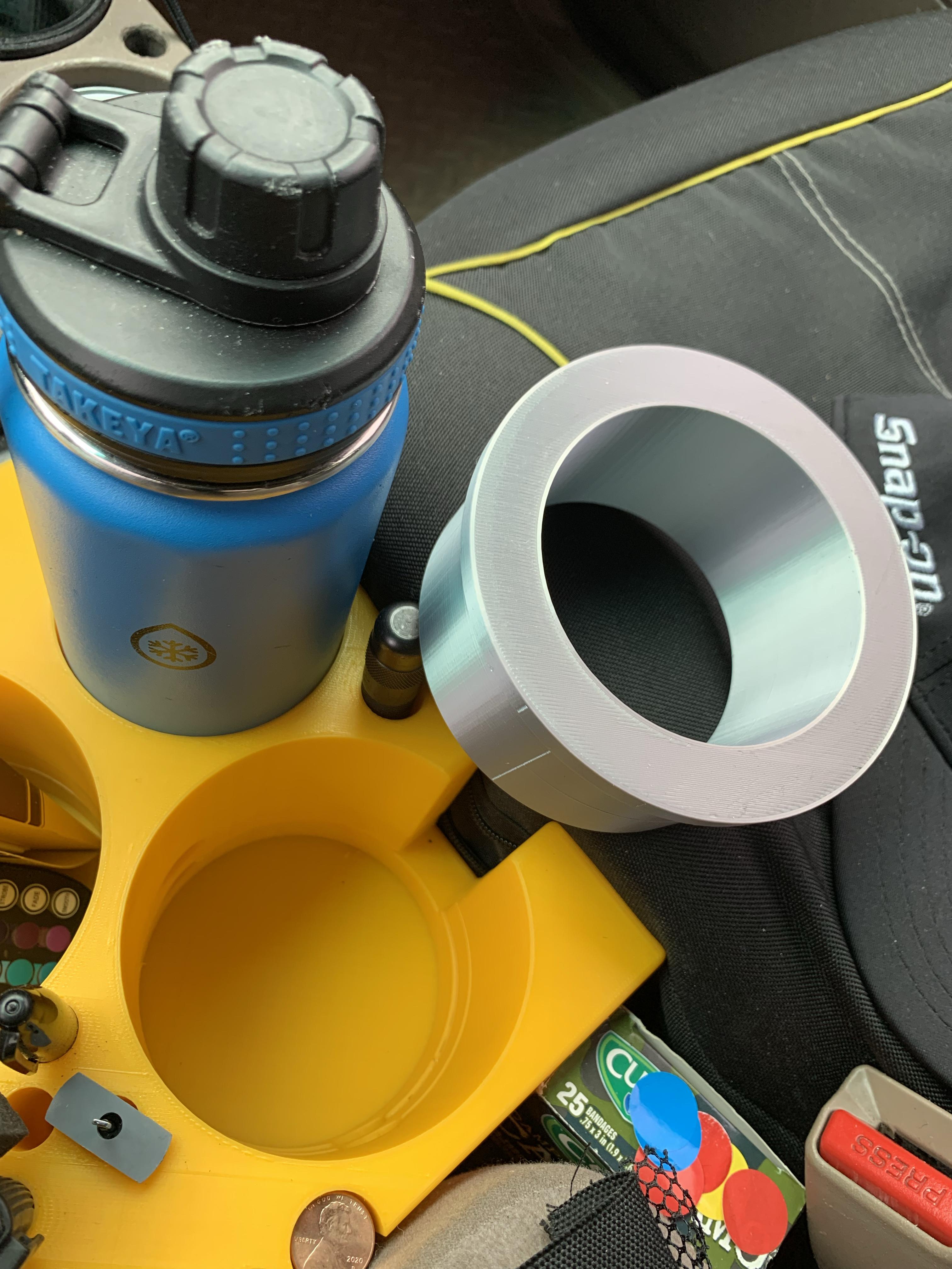

Made a spacer for the 4 inch cup holders to hold the smaller 3.1 inch cups. Came out nice and functional.

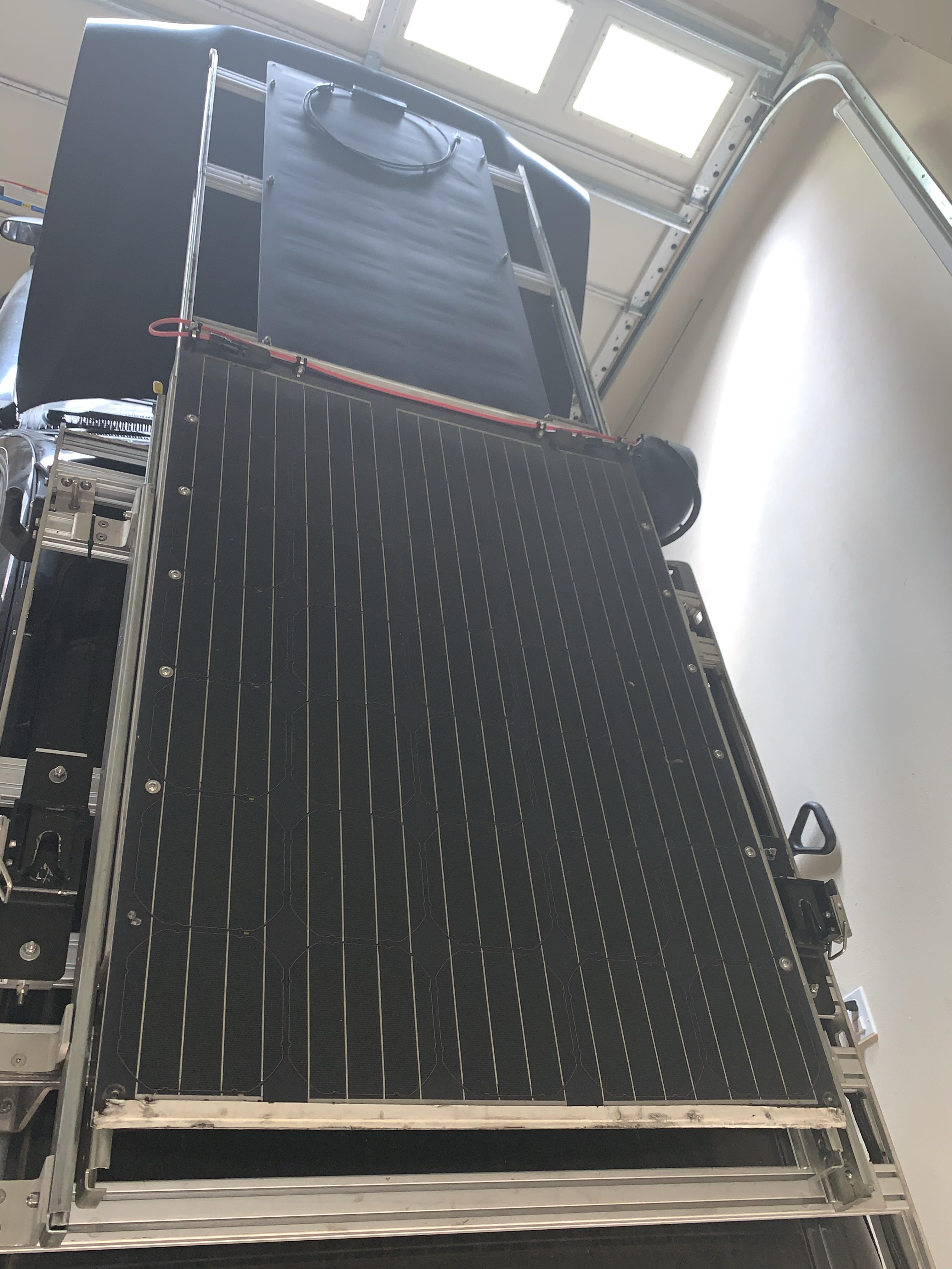

I finally mounted my other solar panel to my truck. The top panel is a Sunflare 105 watts and the bottom panel is from Overland Solar that is 130 watts.
