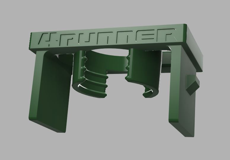

OK, my first post about progress on this project is about the USB port. I've decided to leave my stock port in the glove compartment, and have bought a Metra adapter to use that as my secondary USB connection which will be connected to the headunit.
For my primary connection, I've decided to make it behind the door which sits below the HVAC controls. A 3.5mm aux input sits there now from the factory, so I'll to get rid of that and put a USB port there. From prior experience, Apple Car Play is quite picky about USB connections so that's another reason why I opted to not just relocate the stock connector from the glove compartment to there.
I selected this cable from Amazon, and I'm pretty happy with quality of construction: https://www.amazon.com/gp/product/B078LRSZDB/ref=ppx_yo_dt_b_asin_title_o03_s00?ie=UTF8&psc=1
I was originally going to carve out a rectangular hole in a standard type of switch blank from my 4Runner, but I noticed that style of blank has almost a rounded face, which wouldn't be best for this application. Driving my Dad's 2009 Tundra the other day, I noticed the blanks in the dash were of similar size but had a perfectly flat face. I pulled one from his truck and it's a perfect fit for the 4Runner! $4.50 later, I had one of those blanks from the dealer and I started working on it (p/n 55539-06090 in case your wondering).
A couple photos (first one is after removing bulk of material with a drill bit, but before finishing with utility knife/files):

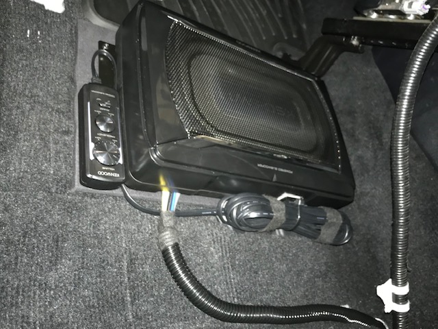

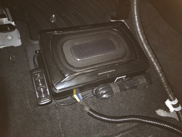

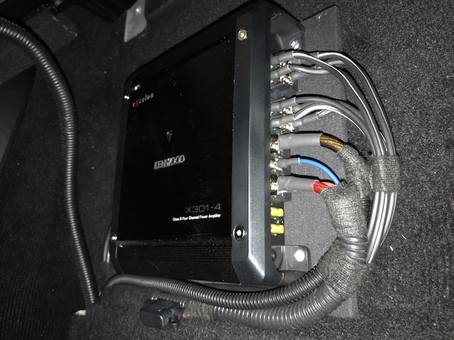

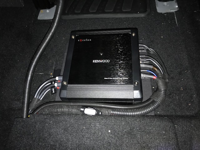

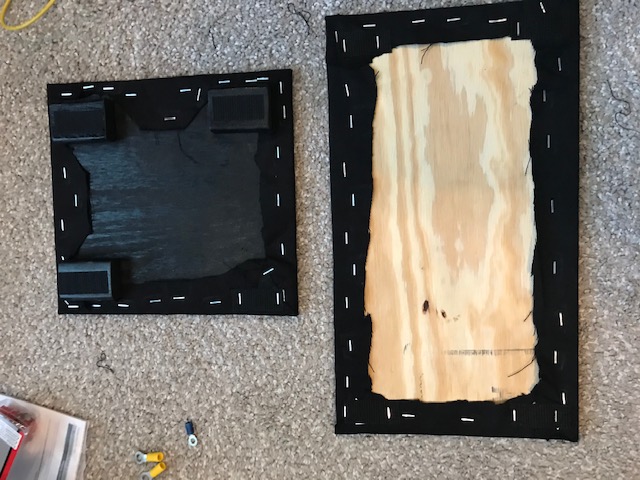

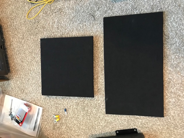

Finally got my amplifier installed under driver's seat, and subwoofer installed under passenger seat. I know I said I wasn't going to put the sub in initially, but I figured I might as well while I was in there doing the work. Ended up going with the Kenwood KSC-SW11, and it's fits perfectly under the seat! I used 1/4" plywood covered in black canvas as mounting boards and then used 3m industrial velcro to keep them in place. Seems quite solid, and they aren't going anywhere.
Also one word of advice to anyone running cables into and through the center console. Just remove the entire console to make life much easier. It's only 4 small bolts once you have your trim removed anyway, and you can just stand it up on its back between the seats. Lot's of sharp objects in there and the moving parking brake cable to steer clear of!
Now on to the headunit, speakers, and sound deadening!
Photos (yes I know the carpet has some debris, but you should've seen it right when I pulled the seats!):

Made a good bit of progress on the project this past weekend, and it was nice to see the equipment fired up and running. Although I haven't really had time to tune it, it's obvious that there is much, much more clean power on tap and I have much more flexibility with with the crossover. My limiting factor is the stock speakers right now because the paper cones just do not provide very clean highs.
