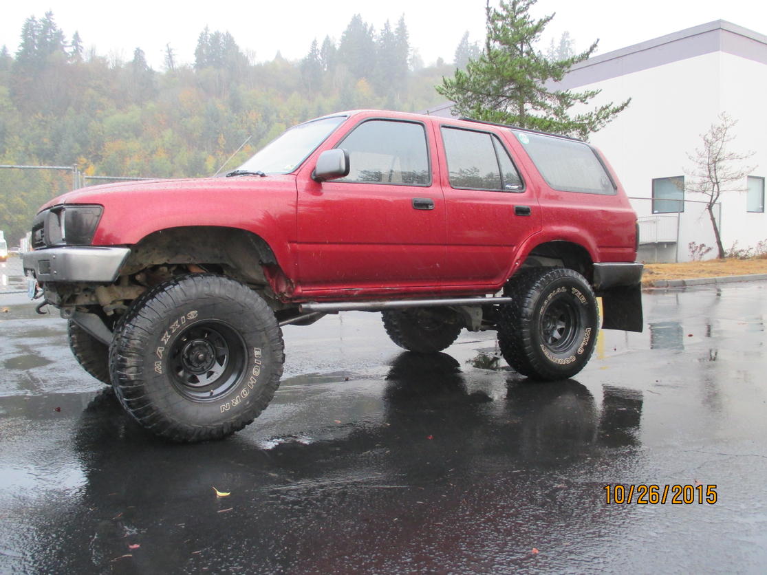

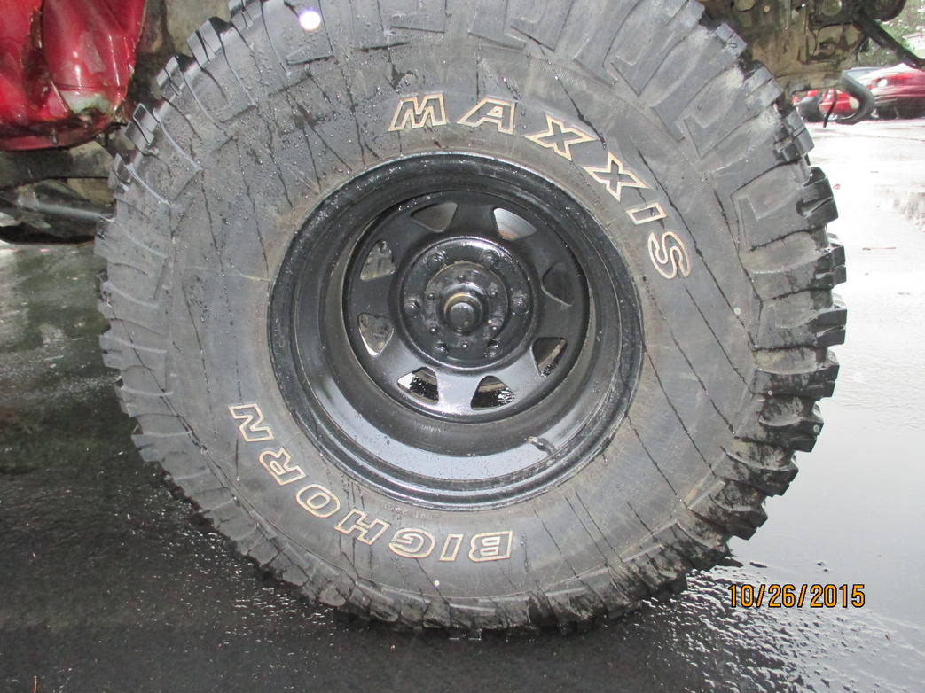

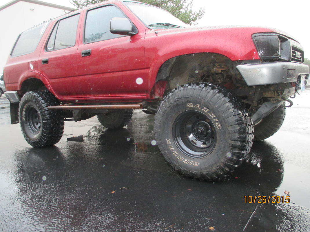

Got the "new" wheels and tires on this weekend. 15X10 steel wheels with 35" Bighorns. Ill post pics in a little bit after break at work
new wheels and tires
35x12.50r15 3 Maxxis Bighorns and one wild country XTR. I also have one more Bighorn with some camber wear for my spare. All in all not bad for $265 after mounting, balancing, and a can of paint and deck of cards to paint the rims.

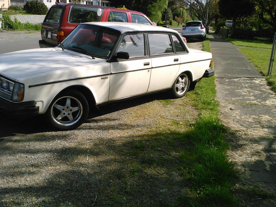

Good looking build. I like the volvo estate/tarp stand.

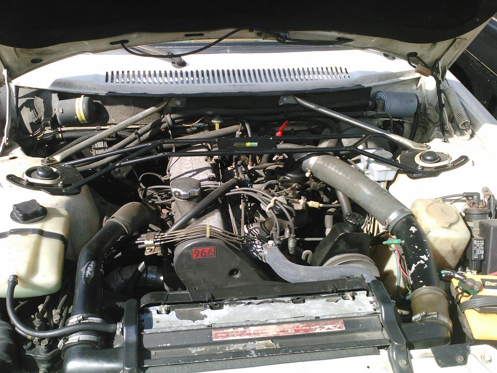

Thanks. LOL yeah haad to do what i had to do. It started raining and i had to drive to work on monday so i had to get creative. We actually sold the wagon the weekend before i blew my engine sad times. So i had to get my other volvo running so i can drive. It's a 82 turbo, intercooled, electric fans, chassis and strut braces. I got both of them from my grandparents. My gramps did all the mods to this one.

Sorry about the 3.0! Mine just took a poop on me as well.. it's in the shop getting a new 3vze in it.. I was wondering about your lift kit, did you really just get longer coil springs and shocks for the back to lift?
Yeah pretty much. Its just longer coils and drop brackets for the 4 links. Honestly my entire lift could be made at home if someone had the fab knowledge. The front is the same way. Its all drop brackets. I was going to research if i can add long travel suspension to the front since my lift is all brackets. Then i would have the ability to run 35-38 inch tires on a long travel setup. Dont think it would be good for trying to jump it but thats not the kind of wheeling i do anyways. I probably wont want to shell out the coin for that though. Save that idea for when i get a truck.
If that's all you need to lift it how come everyone is selling these $1200 lift kits that come with 100s of pieces?
Thats all that my lift kit was. I didn't pay 1200 for it though. I got lucky and bought my parts truck for 100. Steal right. Had the 4" procomp lift a 3" body 38's and 4.56 gears. Problem was no title and a blown engine. As far as why is everyone selling these is by my guess because 75% of the do it yourselfers probably dont have the skills or comfortability to make their own. I could reverse engineer my lift very easy if i wanted to for my next IFS toyota. Except for the springs that is. Check out my closer pics of the lift and you will see what im talking about.
So for the front as well you just have the springs, shocks, and drop brackets?!
Yup the front was all drop brackets no spacers anywhere. The back was longer coils and drop brackets. I did the front over a week after work and did the back in a weekend. So it didn't take too long. I have seen people selling the front lift on craigslist. If your interested id look there. Since its all brackets in the front you dont have to worry about if they have been well used. I also have a support bar in the front that goes from the LCA to the trans crossmember.
