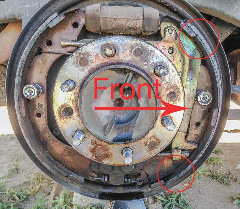

This is a common issue and seems to have a myriad of solutions. In my case the final piece of the puzzle was the rear brakes. I had previously been lubing the drive shaft and this may have been part of it.
But the brakes were certainly ailing. The front shoe on both sides had worn unevenly with the lower part being all but worn out <1/16" tapering up to ~1/4" on the top part [ see image ] I imagine this allowed the top part to rotate forward as with the taper the shoe was no longer properly centered.
$15 for lifetime shoes at Autozone…nice cheap fix, took about 2 hours with adjustment and bleeding brakes. I used this tutorial to start:

The reason why it wear's out unevenly is because the bottom-end is used for parkbrake and stays close to the drum all the time.

damn. Glad you got your problem solved but your brakes don't look like mine nor do they look like the link from Mike's DIY. I just started a rear brake thread and used Mike's as comparison. Coincidence?
Hmmm.
Well mine is a 2000 LTD. I saw that thread before I started but was only replacing shoes not hardware so did not read in depth.
I guess they can differ….. weird...
