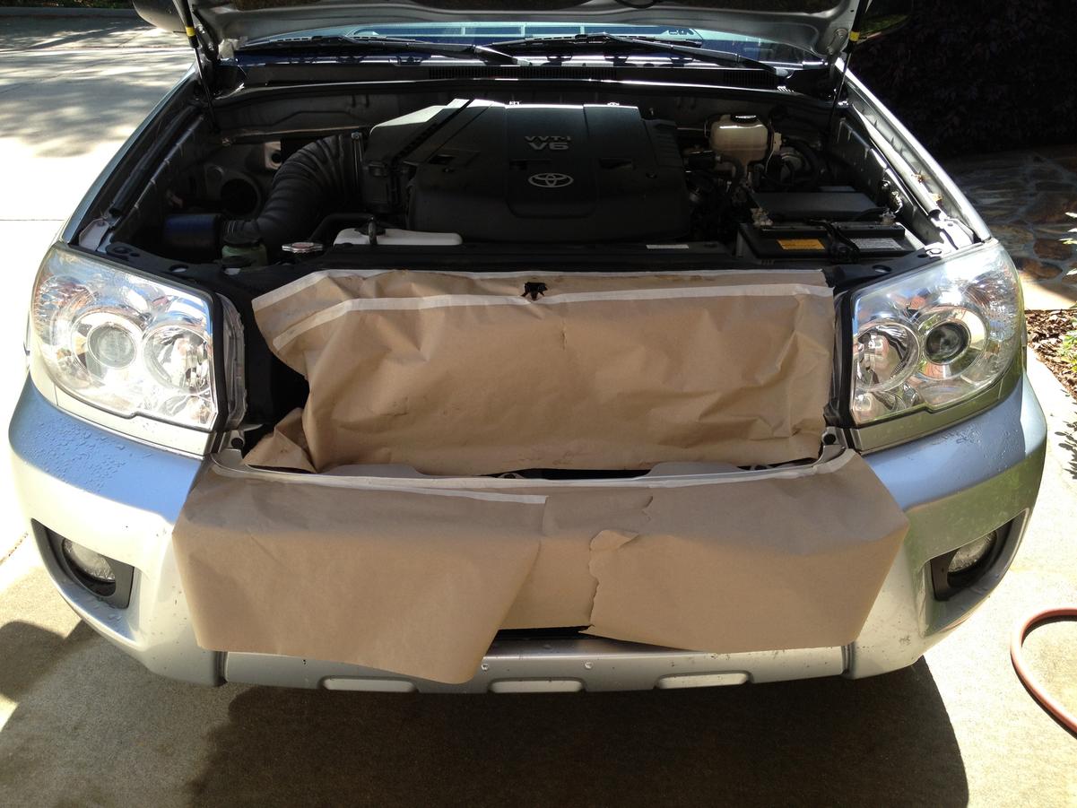

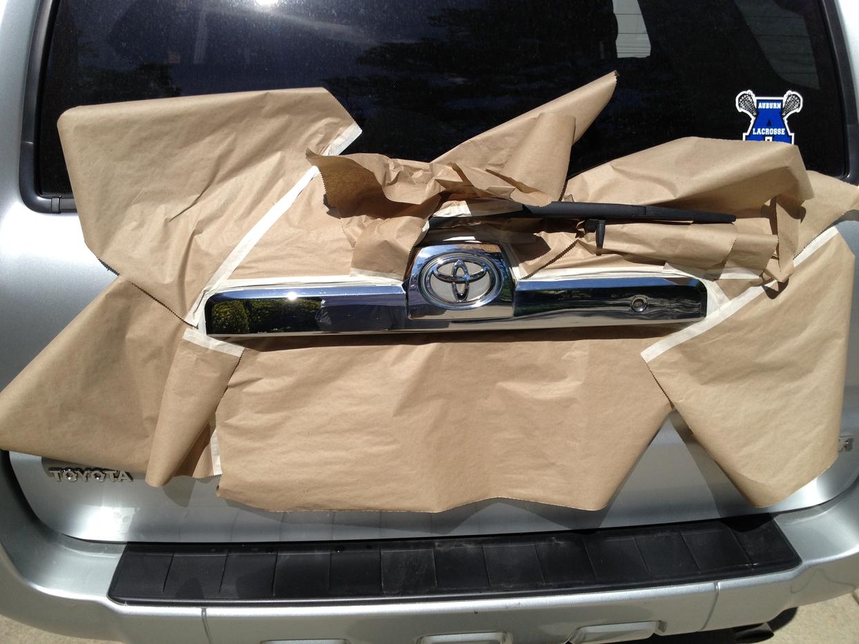

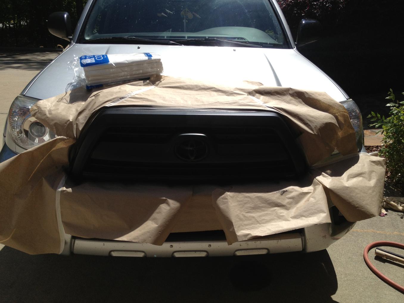

After getting two cans. I returned home to tape off the grill and whatever else I could find shiny enough to plasti dip. IMG_4817.jpg IMG_4819.jpg

Tips For Plasti Dip
Things I learned about plasti dip:
1. Do not tape off directly next to what your coating. Leave at least an inch of paint between your tape and what ever you're coating that way when you go to peel it off, it doesn't come off what you want coated.
2. You cant mess up. Paint, peel, paint, peel.

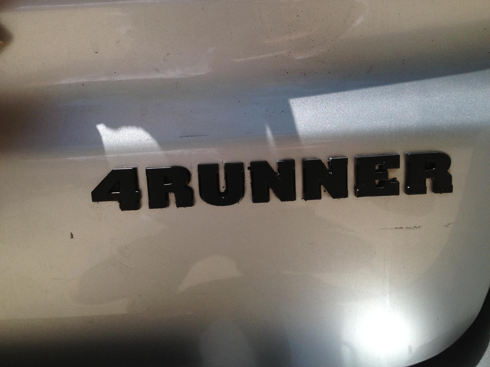

3. For smaller painting jobs such as emblems or lettering, its not necessary to tape off or cover your car on a wind less day. A rag with a little bit of XYLOL will take off any over spray with ease.
4. I found it that if you do it in full sunlight, little air bubbles will come up through it if what your painting is too warm so make sure that your car isnt toooooo hot.

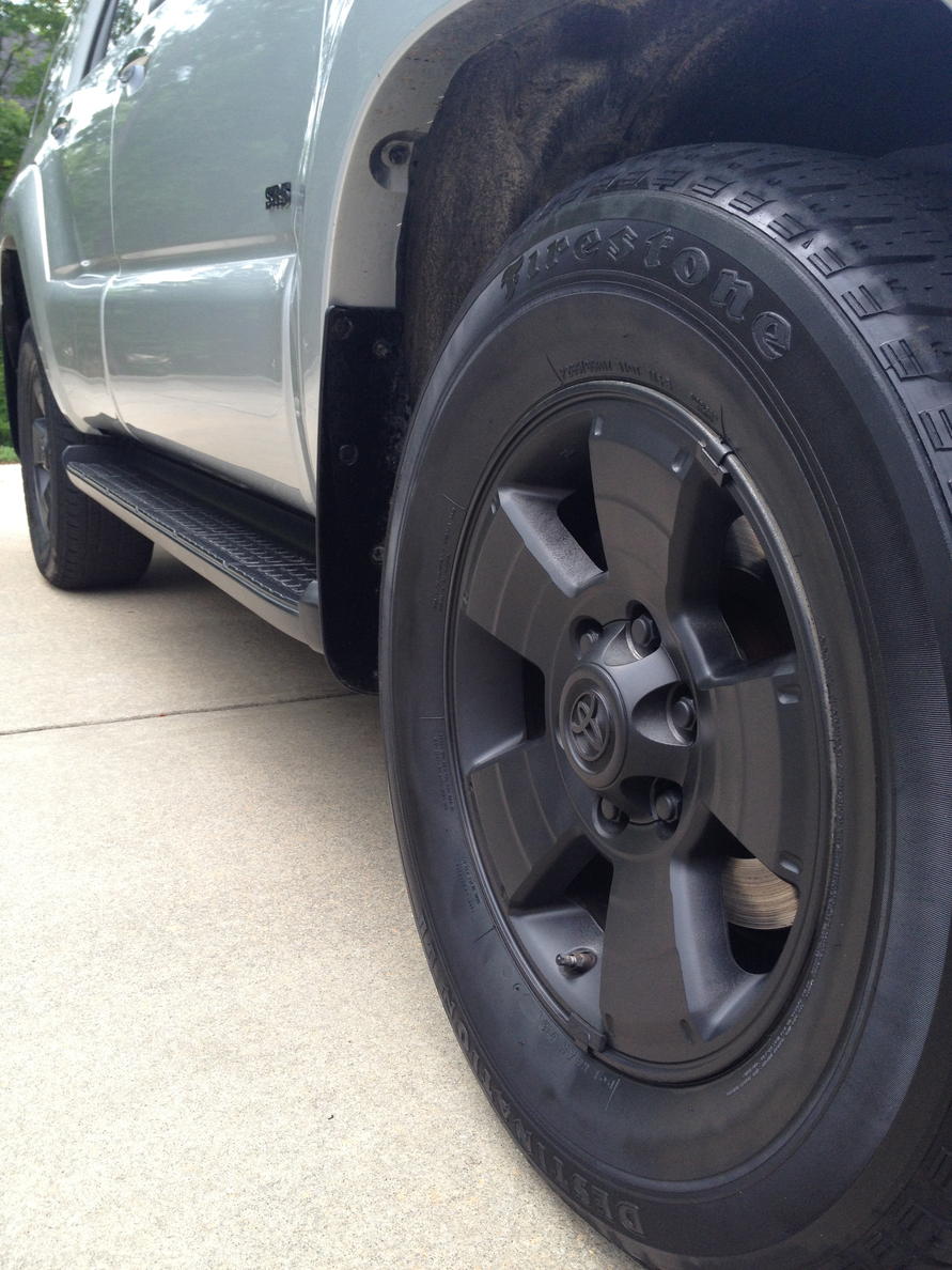

Did my rims today and could not be more pleased. I love them!!! IMG_4848.jpg
